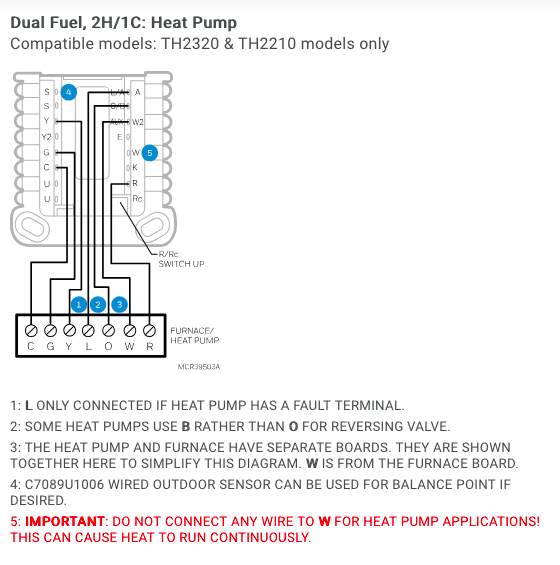

Honeywell seems to be widely instituting balance point logic in trade thermostats. I'm trying to grok the theory of ops where you have the heat pump as 1 stage cooling and 1st stage of 2 stage heat.
So the TH2210WF and TH2320WF (i.e. Pro 200 series-not sure why the model number and series don't line up better. yeah you can see a 200 in the numbers although sure looks like 2000 to me and they designate their TH6320 as 6000 series but T6-go figure) will take an outdoor sensor to operate the balance point but the tech line is a little hazy on the wiring for the crossover between heating stages at the balance point.
they suggest I need a normally closed cutout relay to separate the heat pump and boiler but I think the logic actually is in the thermostat already. if you set the principle type of equipment on the 1st heating stage as heat pump then when the 1st stage heat is called my guess is that it makes Rc to Y and O/B (except there is different logic on some heat pumps so no one can tell me if that is the right guess as to what happens. or maybe it is NC to O/B and breaks the contact. And maybe there is a parameter to set that tells it whether you energize O/B for heating or cooling depending on your heat pump setup?)
then you have told the thermostat there is an outdoor sensor and set the balance point from that input (**** only allow 5 degree increments unless you want to spend double on the thermostat like for a TH6320WF, ie. T6 series) and when the outdoor temp goes below the setpoint and it locks out stage 1 by disconnecting Y from Rc and calls stage 2 by connecting R to W2.

answered one of my own questions. default is O (reversing valve powered during cooling) but parameter. 2060 allows you to change it to B (reversing valve powered during heating). and speaking of inconsistent numbering conventions amongst honeywell thermostat models, why do they have to use completely different parameter lists across their line. couldn't they use the same parameters and then just some are and aren't implemented on some thermostats?
still presume and I guess i could figure out with an ohm meter when i have one of these thermostats on the bench but hooked up to an outdoor sensor and 24V on R and C that calling stage 1 if stage 1 is designated as heat pump closes Rc to Y?
There is a pretty good video on this but it presumes using the same 24V transformer from the heating system/relay to power the 24V side of heat pump so they jump R and Rc. That would not be my first inclination with the exception that I have to consider the jumpout strategy during defrost cycles and whether I care to call the 2nd stage in that case. There I'd have to see what is the common and particular implementation strategy for the heat pump to signal that it is in defrost to the 2nd stage and whether I could implement that as an alternative TT to the SR503 to run the boiler because I don't see a way to send that signal back to the thermostat to call the second stage.
This video actually envisions a hot air furnace that even more directly requires to be locked out during heat pump operation except at defrost. Vast majority of my applications are separate hydronic or steam backup but the theory is more or less the same albeit the effects as between the two stages a little more indirect.0 -
