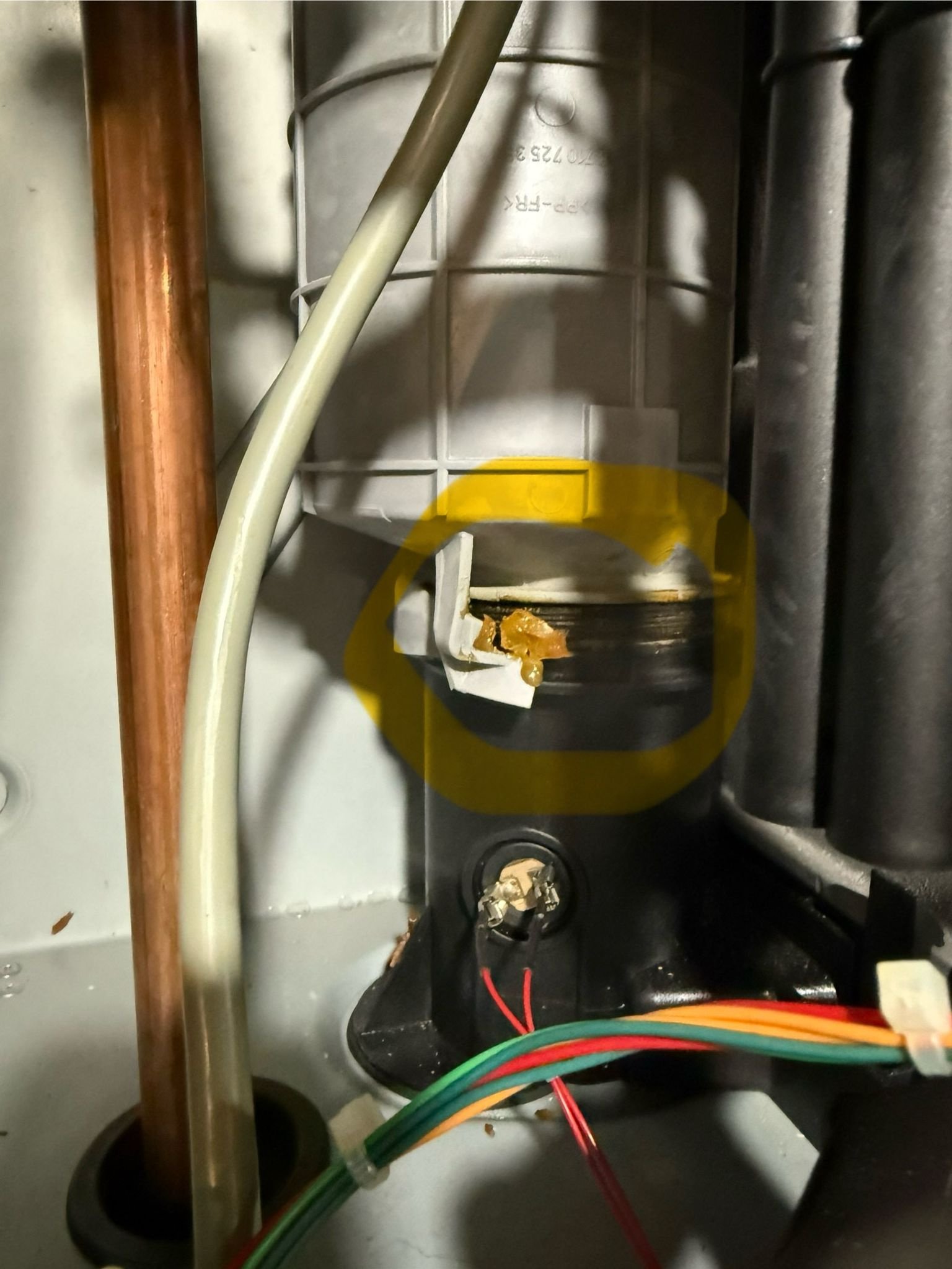

I am having issue with my Bosch ZBR 28-3 boiler. When enclosure is closed boiler works and operates fine for day or 2. And then i get ER code on it. Seems to be working fine when i take of the enclosure and let it run without it. So seems like something is wrong with combustion. I check everything and cleaned everything that i could and what was suggested in the manual but i am still experiencing this issue.
What i noticed is that my silencer, gray thing in back of the boiler, is not really properly sitting or connecting on the bottom. Please see my picture. There is a gap there and i see some grease there as well (where i highlighted). But i am not sure if this gap should be there.
Should i get new silencer and installed it? Or should i take this one apart and reinstalled it and make sure there is no gap there? Its just weird that it works fine for day or 2 and then this happens and i need to take the cover completely off. Most of the time it happens during the night when we are sleeping. During the day it always works fine.

    It appears that you’re leaking flue gasses into the cabinet and recirculating them back into the burner.
    That’s a dangerous situation and should be corrected immediately.
    A combustion analysis should also be done.

    Thank you Ironman. I am getting combustion analyzer today so that i can tune the unit. Should i try to take off this silencer and try to see if it is seated properly?

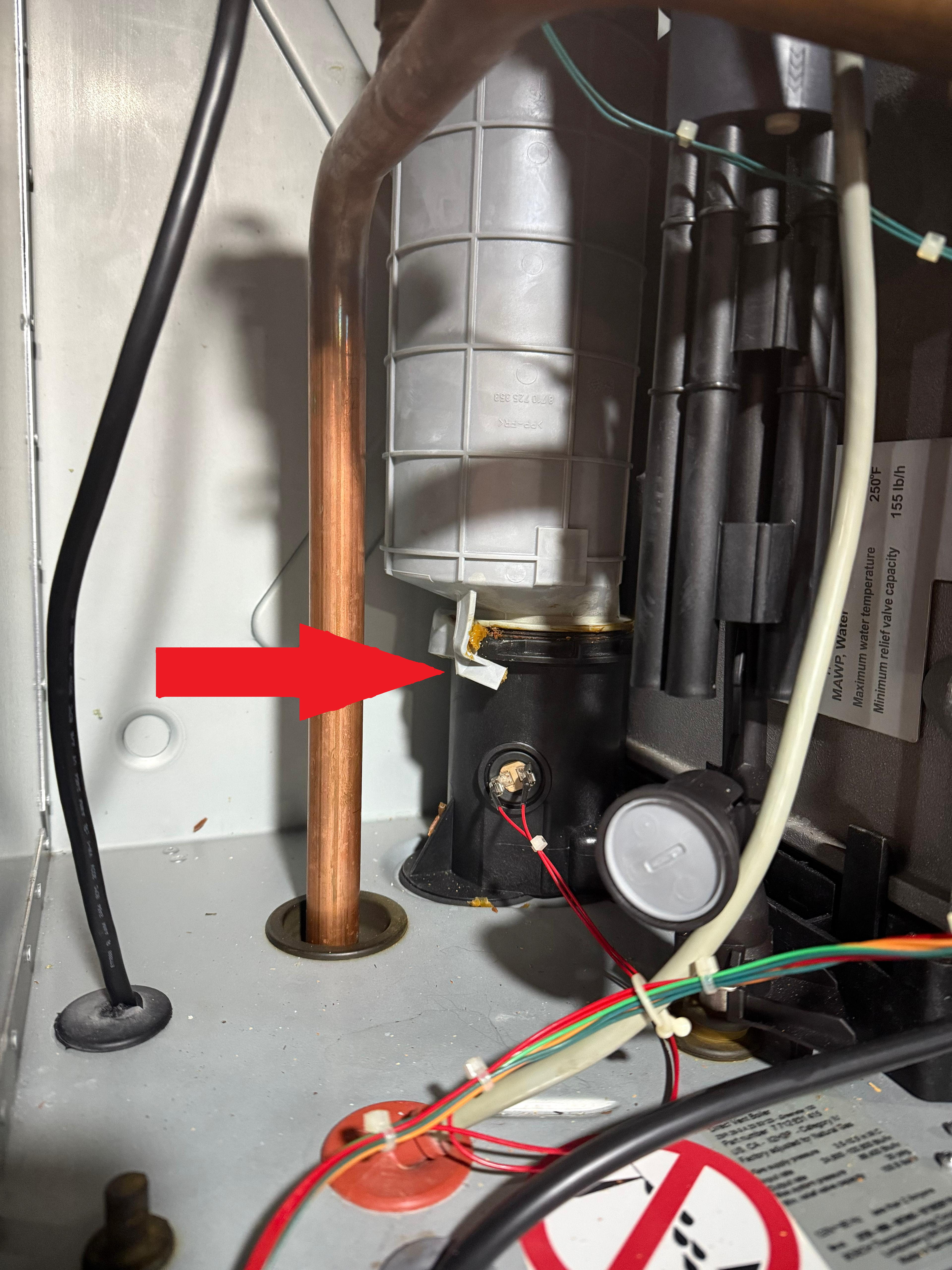

    I was trying to push my silencer down and lock it so it doesn't go up and create this gap but i was not sure if this pin (red arrow pointing to it in my picture) or piece of plastic should be used to lock it or something. Seems like to be in my way or i am not doing it right. If someone can take a picture similar to mine and show me how it looks like on their side, i would really appreciate that.

    Yes , that plastic tab lock locks in the muffler ..

    I will take it off and then put it back. The way it is now I don’t think that tab is doing anything at the moment. And because of that, this is where I am getting the leak and boiler stopes working when cover is on.

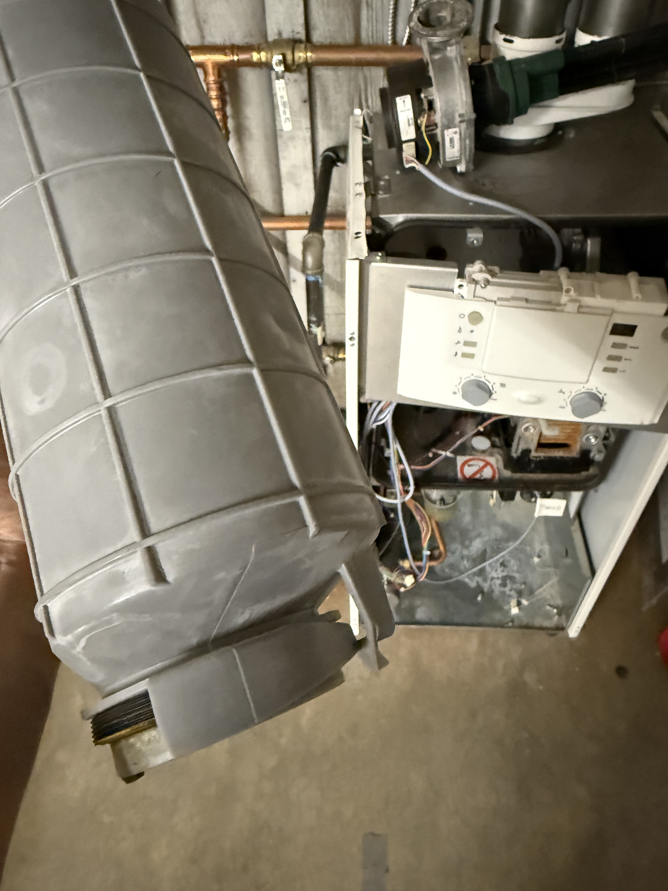

    I’ve gotten the boiler pulled apart. I’m actually in the process of replacing the heat exchanger. It was tough to get any sort of customer support as the homeowner. Unless you’re a licensed technician holding a phone right in front of the boiler, they are reluctant to give any info whatsoever. When I said I was having trouble finding any reps in my area, they gave me a number to a place over 75 miles away in Chicago that doesn’t service my area, either. To be quite honest I had a lot of difficulty finding anyone who works on residential boilers in general, let alone these Bosch boilers. I finally found a licensed guy about 30 minutes away who contacted Bosch on my behalf. He said it was the most painful experience he’s ever dealt with as a technician , but after numerous phone calls , people pointing fingers and making it someone else’s problem, he finally found someone to help get this thing covered under warranty.

    Thank you for providing this picture. When you go ahead and installed it, can you then take another picture so that I can see how it is this sitting on your end? This tab that should lock this silencer, for me it is just not lining up at all.

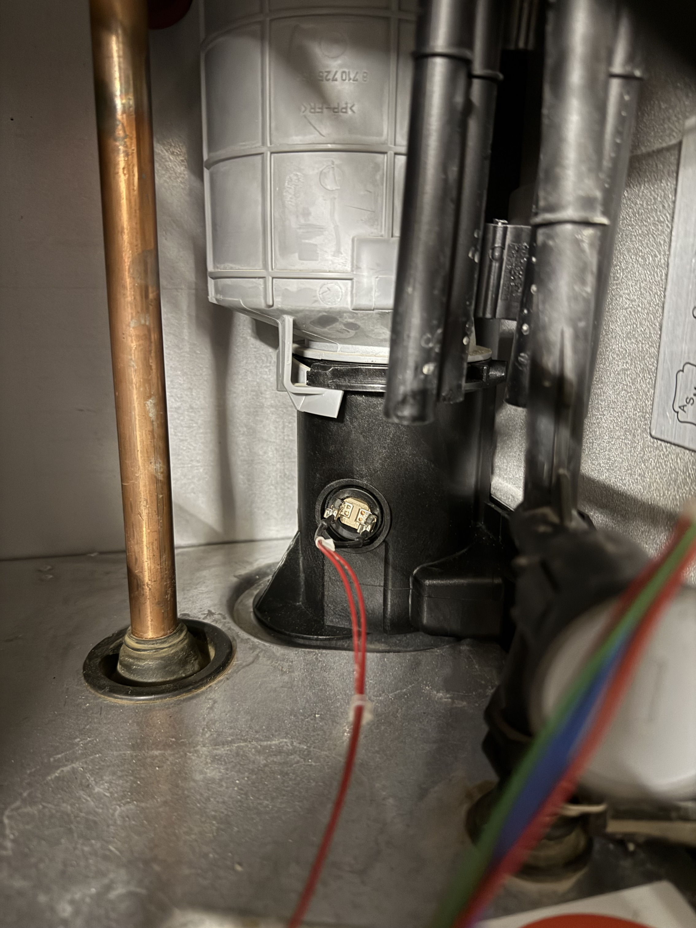

    Looks like you got it working again before I could get you a picture. I finally got mine going again ; What a headache. I think the tech that was able to apply for the warranty on my behalf was intimidated by the job. Fortunately I was able to go get the heat exchanger myself and get everything put back together.
  • Thank you for providing a picture of your setup. Your connection looks nice and clean. In my boiler I still have some hardened grease where silencer is connecting to the bottom part.
