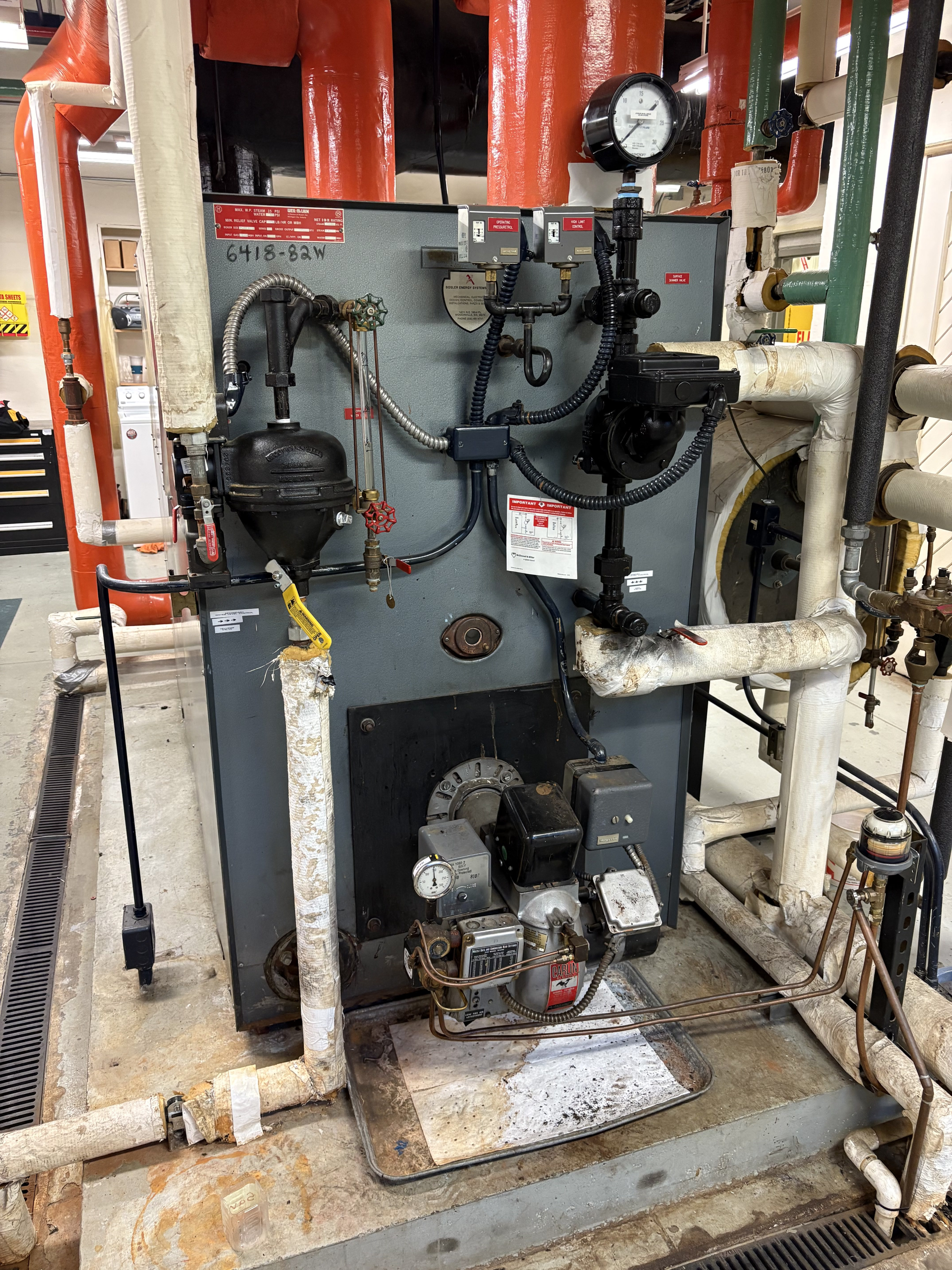

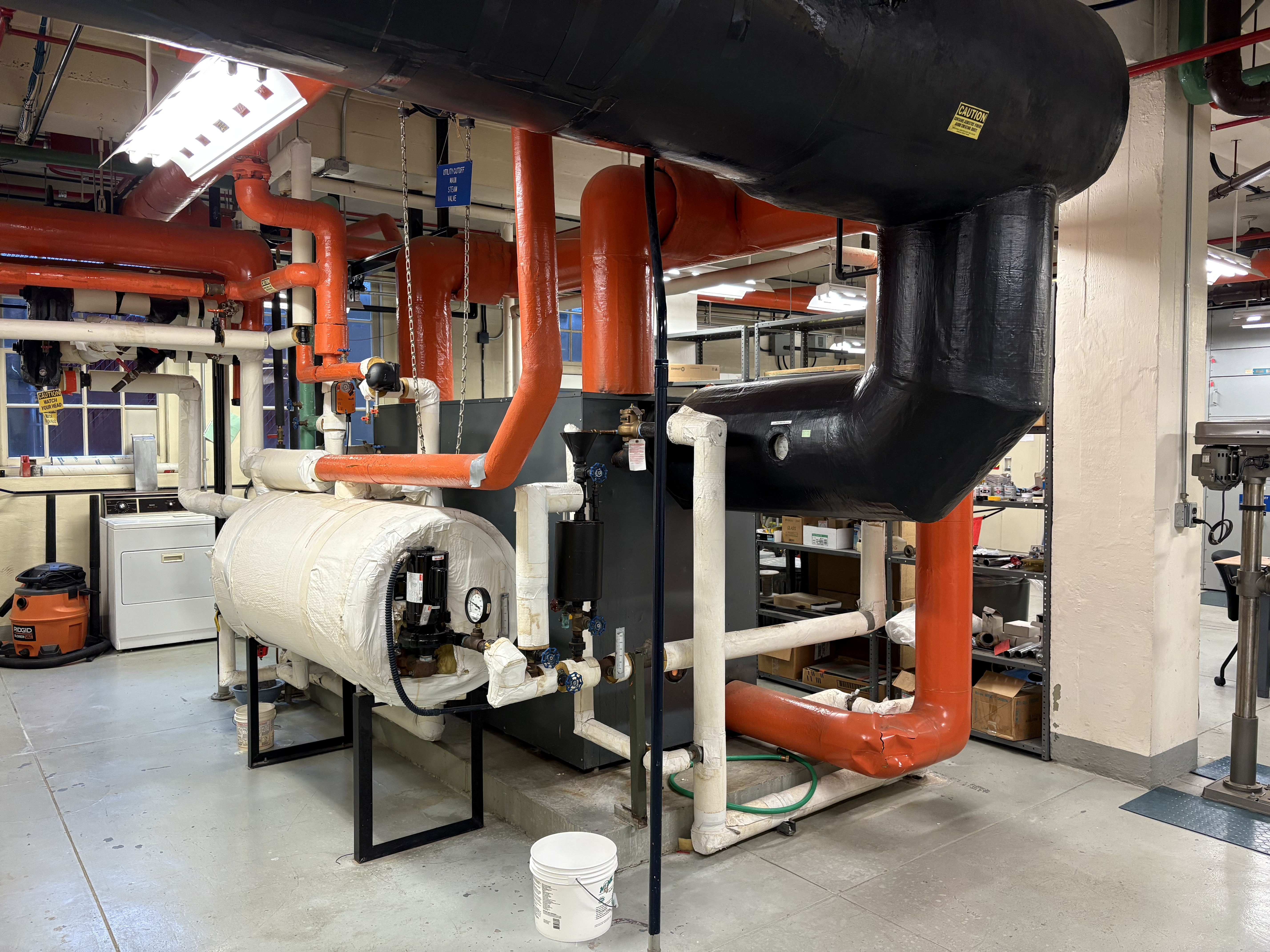

I’m managing operations and maintenance for a historical commercial building built in the 1930’s. It has one-pipe steam heat on 3 floors (basement rads in ceilings), and a heat exchanger (terminology help please) in the attic that cycles the building air through a coil. I have no current 2nd floor tenants, so radiant heating on that floor is not a priority other than preventative maintenance.
The building diesel usage history felt crazy high to me (23+ GPD), so I bought a couple of Dan’s books, and started with tracing steam lines looking for vents. Aside from the (4) F&T traps, there were none. Well, there were (2) Hoffman 79 Hot water vents installed at the end of the basement/1st floor mains where the 1931 blueprints called for “Air Vents”. Based on their location, I assume the vents kept spitting and dying until someone put a backwards vent on it and no more spitting. I cannot change the vent locations, so I was thinking, a big mouth for each line plus whatever needed to trim out the required venting. Advice on this would be very helpful. Pics are included. They’re both in the boiler room above floor drains, I do not care if they spit or whistle.
All Rads have Hoffman 1A vents, and all seem to be working now. According to the tenant, they would spit and leak all the time before I got here. The paint on the near-boiler radiators is all peeled away as well, while all the 2nd floor rads are fine.

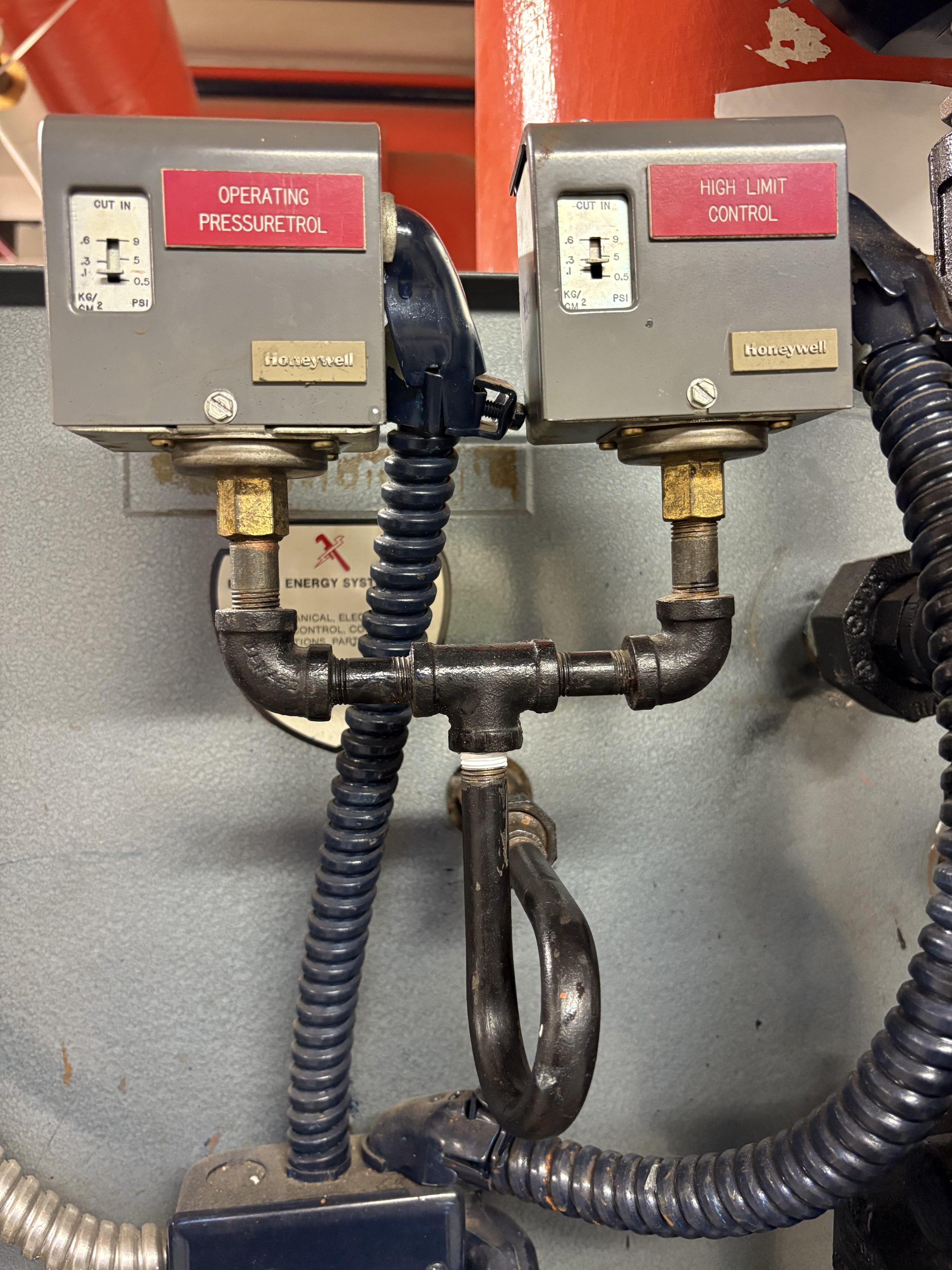

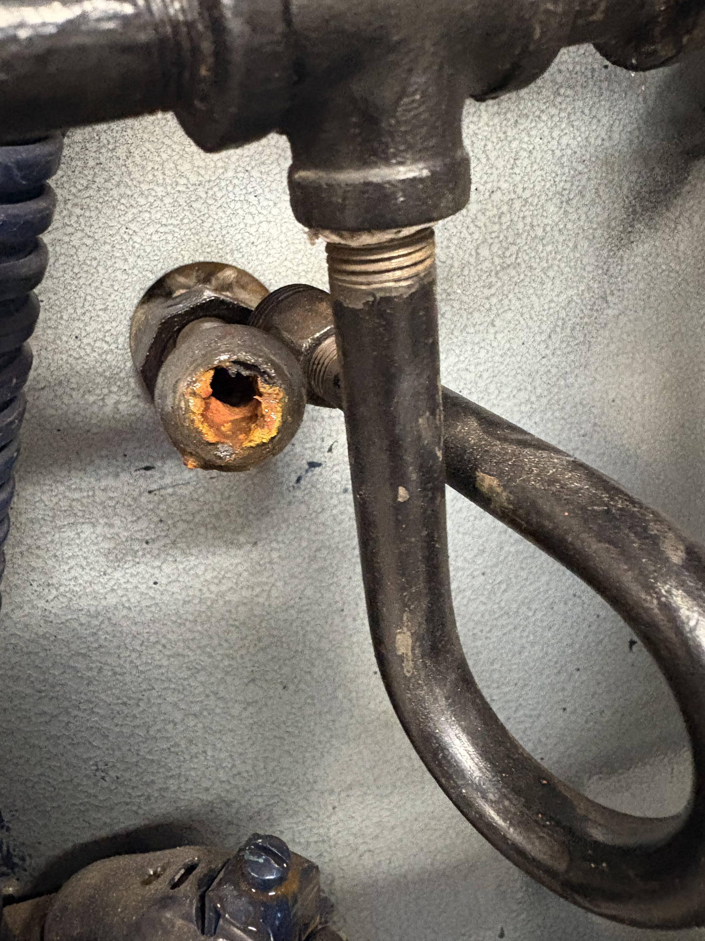

The pressuretrol was turned way up when I got here (5psi). I cleaned out the pigtail, and set the ptrol to around .5 cut in, 1 diff. I have no idea if this thing is working. It seems to just run to satisfy the thermostat.
The thermostat is an old Honeywell mercury dial. Reliable for sure, but it’s located 12 ft from the boiler with no other readings throughout the building or exterior. This building is vacant evenings and weekends. Should I update this to a programmable unit, and which one?

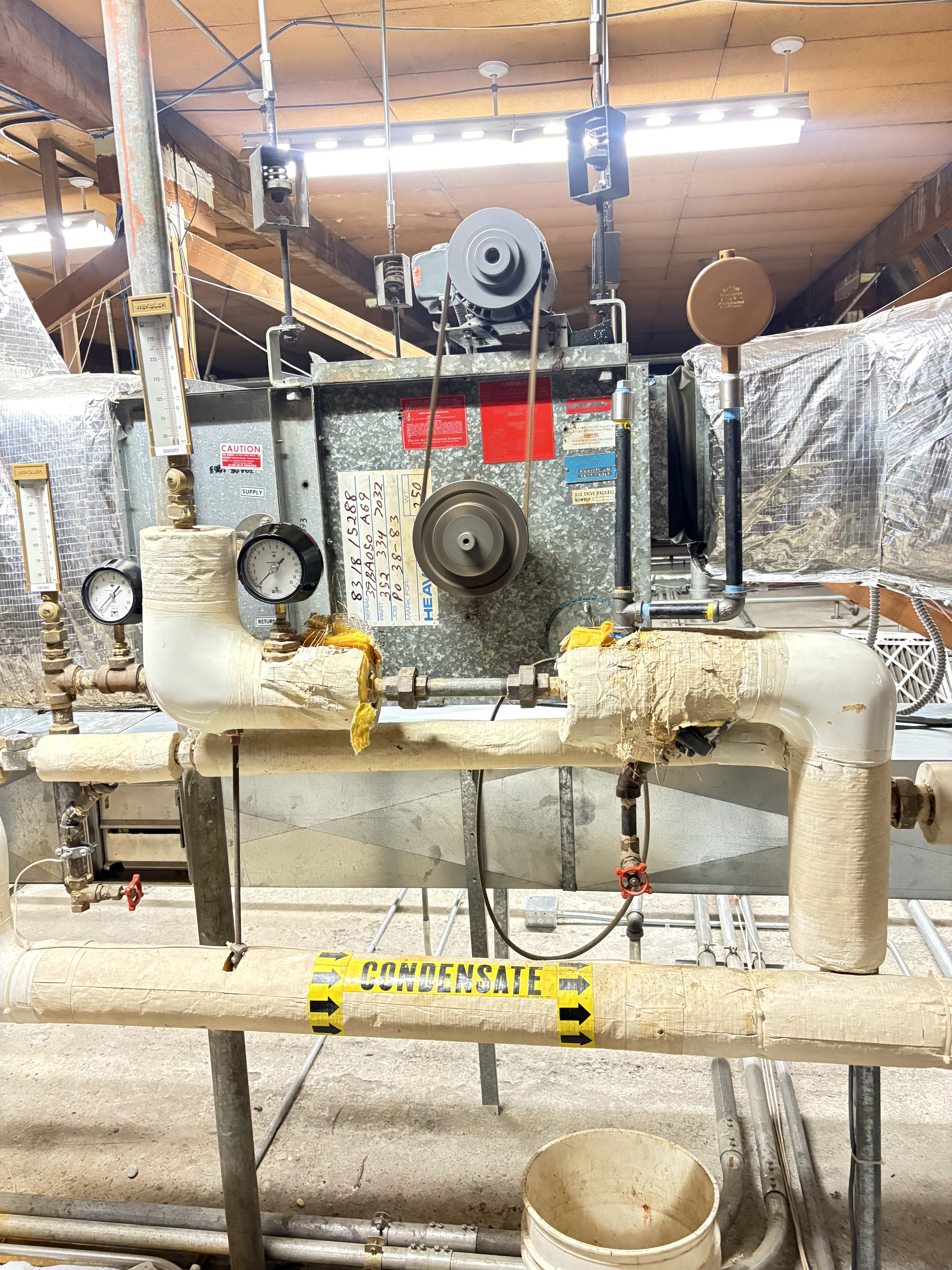

The attic air handler is its own can of worms for a later date, but I drilled and welded on a 1/2” nipple earlier this season and added two Gorton no 2 vents, though I moved one of them to a basement main to help with venting temporarily. I plan on adding a gorton D on the inlet of the unit to vent that last few feet as quickly as possible. The traps on the unit seem to work.
I currently have the boiler set to a low flame. It was set to full flame when I got here, but with the lack of vents, it was going nowhere. Once I get my mains properly vented, should I try to go back to a full flame? I’ve included the boiler specs and rad sizes, main runs, below.
Boiler: Weil McLain 1086 , Carlin 701 CRD Burner, unsure on current nozzles

    The pigtail and the piping under the pressure controls looks to be black steel which can plug up. I would urge you to replace all those fitting with brass and make sure the pressure controls actually kill the burner on high pressure.
    Actuall you should have 3 pressure controls on that boiler.
    1 operating control
    1 high limit control (backs up the operating control)
    1 control to operate the burner on lo-high fire………or do you switch that manually??
    I would recommend using the existing. high limit control for lo-high fire and installing a new manual reset high limit control for the burner. You will have to run 2 new wires from the lo-high fire control to the burner. If you take the junction box cover off the burner you will find 2 yellow? I think wires wire nutted together. Hooking those to the new control will give you automatic lo-hi fire
    Honeywell L4079B1033 is the manual reset control needed.

    You will have 3 controls, one that sets the threshold between low and high fire, one that turns the burner off altogether, and a 3rd with a setpoint higher than the operating controls that is manual rest so if the operating control fails and trips manual reset control, you know that you have to fix the operating control. The manual rest control won't trip unless something has gone wrong. Ideally the manual reset control would be on a separate tapping and water seal.
    EBEBRATT-Ed
    @Hootie manual reset is required on larger boilers now. It may not have been when this was installed.
    Your operating control is you upper steam limit to shut the burner down on steam pressure.
    The High limit only come into play if the operating control fails or the pigtail becomes plugged. You can set the HL up to 10psi or so.

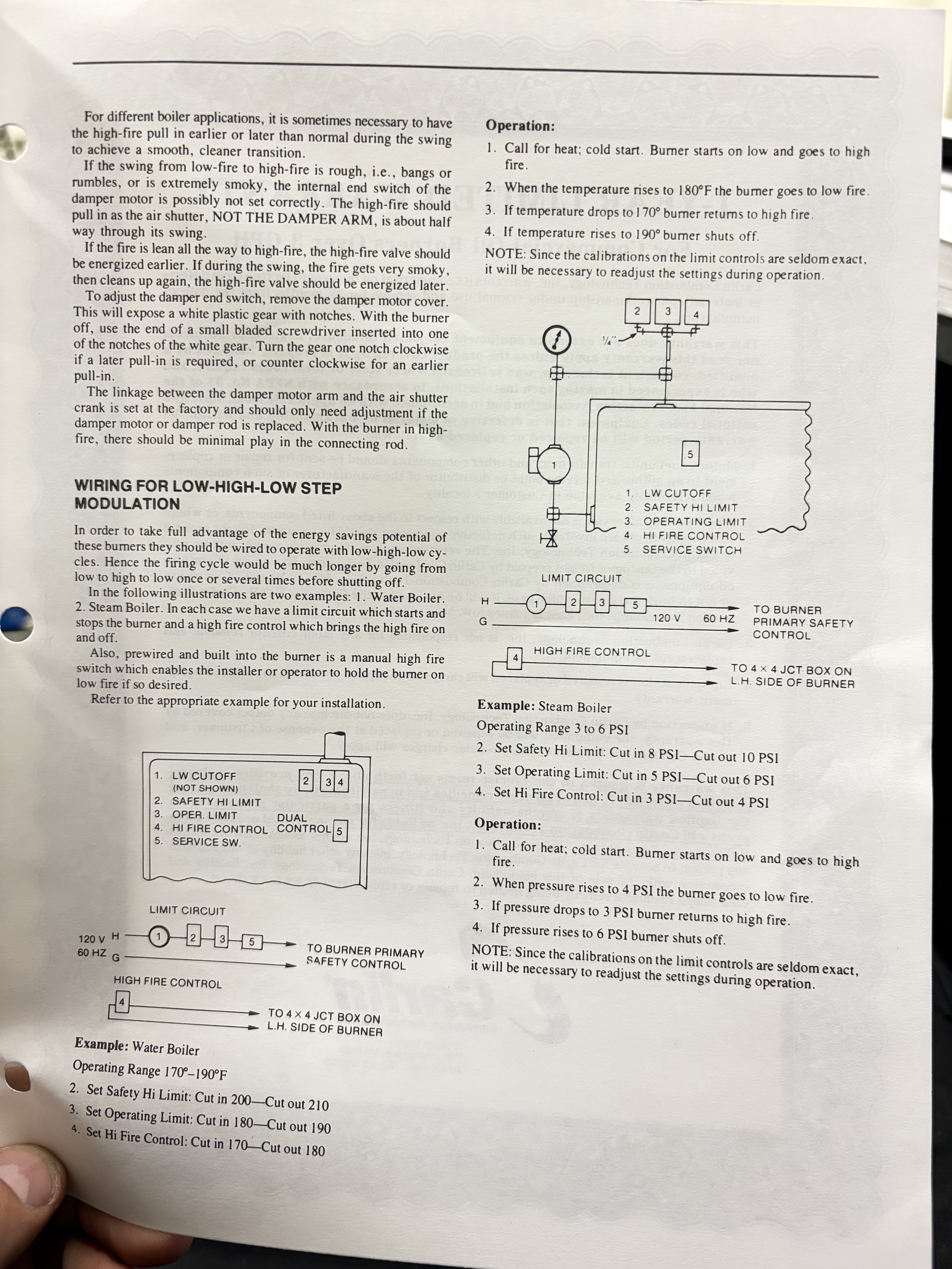

    Your burner I think has lo-hi fire but no pressure control to operate that. I think you only have a manual switch on the burner Junction Box.
    Correct me if I am wrong.
    My thought was to kill two birds with one stone. Use the existing HL as a Hi-lo fire control and put a new HL (Man reset) on to upgrade the controls. Then when the burner fires it will run on low fire and only go to high fire if it can't maintain steam pressure on low fire.
    Hootie
  • I love this idea, and I appreciate the feedback. I put in a quote from Grainger for that manual reset, also a new PA404A Ptrol and separate pigtails, as well as a 0-5 psi gauge. I'm hoping one of the old 404 units is still salvageable for the Hi-lo, because that would be ideal.
    @Hootie Run 2 wires (line voltage) from the lo-hi fire pressure control to the burner junction box. Put the pressure control in series with the toggle switch. If either the control or the switch is open the burner stays on low fire.
    If you keep the switch open (low fire) the burner will only run in low fire. If you want auto lo-high fire turn the switch to on (up)

    @EBEBRATT-Ed look what I found in the file cabinet! Good call 😁
