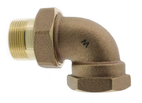

Does anyone know where I could get one of these in 1-1/2"? I found a Watts one but the largest size available is 1-1/4.
Thank you in advance.

    Try FW Webb.

    That would be a monster radiator that would need 1.5" worth of flow.

    It might be easiest to just get another 1 1/2" valve to do the job in the place of the 90 ell.
    We assume that this is hot water…..not steam?

    Or an 11/2 street 90, a union, and a close nipple if there is room, as these fittings are more readily available.

    I looked in my stock, have 6 threaded 1-1/4 radiator els. Usually had a couple 1-1/2" but all gone. As others said, probably best just to install a valve in its place as they are readily available.
