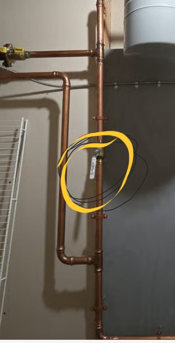

We bought the house which had UFH and its about 20 years. But funny the previous owner they didnt try to turn it on so when we moved in, found out so many missing parts to make it works. Got contractor came in and installed parts but funny he disappeared, no answer from us when we calls or messages

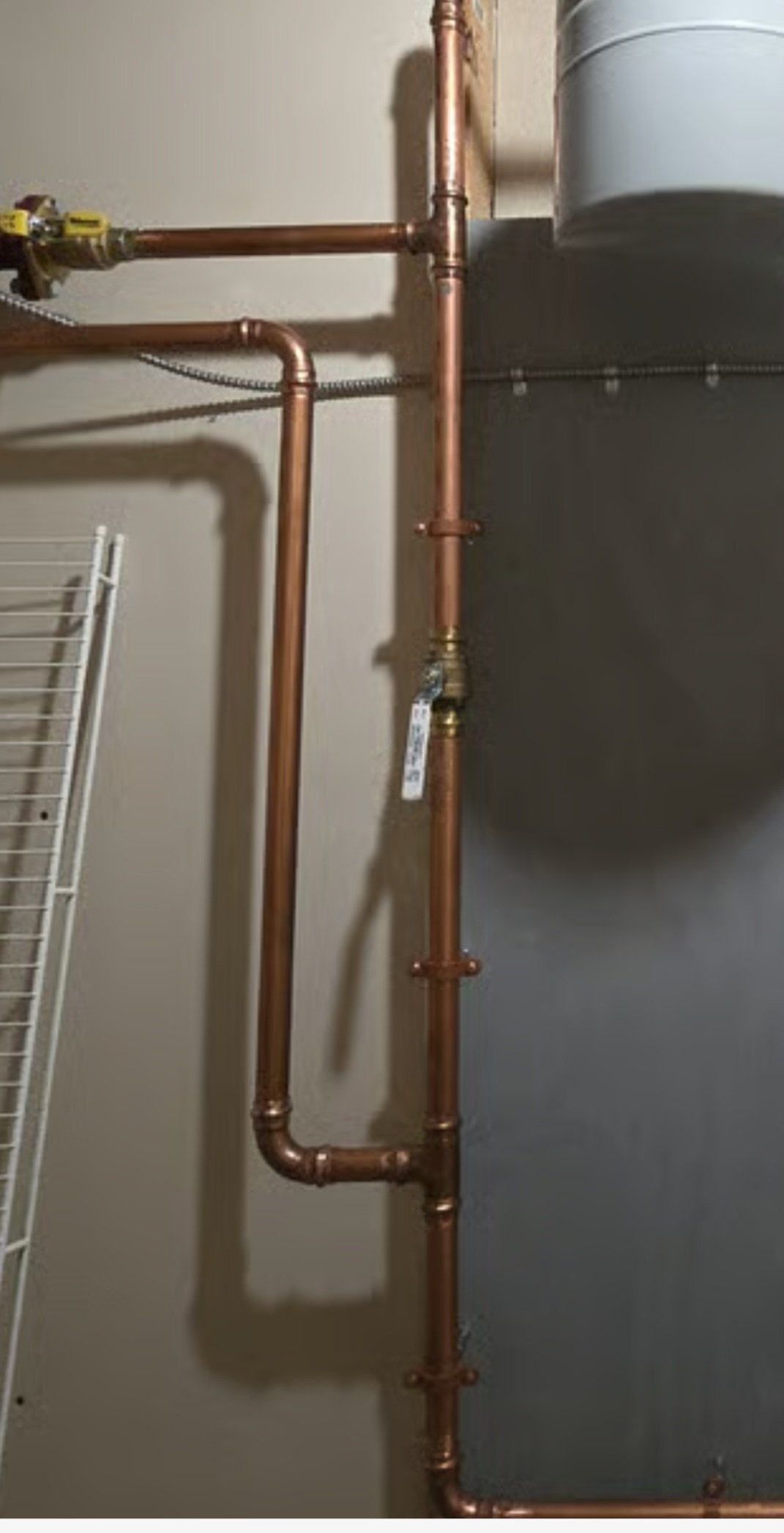

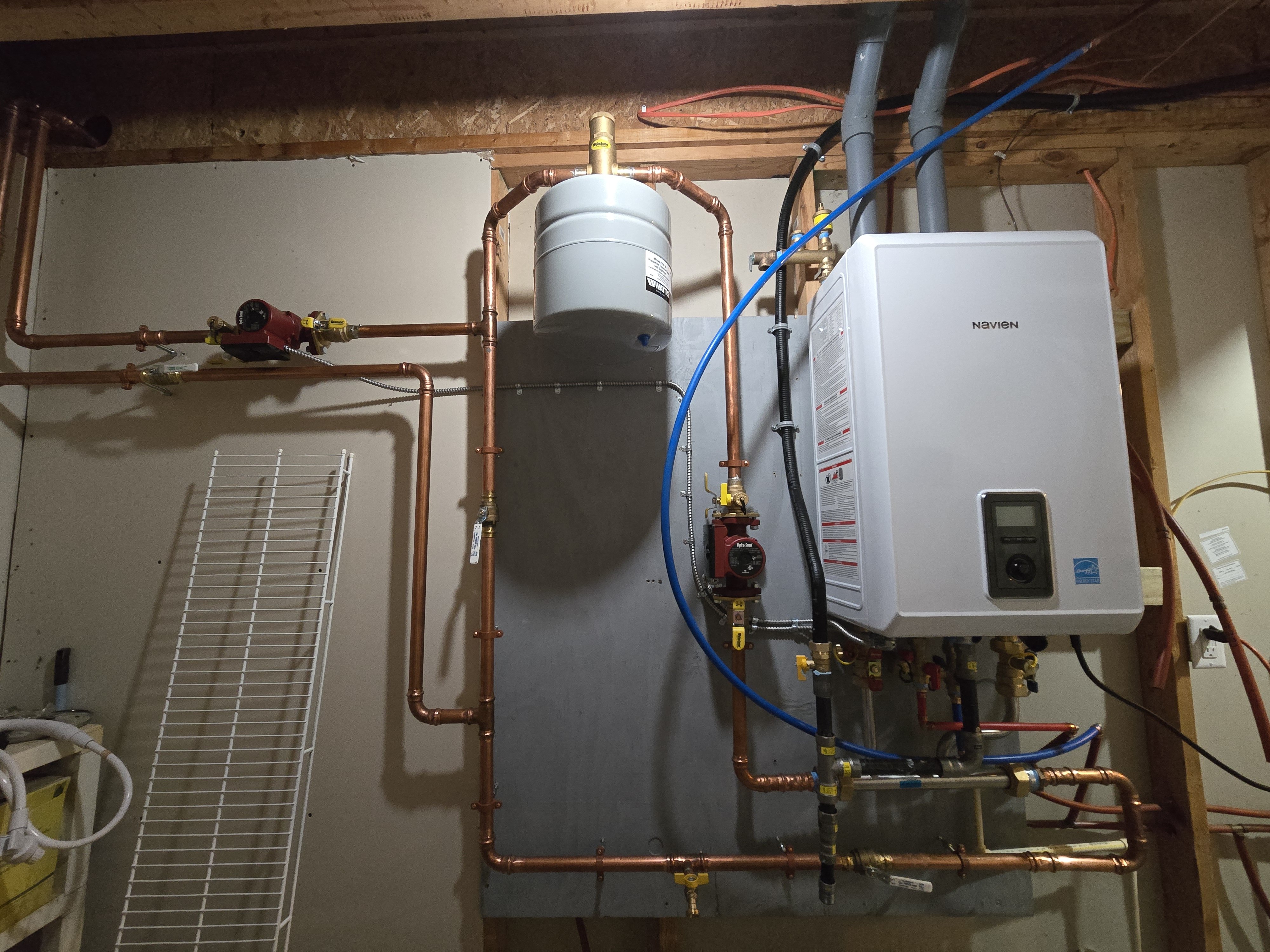

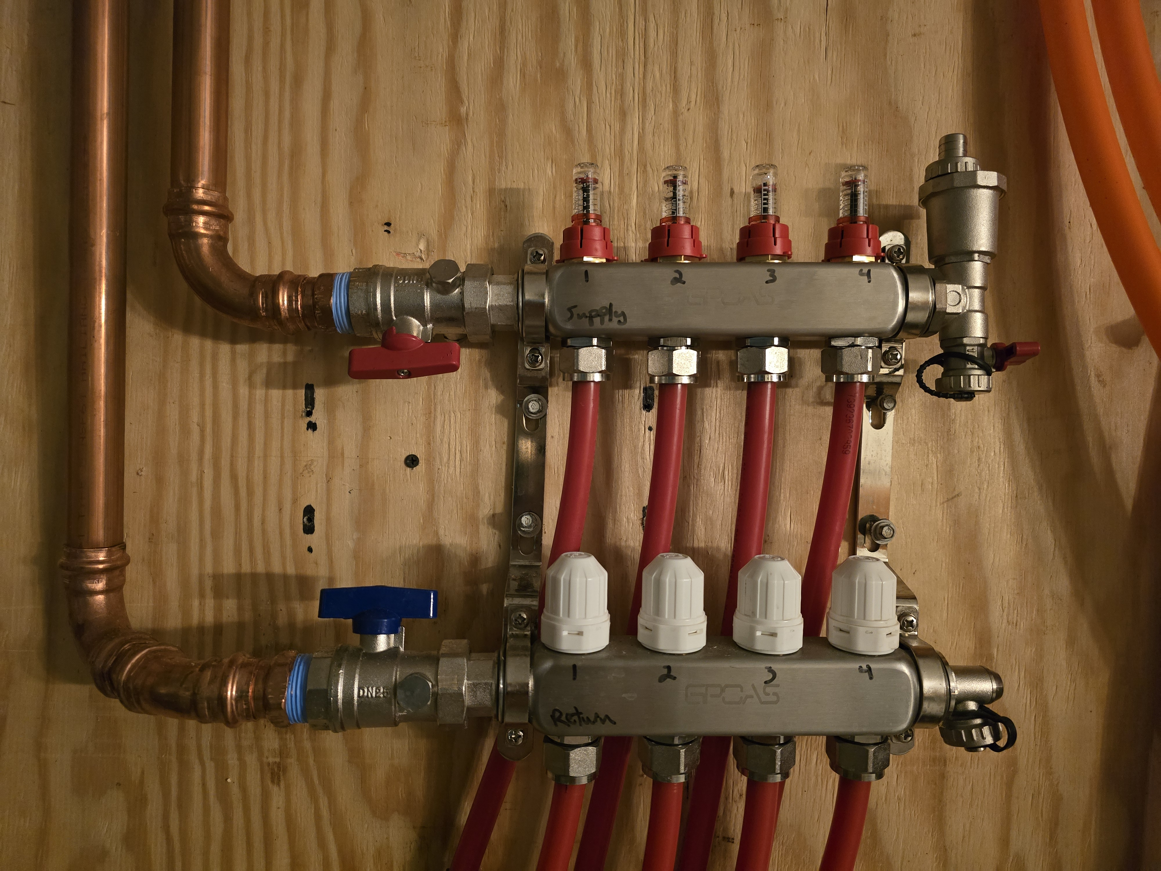

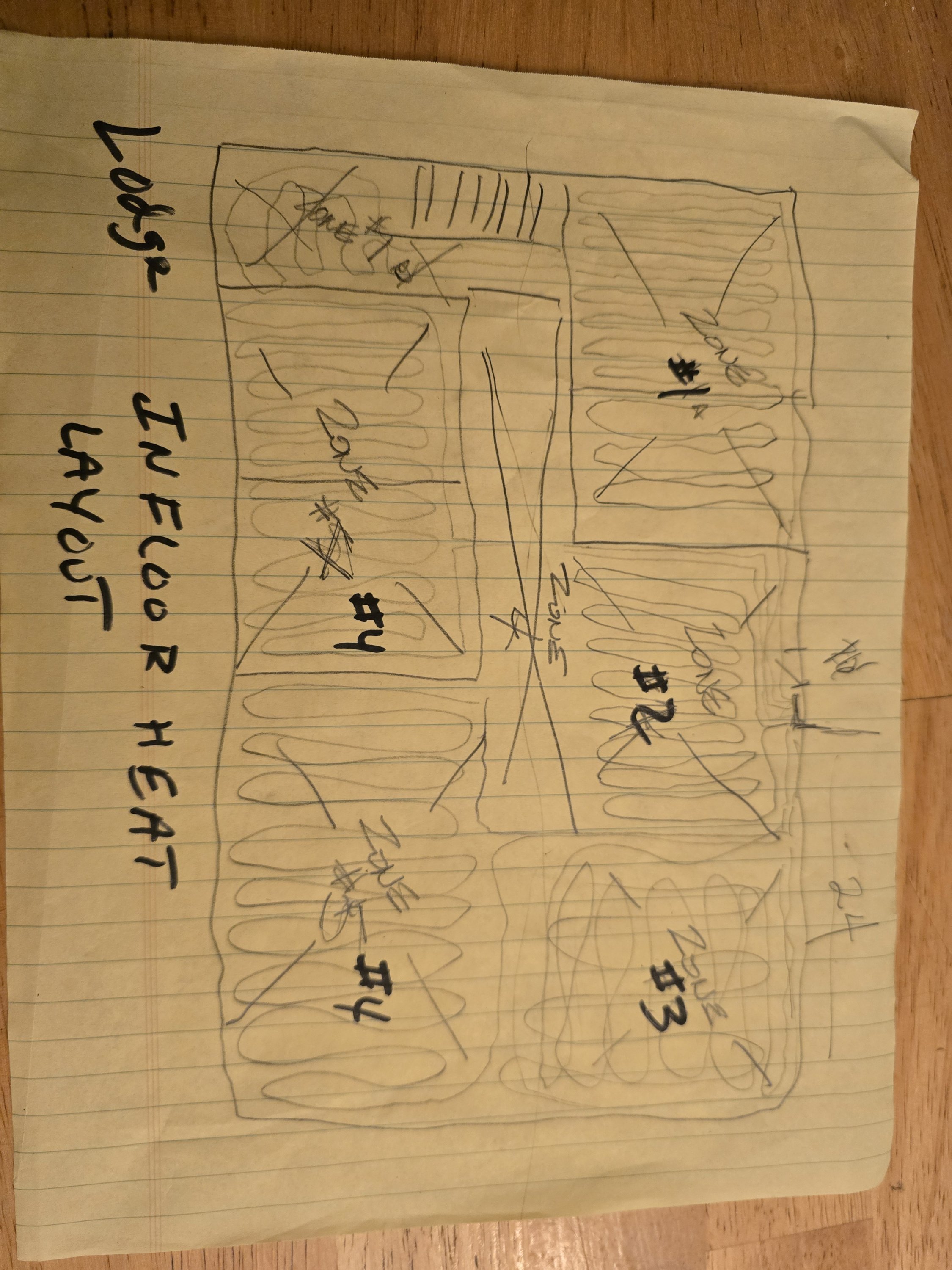

Here is some pictures with the system. Zone 4 seems to big to run.
Question is how can we fix it, can we add more manifold to split zone 4 or something to make it works better?
Right now the outside temparature is 30 and the heat only up to 68 which is highest. We are in MN and soon we will down to -30F or more

    FYI you only have one zone, and the person who installed this did a poor job (piped wrong) but it should still work to some extent. What seems to be the actual problem? Also where in MN are you located?

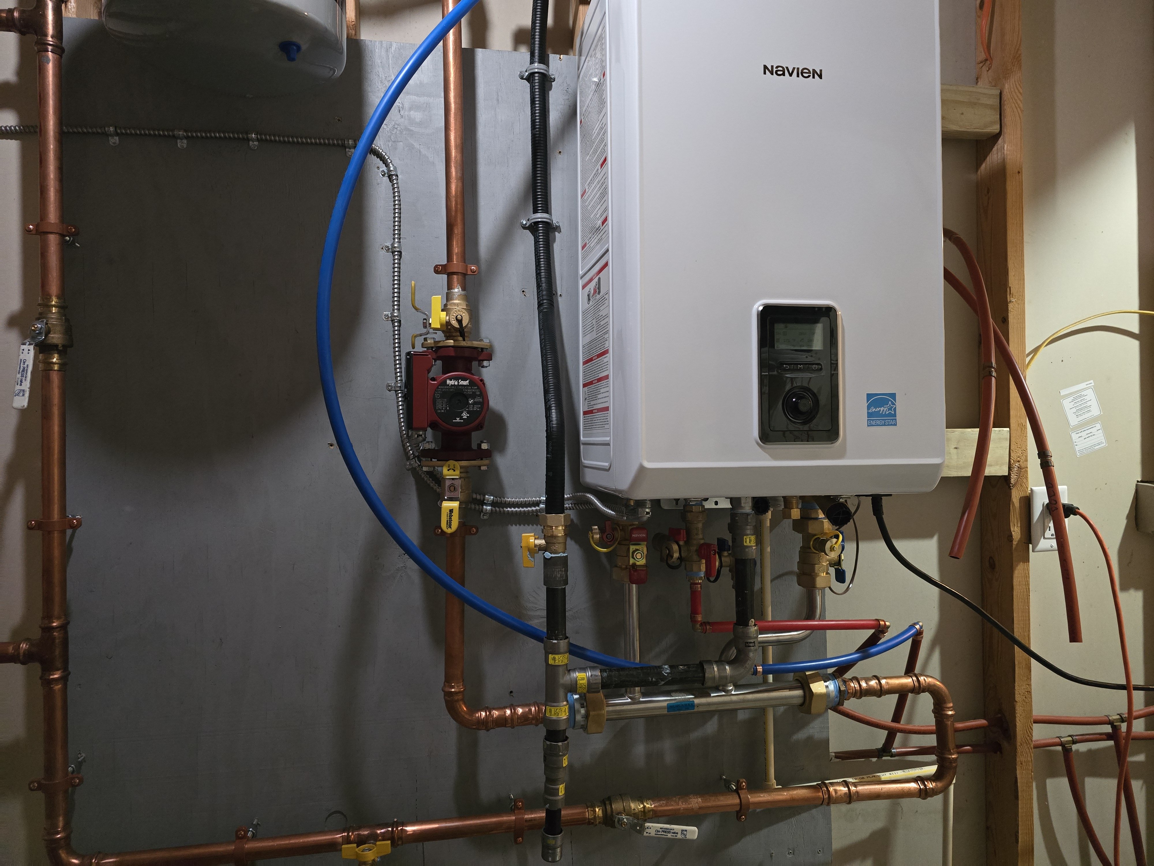

    @Hleight7, The circulator next to the boiler is pumping into the expansion tank. No good. Move the circulator to the return.

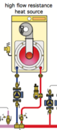

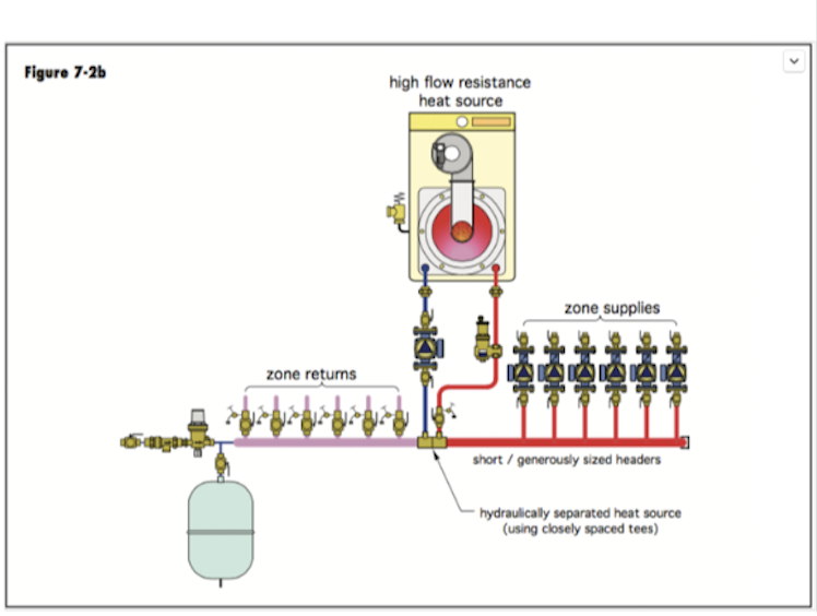

    Someone's attempt at injection pumping, but wrong. It needs to be closely spaced Tee's here.

    Closing the ball valve might help, but then you've got 2 circulators running in series. There's also an internal boiler circulator, so they might not all play nice together that way. How far away is the radiant manifold that an injection loop is needed?
    I also don't see an external Pressure Reducing Valve, and it looks like the port for the internal Pressure Reducing Valve is capped. So where do you add water to the boiler?

    And, Navien. Aside from that "Mrs. Lincoln" you need a down-pipe on your TPR valve.

    You have one two many circulators :)

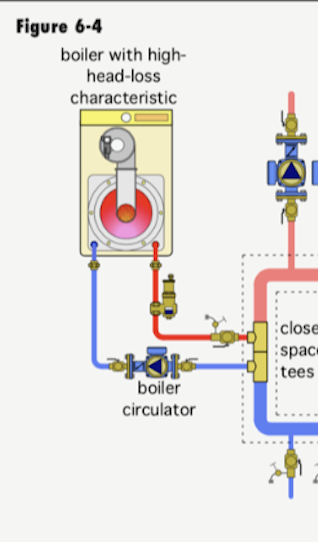

    Your boiler, a combi has one circ inside. These pics show an external boiler circ.
    It looks like the factory P/S header pipe under the boiler, that stainless steel pipe. If so this piping is what works, just the a single pump version off that header. This pic happens to be a multi zoned pump system.
    Or a U shaped version, lower pic
    This shows closely spaced tees where you have a header pipe
    A fairly easy piping fix.
    A discharge pipe to the floor from this relief valve, please. as @psb75 mentioned

  • The living total is 3900 sf. 6 bedrooms at 2 level. Somehow we think its not enough to cover whole house

    Yes and you can eliminate one of the pumps there as well. The only pump you need there is the one that runs when any zones call for heat. The boiler circ is built into the boiler.
  • Ok i closed that one and turn the pump to Lo which connected to expansion tank. 1 hour is nothing but at least temperature didnt drop.
    I will wait and see if can gain any degree or not
    Thank you
  • Still dont see how to addd water pressure to the system. if the system has not operated for many years, there is air in the tubes most likely. You will need to get that air out and and to do that you need to add water pressure. Up to about 20 - 24 PSI water pressure to purge air out. then put boiler pressure back to 12 PSI after all the air is out. Your professional needsa to figure that out for you.

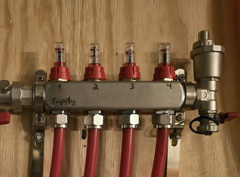

    What flow are you now seeing on the indicators on each zone on the manifold? What is the supply and return temp and fire rate your modcon is reporting?

  • I closed that valve and somehow it only warm loop 1 and 2
    3, 4 are cold and tempeture down to 61

    What are these gauges reading when the system runs?
    Your emitters could be air bound.
  • I just got off the phone with the Warwas heating and cooling owner.  It appears that you purchased a new Nevian Combi and it is operating as expected.  Some of the space heating loops are operating. However, the radiant floor heating loops are not properly installed.  From what I have heard from the installing contractor, the previous owner of your home installed the tubing himself.  He used a non-oxygen barrier ¾” PEX tubing, and there is no way to determine where each loop goes or how long each loop is.   As a result of all his efforts the contractor has determined that there is no way to make that floor heat operational.  He sounds knowledgeable and I believe him at this point.
    If I were in your situation, purchasing a home that did not have an operational heating system I would check with a real estate lawyer to see what your options are regarding this situation.  I don't really see how the contractor (or any contractor) could do anything to make that tubing operational for you.
    Second, now that you own a home without an operational heating system the easiest way to make that new boiler heat your home is to install 2 zones of Copper tube Alum fin baseboard in that home.  The heater is large enough to heat your home if you have the proper heat emitters.  This would mean abandoning the floor heat system completely.   I hope this helps you to understand what you have gotten yourself into.

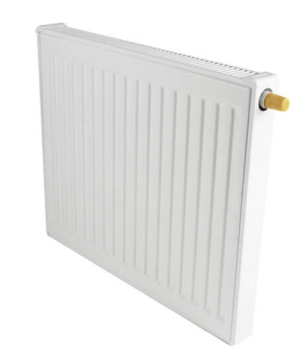

    If you do end up adding supplemental heat, consider panel radiators. The behave more like a radiant system, and generally use lower water temperature.
    With a condensing boiler you want to avoid high temperature fin tube type. Although there are high output versions.
    Panel radiators are radiant and some convection heat transfer.

  • If we install that panel radiator. Could you tell how much for 4000 sq ft?

    Panel radiators will be a better system however it will me more expensive than baseboard.

    do you have areas that don’t heat at all? Or areas that will not keep up with the thermostat but get some heat.
    Ideally a room by room heat load calculation would indicate what every room requires
    either add a radiator for the entire load, or some smaller ones to “help” the radiant
    Either you or a competent designer needs to do the calculations.
    you have seen the results of not doing a proper design.
    Since you have a new boiler I would stick with a hydronic solution
    It may be time to think about abandoning the radiant and installing a new radiator system
    Boots on the ground would be helpful to see how feasible that is
    Those 3/4” tube systems are not often a good match for residential systems. Wide spacing and long loop lengths are not ideal
