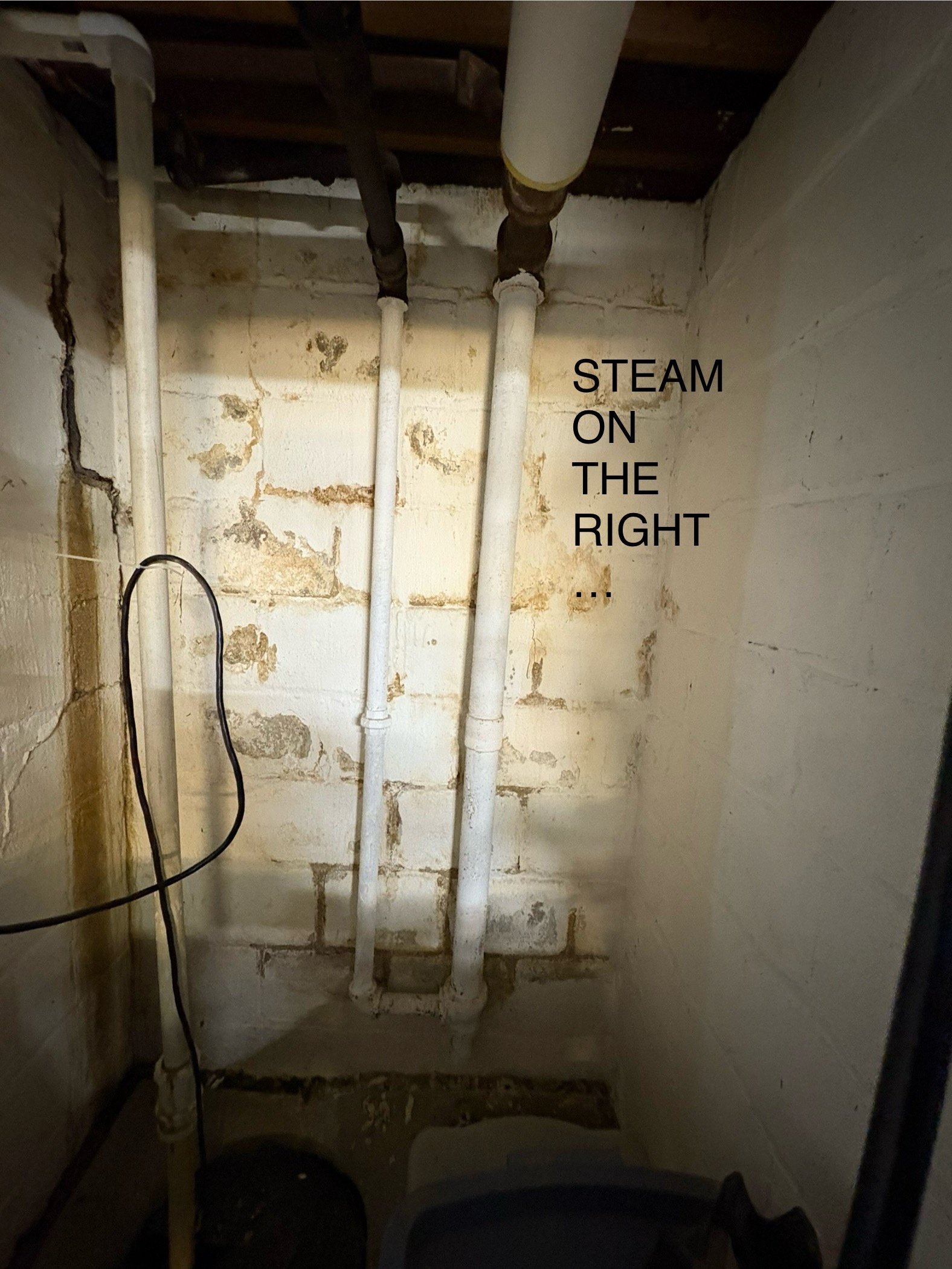

Is this where main steam line is vented to the dry return? After nearly 100 years, should the nipple leg be taken off and let come out what may?

    is that a capped nipple at the bottom of the right 90, or does that go thru the wall as a wet return?

    Yes… but. It is very likely that at one time at the top of that arrangement there was a crossover trap — a simple radiator trap, but connected starting at the steam main with a short nipple up, then a 90 and a nipple to the INLET of the trap, with the outlet of the trap going straight down through a nipple to the dry return. Air went through the trap, and condensate went down the water seal loop and made its way back to the dry return..
    Steamhead Posts: 19,007
    That might be a Tudor system. Go here for some illustrations of how that loop seal fits into the system:
    https://www.heatinghelp.com/systems-help-center/european-heating-systems-circa-1907/
