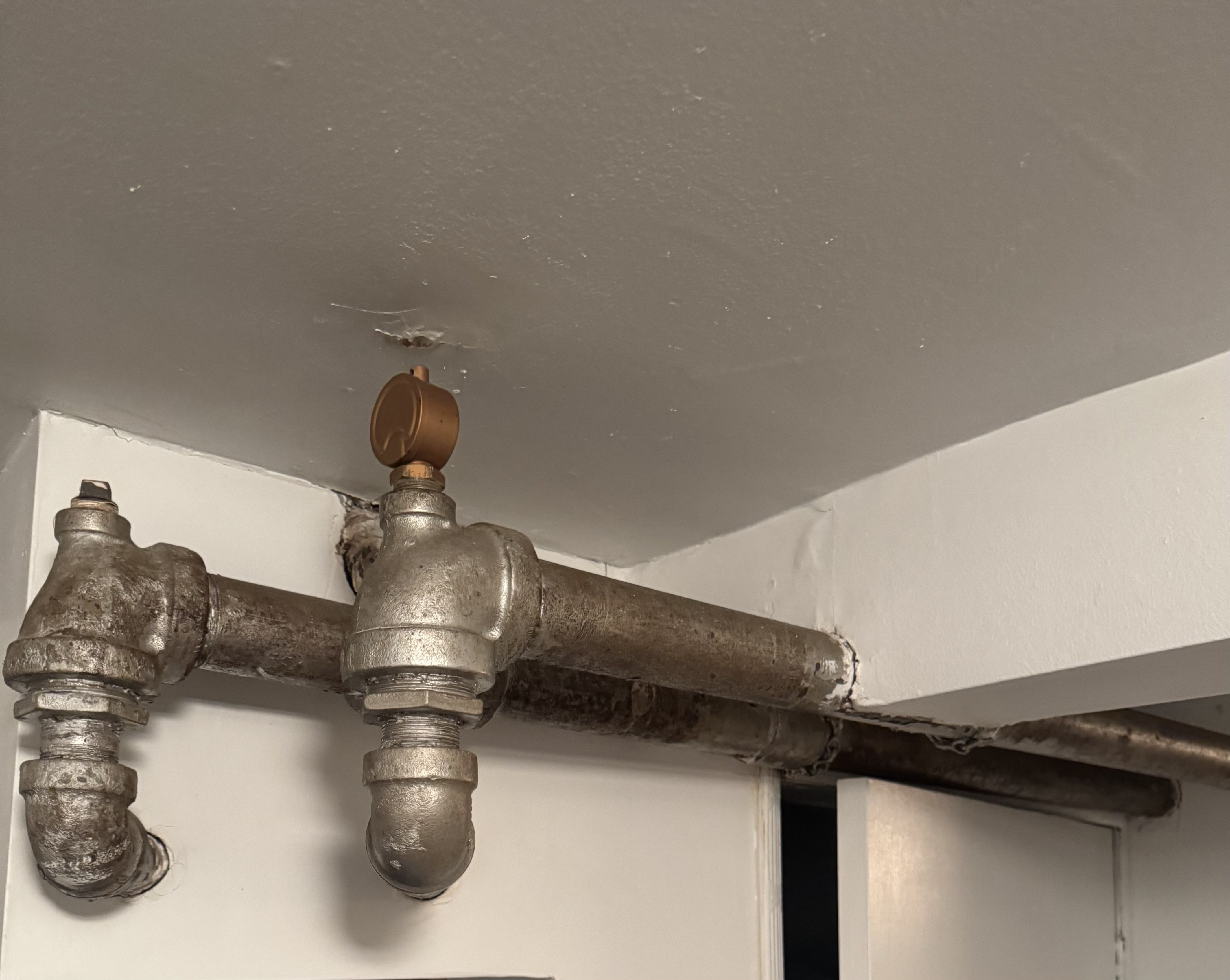

    @EBEBRATT-Ed could I install a vacuum breaker if I were to add an antler where the vent is in the photo, with the breaker and the vent next to each other?
    I was also previously advised to replace this maid o mist #1 vent with a gorton #2. Could that also help with the noise since it would be a larger vent?

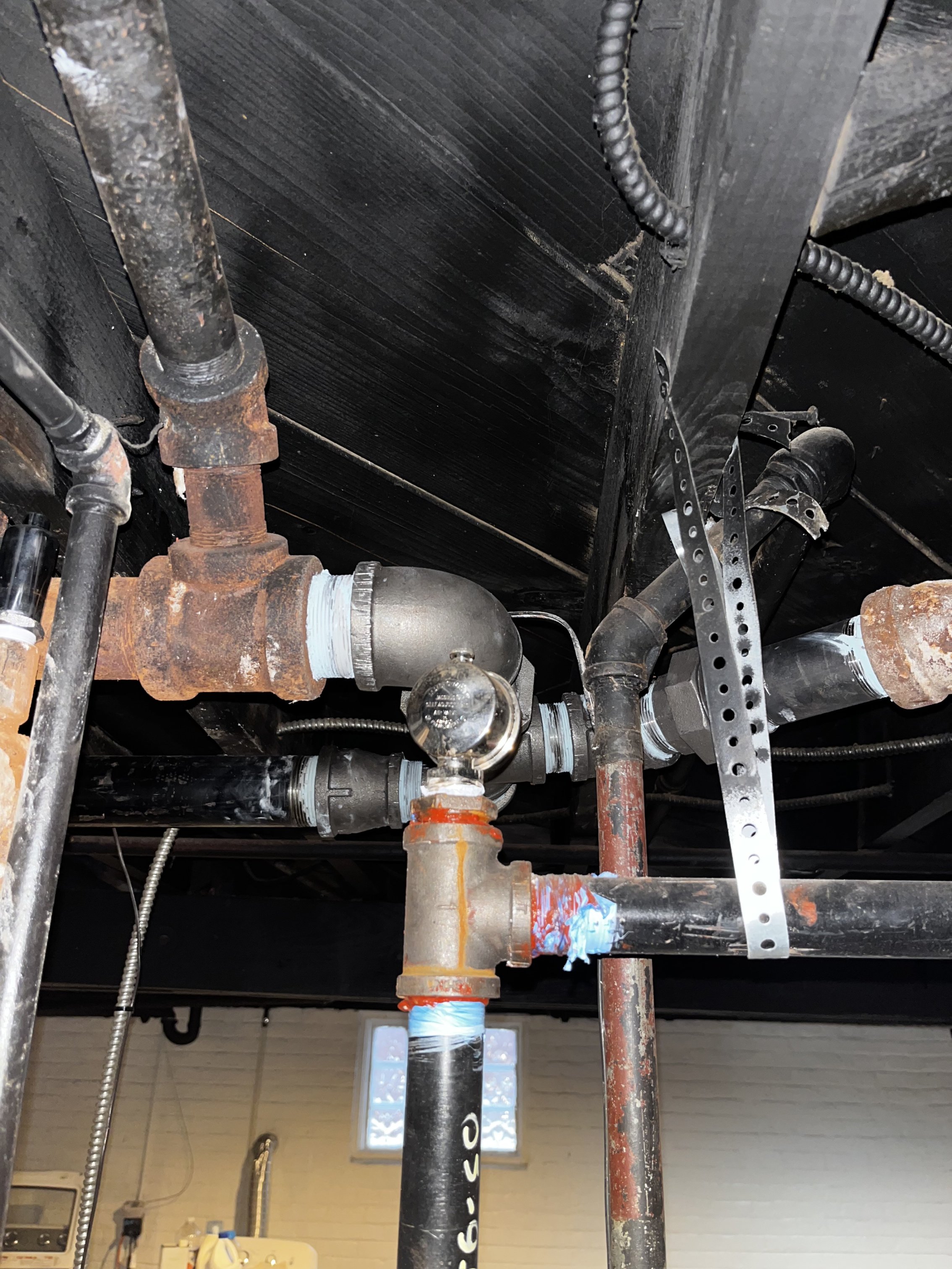

    So I actually stood near my long main and it’s not hissing it’s definitely sucking air in when boiler gets turned off. Here is photo of long main
    Have it in a livable basement 0-30 gauge usually goes from 2-4
    Not sure how reliable it is

    HotRod1975, If you can see the 30 psi gauge move, your pressure is most likely too high. The Gorton #1s will tend to behave that way when the pressure is around 3 psi or above. You need to determine the pressure with a 0 to 5 psi gauge. Then determine if the vent is closing due to pressure not temperature.

    A vacuum breaker can be anywhere on the system above the boiler waterline. The higher the better. You do need to check the pressure as that vent looks like it has been leaking. Raise the vent on a longer nipple as high as possible.
