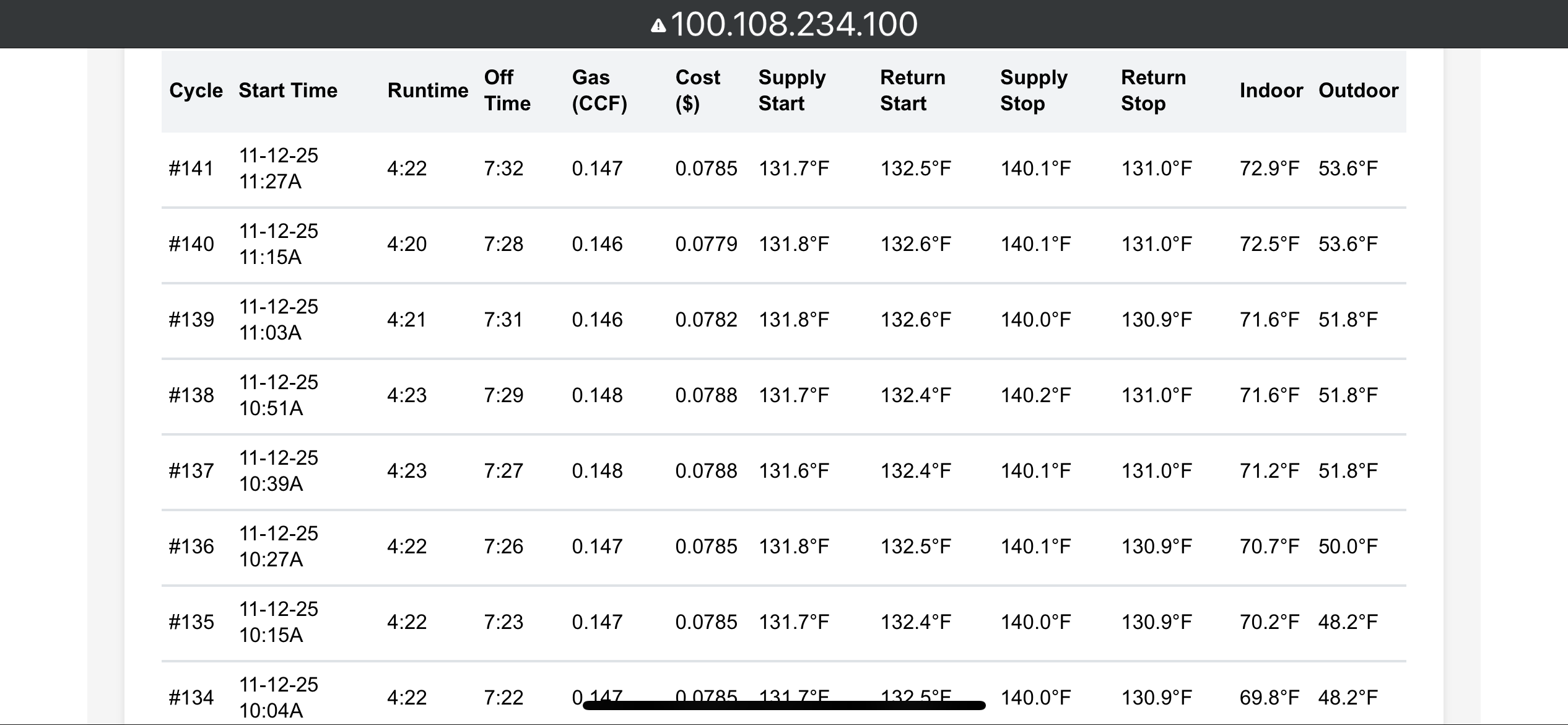

On my journey to increase my understanding of hydronic heating (thank you @EdTheHeaterMan and many others), I put my "nerd hat" on and developed a little project to show me the boiler statistics via a simple webpage.
I have a older WM CG8 and a TekMar 256.
I didn't want to touch any of the wiring and instead use simple sensors safely attached to various parts of the boiler to capture when the flu damper opens, supply and return temps, outside and inside temps. I used a small camera to capture a pic of the Tridicator, also.
I had fun developing this and learned a bunch about what is actually happening during the heating cycle.
DOY Boiler Monitor.png There was an error displaying this embed.

    Great info! Clever data collection methods
    6 minute run times are fairly short. Probably mild season loads?
    With run time and off time.
    6 minutes on, 11 minutes off, total elapsed time= 17 minutes
    6/17= .352 run fraction 35.2%
    So running about 80% cycle efficiency

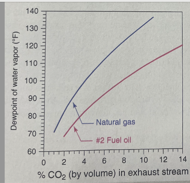

    I'd like to see the return up around 140F at shutdown. If you could get a CO2 reading you could determine if the boiler is still condensing when it shuts off. Or the flue is still sweating?

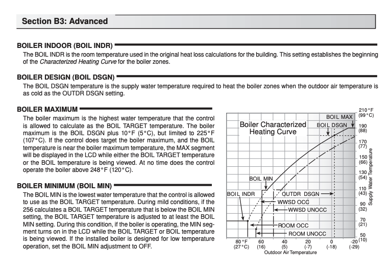

    With a cast boiler you might bump the min. on the tekmar. Are you using a return sensor? You are limited on reset temperatures with a cast boiler might not do a wide reset with a cast boiler

    Thank you, @hot_rod ! This is very helpful! The tridicator guage and the supply/return sensors from my project differ. Not sure which one to believe. Need to test more. Curious if you all know if the tridicator guage on this model boiler is a easy swap or does the boiler have to be drained?
    The TekMar uses the pipe sensor and is reading similar to the project sensors.
    As far as the run cycles, I agree. I initially had the TekMar 256 in the auto-differential mode but the cycles were very short. I changed the differential to 15 and this is the result. Based on recommendations here, I should be considering a 20 degree delta. If I did indeed change the differential to 20 instead of 15 and bumped up the min from 140 to 145 this would equal better results?
    I've not noticed any condensation. Not able to test the CO. It's quite cold yesterday and today. I would think these results are a good representation of the current conditions.

    The manual for the Weil GC indicates return 130 or above. I didn’t see a CO2, 8.2- 10.2 is a common range

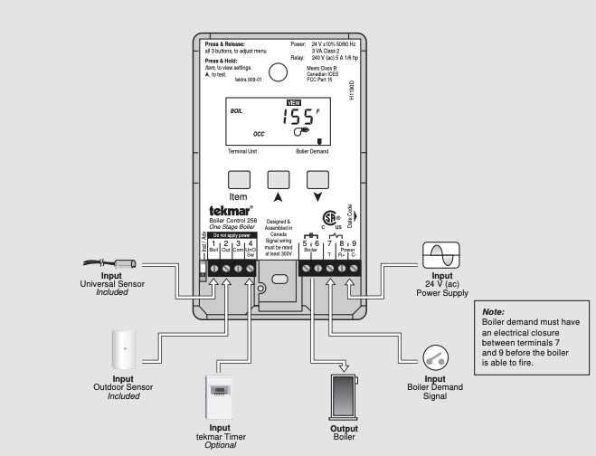

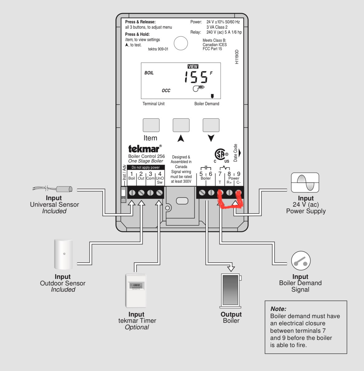

    I noticed that there is a jumper between terminals 7(T) and 9 (C-) on the Tekmar 256.
    Is this standard practice?
    hot_rod Member Posts: 27,904
    @24 VAC goes on 8 &9 this powers the control
    7 & 9 enables the boiler to fire.
    Sometimes zone valves or a relay contact connect to the "input" so the boiler only fires on a heat call. Seems like your boiler is always hot with that jumpered?

    No, the boiler is not firing all the time.
    The boiler cycles (although as you’ve pointed out, short cycles).
    Is this something the installer would have chosen in absence of a thermostat?
    There are any number of ways to wire that demand.
    On a single zone system the thermostat could wire there. With multiple zones typically a relay on the zone control box would wire there. It could be a seasonal wall switch. An outdoor temperature control. Or it could be jumped for a permanent "call"
    The manual refers to a switching "device" the installer makes the determination what the device is.
    It's possible another control is calling on the boiler, not the 256? We would need to see the control logic drawing.
