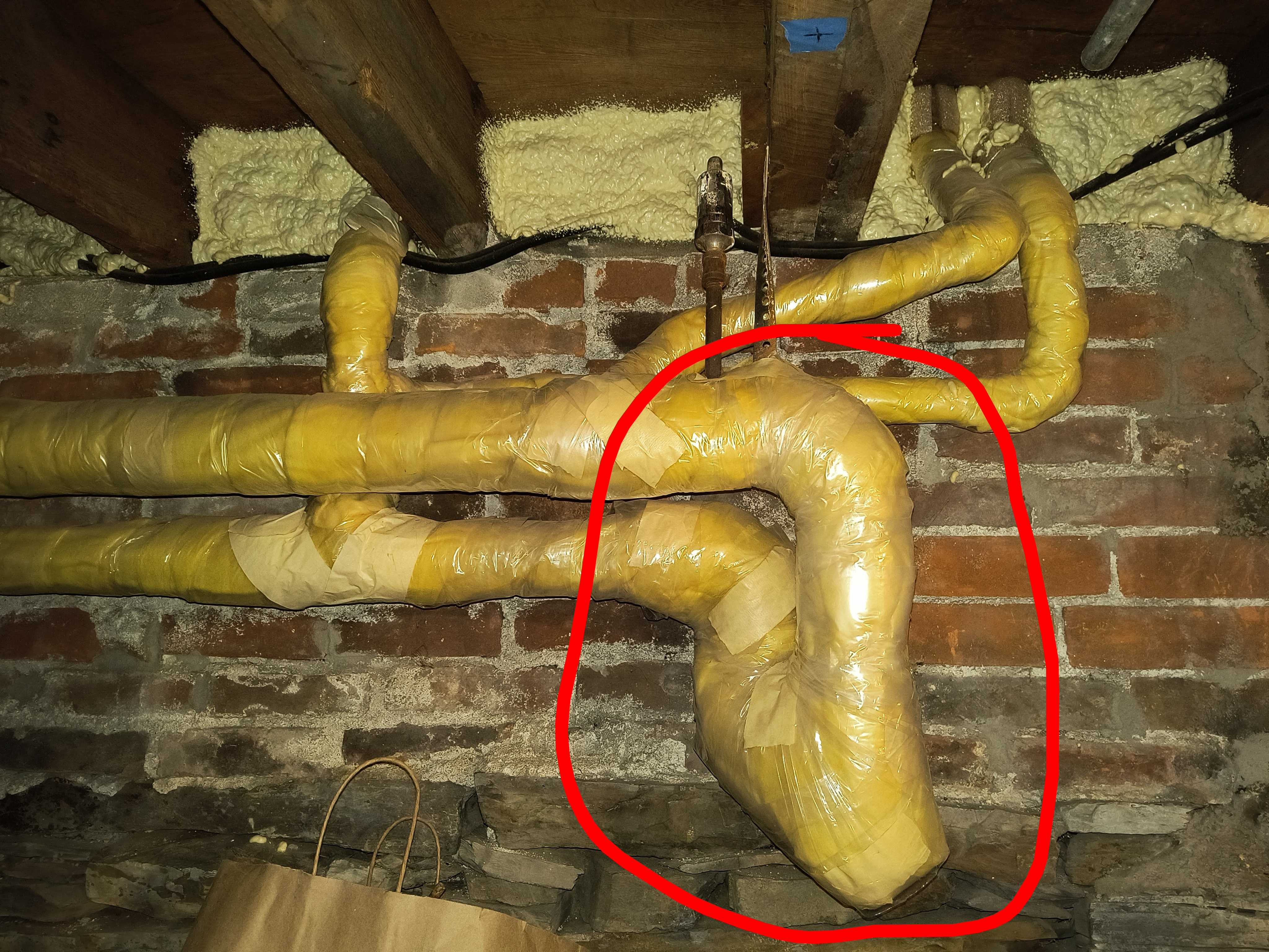

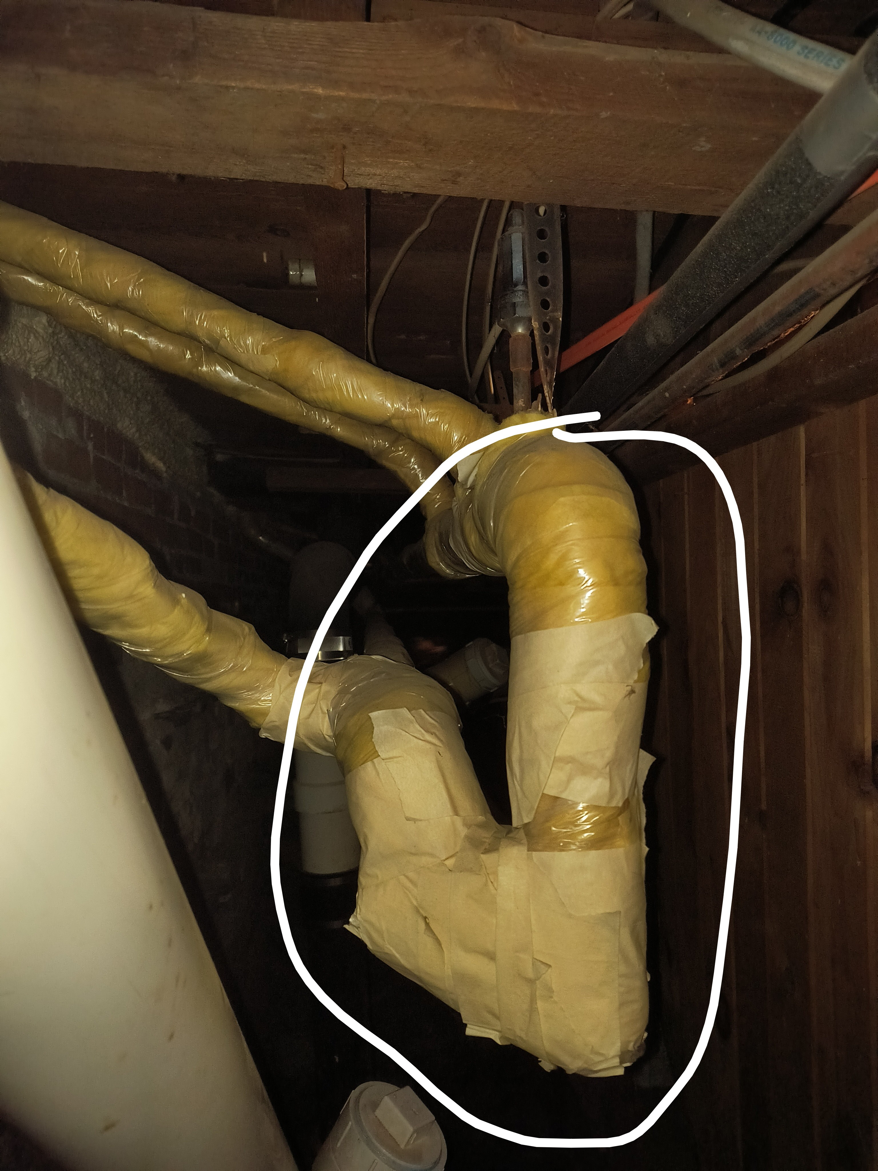

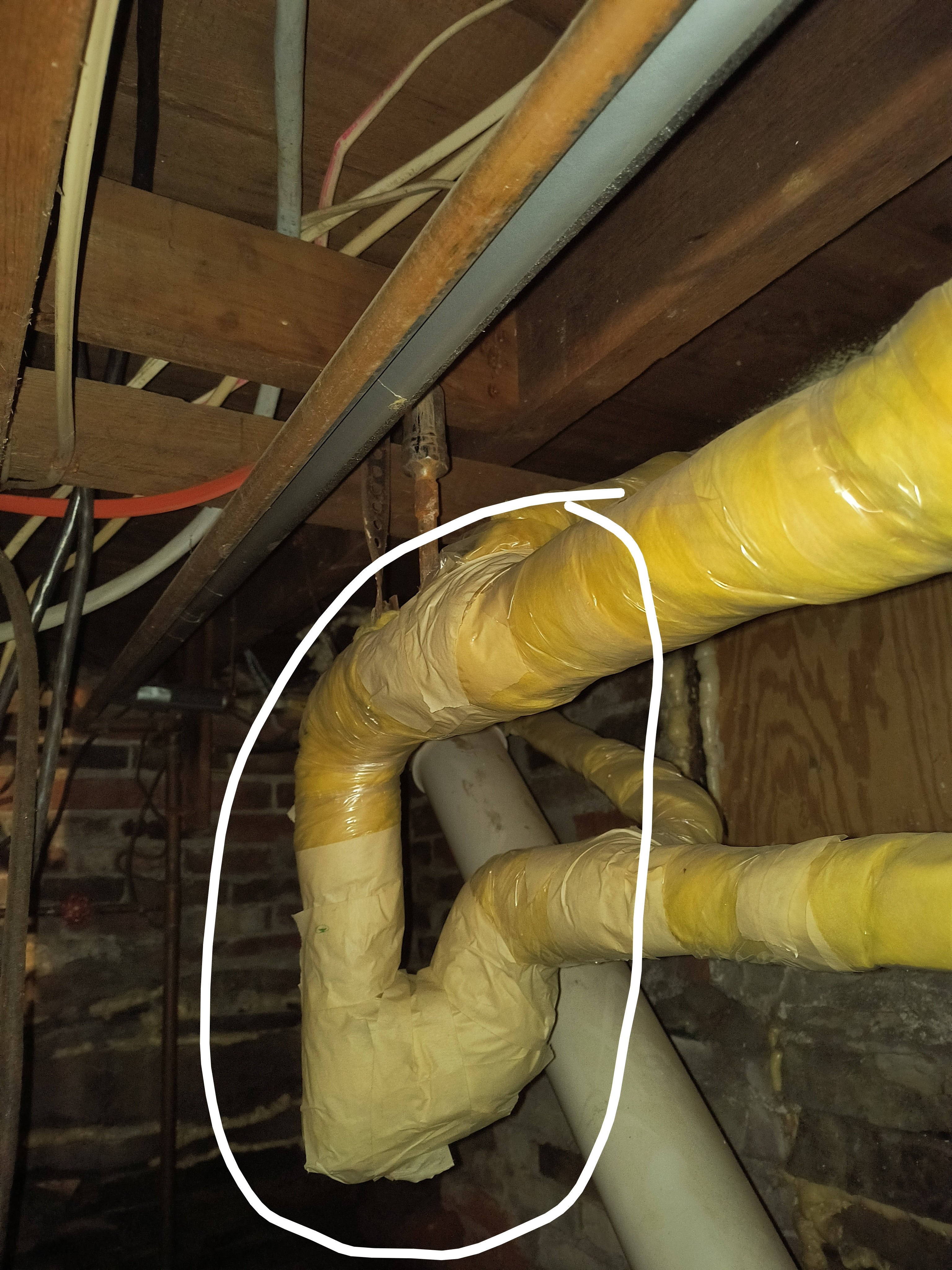

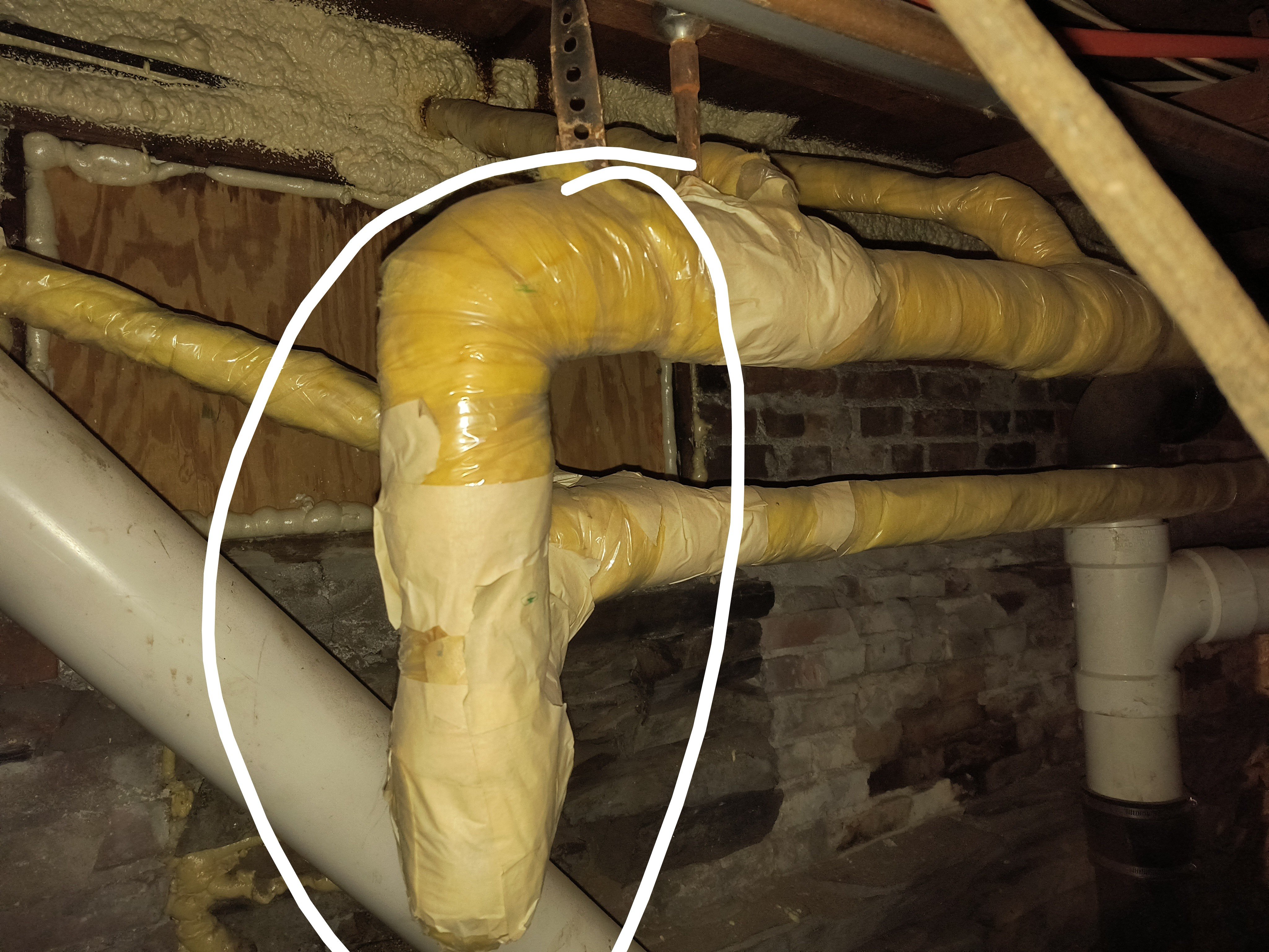

I've learned a lot reading many of the posts on this forum, thank you all for your contributions.
I insulated all the pipes in my basement in 2019 and did not take any good photos before then. A photo below is blurry and shows the loop\dip of my 52' long line (Main + this 'U' + Return). Another photo also circles the U in red and is after I insulated. Three photos show my 81' long line's U circled in white.
Are these 'U's called water\wet seals?, or traps? If there is water in it, how is it not a cause of water hammer since I've read over and over that steam colliding with water causes water hammer?
My system is experiencing water hammer ("mid-cycle" I believe) only on the 81' line, not the 52' line, and I have hope that that will be fixed after I properly pitch the pipes, then increase the venting. Presently, the 81' line has a Dole 3B at the end of its Main and a B&J\VentRite 86D at the end of its Dry Return, and the 52' line has a Dole 3B at the end of its Main and a VentRite 35 at the end of its Dry Return.
Back to the U: are there any components in the U?, or is it merely pipes and fittings? Is there any servicing I should to do to it? If requested, I will take off the insulation and show a better photo.
The 81' line has 5 two pipe convectors and 1 one pipe convector which is in a renter's room, so I'll need to coordinate with them to see if the 1-piper has its own vent.

    Those are nowhere near deep enough to be water seals — water seals must drop at least 28 inches per psi differential working pressure in the system.
    Are they just a plain loop, or is there by any chance a thermostatic trap buried in there?
    EBEBRATT-Ed Member Posts: 20,144
    My questions are the same as @Jamie Hall a trap on that drip. Also the "return line" if thats what it si going off at a funny angle is that a radiator return? Rads 1 pipe or two pipe?
    Guess ing two pipe.

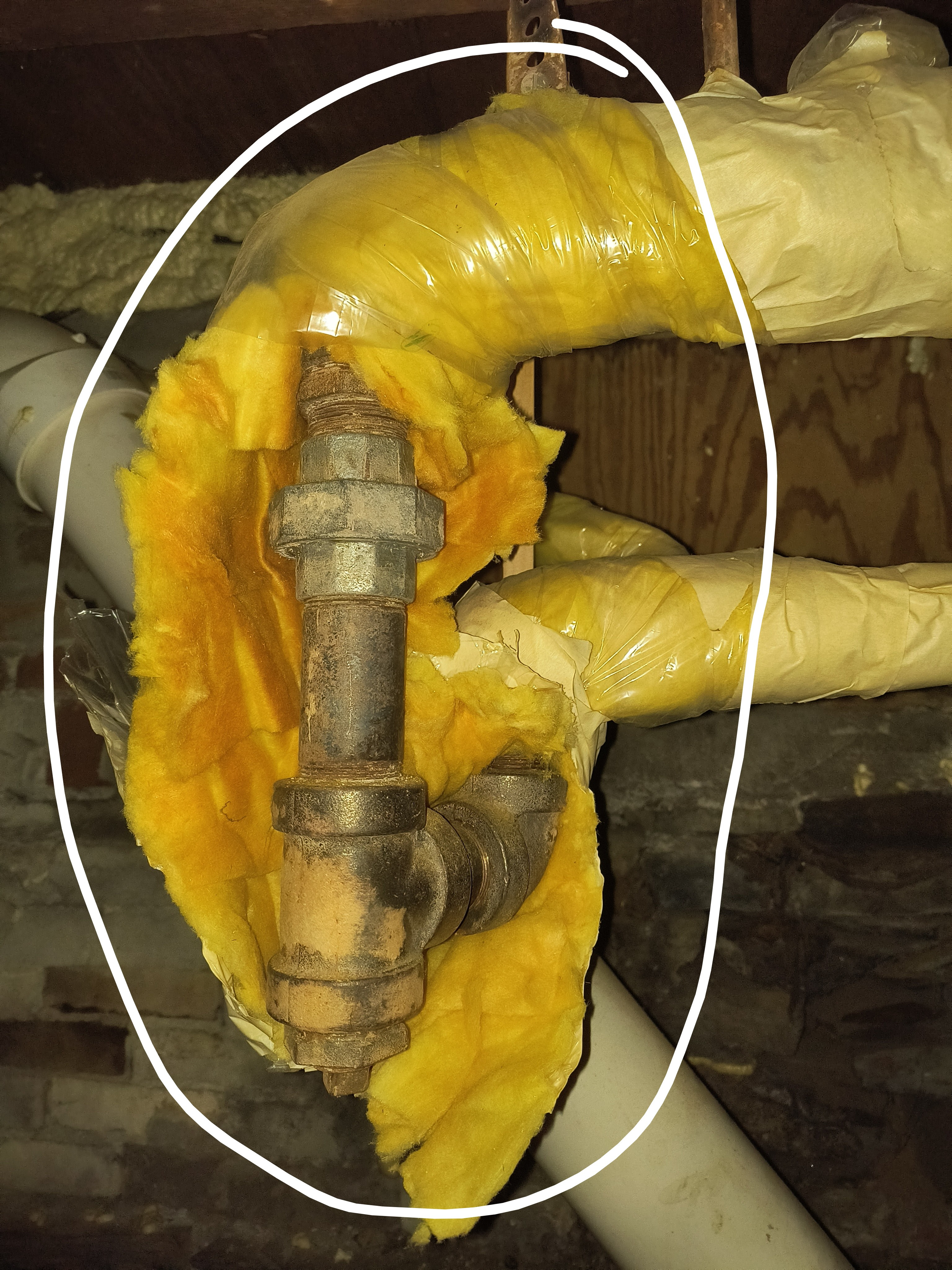

    Here's a photo of the 81' line's loop\U with the insulation cut open. Looks to me like all it is is a plain loop. There is a plug on the bottom (should I drain it sometimes?) and towards the top is a union (might this be useful when correcting the pitch of the main line and return line?).
    Ed, which photo are you referring to? The second red circled photo? Or the first, second, or third white circled photo? The 81' line (white circles) has 5 two pipe convectors and 1 one pipe convector. The 52' line (red circles) has 5 two pipe convectors.

    maybe that loop was far enough down with an old boiler with a much higher water line
    Steamhead Member Posts: 18,464
    edited November 2025
    Either that, or someone replaced wet returns with dry returns.
    @Tom8o , is there an air vent both before the loops (as I see in the pics) and at the end of the line where it drops to the boiler? If so, steam is probably pushing through the loops and banging as it tries to reach the end-of-main vents.

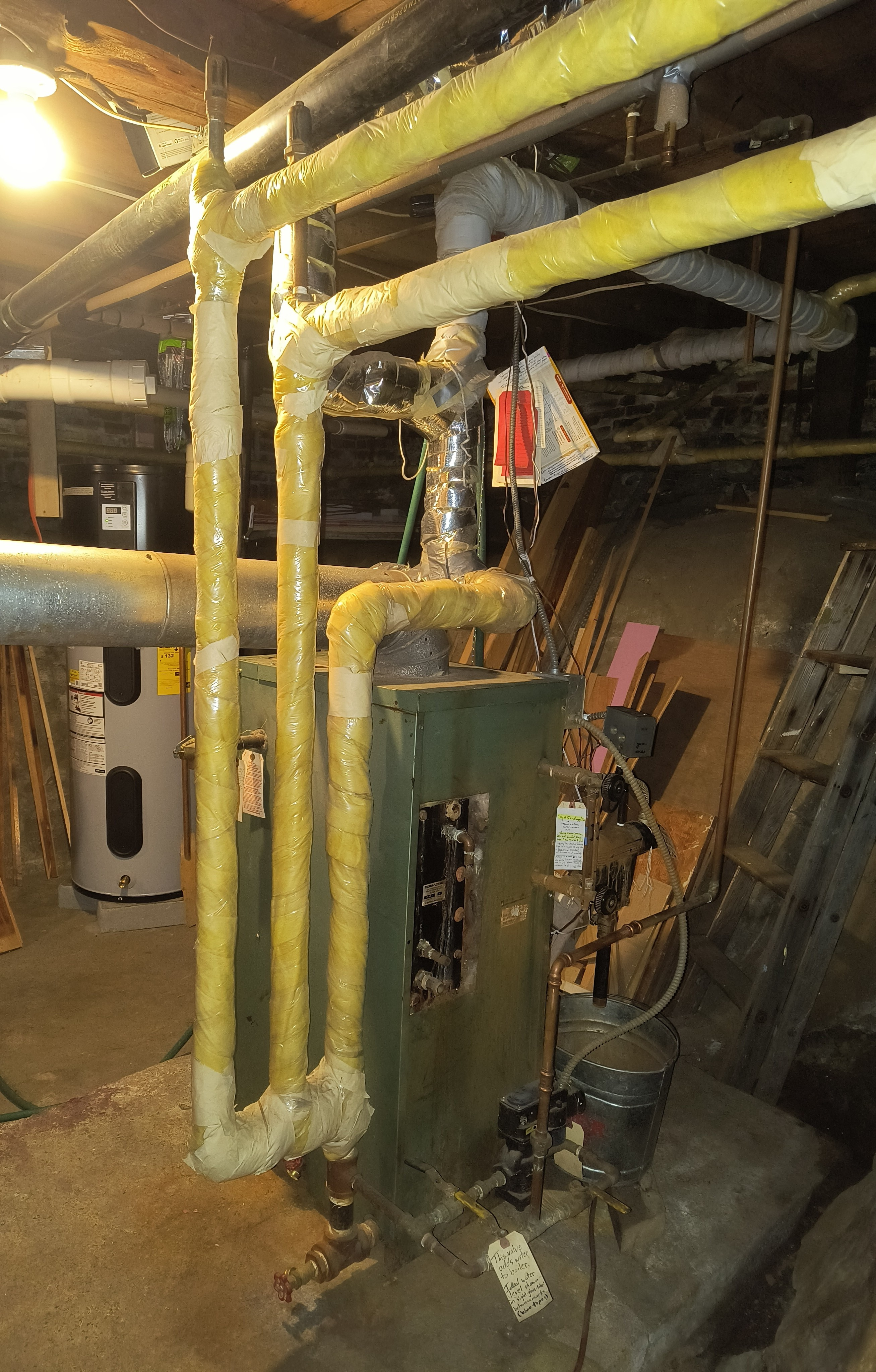

    I see vents on the dry returns at the boiler so unless that return drops down and becomes a wet return before the boiler, there is a second vent.
    Jamie Hall Member Posts: 27,318
    On your water hammer question — it isn't steam meeting water which makes the water hammer, it is moving steam encountering just enough water to make a nice wave and push it along until the wave meets an obstacle like an elbow or bullhead. Those U bends like won't hammer for one of two reasons: first, if there are no runouts downstream there's very little velocity so no hammer or, second and conversely if there is a big vent or radiator runout the steam velocity is high enough to effectively blow them dry.

    @Steamhead if someone replaced wet returns with dry returns, why not join the Main to the Dry Return with a simple bend (two 90° elbows with a nipple in-between)? Is there a usefulness to the dropdown-dip and the plug?
    @Steamhead yes, vents at both places on both the 81' & the 52' lines. The 81' line (white circles) has a Dole 3B (1\4"pipe) vent at the end of its Main before the loop\dip and a B&J\VentRite 86D (1\2"pipe) vent at the end of its Dry Return; and the 52' line (red circles) has a Dole 3B (1\4"pipe) vent at the end of its Main before the loop\dip and a VentRite 35 (1\2"pipe) vent at the end of its Dry Return. The 81' line bangs, the 52' line does not. For the 81' line, I have a Gorton D I'm going to add beside the Dole 3B. For the 52' line, I have a Gorton C I'm going to add beside the Dole 3B.
    @mattmia2 the Returns are both well above the boiler's water level. At the end of the Returns, where they have vents (shown in the boiler photo) and then drop down vertically, the bottom of the Returns' pipes are 31.5" above the boiler's water level.

    The water line in coal boilers was much higher than in modern boilers.
    The vent at the boiler shouldn't be doing anything but possibly acting as a vacuum breaker. but much larger vents at the end of the main and replace the vents at the boiler with a vacuum breaker or plug them. Right now the steam will try to push through the water seal until it can get to the vent at the boiler and close it.

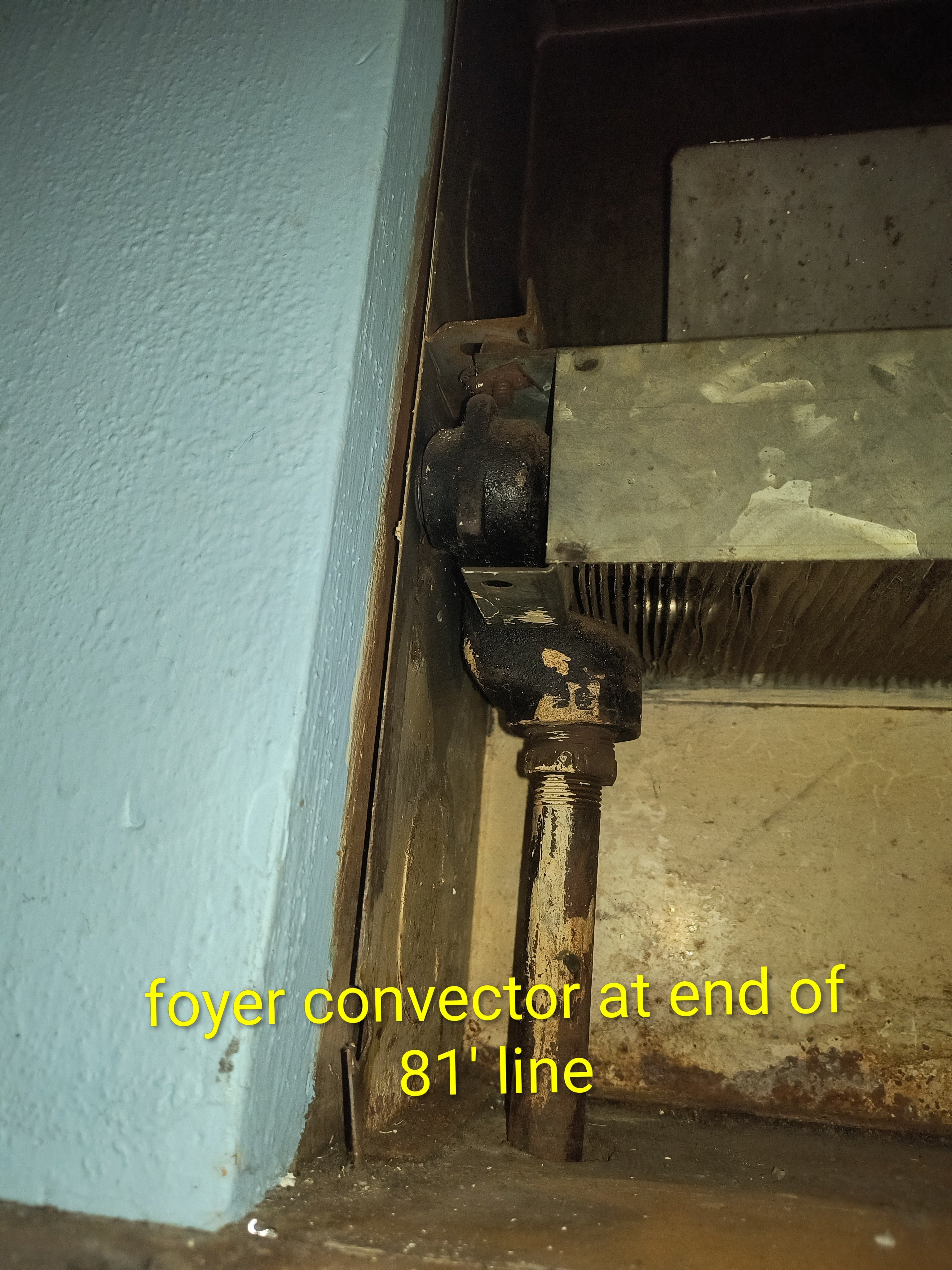

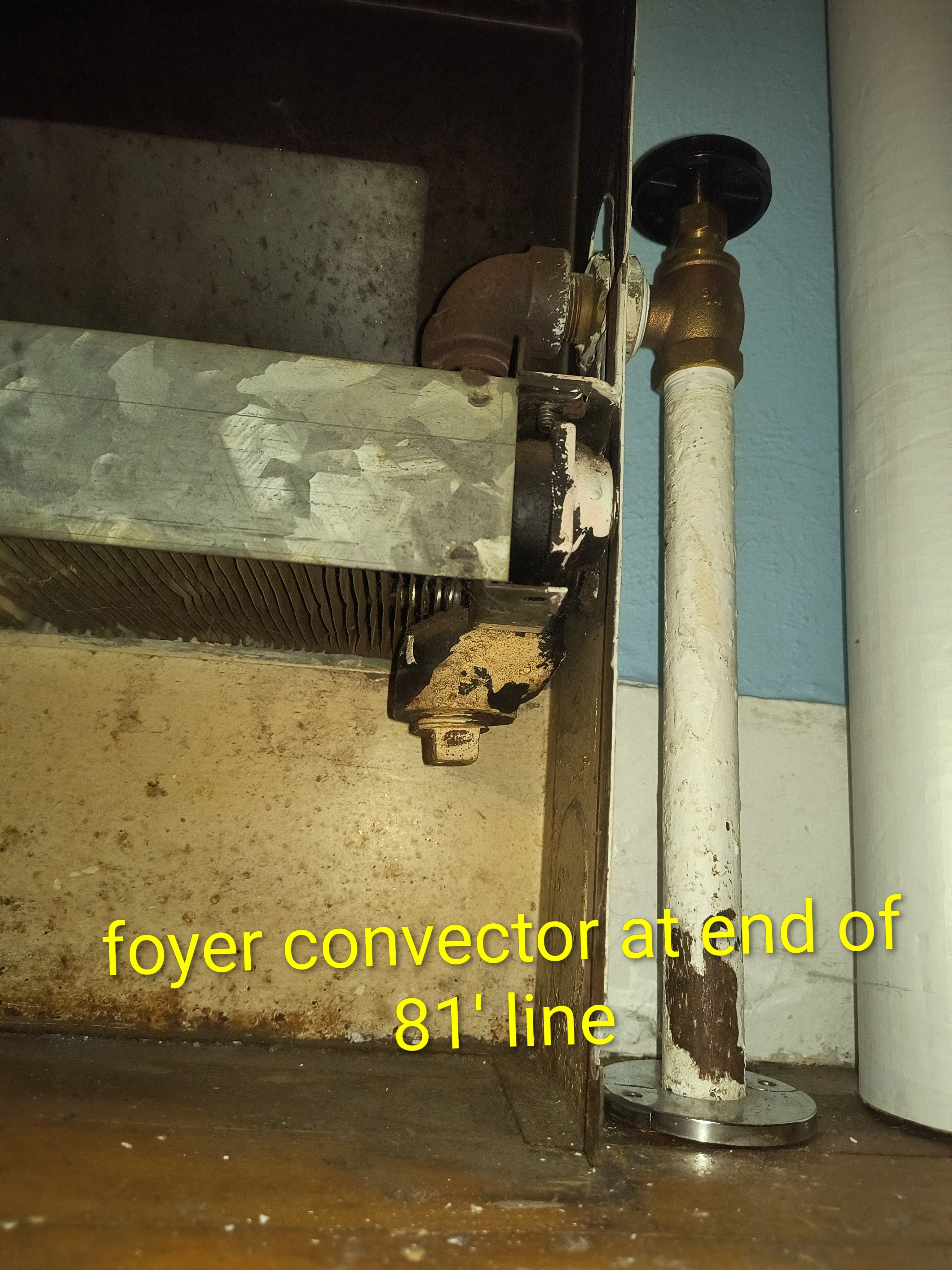

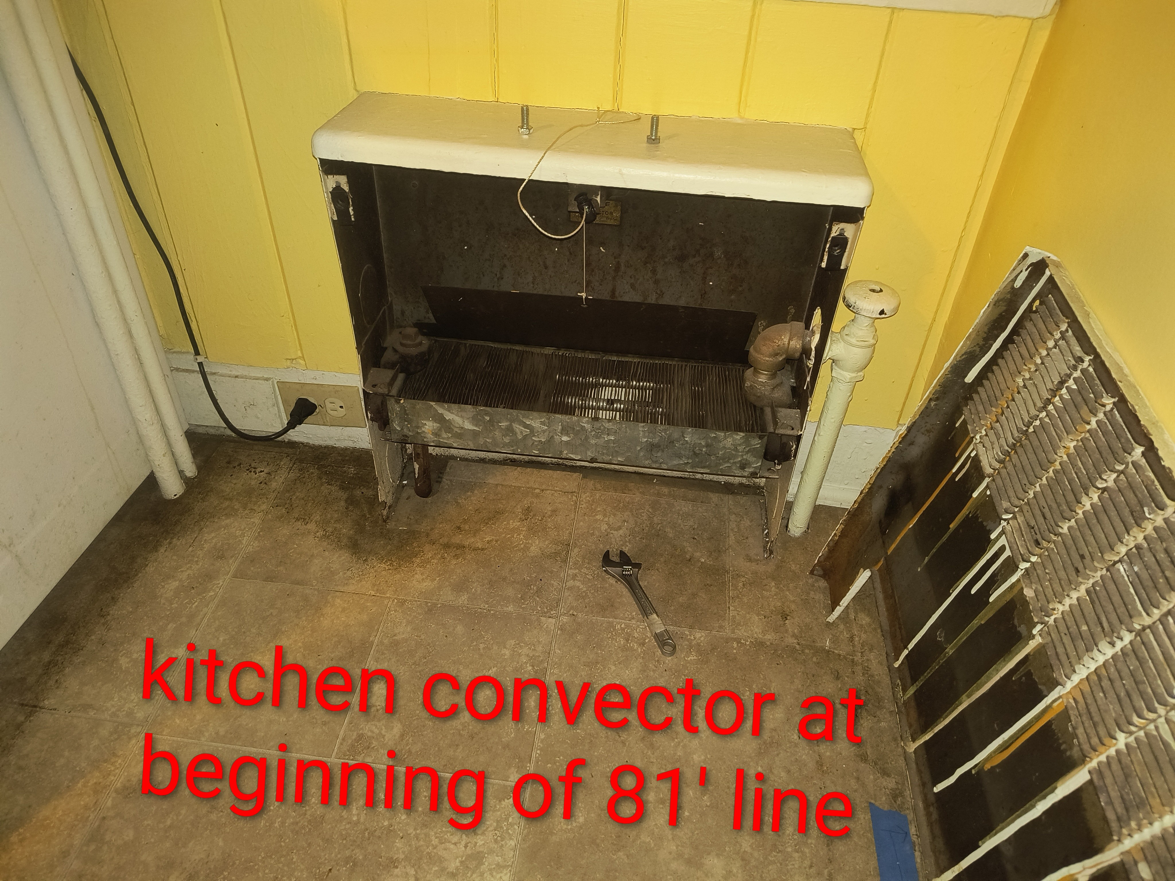

    @Tom8o , can you post some pics of your radiators? If they are concealed in cabinets, can you show at least one with the cabinet open?

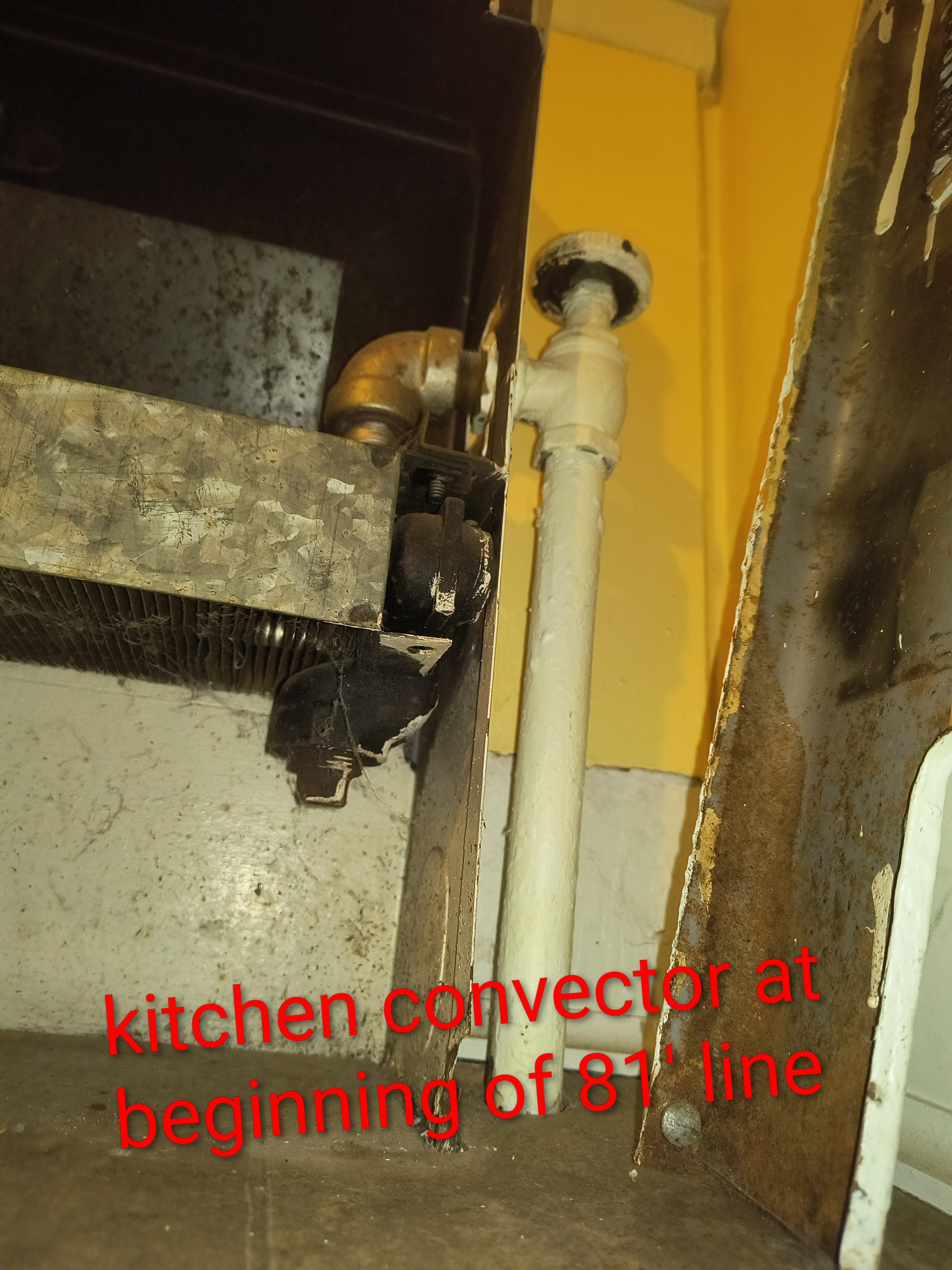

    @Jamie Hall yes, the 81' line connects to five 2-pipe convectors and one 1-pipe convector, on two floors. None of the 2-pipe convectors have vents nor traps that I can discern. See photos. The 1-pipe is in a renter's space and I can take a look in the coming days.
    @Steamhead I've included photos of two of the 81' line's convectors. They're both on the first floor. All of my house's convectors are this style and I believe they all have this setup of internal fittings\pieces, except the one 1-pipe convector in a renter's space is something I'll need to get back to you about in the coming days.
    If those are Trane convectors, they probably have orifices cast into them. Otherwise, the traps may be in the basement.

    If there are not traps in the basement and they do have orifices built in, you need to keep your pressure very low or you will get steam in the returns through the convector.
    The returns only need to be pitched in places where they are providing venting.
    Actually, you do need the vent at the boiler because it is 2 pipe, that is how the emitters vent, through the returns.
    Pitch won't solve your problem, you either need to make the water seal deeper or keep the differential pressure between the supply and return so low that it can't lift the water out of that water seal. You would need to be under about 6-8 oz/in^2 to not blow the water out of those seals.
    Are there any devices near the boiler? This appears to be a vapor system that possibly lost the vapor specialties at the boiler.

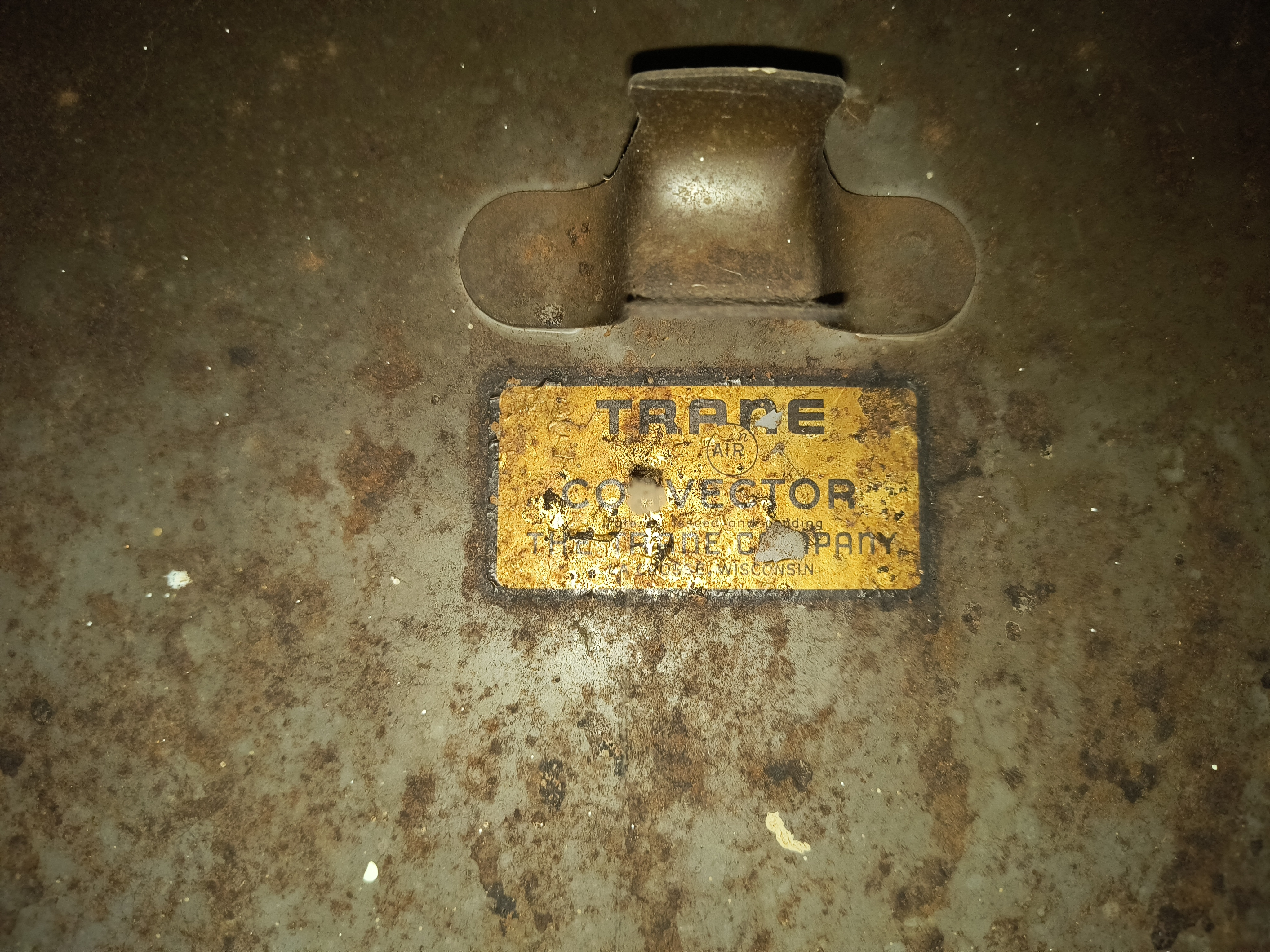

    yes they are Trane convectors. I see nothing resembling an orifice - just learning about them now for the first time and not sure what they look like (see search screenshot that doesn't show much re orifices).
    I haven't seen anything in the basement resembling an F&T trap nor a Thermostatic Trap, based on photos of them from searching those terms.

    some models of trane convectors have an orifice in the cast iron body itself, there isn't really any sign it is there, you just have to know they are designed that way.
    You won't see orifices — they are built into the radiation or installed as a thin shim with a hole in it or sometimes built into the feed vavle.
    Most Trane systems operated in the vapour/very low pressure range.

    • Between firings, I opened both lines' water seals (where Main and Dry Return meet) and exactly 2 cups of water drained out of each and there was no blockage.
