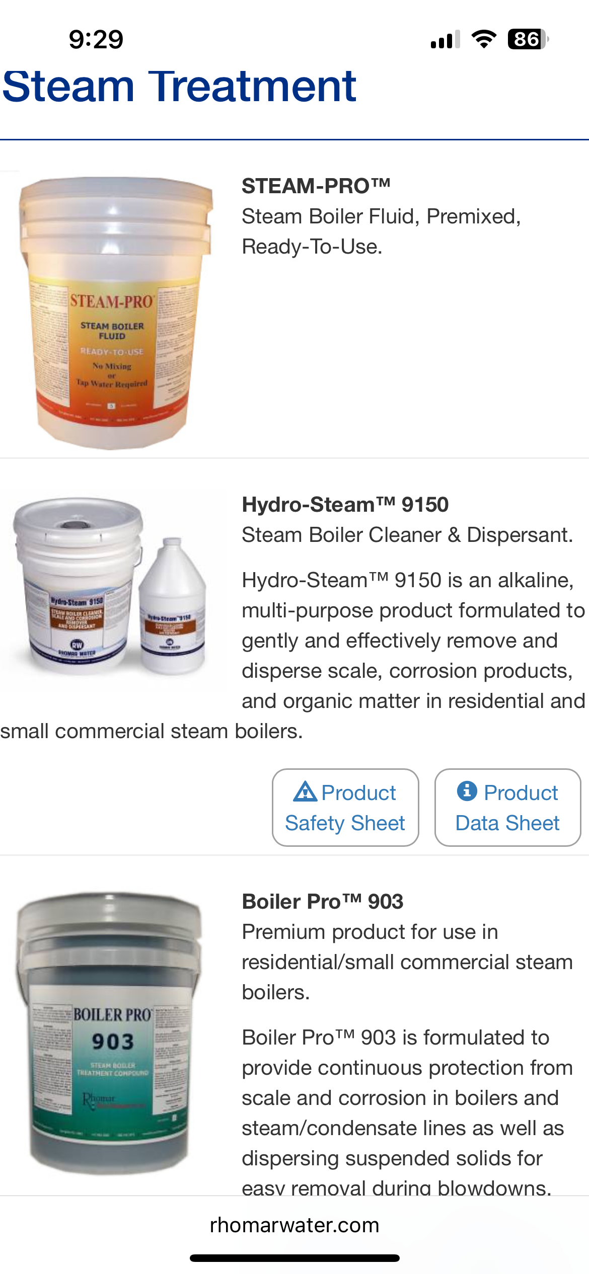

if it is available in your area Rhomar has some excellent products
I have used their hydronic and glycol products
They had a good steam system cleaning manual, I’ll see if I can find it
