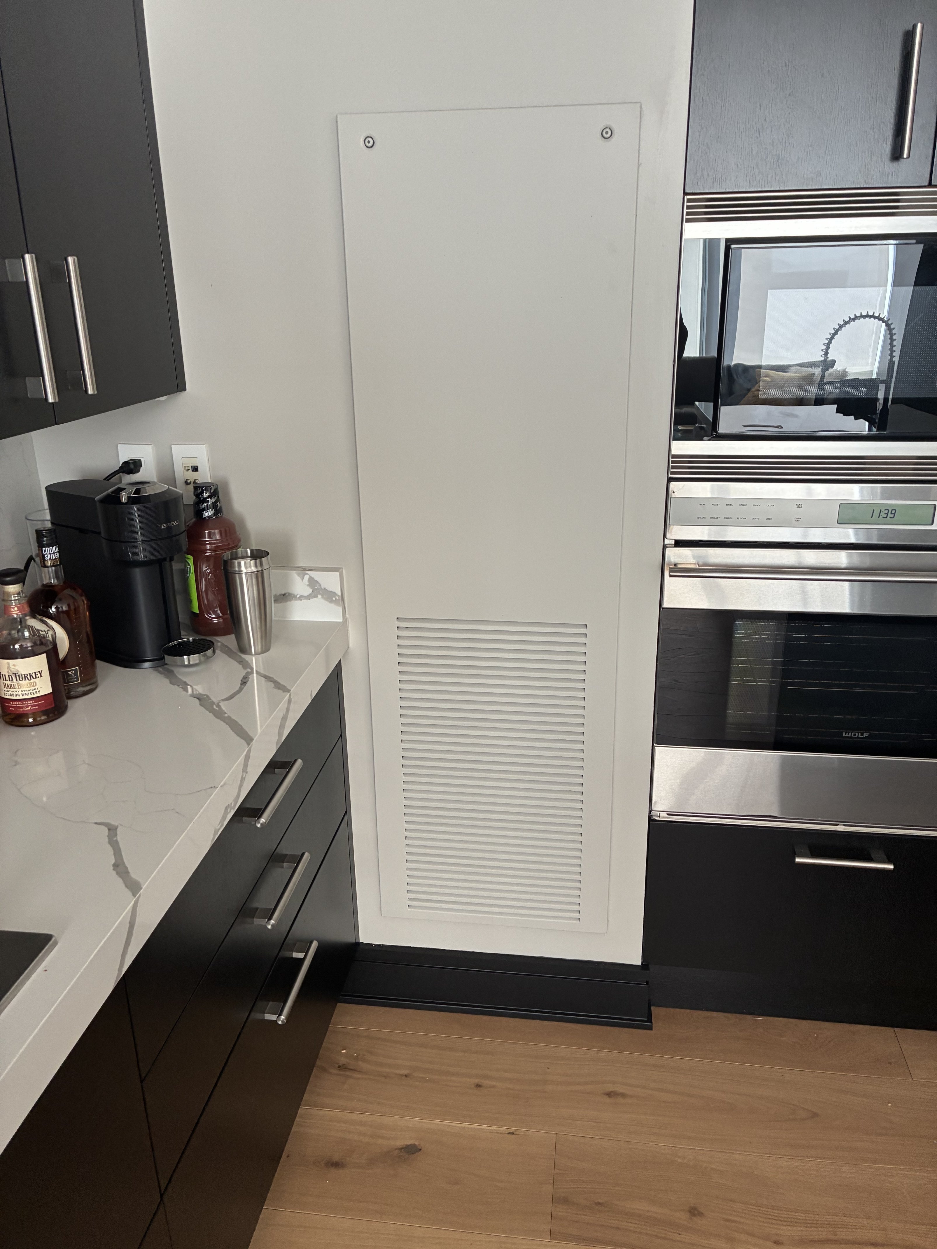

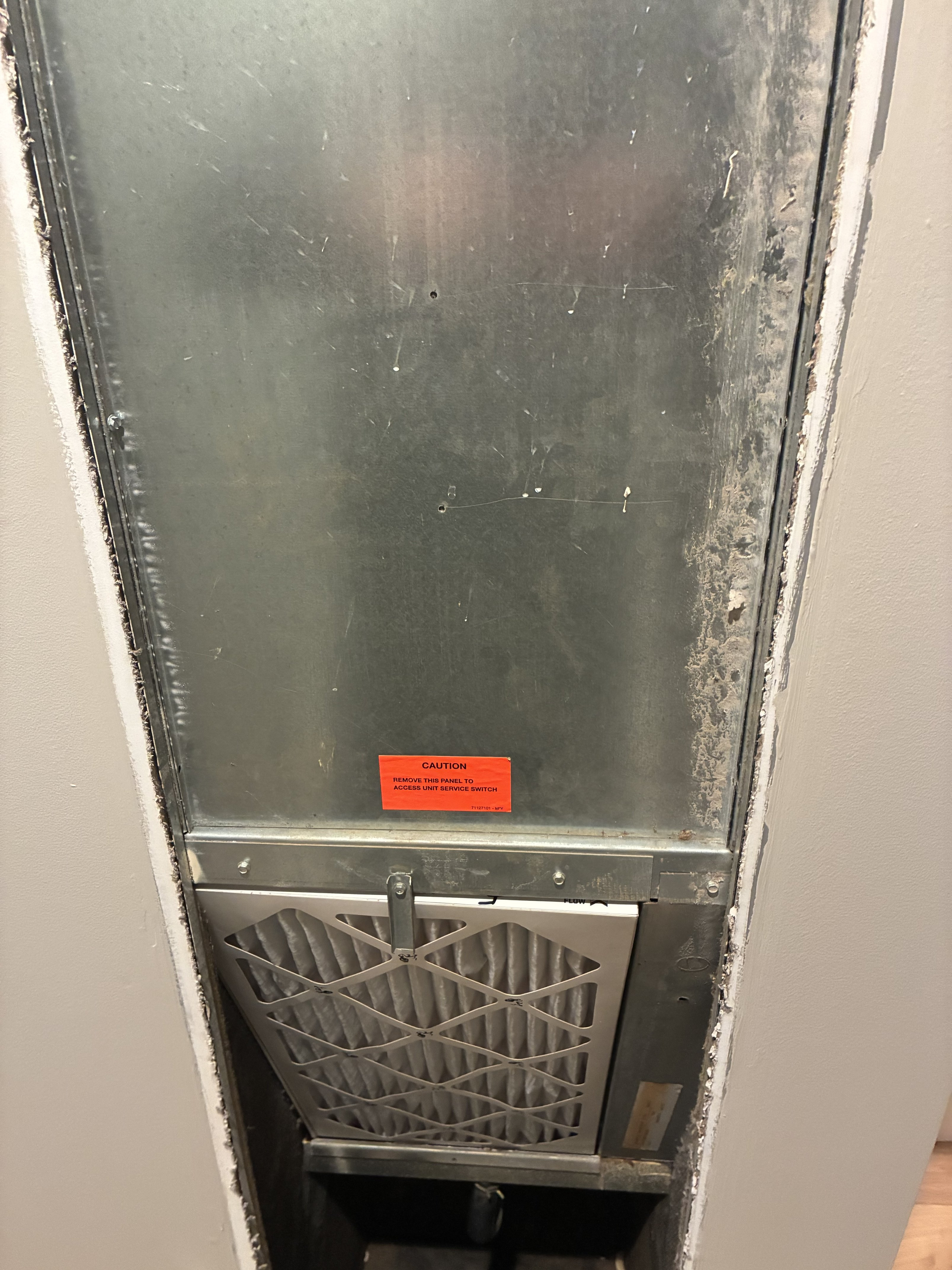

Working in the Trump building in Chicago. Customer has 4 vertical chilled water / electric heat vertical air handlers. His new hardwood floors are drying out and he wants to add humidification. Pictures attached. Any recommendations are appreciated.
no room in that closet. I feel sorry for the tech that has to work on it.
Free standing units possibly more then 1.Or boiling water on the stove, the return is right there.
that is a very liberal use of the word closet.
is there someplace by the laundry equipment to sneak in a steam humidifier?

A stand-alone humidifier in the room is the best bet

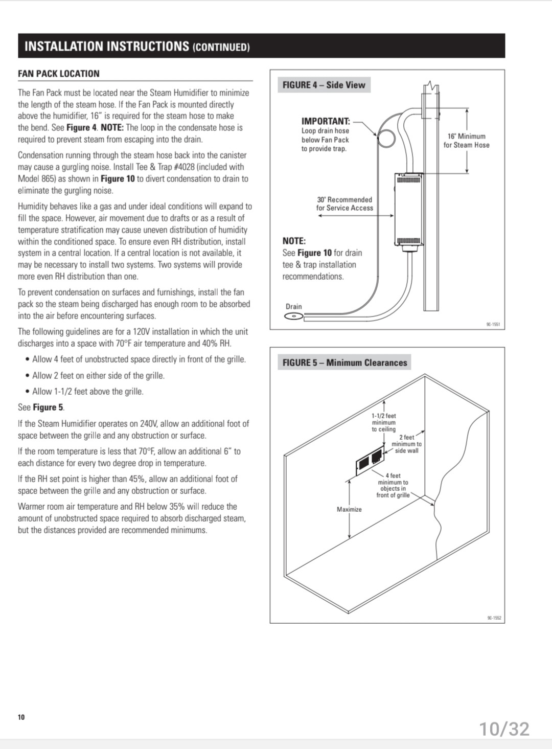

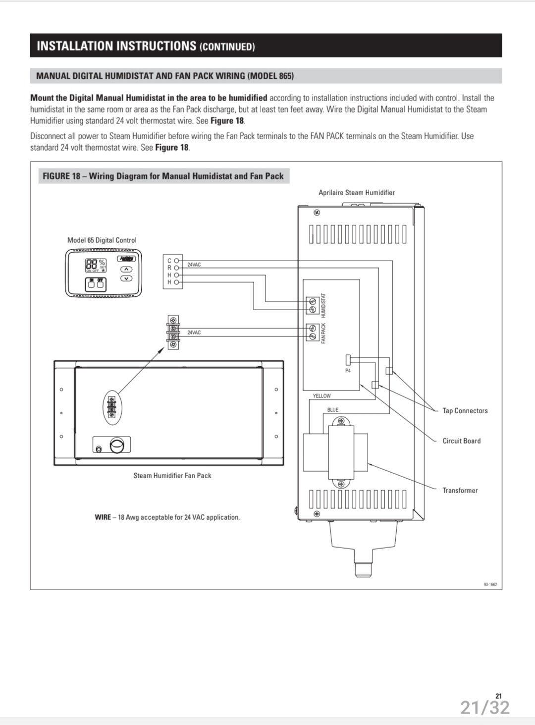

Aprilaire model 800 steam humidifier with the fan pack can be stand alone. It'll need electric, water, drainage, and some closet space. But considering the real estate, it shouldn't be a problem.
