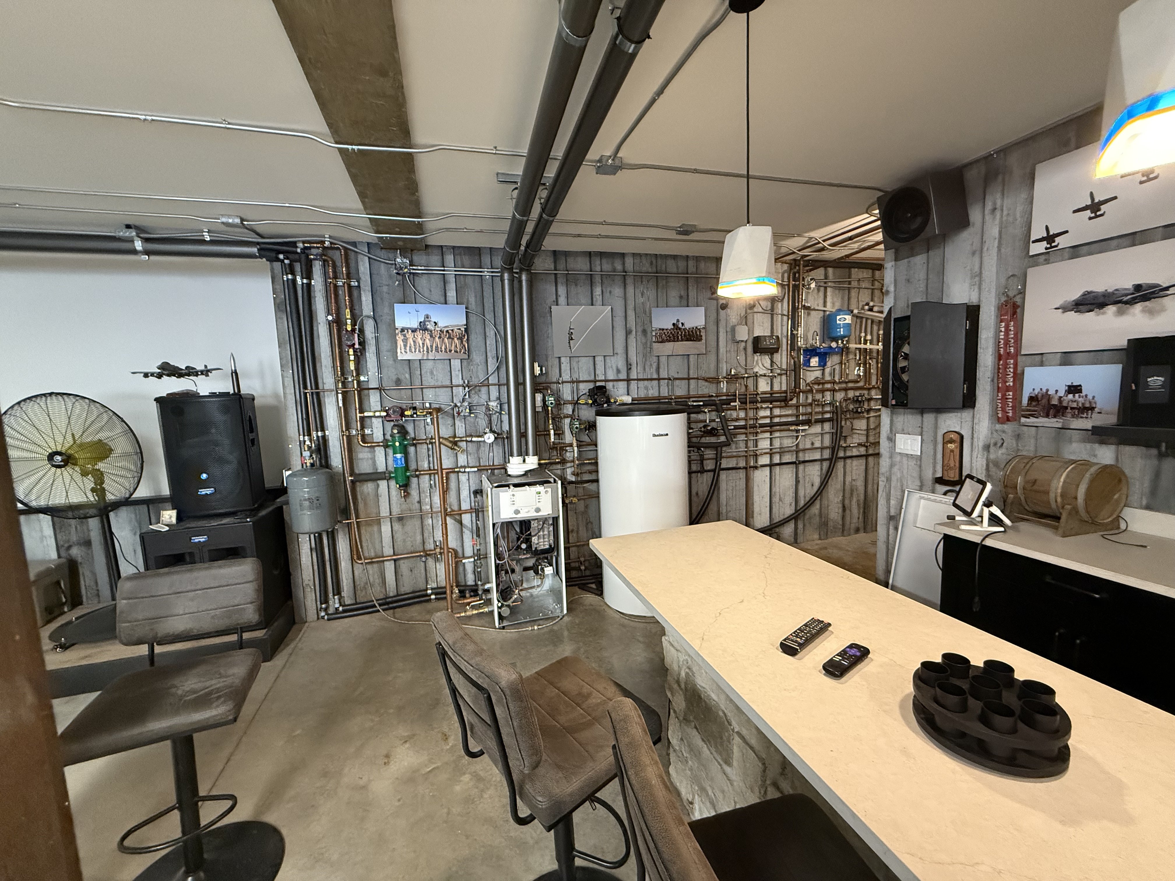

I ordered this Switzer wood boiler years ago and was finally ready to install it six years later. It’s a 1750 gallon wood gasification boiler and it provides DHW and radiant floor heat. The wood boiler is connected to the system across the room by 2x 1 1/4” pex supply and return lines for the radiant heat, and 2x 3/4” pex lines for DHW.
The heating system is designed to utilize the wood boiler until water drops below 120 degrees at which point it kicks over to the propane boiler. I am on well water and water quality has been a concern. The Bosch propane boiler has a leaking heat exchanger that needs replaced - the system wasn’t holding pressure. I had a 5 micron filter installed between the well and the house / heating system. At that time I asked them to check the water quality and ph- it tested neutral at 7.3.
Right now I have all 1750 gallons of the wood boiler connected directly to the heating system and thus the pex lines that run through the floor. The heating design calls for Fernox f1 for water treatment. Heating that amount of water with Fernox is costly. I was considering a plate heat exchanger between the wood boiler and the 1 1/4” pex lines that bring hot water over to the other corner of the room and the heating system. That way I could treat the wood boiler with less expensive treatment and only treat the water going through the floors and propane boiler with the Fernox.
It looks like I lose about 20 degrees of efficiency if I do this.
Couple questions - are there plate heat exchanger manufacturers to avoid ? I want to say the system is designed for about 160k btu/hr. I was looking at a 225 btu/hr exchanger but in the remarks it said 180 boiler side, 160 return.

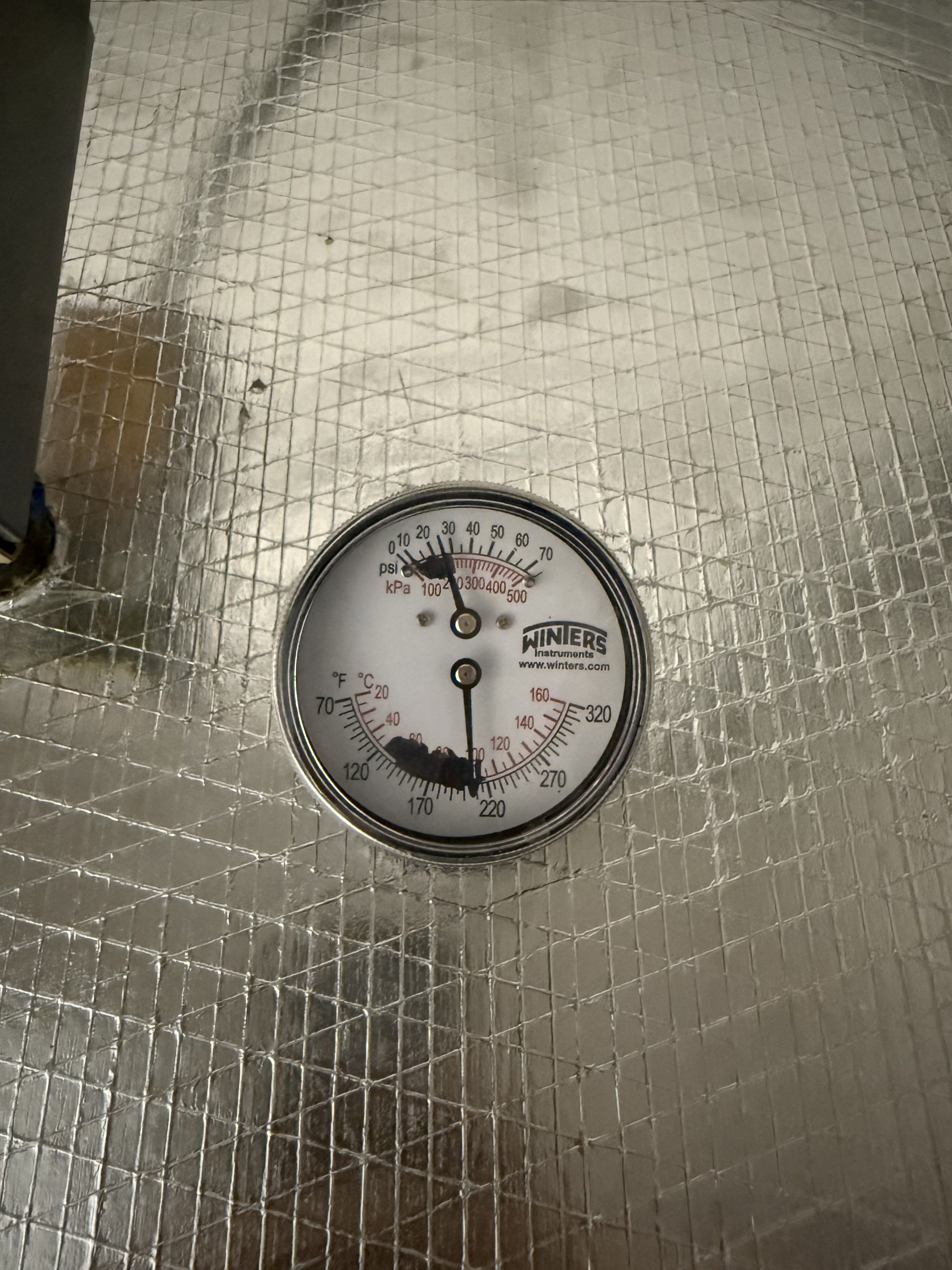

The wood boiler heats the water to about 220 under 30psi pressure. I don’t understand the 180/160 numbers. Anyone see any good reason not to install a plate heat exchanger between the two? Recommendations on what to purchase ?
Thanks in advance

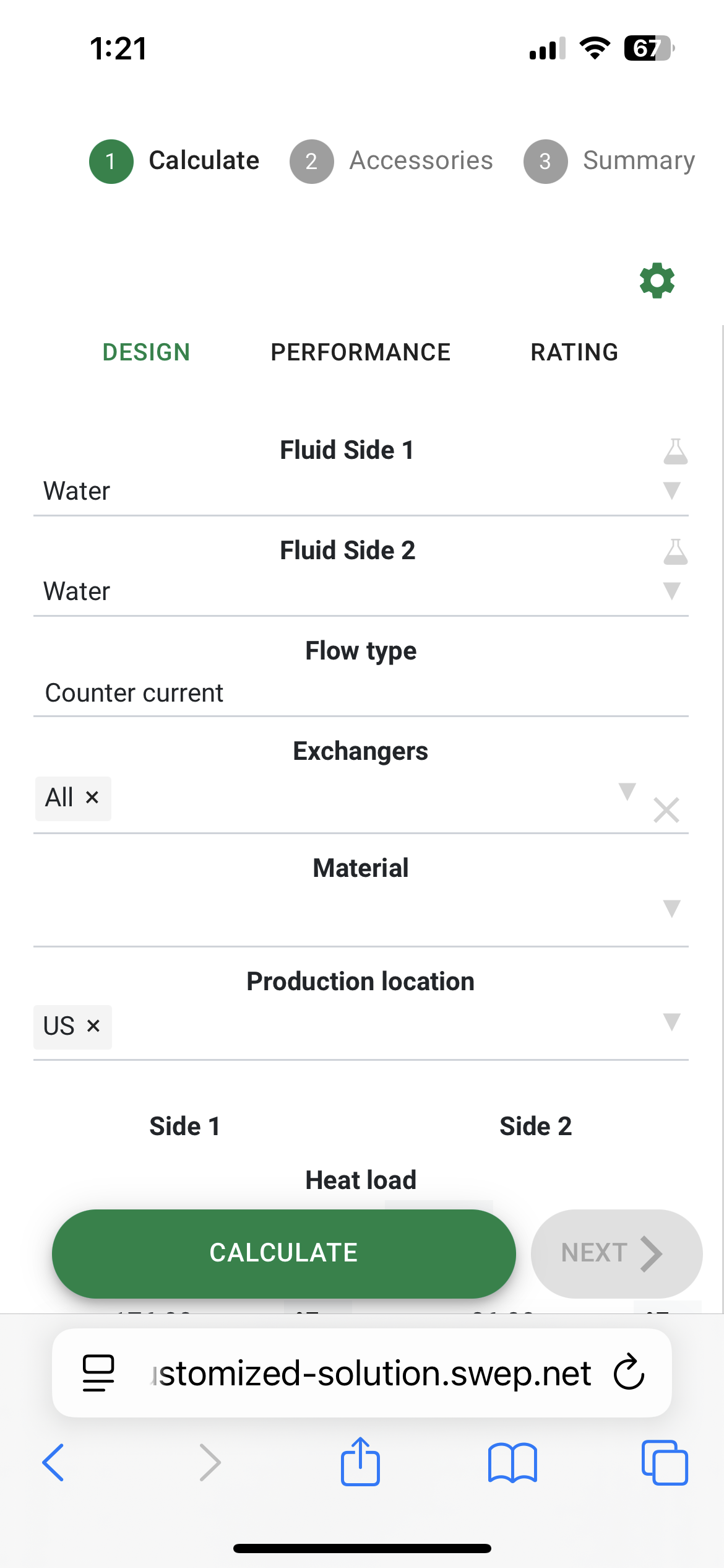

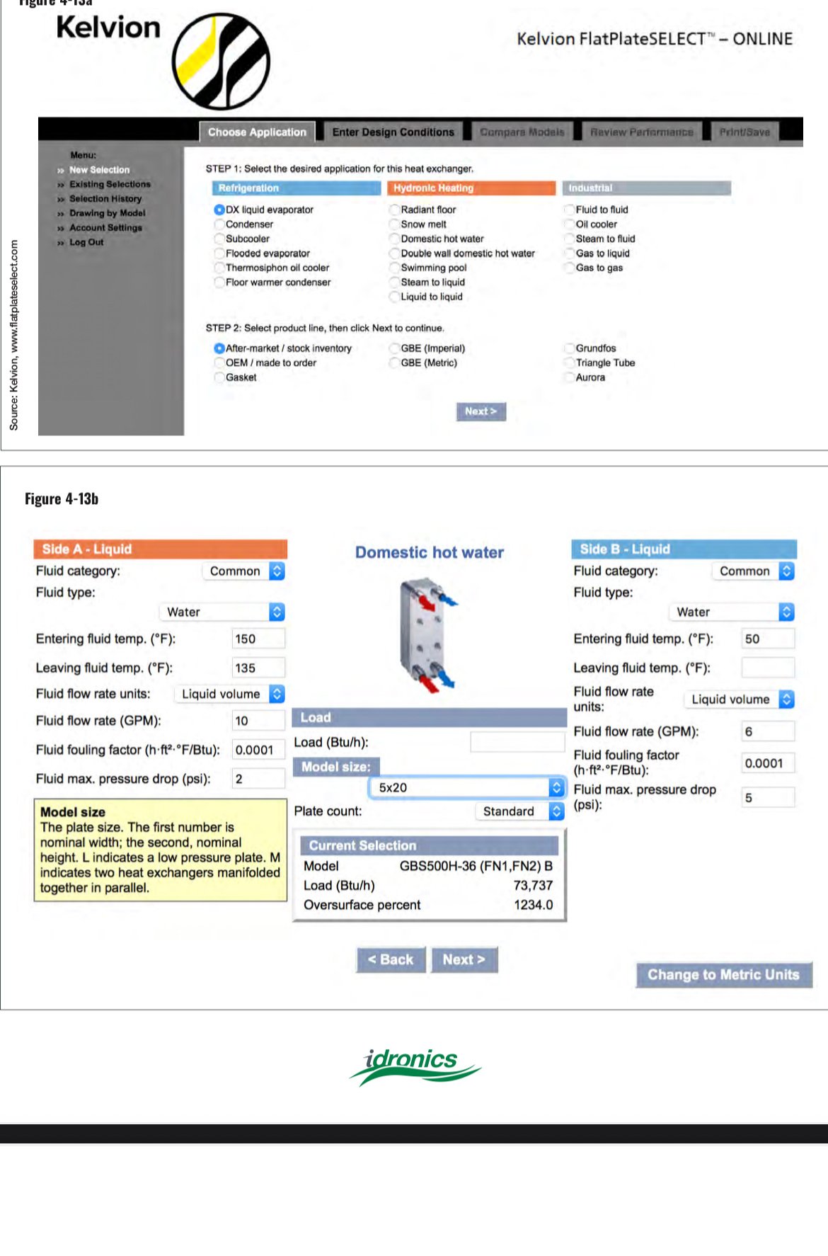

    There are free HX sizing software online if you want an exact answer
    Most HX info is just one configuration which may or may not match your needs
    Bigger is usually better
    Stay away from the very cheapest brands Find a name brand on bay, etc.
    https://customized-solution.swep.net/singlephase?c=13748f2b-3ab1-48bf-90c5-be4958b8e7aa

    Switzer has a domestic hot water coil in his boiler so I don’t need a heat exchanger for that. Right now I have the ability with valves to bring the water from the well and run it through his boiler and either preheat a domestic hot water tank , or bring the heated water directly into the house from his boiler. I’ve had the propane boiler turned off for over a week or so. I fired the Switzer boiler up on Saturday and got the temp up to 200. I left on a military trip on Sunday and returned home yesterday. Since Saturday, the temp had dropped from 200 to 170 on the boiler and the family has been using DHW throughout that time. I do have a recirc pump that I can utilize that constantly keeps the water running through his boiler coil so hot water is on demand and available within a couple seconds. I’ve had that unplugged to keep the temp up on Gary’s boiler, though. I’ve found that bringing cold water from the well and directly into the house after making a trip through his DHW coil is plenty hot to take showers with.
    I’ll take a look at those plate exchangers you recommended. I’m on the Wisconsin border north of Rockford so they are local.
    I’m trying to figure out the calculator that hotrod sent. Not sure what co flow and counter flow means. And why are there two inlet and two outlet settings?
    I have a max temperature of 220 water on the wood boiler. Max temp water required in one of the 11 zones is around 120 water. So I probably only need to bring 160 or so through the pex tubing and over to the floor system to mix with the return water. I think when I only had the propane boiler in use for radiant heat I had the dial set to fire up to about 140.
    The only other concern I have - the wood boiler is set up so that if it over fires - temp more than 220 - it automatically opens up the valve to the garage floor for a heat dump. Hopefully the installation of a heat exchanger wouldn’t inhibit that safety feature for heat dump? I also have a taco three way mixing valve with dip switch settings that I’ve now set so it doesn’t limit the temperature it sends to the floors. Not sure that was the correct decision either but I didn’t want to keep the excess hot water trapped on the primary side by a taco valve - so I set the settings to not limit water temp at all for the garage floors.

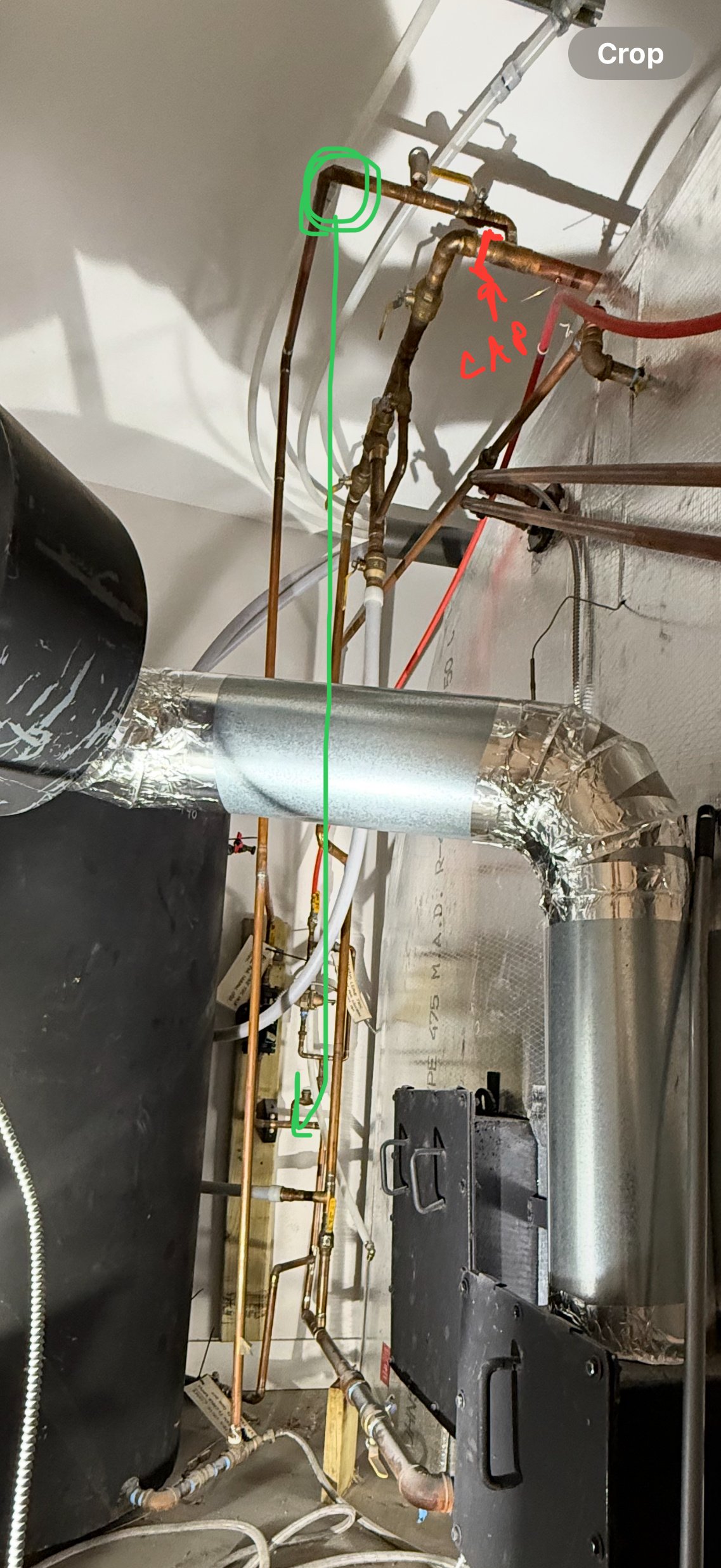

    Hindsight I should have run copper over to the wood boiler vs the 1 1/4” pex, but admittedly I’ve already overfired the wood boiler once - temp exceeded 220 on the boiler by a bit, the heat dump valve opened and 220 water ran through the 1 1/4” pex across the room over to the copper pipes. I went to the back of wood boiler and manually opened a valve to let hot water escape but I was concerned to keep it pressurized so I didn’t have boiling water in my pex lines.
    Definitely some learning required with a system like this, but looking forward to not seeing the propane man show up in his truck as often.

    If you are seeing a 220 degree water temperature without the relief popping off, you need a much better American made gauge from Marsh instruments or Dwyer instruments.
    You should look at shell and tube heat exchangers before you make a purchasing decision.
    If you do not have a dump zone to get rid of excess water temperature you need to have one installed.
    You can use the garage as a dump zone using a Zurn garage heater with a separate circulator and single aquastat to power a separate circulator and the garage heater.
    You never want to see your water temperature rise to 220 degrees, you need to buy an American Made temperature gauge with a 4 inch round dial or square face.

    can you limit the boiler operating temperature to 180 dump at 195.At 220 if pressure drops you are flashing to steam a very powerful force to recon with.
    Pex can go above 180, dependent on pressure, it gets very soft at those elevated temperatures and pulls in O2 at a higher rate. I worry about fittings coming apart when the tube softens.
    Boilers typically have pressure only relief valves. Although some do have a T&P also, Aquatherm had both, 30 psi relief and a 210f/150 psi t&p

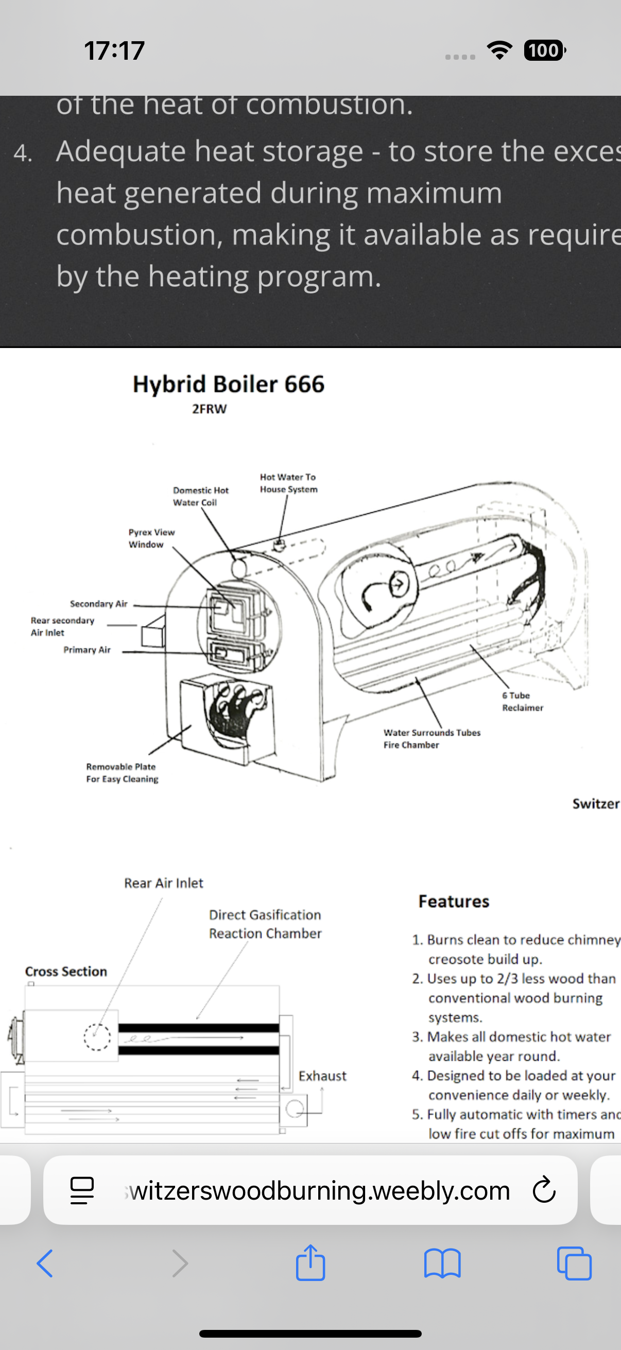

    If the Switzer WB has a DHW HX built in, why do you want another HX on the WB boiler?
    Take cold through the WB intergral HX and on to the EK system. Simple no pumps or controls required.
    I think the WB is already tied to the heating system somehow?

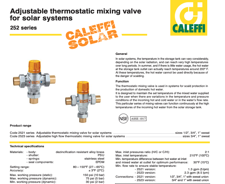

    However your ultra high operating temperatures frighten me. Potentially you could send 200° preheated water into the dhw system.
    Somewhere you want a listed 3 way thermostatic. Ideally one rated for 200° plus. Generally solar mixing valves have that high temperature rating, but not over 210°F for obvious reasons :)

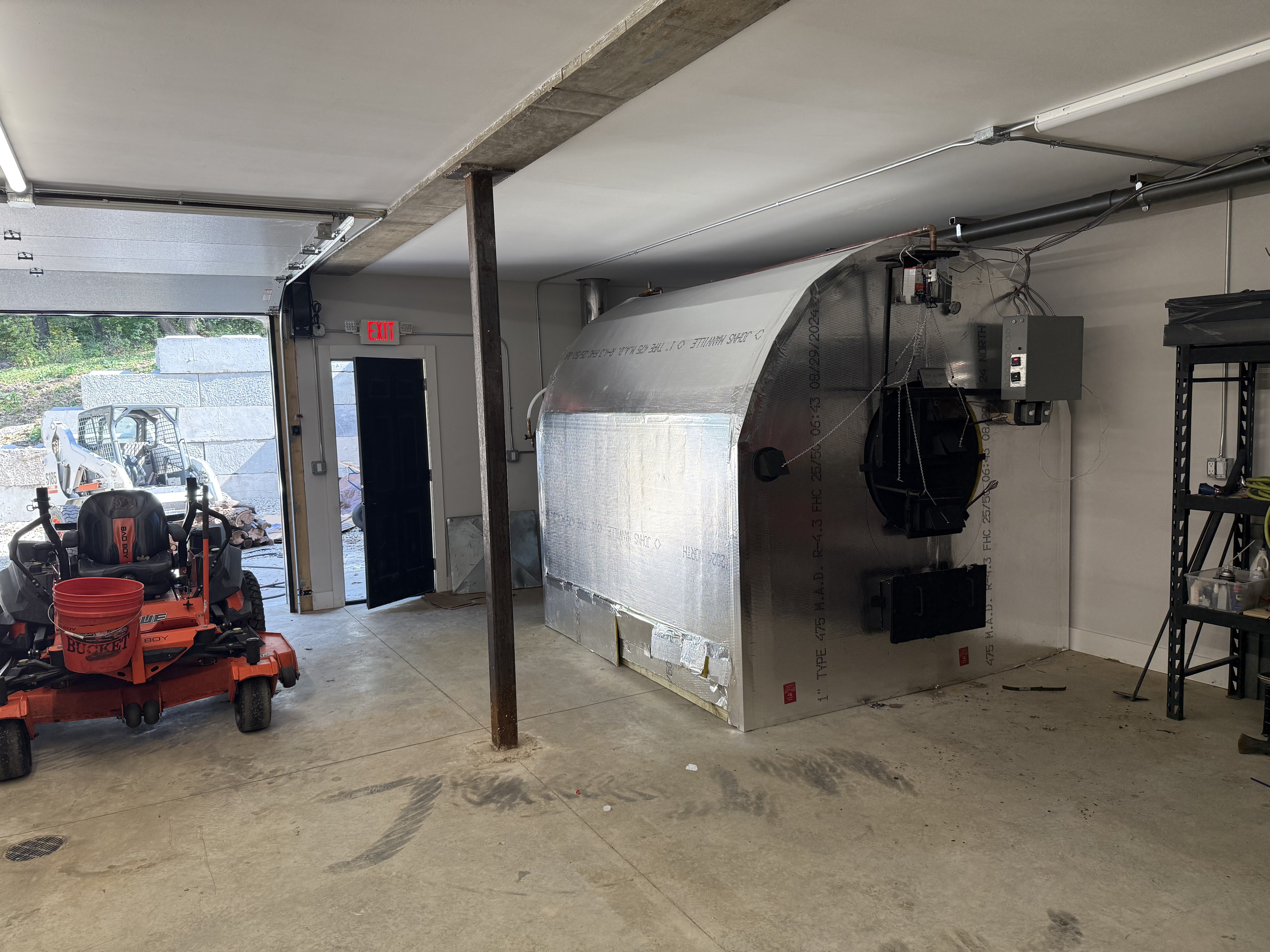

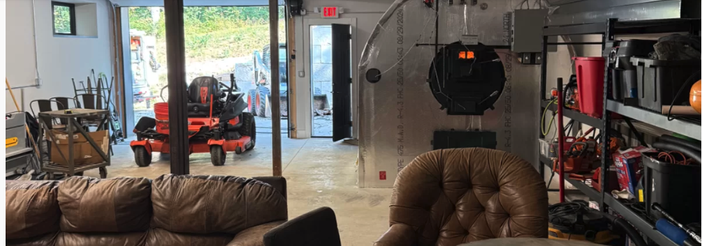

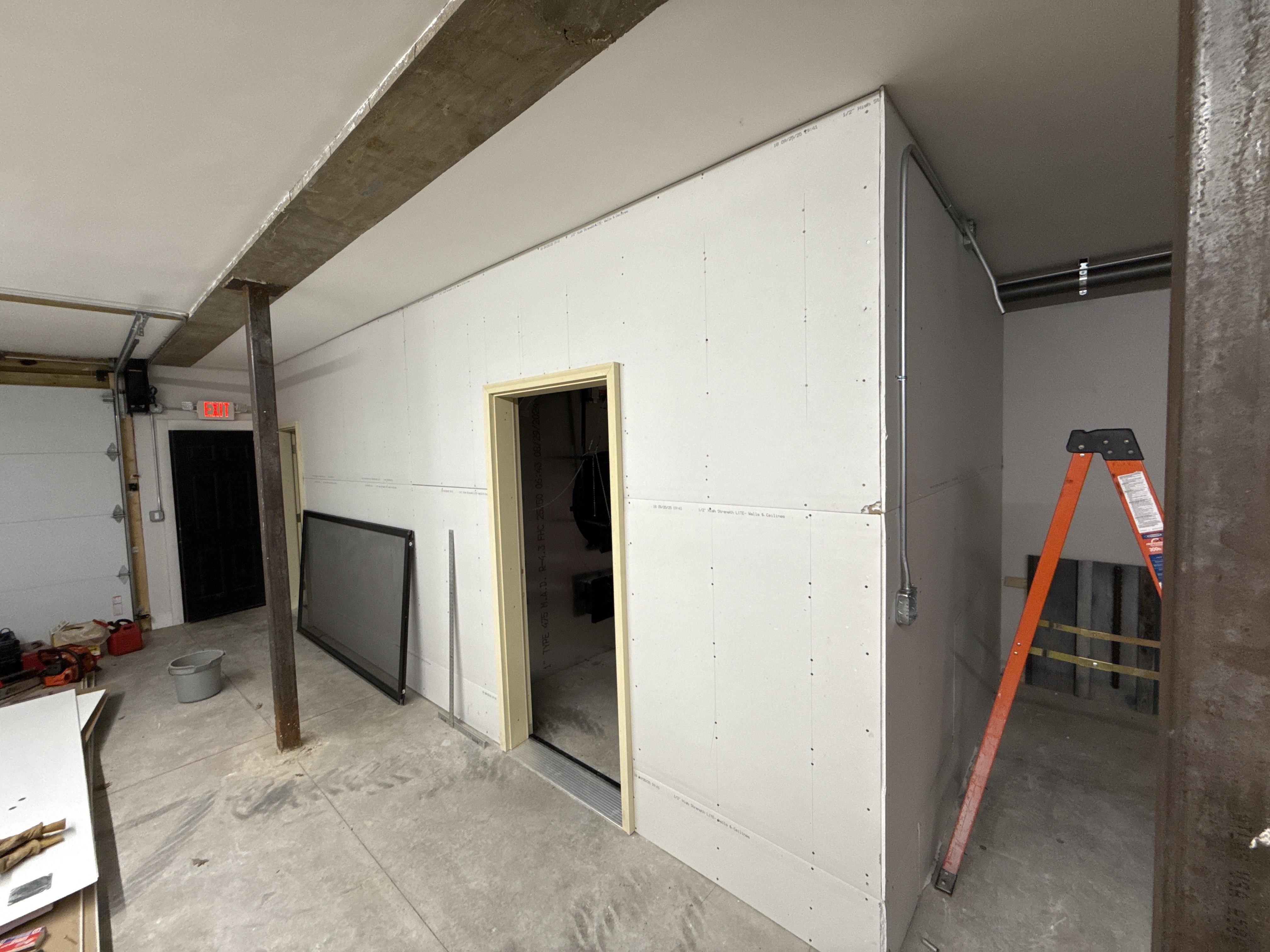

    I believe a mower parked in a shop with wood heat, and fossil fueled appliance is a big no no, as far as codes go :( Cozy set up, however.
    Around here you cannot have an overhead door on a building with a wood fired appliance.

    When I was discussing with Gary, he didn’t mention anything like that as an option. In the back of the boiler there is are 3/4” supply and return lines for the domestic hot water coil. There are separate lines for radiant heat purposes, 1 1/4” lines.
    There is a thermostatic mixing valve both for the DHW lines and one on top for the radiant heat. The dump could be set for 190 but I’m losing quite a bit of efficiency I would think- in that I’m heating significant sf and getting DHW. I would think that the 120 degrees where it kicks to propane would come quite a bit sooner?
    Gary doesn’t think the heat exchanger is necessary. He says with the proper ph water- his boilers have lasted 40 years with no water treatment at all. My concern is the cost over time of treating 1800+ gallons with fernox f1 or sentinel 100- like my radiant heat design calls for.

    Re: lawn mower; I’ve since built a wall around the boiler , heavily insulated and fire protected. The lawnmower was there temporarily - that was before we even fired the boiler up for the first time. Garage door mainly for getting wood into the boiler area.
    I think I might build a bench in there and use it as a sauna room- it gets warm. That’s how I can justify this entire thing to wife.

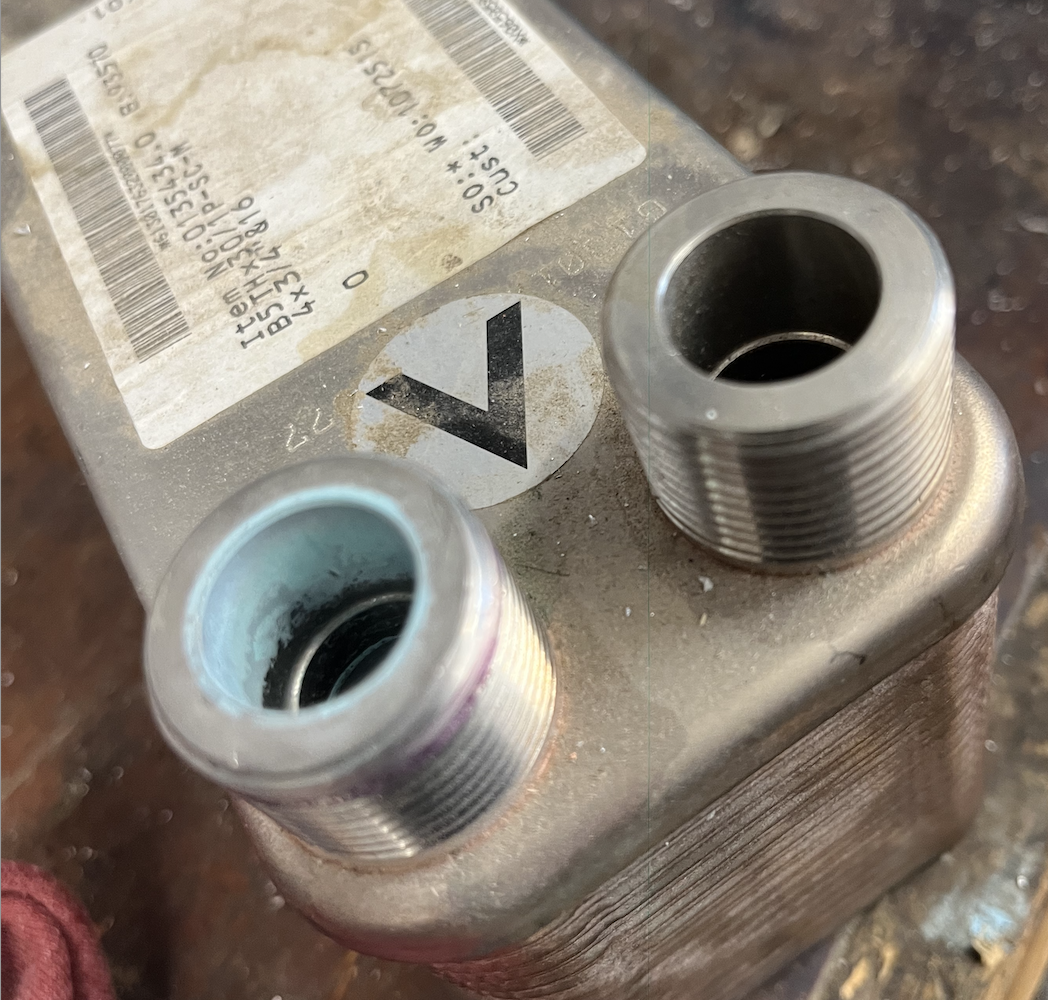

  • Sukhoi29SU
    Sukhoi29SU Member Posts: 204
    the propane boiler is a Bosch FS-151 greenstar.
    Already replacing the heat exchanger after about two years of use.
    perhaps I’ll call badger next week and see if they can help me properly size a plate heat exchanger ; I think I’m convinced that’s the way to go.
    hot_rod Member Posts: 28,077
    yeah, aluminum block boilers really need careful fluid monitoring. You know that from the I &O manual. It may be the most sensitive of all the boiler metals.
    I think some brands include a bottle of aluminum friendly inhibitor in the box

    Four inputs in the sizing, 3 temperatures and flow This shows 50 degree water being heated at a 6 gpm flow, 10 gpm of 150 on the boiler side 5x10 -36 plates
    Here is a graphic showing counter flow piping
    A good practice to install unions on all four connectors, should you need to replace ir service

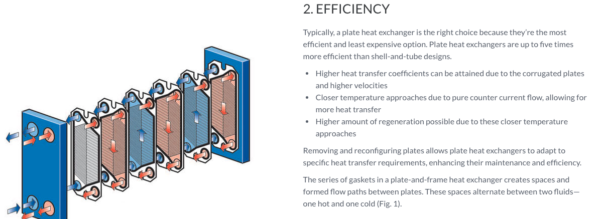

    Plate type HX are more efficient and less $$ compared to shell and tube.
    https://www.csidesigns.com/blog/articles/shell-and-tube-heat-exchanger-why-purchase-plate-and-frame?srsltid=AfmBOopa0JkbSpxY8W0Mca1B3V_rTe3h6dqZxBt2UqYtykWqWYQvGu4G
    More size availability also.

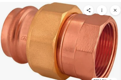

    I could suggest some simple union fitting options to get to copper, pex or threaded pipe. Plate HX usually have nipples with a nice flat surface to take a fiber washer and union nut.

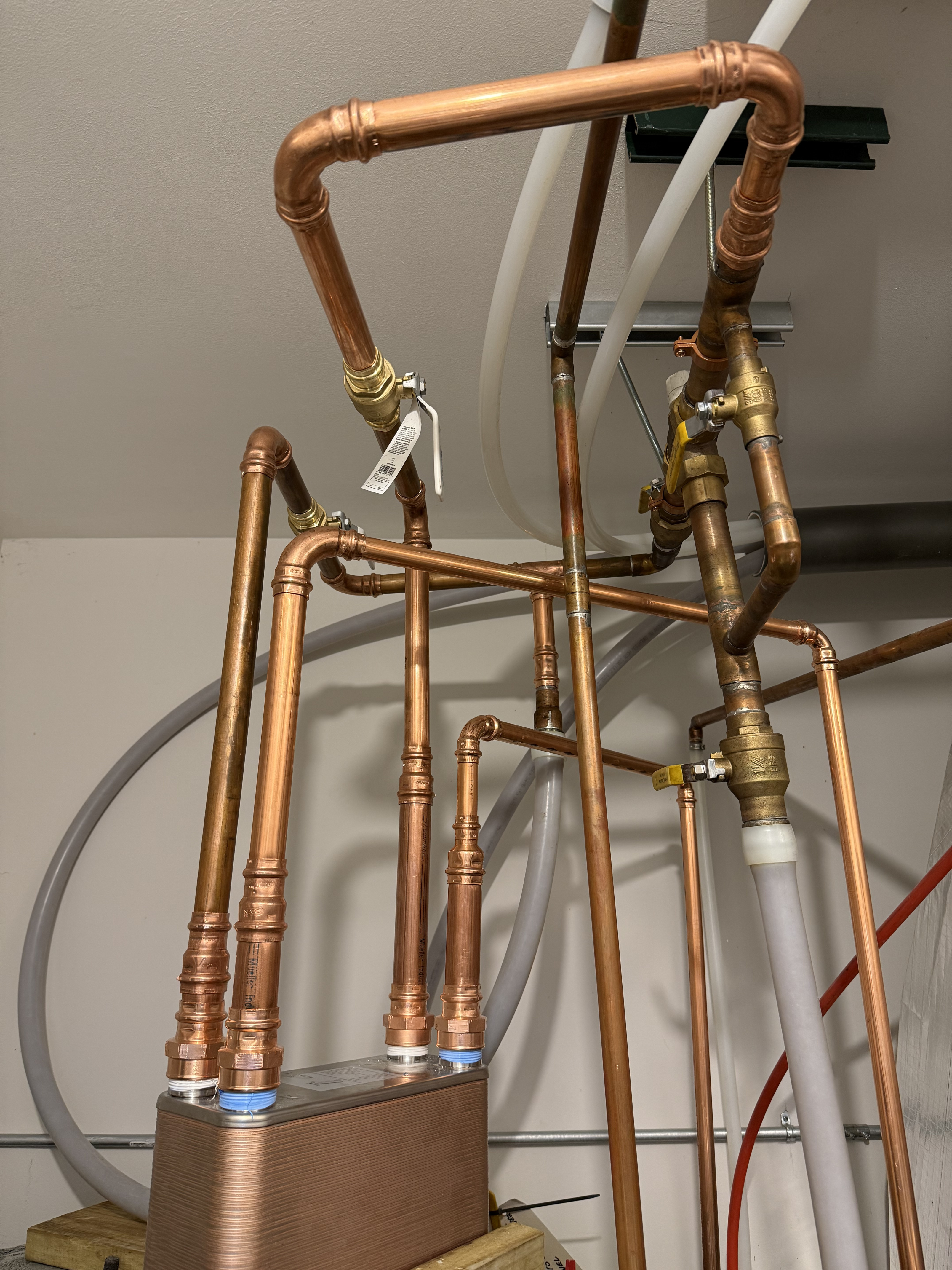

  • Sukhoi29SU

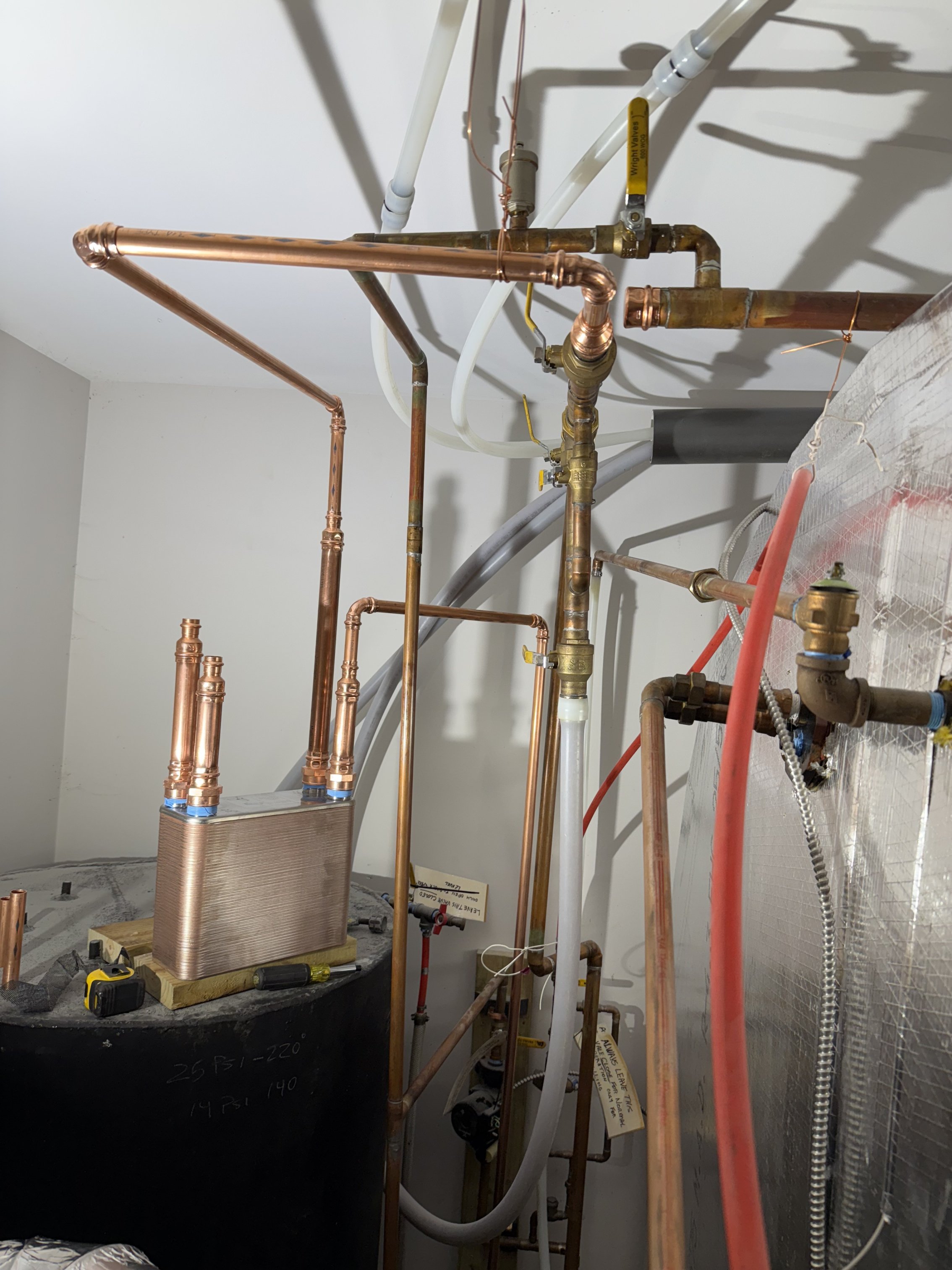

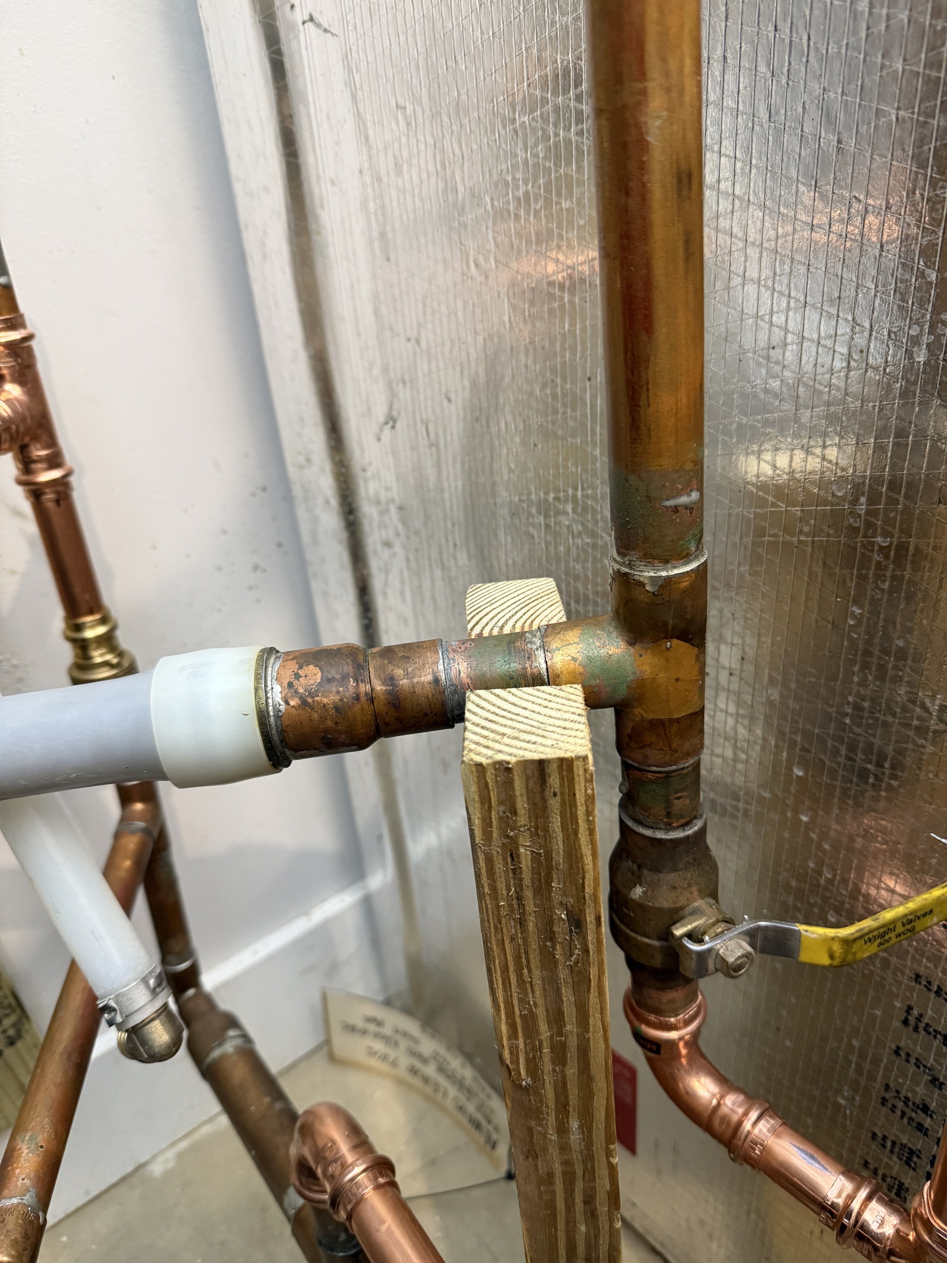

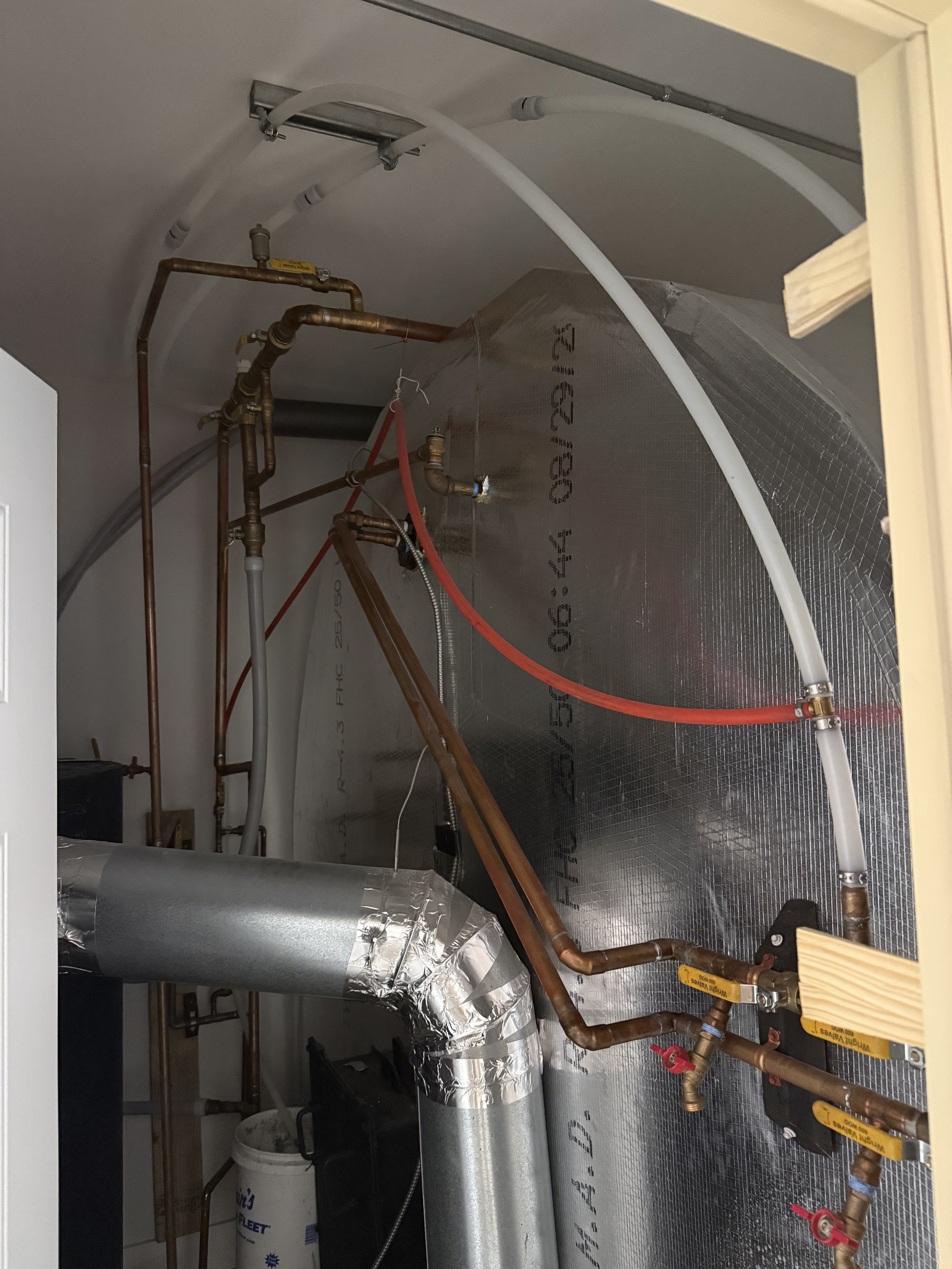

    I borrowed my buddy’s copper press tool and am about to plumb in this 100 plate heat exchanger. Gary has advised me of the way to hook it up, which involves taking the current 1 1/4” supply line and capping it off, and using a 3/4” line that has hot supply water that t’s off prior to his expansion tank and runs through a recirc pump. This would allow me to use the existing pump behind Gary’s boiler by installing a relay to circulate water through the heat exchanger when there is a call for heat ; rather than that pump only running when his boiler is fired up. I like his thought on this , but I have concern about reducing the supply down to 3/4” pipe, only to expand back to 1 1/4” to go into the heat exchanger ports. I bought all the fittings to do it this way, but wanted to check here in case anyone sees any problems with reducing diameter and using 3/4” supply lines for portions of this plumbing ? Picture attached annotated to show the cap. Green is the pipe I’ll use for supply after it t’s off and after it runs through the pump.
    Yes the pipe reduction will add some pressure drop to that circuit. With 3/4 connections on the FPHX you don't have any options.
    If the boiler manufacturer has a specific way to pipe the HX, they should know what works best.
  • Sukhoi29SU
    edited December 2025
    the connections on the heat exchanger are 1 1/4”. Im reducing down to 3/4” to utilize the line to the hot supply line to the expansion tank which t’s off - and use the current pump. Then eventually going back to 1 1/4” pex to go across the room and into the heating system where the propane boiler is.
    I’d need another pump to create all the loops with 1 1/4”, but after further inspection it looks like Gary already has the return line reduced down to 1” copper behind his boiler.
    The way he’s having me do it is the least amount of work and parts; and I don’t need an extra pump. I was just concerned about the reduction. They are short loops, I guess …
    This is the difference between and off the shelf HX and one that is built and sized to the exact application. The connection can be a variety of sizes and locations in a factory built HX.
    If you have 3/4 male threads on the HX, make the increase with as short a fitting as possible.
    A 1-1/4 X 3/4 black steel bell reducer for example.
    There are 1-1/4 X 3/4 female copper adapters also, but $$.
    If it were me I would have unions on all 4 connections.
    1-1/4 black unions, bush the one end to 3/4 fip and adapt copper to the other side, with a press adapter perhaps.
    A press union 3/4 fipx 1-1/4" copper would be ideal, but I've never seen such an animal.
    You may be find an 1-1/4" version like this and reduce the fip threaded side with a brass bushing, again the more custom the fitting the more $$
    Basically when flow hits that smaller opening you get a velocity increase in that section, basically it's an orifice.
    Go with the flow, transition as you wish and keep moving.
  • Sukhoi29SU
    @hot_rod
    Thank you, I got started today and should be finished up tomorrow.
    It does seem odd to have a high sq footage HX with small diameter tube. Typically 3/4 copper is good for 4 gpm
    Are you taking that one connection down to 1/2” tube? Or are the HX connections 1”?
  • Sukhoi29SU
    the HX connections are 1 1/4” threaded. This is my concern. We are taking the boiler supply lines which were 1 1/4” (and matched the hex ports) and forcing all boiler supply through a 3/4” copper line that T’d off and went to the expansion tank and T’d off prior to the expansion tank to run through the recirc pump.
    After Gary explained the way to be plumbed and I processed it overnight , I sent an email expressing concern over the reduction but haven’t received a reply.
    im sort of committed at this point.
    I’ve just got so much invested in this that I hope we don’t lose a bunch of efficiency.
    I had expressed interest to Gary before the install about a HX between his boiler and my other one and the water running through the floors. Miscommunication, I thought he had one installed on the radiant heat portion of his boiler as well. Now I’m redoing all his work and hoping it’s going to work out.
    I believe he was against the HX idea in the first place.
    Sorry , I misunderstood the port size of the HX
    The amount of gpm, heat, you can move is dependent in the tube size, flow rate
  • Kaos
    Kaos Member Posts: 957
    3/4 is good for about 5GPM. Assuming 20f delta, that is about 50k BTU of heat. If your space heat load is less than that then the pipe size is fine. You can also run with higher delta and get even more.
    The extra big HX just gets you closer approach temperature which is always a good thing.
  • Sukhoi29SU
    my total heat load to heat this SF is approximately 130k btu/hr according to the designs.
    as I plumb this in I have more concerns - maybe unwarranted.
    the Return water from the house comes over in 1 1/4” pex lines. The way Gary had it plumbed before it ran into a 1” Tee and either went back up to the thermostatic mixing valve to be mixed with 1 1/4” boiler supply water, or go down through the 1” T and enter a 1 1/4” line to go back into the wood boiler to be heated.
    the way I have it now is that 1 1/4” line hits that 1” T and either goes up to the thermostatic mixing valve and the 1 1/4” supply pex line to the house (after being mixed with the hot boiler water), or it can go down into a 3/4” line with two 90 degree elbows which eventually leads to the new heat exchanger. The water’s path of least resistance would be to travel up the 1” line and into the 1 1/4” supply line. Will any water make it through the 3/4” lines to the heat exchanger like this ???
    thanks for your replies. I hope this isn’t a huge mistake.
  • Sukhoi29SU
    1 1/4” was spec’d by the designer from the wood boiler over to the primary side of the system with propane boiler.
    designer didn’t have a heat exchanger in the system, that was an after thought when I saw the price of fernox f1 and the cost of treating 1800 gallons vs 50. Plus, I was a little concerned about 220 degree water running through 1 1/4” pex. Hindsight I should have ran copper across the entire room and really pushed for Gary to add a heat exchanger when he was plumbing it in.
    If you want to run a wide delta, maybe 30 instead of the common 20° To move 130,000 requires about 8.6 gpm
    The math looks like this
    GPM = btu/ hr ÷ 500 X delta T
    130,000 ÷ 1500 = 8.6 gpm
    At a 40° ∆ you need 6.5 gpm
    I'd like to see it work at a 20∆, widening the ∆ is a work around. At this point, money spent, piping installed, see if it does the job. The test will be at design conditions when all zones run and you need the full 130K. Generally 80% of the heating season you are below that design requirement, so it may be workable.
