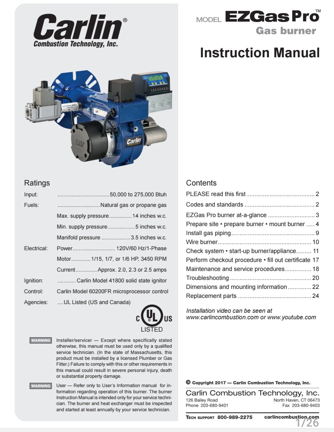

    @Rina, you're not getting a modern gas power burner installed without major fabrication to the burner door. Did you send pics to the heating, plumbing, and mechanical places? If so, maybe thats why the lack of feedback. Below is an example of a modern power burner. You can see the difference in the big rectangle opening in the existing burner compared to the round air tube on a modern power burner.
    Having a burner that has "GYROSCOPIC - BALANCE" is really awesome, but maybe it's time to upgrade the whole system. Then I'm sure they'll all come knocking.
