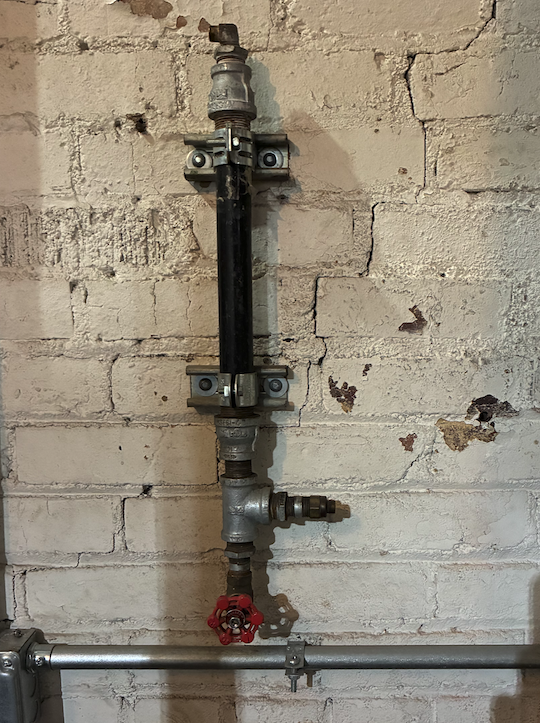

    You could do what they did in the Olden Days, the tube from the regulator feeds into the bull of a tee at the bottom of a 3ish foot long vertical piece of 2" pipe. A reducer to a small drain at the bottom, a reducer to main air at the top. If it worked with air pumps from that era, it should be fine with a modern one.

    You know, it was kind of working when I got here. The compressor was constantly tripping the breaker though. So I thought the compressor was just running too long and overheating. I shut it all down when I got the software updated on the boiler to include OA and night setback settings.
    There is a setup attached to the wall just as you describe that is abandoned. Might this be what you are describing?

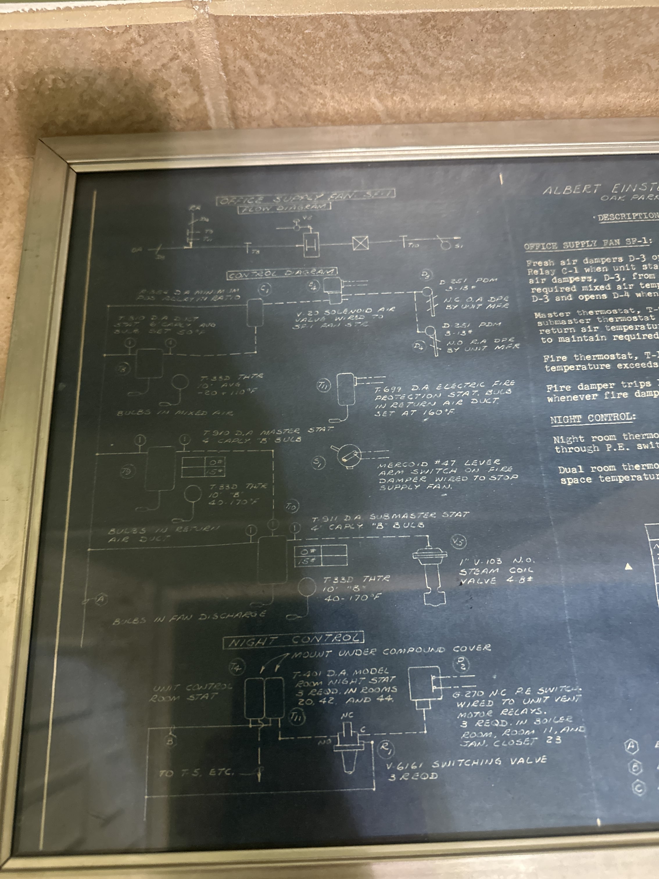

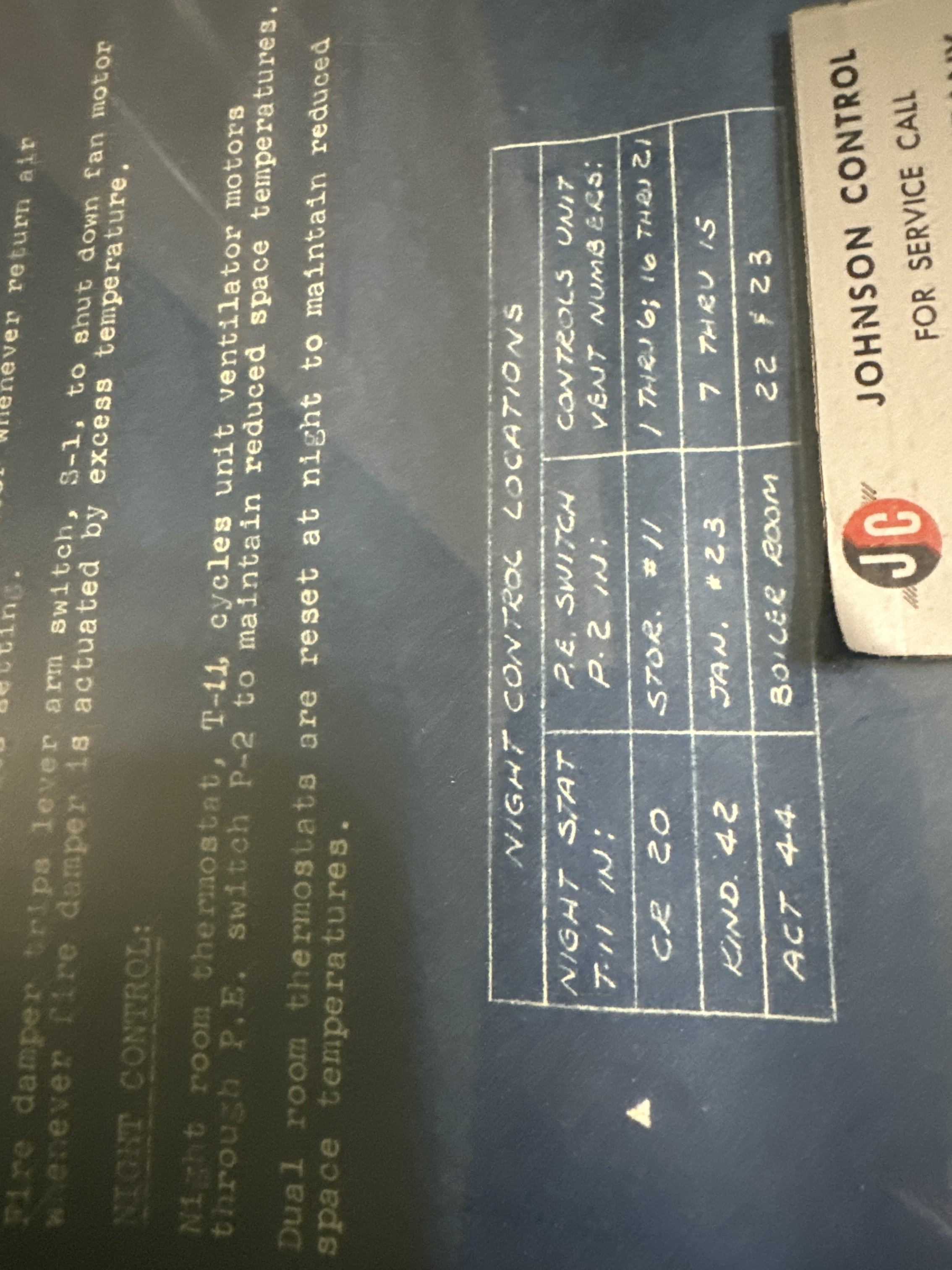

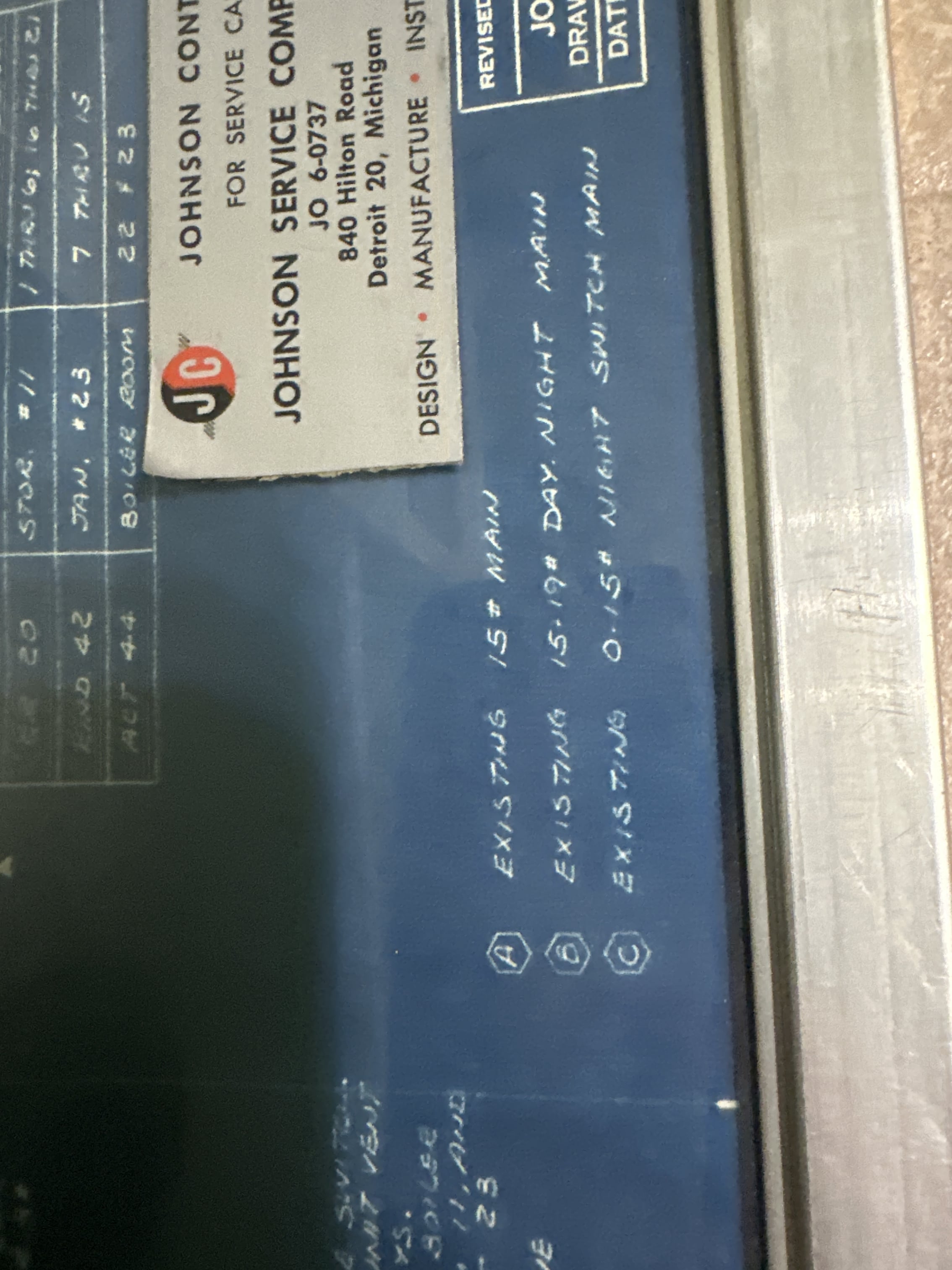

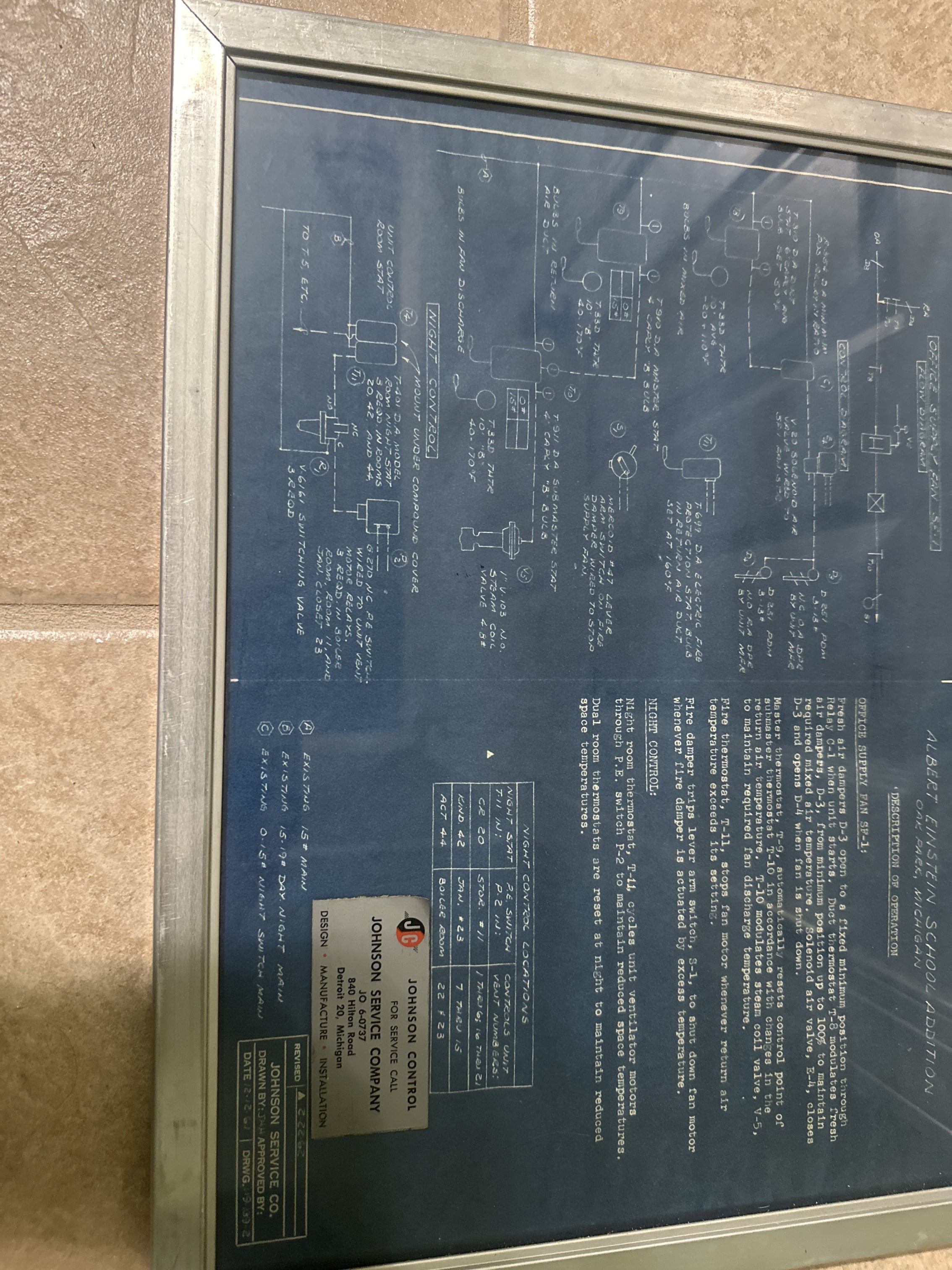

    As luck would have it. Here is an example of a small HV unit from a school built in the 60s where I did a fully DDC change over to. Hope this helps you see they did the controls via pneumatics
    EBEBRATT-Ed Member Posts: 20,712
    The good old days when "Blueprints " were really Blue.
    Nothing wrong with Pneumatics. They do need to be tended to occasionally to keep things working right. Unfortunately, they get neglected and then its a tedious road back

    Yes the stand pipe was used to drin moisture before the refrigerated driers. An auto drain and oil separator on the tank will help. Keeping moisture and oil out of the system lets the controls last longer.

    That's pretty much it.
