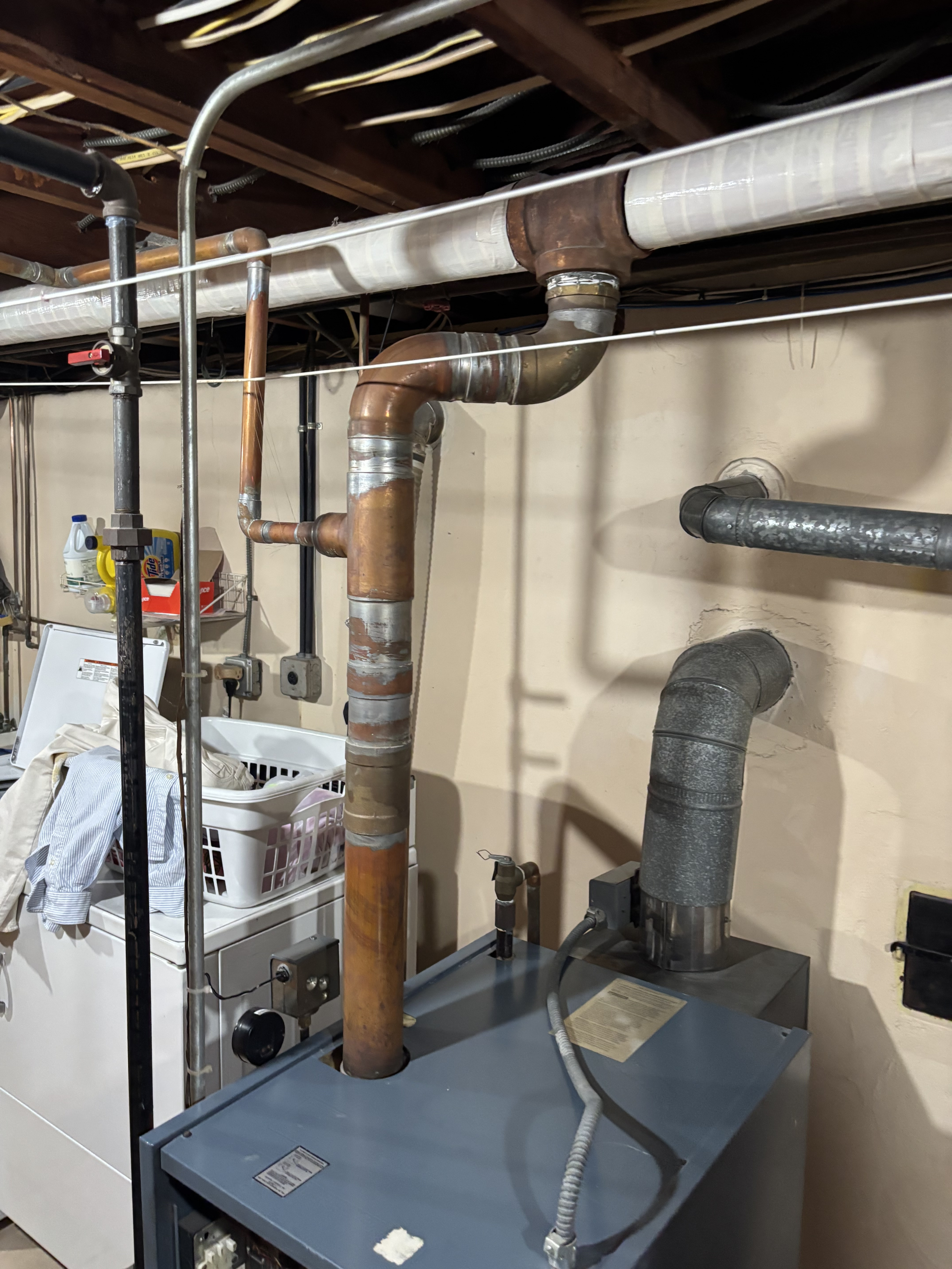

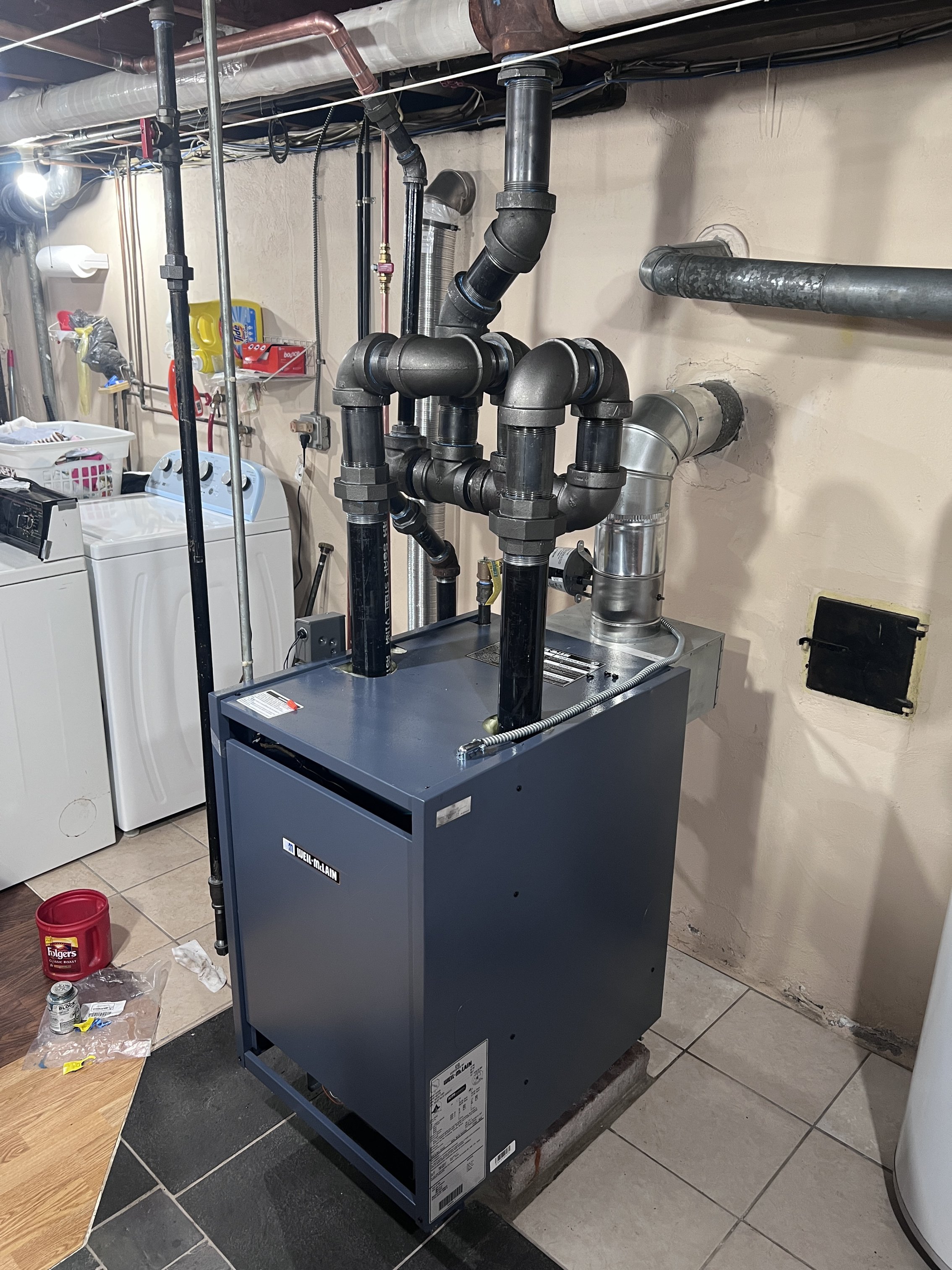

I have a customer who has one individual piece of cast-iron baseboard banging. The boiler was just replaced about 2 weeks ago. We flushed the boiler before installing, skimmed after installing and came back about 4 days after to skim it again. We didn’t add any SteamClean or anything. The banging happens all the time, and not just while warming up. And the I’m wondering if my guys didn’t give the one piece of supply piping enough pitch. I will attach a few pictures. First picture is the previous boiler. The second is the new boiler, and the 1” copper line is what goes to the baseboard.
Pitch back would be the first thing to check.
I hope you have the picitures reversed…
I agree. My guys are there now checking it out, so I will report back.
Hahaha yes, I do. I did not replace the CI with copper. Surprisingly though, that crazy copper piping lasted 35 years!
