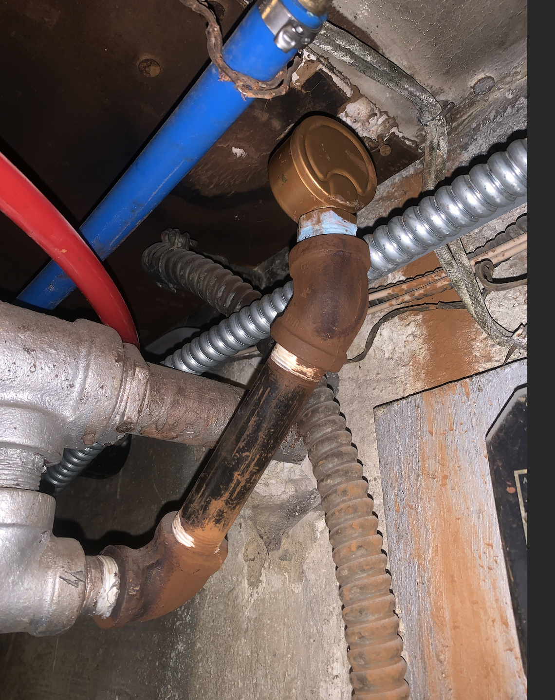

I replaced a vent at the end of my main line because the previous one was rusty. There was evidence of steam being hissed from the rusted stains on the walls.
Was wondering what the best way to fix this would be. I just had the boiler tuned up a month ago and the pigtail was blown out. Pressuretrol is set to lowest. (EDIT: actually, I properly checked it and it wasn't. Differential was set to 3. Lowered it to 0.5 for my 1-pipe residential system.)
I'm wondering if it's somethign to do with the piping or if it's just another faulty vent. I didn't have this issue with the rusted out Gorton I replaced, but I presume it was rusted shut…

    Steamhead Posts: 19,007
    Sure it's not sucking air in as the steam collapses?

    nc23 Posts: 14
    yes, I should have noted I visually saw steam being blown out. I took the pic after it stopped.

    Unfortunately, November3 and patrykeblsz are correct. When the steam pressure drops and there is not enough tension on the valve orifice to keep it closed, there will be hissing and the vent in question, has reliability issues. I address this in a discussion several years ago. Nothing to my knowledge, has changed. Also, how do you know that the pressure setting is the actual pressure. Buy a 3 or 5 Psi gauge.

    May be the location , it looks like it was installed in a wet location …

    The mud splatted on the wall is the tell-tail of a problem . That mud will foal up the vent .. You want a dry location for a steam vent..
  • nc23, If you fear water is an issue, simply cover the vent so that it does not get wet. You need to verify: 1] the actual pressure 2] is the new vent defective.

    Your vent is installed in the condensate stream . A dry location would be tapped on the top of the main , past the last radiator and before it drops down to the return . It looks like your main was extended from that connection ?

    I skimmed through the comments and it seemed like no one noticed the vent was tapped in below the main. I thought maybe I was seeing things.

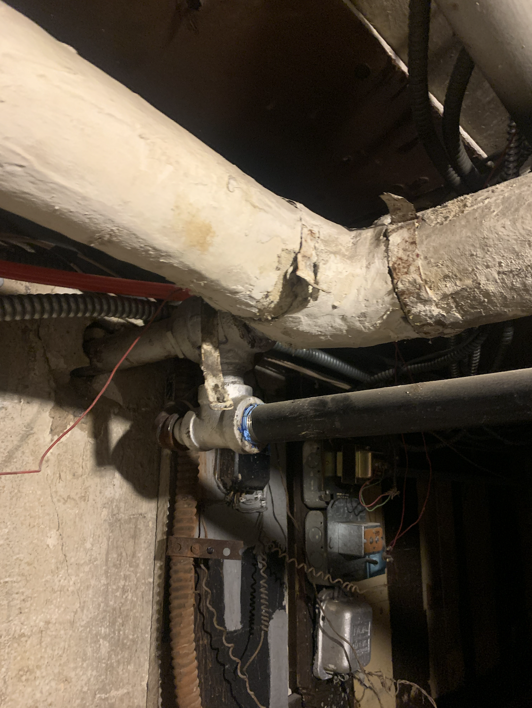

    Not sure on the piping there , thinking that section was repiped to add heat to a porch ? Also seems like the return is retuning back ? Thinking it may have a dry return ? I am thinking a King vent which is a main vent piped at the connection of the last radiator , but need more info ..
  • nc23
    nc23 Posts: 14
    Now that I really look at it I'm not super sure myself.
    I only have one radiator up front yet there are two pipes. One goes through the wall; the other is insulated in asbestos and goes up. I'd thought this asbestos one (the main) went up to the radiator.
    There is a riser to the second floor on the back side of the house.
    Here's the view from the left side.
  • Big Ed_4
    Big Ed_4 Posts: 3,585
    The lower pipe that was added , we need to follow it…
  • nc23
    nc23 Posts: 14
    edited November 2025
    The literally lower pipe (the black one with the blue teflon tape) is definitely condensate return that goes back to the boiler.
    The silver pipe before the main turns I have no idea how to follow, save for removing some of the old, potentially asbestos-ridden sheetrock above. It does get warm because I can see my thermal camera has it hot when the boiler is on. Any other suggestions?

    nc23Long Beach Ed
  • Big Ed_4
    The water line on the glass gauge maintain 1/3 full . Don't over fill and keep the pressure low.
    The king vent will work there..
