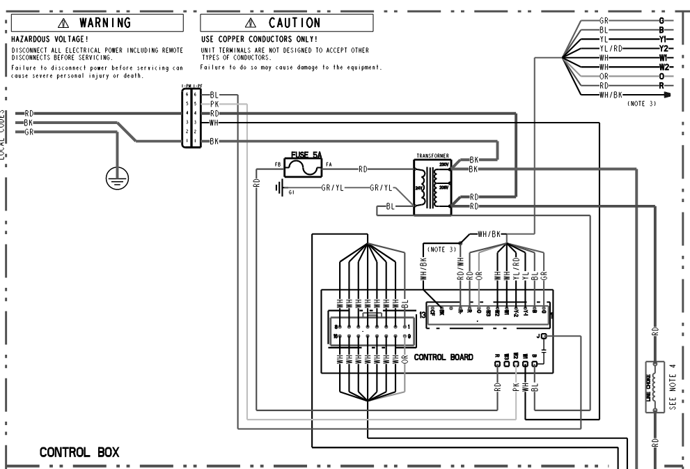

Where is the 5A fuse on the 24v transformer in the Trane tem6 air handler?
I am trying to find the 24 v secondary fuse that powers my thermostats on the Trane Tem6 air handler, but don’t see it there or on the zone controller board. The installation manual also does not have a pic of its location. I have attached a pic of the mother board which has a DIP switch and several diodes but no fuse. The xformer is just behind it and has a wiring harness with a large connector. Is the fuse in line or elsewhere on the board?
Thanks in advance.
    mattmia2 Member Posts: 17,905
    what is this right here? what colors are the wires to the fuse on the schematic?
    HVACNUT
    109A_5 Member Posts: 4,346
    edited November 2025
    That looks like the fuse @mattmia2. The 5A fuses are amber or yellow color if I recall correctly
    EDIT: I just zoomed in close and it appears that fuse may have blown @PhilKulkarni

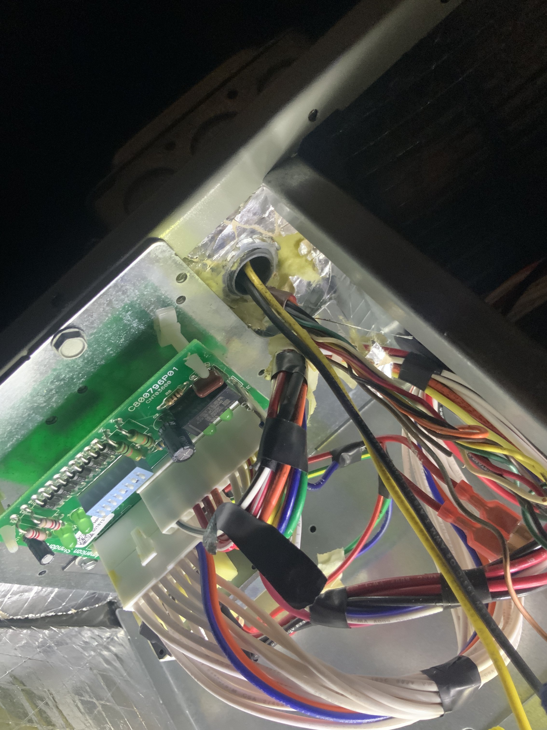

    Here are some pics of the zone controller. These were taken with a flash and do not show the LED status. The last 3 white LEDs are turned on while the red led between the yellow and green is turned on.
    I show no voltage on the condensate overflow detector, and it is off-the test button also doesn’t work as a result. I have 27.5v at the thermostats for each of the 3 zones.
    A few things;
    What is the lit up Red LED for ? IDLE maybe ? The documentation is a bit lacking.
    What is the actual issue you are trying to resolve ?
    Since the " Not clear why, since the accidental short at one of the stats left the xformer fuse intact. " have you completely powered down the whole system ?
    What wires were shorted at the thermostat R and C ?

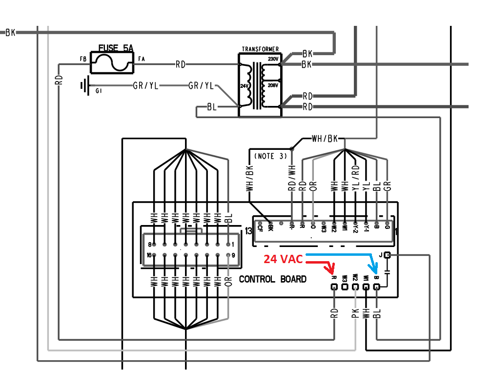

    Looks like there is two 24 VAC power sources, maybe three ???

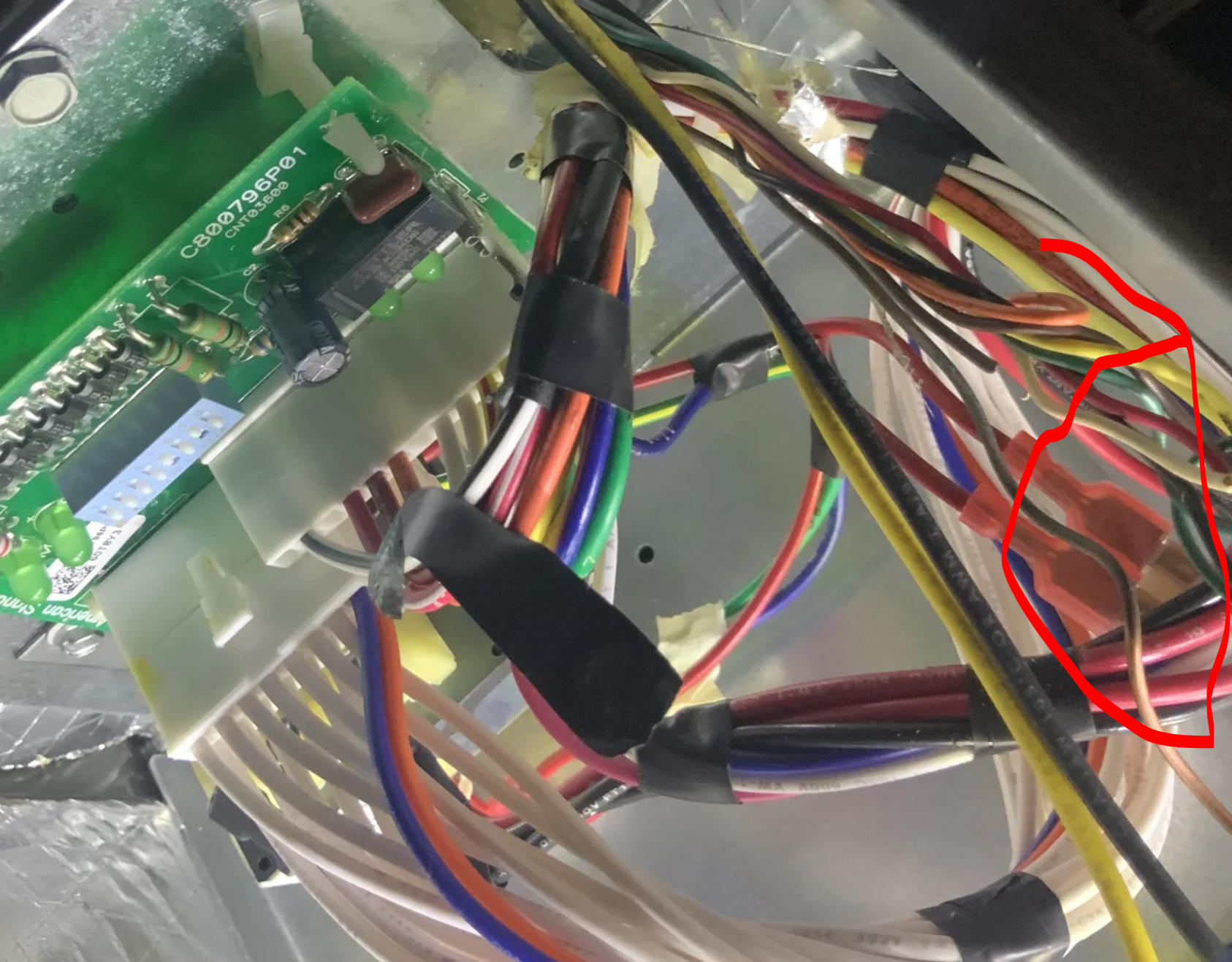

    I believe the component at the Orange arrow is a self resetting (PTC reset) fuse. Have you tried a complete power down with a 30 second or more delay before reapplying power ?
    The Blue terminal (Red arrow) is a bit twisted, hopefully it is still electrically intact.
    What transformer powers the 'condensate overflow detector' ? Is it only active in A/C mode ?
    Maybe the microprocessor got glitched, seems the LEDs are in a strange pattern. Cycling the power or the Boot button may help.

    The left side transformer is inside the TAM6 air handler. That would be normal for a zone controller of any type.   The transformer that operates the dampers (or zone valves on Hydronic) should be isolated from the AHU (or boiler transformer)   That is how zone controllers work.

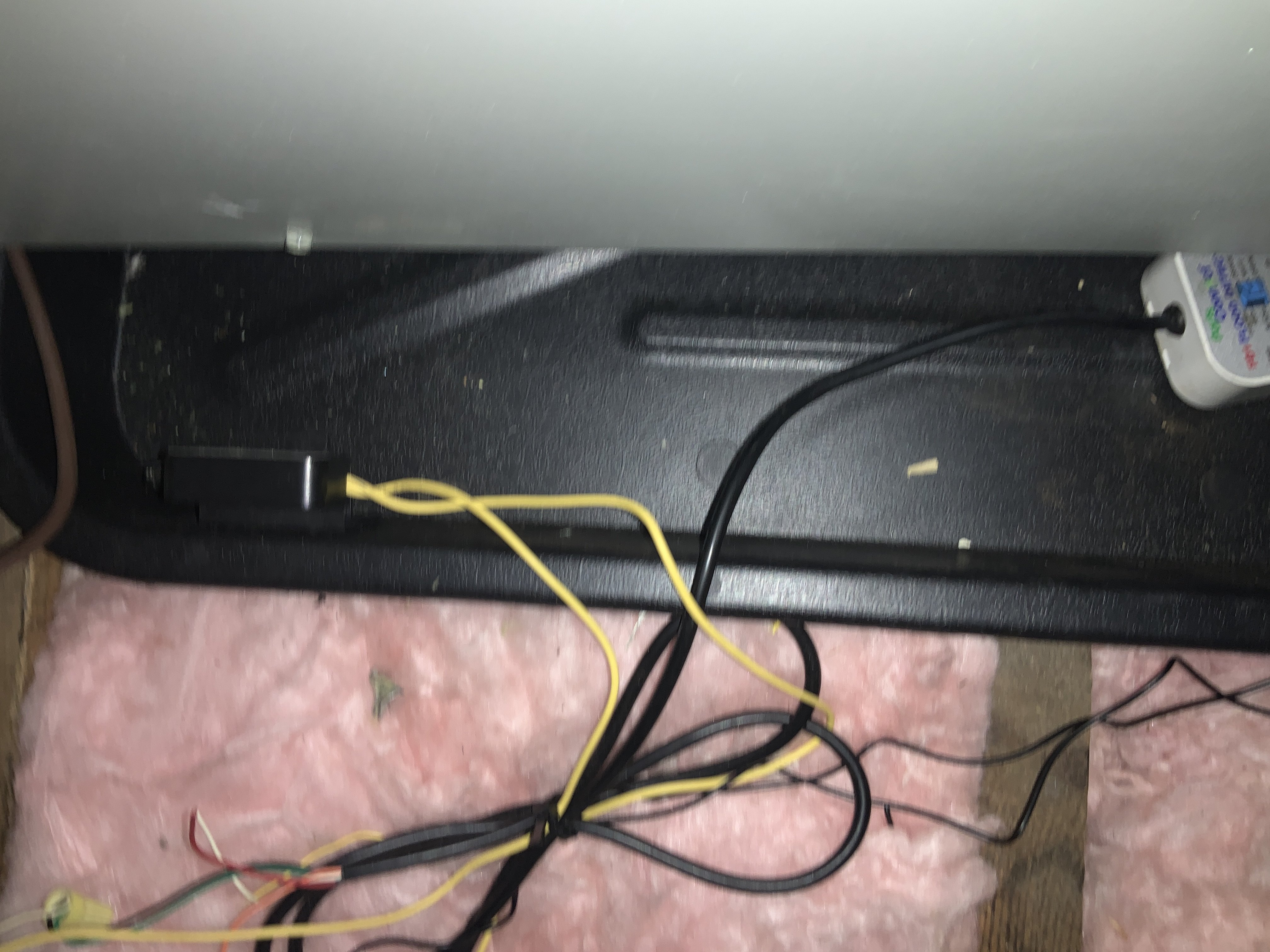

    I have two switches for cutting off power to the air handler in case the condensate overflows. One is a mechanical float switch and the other is a water sensor that sits in the tray. Both are NC and in series and thus the unit will turn off even though the sensor has no power. I will check if it interrupts the Red xformer wire or the yellow one and rewire for yellow as suggested. The problem right now is that the sensor switch has no power. All the 3 wires are connected tightly. I may have to remove the air handler panel again and trace the wires back to the Rand B wires on the xformer after the fuse.
