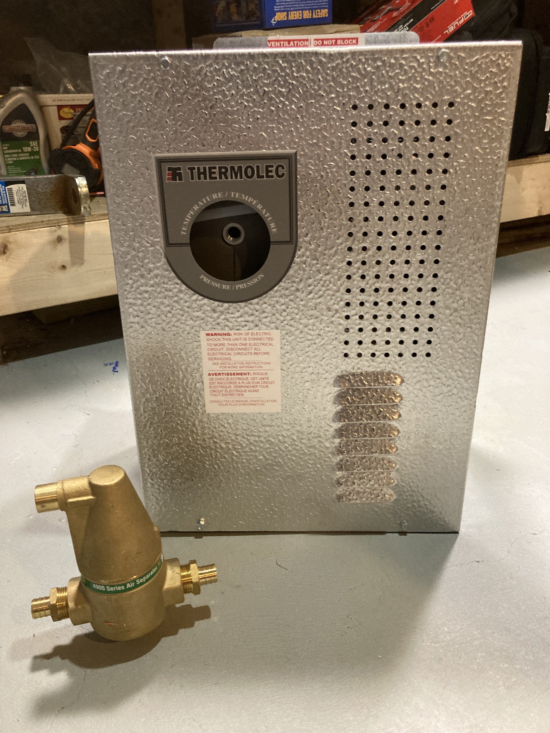

I have a small underfloor heating setup and the primary hot-water source is a 10 gallon tank heated by solar. It heats the water up to about 90 degrees F into the loops and 80 degrees F on the cold return, feeding 4 loops about 250 feet each. I purchased a new Thermolec 3K mini boiler and air separator to add to the system. I need some advice on the correct location of the new boiler and separator. Can I feed the hot water outlet from the hot water tank to the cold inlet of the boiler and then the hot outlet of the boiler to the loops. The cold return from the loops would feed the cold of the hot water tank? see attacked pic. Also, what would be the best location for the air separator?
If my thinking is in correct, any help will be appreciated.
Thanks

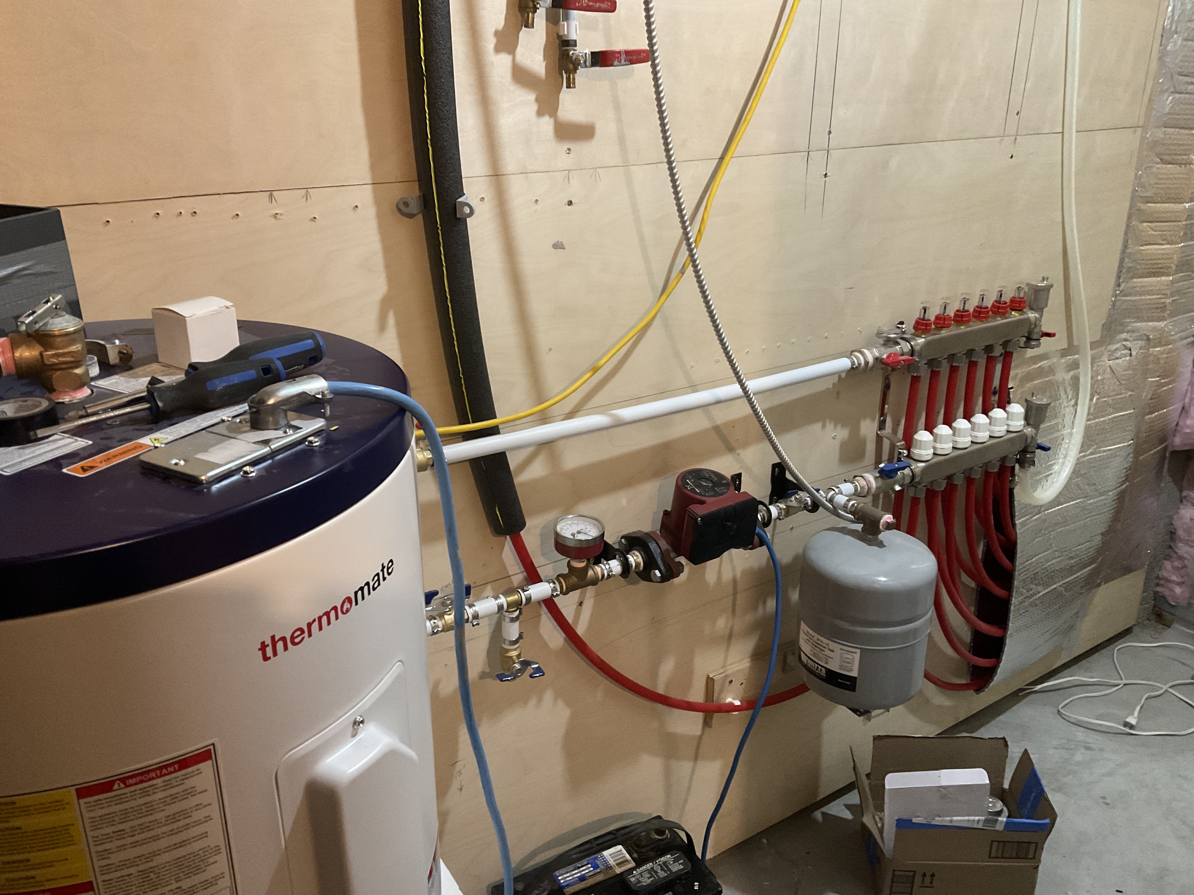

    Is that expansion tank on the INLET side of the pump? I hope so.
    Otherwise the general concept looks good.

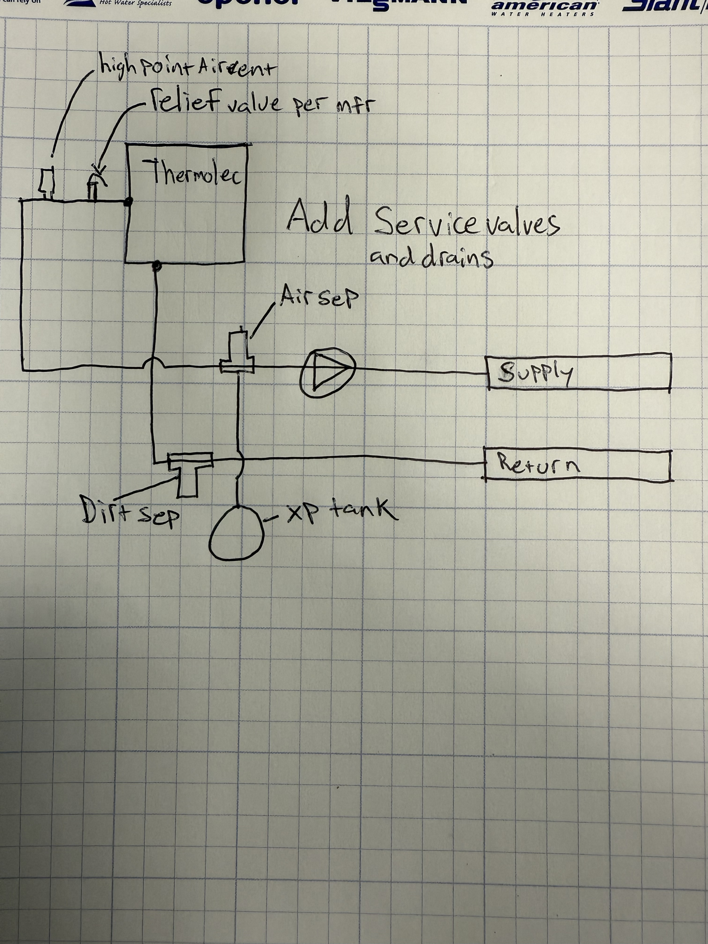

    I would install the boiler on the hot feed to the floor heat loops. Set the boiler to a temperature bellow what your solar can deliver. This way the boiler will only run if solar is not putting out enough heat.
    Something like solar tank→air sep→pump→boiler→heating loop.
  • GGross
    GGross Posts: 2,104
    edited October 2025
    just saw you are keeping the solar disregard my drawing

    hot_rod Posts: 28,705
    Is the solar a closed loop glycol system with a solar heat exchanger or solar tank?
    Also, turn the Grundfos so the motor faces out, when you make the changes.

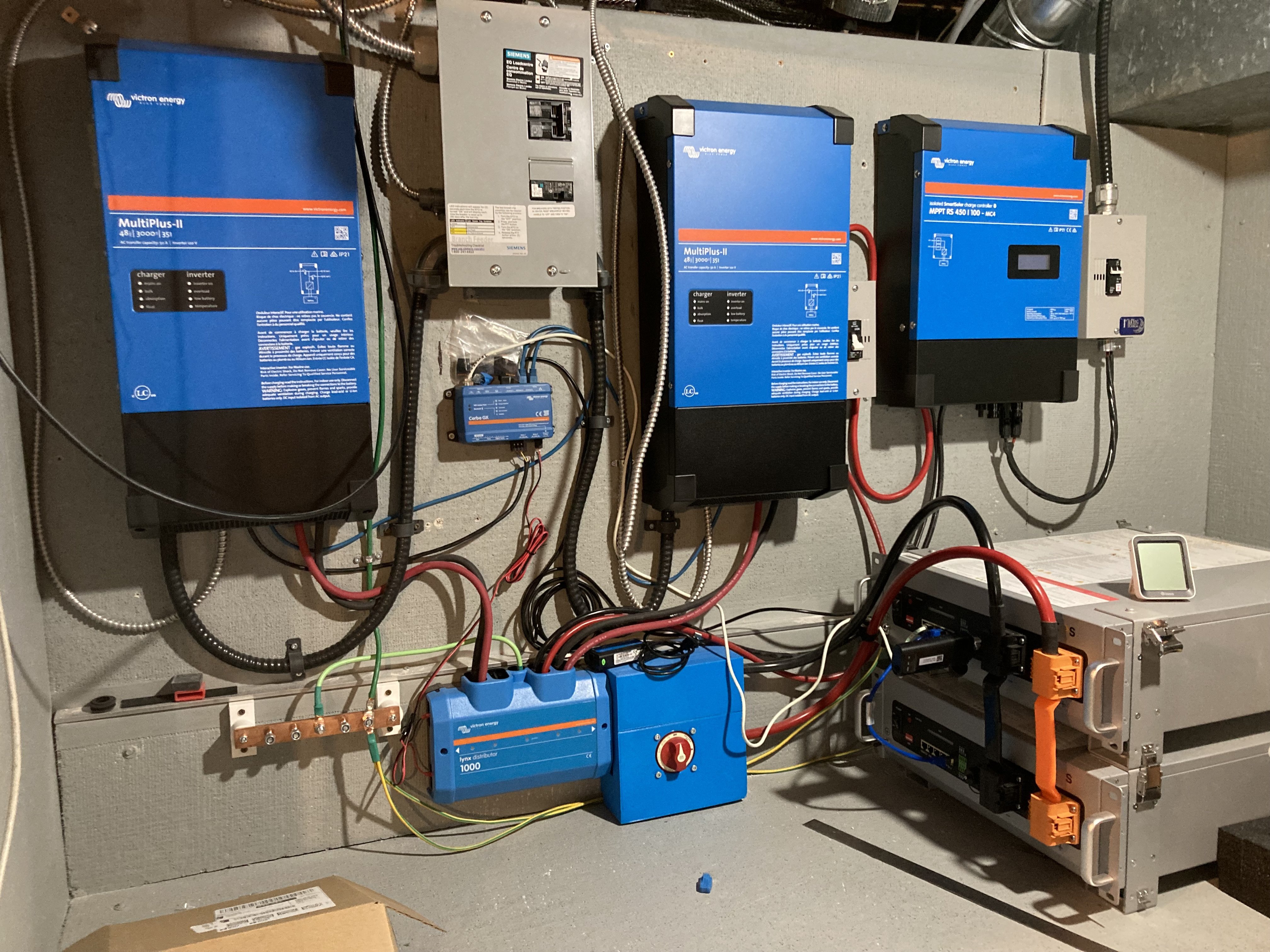

    I have a 4 kilowatt solar array that keeps my Pytes batteries charged and Victron inverters that send AC to the 10 gallon water tank. If I have a day or two of no sun I need the boiler to kick in.
