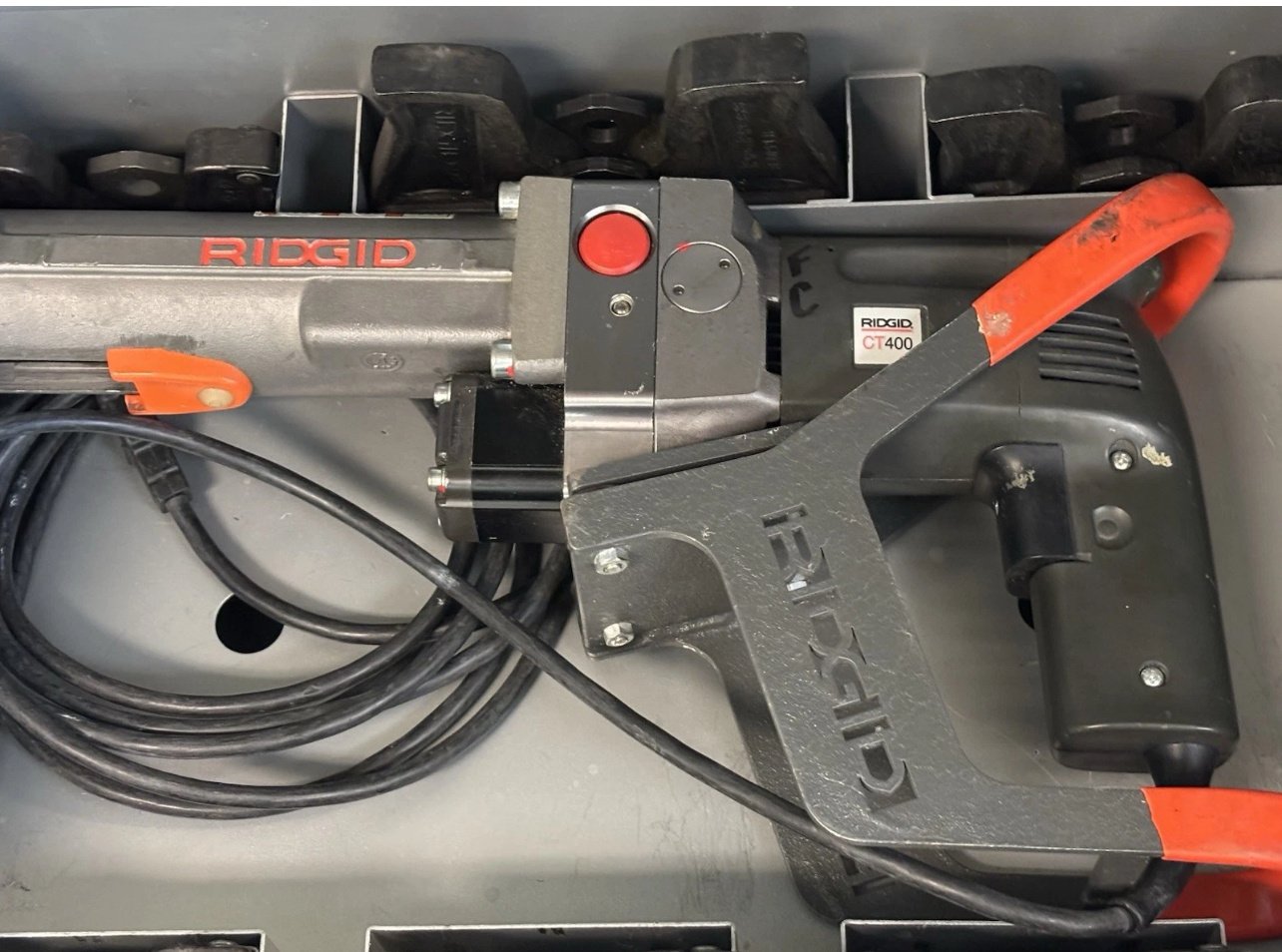

Hi guys, wondering if there is any recalibration and maintenance procedures in a PDF somewhere for the CT400. I know the tool is obsolete but I can find identical parts on my own such as orings, seals, etc online. I’m handy in that aspect.
just wanted to know how to reset the counter and if there is any shop manual with parts list and diagrams.

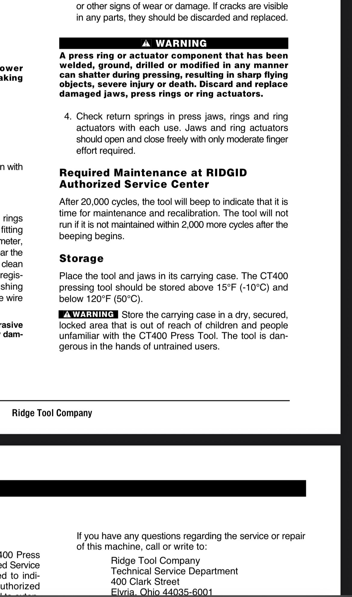

here is the manual
I think it needs to go to a Rigid service center for recalibration

My guess would be Ridgid won't provide you the info you need to reset the machine. If you bring it in they may tell you to buy a new one.
All of what you ask can be done by a DIY'er. The calibration, however, must be done by a Ridgid repair center.
