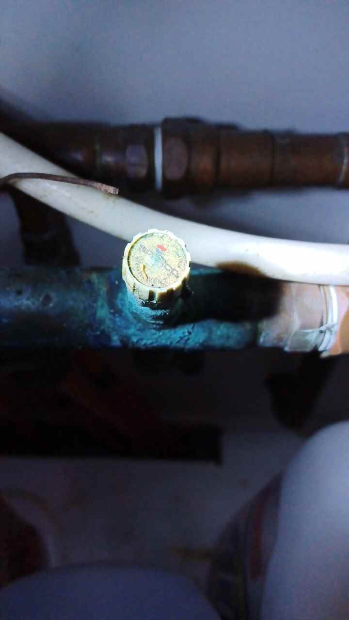

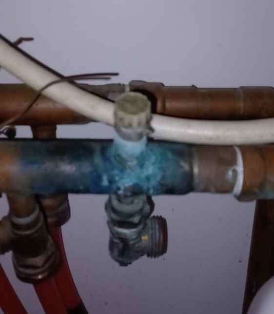

    I found some evidence of leakage on one of the air vents. I see some air vent specs state they can be taken apart for cleaning - is this a maintenance item that needs to be done periodically? Should I be getting better ones? If so I see some brass ones such as Taco 400-4 and Watts FV-4M. I have a similar looking Amtrol device near my pump but don't see a model number.
    Should I be using distilled water if my domestic water has high mineral content?
    Here is a pic of the vent.
    hot_rod Member Posts: 27,904
    There are a few brands of auto vents that cannot be disassembled, the top is crimped on.
    Most of the forged brass type can be disassembled and cleaned or rebuilt. Often a speck of debris is in the small needle valve inside. Clean ad reassemble.

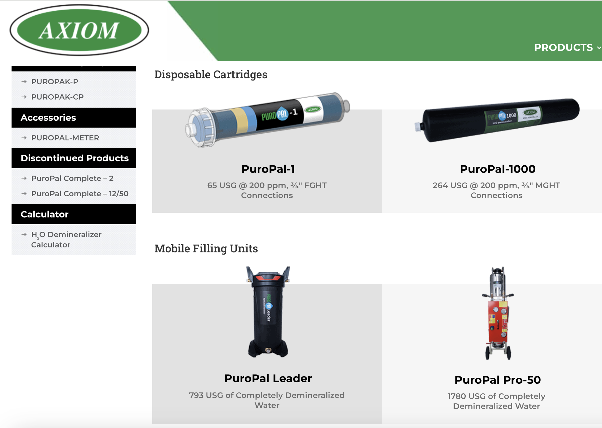

    If your water is over maybe 10-12 grains hard or high TDS, it is good to get some filteted water. Boiler manuals give you water quality specs. IO'll attach a few.
    True distilled water is hard to find and expensive. most filtered water you see in the stores is either run through a RO unit or a media for DI deionized, or DE demineralized water.
    For small amounts 5 gallons or so, places like Walmart have water machines that you can fill your own container.
    Water treatment companies will generally fill a 55 gallon drum for you.
    Another option is to buy a demineralizer cartridge and connect to a hose to filter water on site

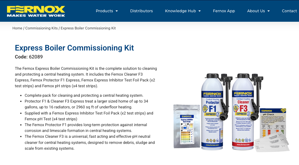

    A 3 step process. Run a cleaner first to dissolve any oil, flux, pipe dope etc. Flush that out, add good water, then add a hydronic conditioner.
    The conditioner adds a thin film over the cleaned bare metals, has an oxygen scavenger and ph buffer to protect all the metals.
    There are easy to use kits for this now. They screw onto a hose thread, like a boiler drain to squirt in.
