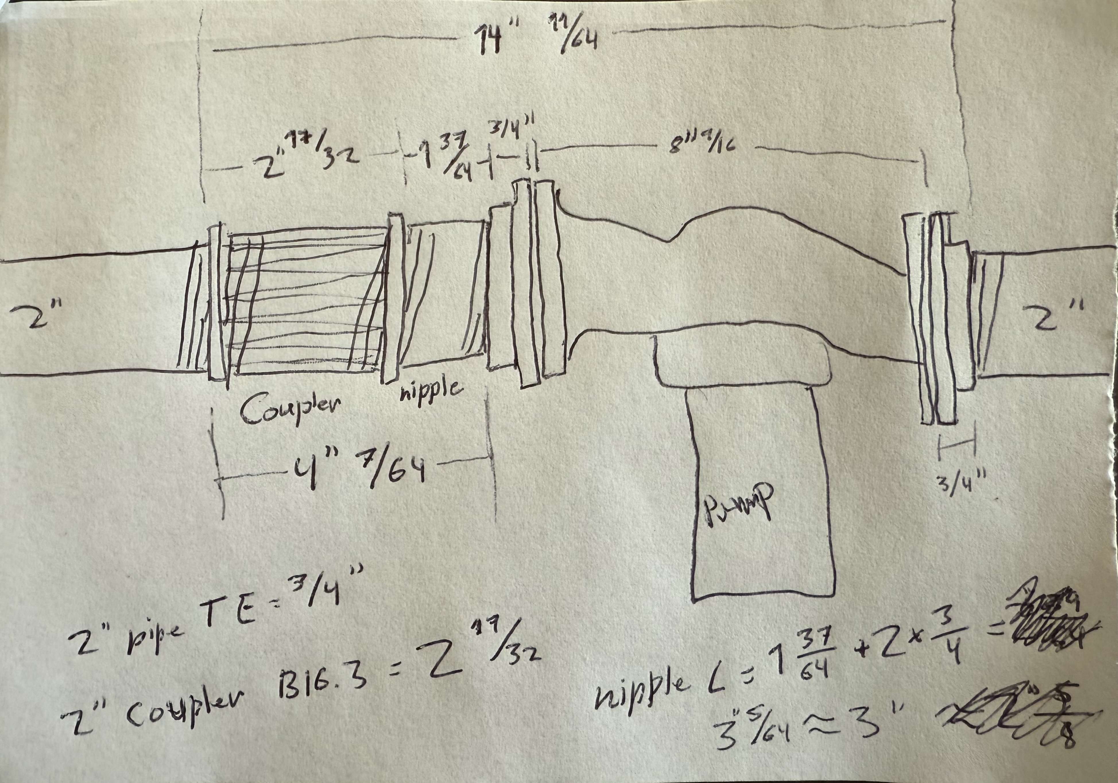

If I go with this pump then I also need to shorten the pipe. I've done plumbing and have changed a pump before, but I've only worked with copper and PVC, so this black iron stuff is new to me. I don't have NPT thread cutting tools, so I'm hoping to get by with a coupler and nipple. I did my research and based on all the measurements I have, a 3" nipple is just about right.

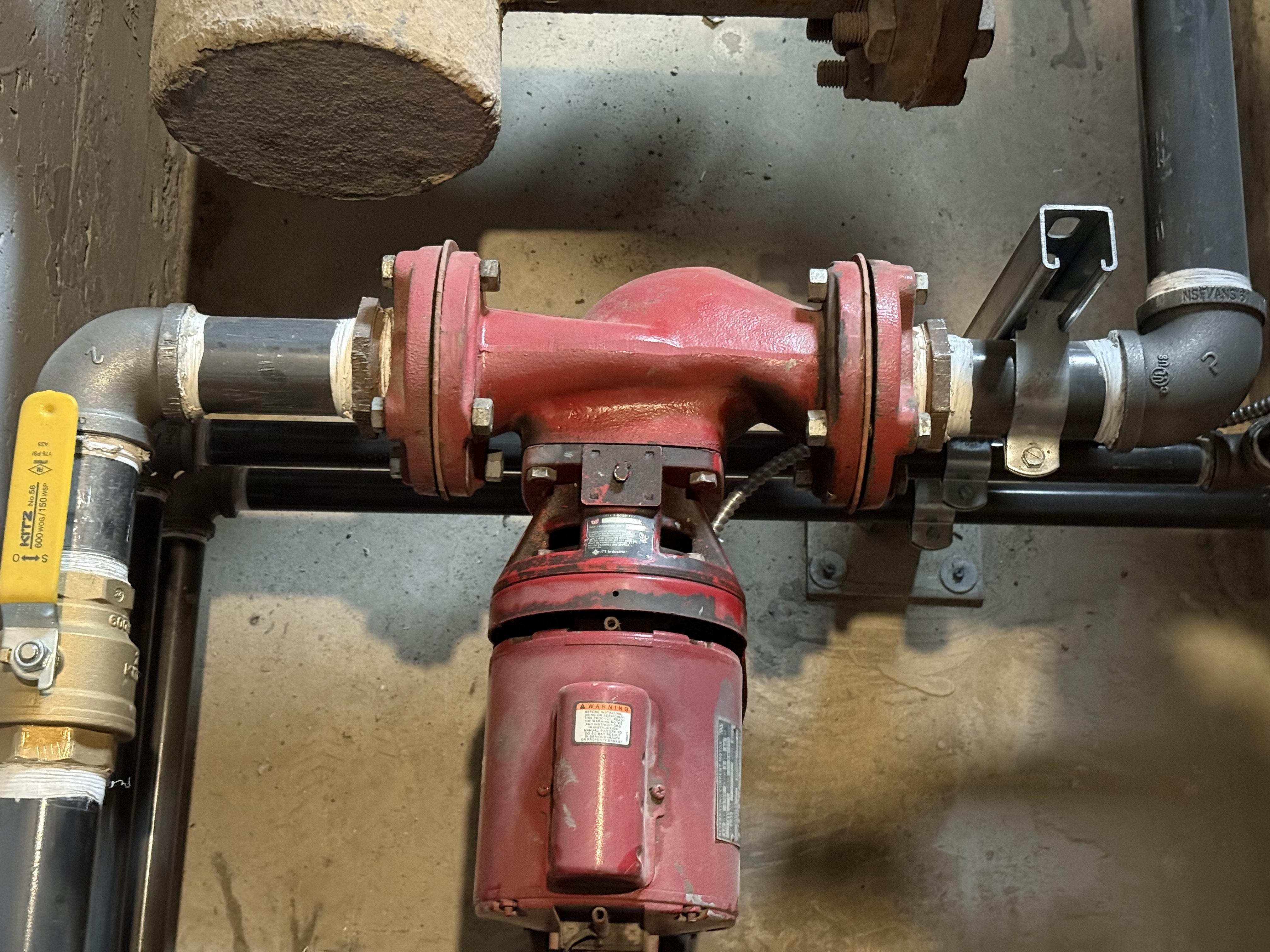

Here's the current setup: I plan on removing the 2" 1/2 thread adapters and lengthening the left pipe for the shorter port-to-port length of the Grundfos.
And the math (sorry for the bad handwriting):
If I understand correctly, couplers have a standard length, and for 2" pipe I need 3/4" of thread engagement. I also did the math in metric since most spec sheets gave metric values and I don't trust my knowledge of imperial measurements, and arrived bang on at 3" (7.62 cm).
I found a domestic supplier for the pump, coupler and nipple. I think all I need is two 18" pipe wrenches, which should be suitable for 2" pipe?
Will this work? I don't want residents angry at me because they don't have heating…

    You may want some extra nipples one size longer and 1 size shorter on both sides of the pump.
    You can look up the "correct" make in allowance for fittings but in the real world that sometimes doesn't work out do to manufacturing tolerances and China made fittings.
  • DDoS
    DDoS Posts: 22
    Should I extend both ends or just one? Seems like only one end would be easier. Fewer parts.
    But yeah I should buy the next size up and down to be safe.

    This type of strut clamp may be all you need, they make a big difference for noise and vibration dampening

    My thinking is you haven't got a lot of room for a coupling. It may fit it may not fit. You may find that if you shorten the nipple on 1 side and slide the pump over you will have more room for the coupling on the other side.
    Also changing two nipples and installing the coupling will then give you 6 threads to work with which will make getting the space between the two flanges you need easier
  • DDoS
    DDoS Posts: 22
    I see, but I checked the measurements and I don't have room for two couplers.
    You don't need two couplers. I gave the example in case you can't fit one in one side you can change just the nipple on the other side if you need more room

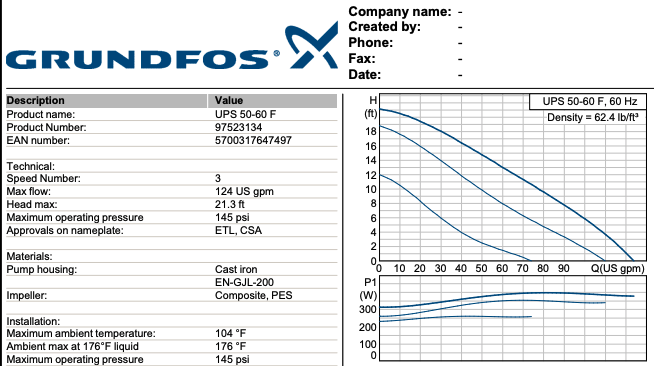

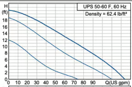

    After some more research, I think a Grundfos UPS 50-60 F is maybe a closer match? If I don't want to undersize. Looks like it's a 3 speed equivalent to the discontinued UP 53-45 F in the equivalency chart.
    hot_rod Posts: 28,705
    If you don't have the gpom or head data, look at the boiler. Say it is a 250,000 divide by 10,000 and you need around 25 gpm to move the heat around at a 20∆. So you need a pump that can at least move 25 gpm. Head is a bit trickier to guesstimate.
    Unless you have small coil, high pressure drop fan coils you probably do not need a real high head version.
    Ideally the gpm number is in the middle of the pump curve.
    So depending on the speed the 50-60 wants to flow 30-70 gpm to run mid.
    On speed 1, 30- 50 is mid curve.What size is the boiler?

    A cushion clamp is what you need for this and perhaps a rubber cushion at the base to absorb more vibration.
    Generally, when you have vibration like this the bearings are going bad and all you may need is a new circulator assembly.
    You will know if the motor end bearing is bad if the shaft can be pushed/moved too as the outer race will be bad as well.
    If you have an engine stethescope you can quickly identify bearing noise and cavitation/air bubbles being generated in the circulator housing too indicating a severely worn volute.
    Before you waste your money, invest in an engine stethescope to listen to the noises being made as you will quickly find the cause.

    The boiler is 650,000 btu/h. For head I have no clue, this is an old building and I have no official information about piping.
    Digging up a previous tender, they suggested a Grundfos UPS53-55/57F, which is quite a bit more powerful than the B&G.

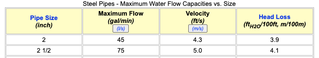

    Avoid over-pumping, it leads to noise ad pipe ad component wear. If the boiler is a 650K input X 82% efficiency then the boiler output is 533,000 BTU/hr so around 50- 53 gpm.
    My guess with the info we have is this circ is a close choice. The 3 speeds give you some wiggle room.
    2" schedule 40 pipe accepted flow rate typically 45- 50 gpm

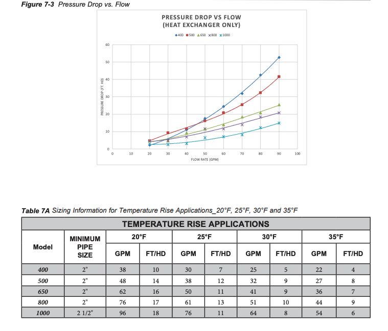

    if you have a 97% high efficiency boiler, you need to check the pump spec for that also. Some of the high efficiency boilers have high pressure drop heat exchangers and need to be primary secondary piping
    Got a pic or brand and model?

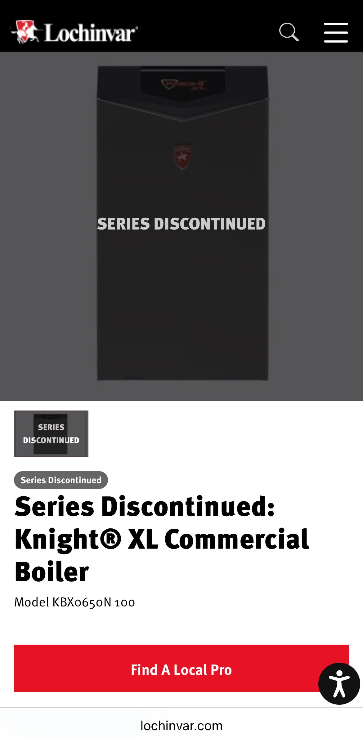

    I think the 650 is a discontinued model?

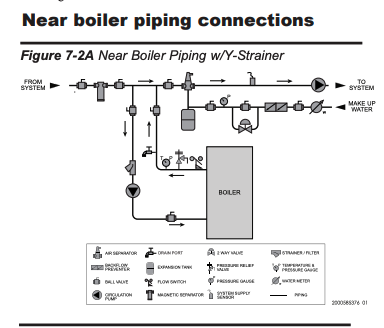

    It should have a dedicated pump, and be piped primary secondary as the manual shows. So you should have a two pump system?
    Here is the pump spec for the boiler depending on the delta you are running. At a common 20 delta it needs 62 gpm!

    Yeah it's two pumps, sorry if that wasn't clear enough. The boiler feed pump is fine, it's a brand new Grundfos UPS43-100F.
    It's the main loop pump that needs to be replaced.
    Edit: I don't think it's discontinued, this is what we have: https://www.lochinvar.com/en_US/products/commercial-boiler-knight-xl/kbx0650n-110/100381763.html
    when I looked for the manual, this is what Lochinvar shows, although the manual is still available
    I think they have a Knight 600 and 700 now.

    Important bit with a modcon is make sure the outdoor sensor is installed and a reasonable reset curve set in the boiler. This increases the efficiency and reduces the cycling on the unit so it is a win win in terms of operating cost and boiler life.
    With PS piping and a modcon boiler, the secondary pump should be sized for your load not the boiler. You can look at your heat load if you have a man J estimate or fuel use during previous heat season. From there you can figure out how much water you actually need to flow. If you are not replacing with an ECM at least go for a 3 speed unit so it can be adjusted once running. Getting the rad delta T dialed in gets you a couple more precent efficiency as well. With older gravity conversions you do have to watch low flow rate though as some rads might end up getting starved.

    You have three parallel pipelines stacked on top of each other with a solid wall on the left side and three clamped pipes to the right of the circulator.
    If after you find the circulator is not going bad the next thing would be to invest in rubber isolation clamps for the steel leg and a rail mounted on the wall for three more rubber isolation clamps to further absorb any vibration as circulator/pump vibration can travel for long distances in unsecured piping.
