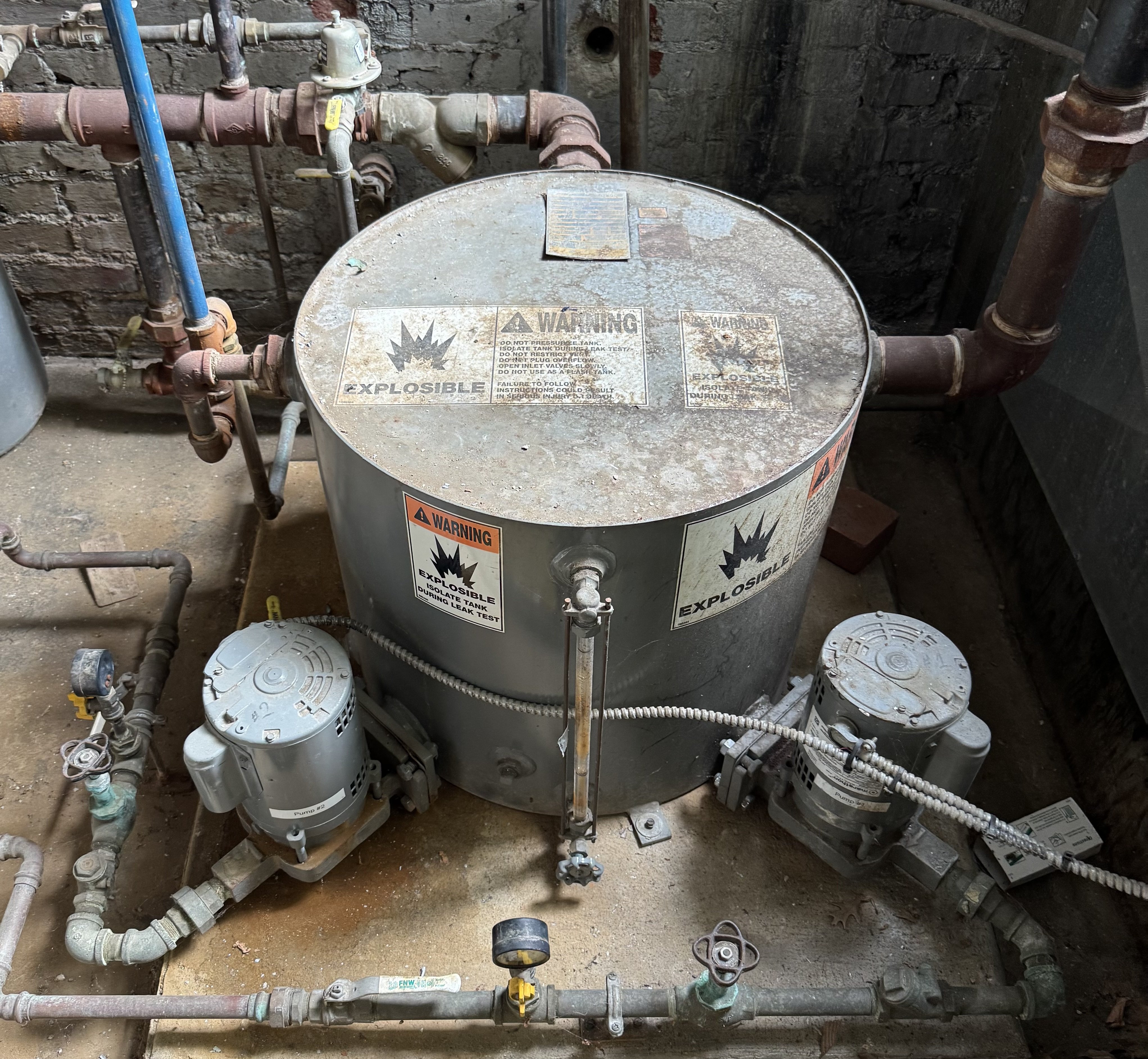

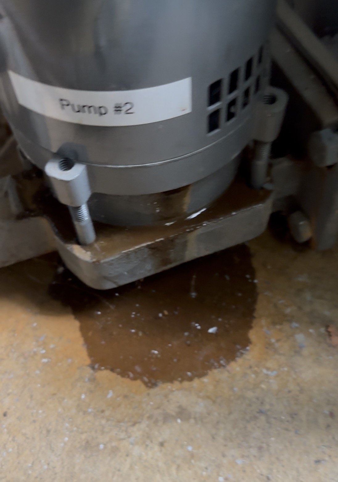

Hi all. I could use some advice on problem I'm having with my church's commercial steam boiler. The condensate tank has two pumps and one is occasionally making a very loud whizzing/grinding noise (sorry, hard to describe it exactly) for several seconds and then water leaks from the base of the pump. The system otherwise appears to be working properly.
Seems like, at the very least, the seals need to be replaced. But maybe the noise indicates there's a bigger problem with the pump, and it needs to be replaced entirely?
Also, is there any concern with continuing to run the system while this is happening?

    that’s a sign of a seal leak.
    as far as the noise it has to be opened to know.

    Leaking pump seals and bad pump side motor bearings go together like a nut and bolt. Once the shaft seal starts leaking, the leakage gets into the bearing and it goes bad shortly thereafter.
    It's always recommended to change the motor bearings whenever the shaft seal is changed.

    You can probably get that pump fixed at a motor shop.
    Shut the boiler off and kill the power to the pump. Drain the tank and remove the pump. With the pump off get a piece of 3/4" plywood and cut a piece you can bolt to the tank flange after drilling bolt holes in the plywood.
    Get some gasket material at a plumbing supply or an auto parts store.
    Boiler feed tanks are vented to the atmosphere so there is little to no pressure on the tank so the plywood will hold up.
    I would call the motor shop and explain the situation and give them model/serial and pictures of pump and pump and tank name plate. That way they can get some parts ahead of time or find their availability. Have the bearings in the motor changed as well as the seal and get new gaskets.

    Other brands of boiler feed pumps are available that may cost less. The 2.75 X 5" suction flange bolt pattern is used by 4 different manufacturers that I know of.
    That said, a new seal kit and motor bearings should be all you need to get that pump going again.
