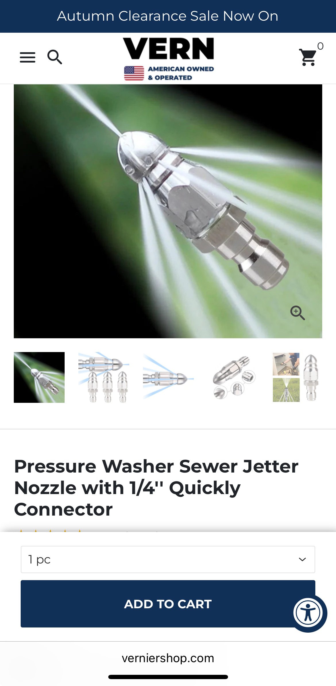

    A sewer cleaner with a jetter is another option. They have reverse heads that blast water back out as it runs in
    If you have access to a pressure washer get a head like this, and run it in
    you might need to attach some sort of almost ball shaped guide an inch or 2 in diameter just behind the camera on that borescope to let it ride over the corrugations instead of jam and wedge in to them.
  • I actually bought this pressure washer on sale last week: https://www.bestbuy.com/product/greenworks-pro-electric-pressure-washer-up-to-2300-psi-at-1-2-gpm-green/BL6VJXCP3C
    I've never used one before and haven't opened it yet. I was going to return it because I read bad things about green works after buying it. Maybe I'll keep it and try it on the downspout. But how does the water jet navigate turns though?
  • I did think of something along those lines, like drilling a hole in a tennis ball and attaching the camera through it. Is there a specific tool for this purpose? I tried googling what you suggested and didn't see anything that I'd think would work.
    Ultimately, I still have a hard time seeing how this thing is going to manage to turn corners.

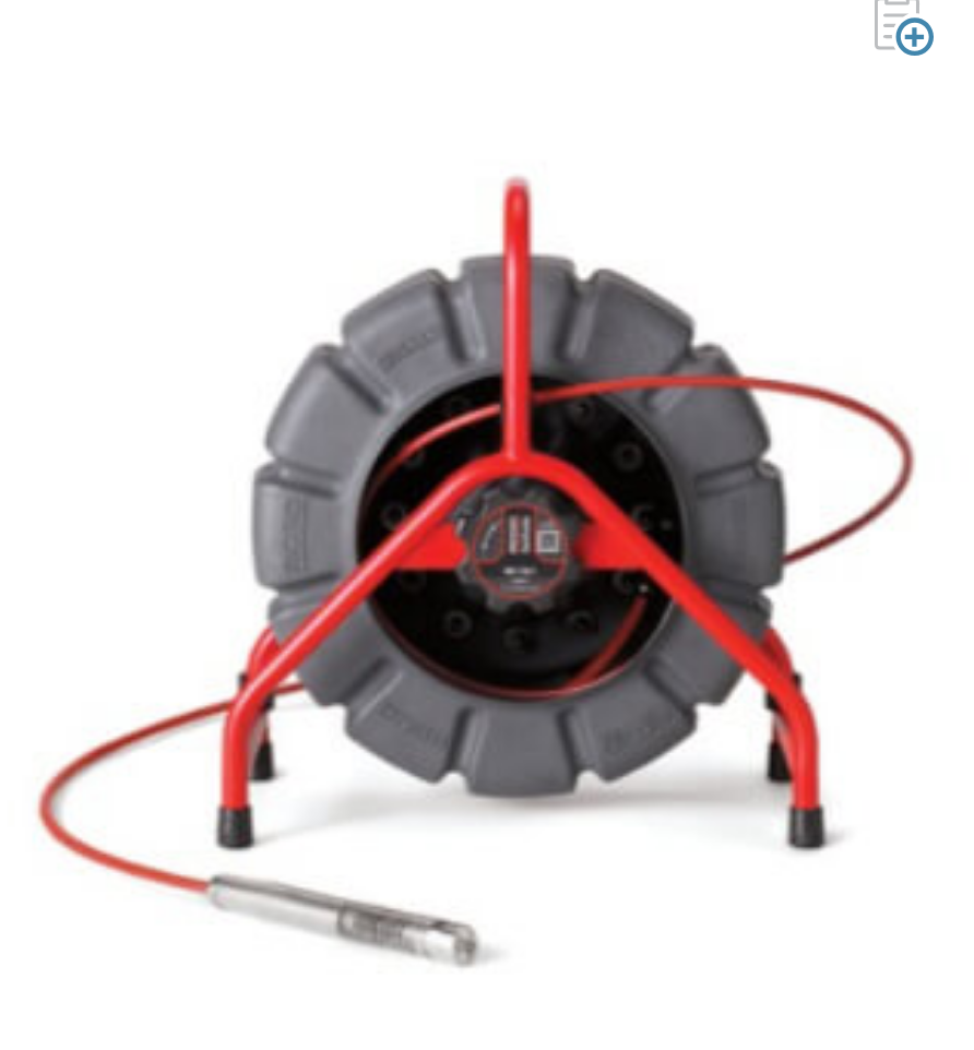

    Before you go any further you should invest in a good sewer tape from a plumbing supply company and zipo tie the end of the sewer tape behind the camera head and every 5 feet after that and then pass it through the piping if possible as the sewer tape will provide you with the fulcrum/stiffness needed to push the camera cable through it UNLESS and only unless the drain pipe is totally blocked like mine were.

    Wait, is this the sewer tape? https://www.homedepot.com/p/RIDGID-3-4-in-x-100-ft-E-2731-Drain-Cleaning-Exposed-Sewer-Rod-Flat-Sewer-Tape-w-4-Sided-Spear-Tip-Carrier-62565/202826662
    I probably don't need much but still 100 ft for almost $200 seems really expensive. I thought they'd be priced like regular tape lol

    You want to make the cable and camera stiffer to assure it does not try to make a U turn in the pipe.

    look on ebay for sewer rod/tape and filter for under $75 or so. like 20 years ago I paid like $50 for a 100' 3/4" general homeowner grade rod but the cost of steel and antitrust activity in retail sales has driven the cost of new name brand way up.
    also if you want to do digging, you can probably find it for much less used on ebay from people that don't know what it is so it won't say "sewer" or "tape" or "rod" in the listing so you will have to be creative.
    real sewer cameras have a bulbous head on them that will turn the somewhat gradual corners that sewers should have.
