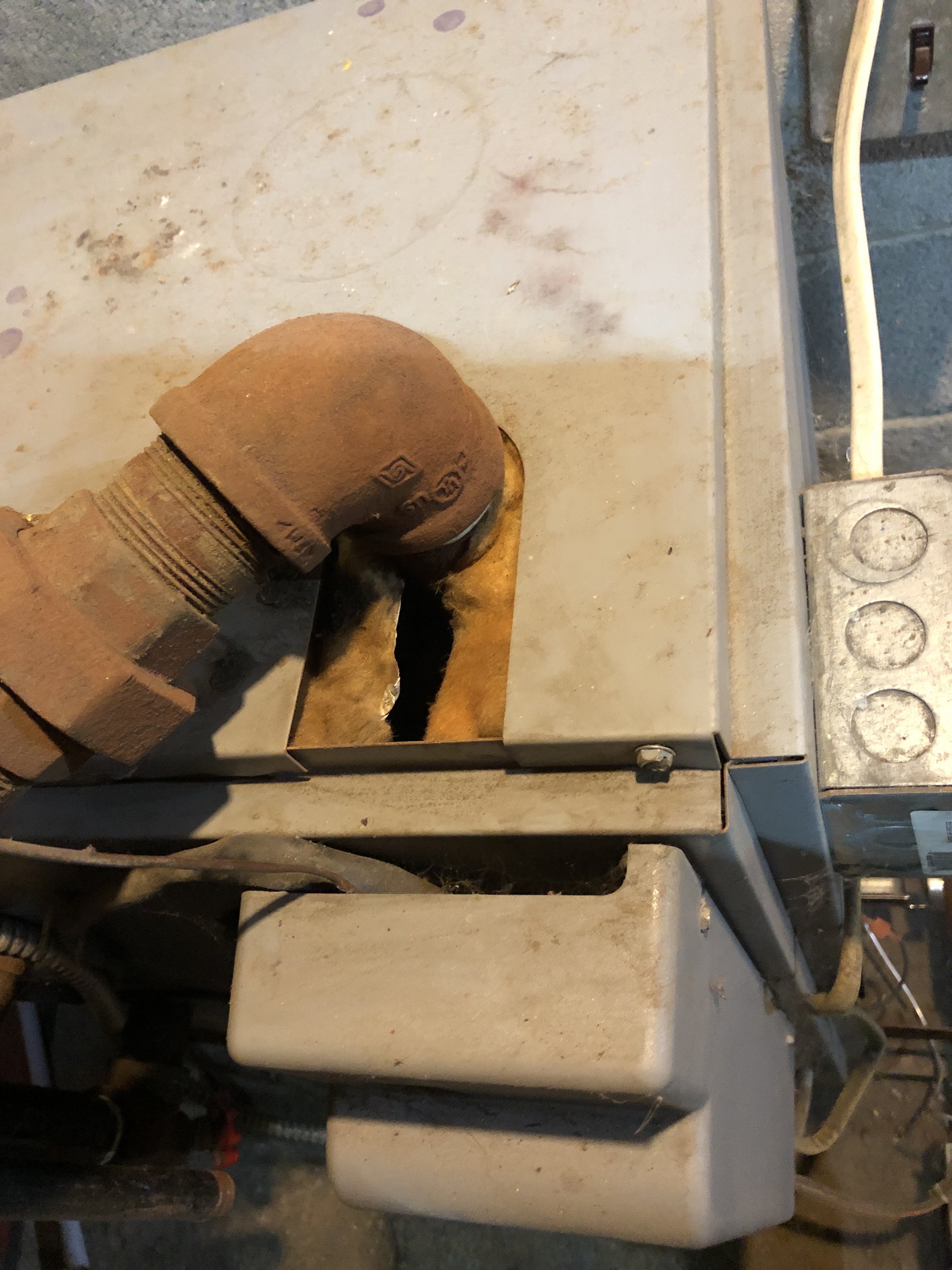

Utica Hot water boiler Model UH15B096FE
stevenknaub
Posts: 37

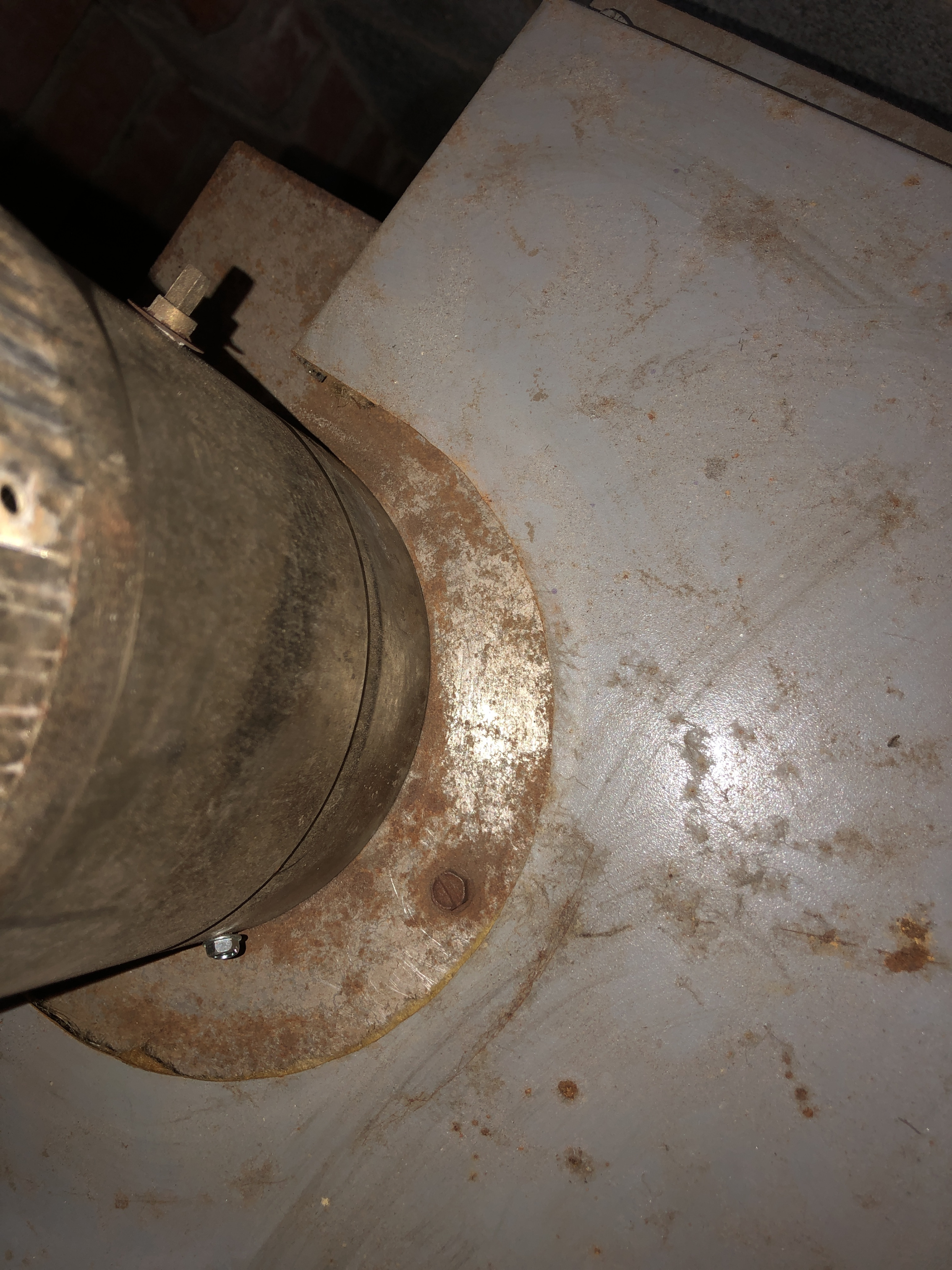

The boiler block, breeching and draft hood contain the flue gases. The access panels have nothing to do with it, they merely cover the insulation over the block.
Flue gases may spill from the draft hood or burner opening in abnormal draft conditions, so a good carbon monoxide detector in the boiler room is essential.
