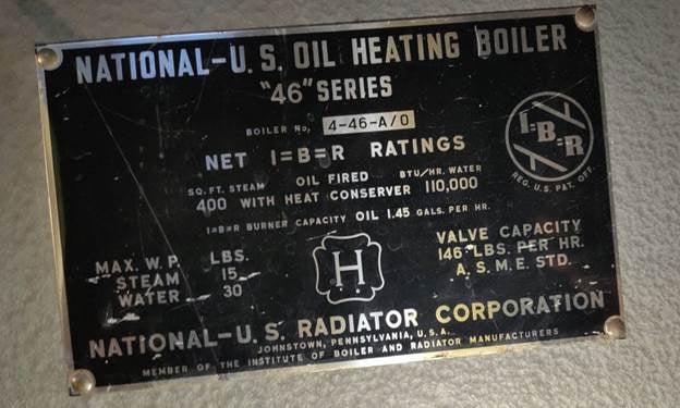

I've tried looking up this boiler on the line but despite the brand being pretty popular I come up empty on any info related to this series:

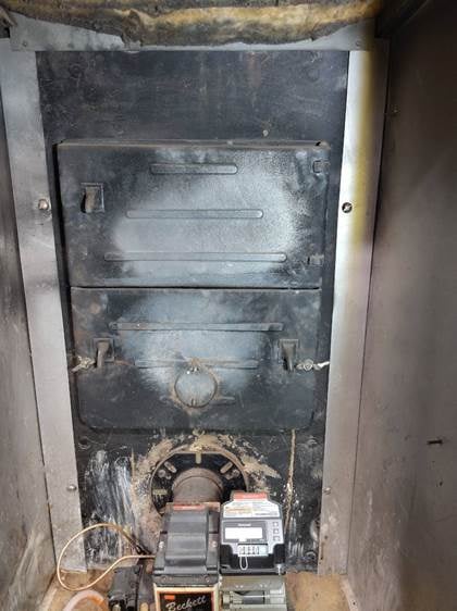

There are two access doors when you remove the front panel. The lower one goes into the firebox, the upper gives you access to the heat exchange portion of the boiler.

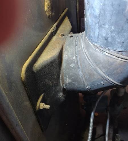

It looks like the flue adapter comes off the back of the boiler and that you clean it out front to back:
I assume as stated that there is no access from the top. You would do everything from the front doors back through the Flue pipe adapter.
Looking to pick up clean out brush too that's why I want to see what access looks like and the appropriate size brush.
Appreciate any comments on the boiler ID also

    That is an older style of boiler and can be thoroughly cleaned using the two access doors on the front. The flue passages are horizontal, not vertical as in modern pin style boilers.
    The design dates from the coal burning era, when the flues had to be brushed down much more frequently than they do when firing oil.

  • Thanks. The passageways are definitely not what I'm used to seeing from the Burnham boiler in my previous house. Much bigger! Looks like a 2 to 3 inch brush is required.
    I'll probably pull the back off any way to check things out.
    Does the info on that nameplate make sense for about 1956?

    Yes, the nameplate is right for a mid-1950s boiler.

    Most of the cleaning will be through the upper flue door. If you look in there with a flashlight you should be able to see the flue pipe in the back. I used to use a 2" x 3" rectangle brush but any brush will probably work if not too large. Do the top door first some soot will fall down in the fire box so you can vacuum it out after you clean through the lower door. You may want to take the flue pipe down and clean it especially if you new to the house. After that you shouldn't need to do the flue pipe every 4 years if the burner is firing right.
    200,000 btu/hr in 110,000 btu/hr out?
    Steamhead Posts: 19,007
    That would have been with the original burner. With a modern flame-retention burner like that Beckett, it's probably more like 182,000 or 1.35 GPH input to get the same output.

    Don't be surprised if you see bricks in the flue passages. That was a pretty common way to slow the flue gas down.
