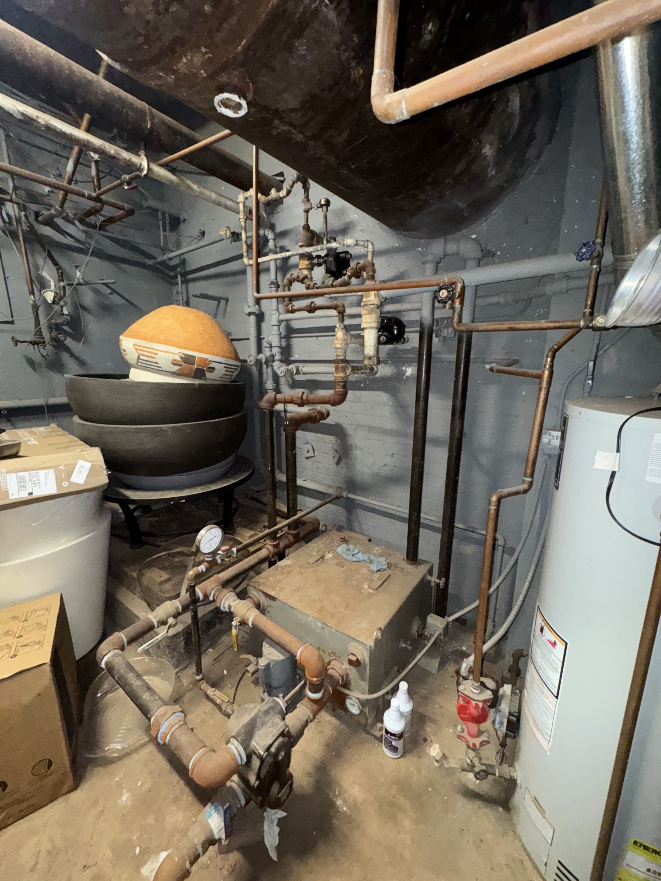

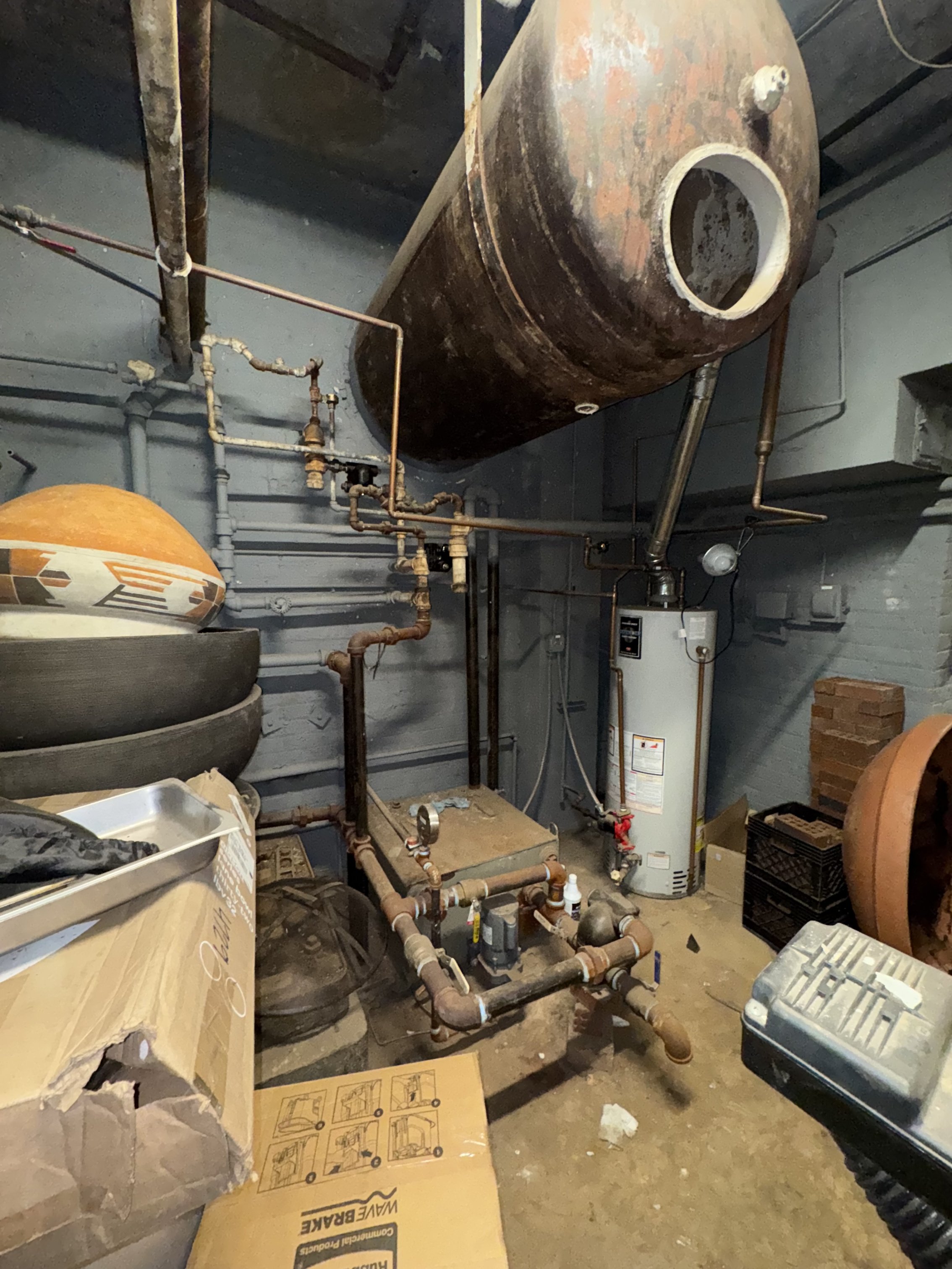

  • Pumpguy
    Pumpguy Posts: 812
    Can we see what type of pumping equipment is there now? Please show near by piping too. This will tell us how the venting is arranged.
    "The section of radiators that are not getting heat are supplied directly from the 6” main. There is a wall that has 5 radiators and each one progressively gets colder as you go down the run. However, the rads that come before it on the run and after all receive ample heat. The rads downstream of these 5 are actually getting so much heat it’s unbearable to be in the room. These rads are in the vestibule area of the church that is completely made of stone"
    Is there any hope you can draw a diagram of this section, including the main or sub-mains that feed it, any traps, and how the return piping is arranged? How does it tie into the mains and returns from the radiators downstream?
    by looks of it previous company installed
    looks like someone has installed a “master trap” at some point at condensate return vessel. I’m assuming because they did not attempt to repair all individual steam traps instead they double trapped the return
    the condensate tank vent is the vent for the system
  • Right I know that, all this talk about other vents had me worried I may have missed something. I have been in every nook of this place multiple times. Everything single trap has been replaced all bi metallic traps and thermostatic traps
    in order to be a mechanical vacuum system all the venting would have to have come back to the vacuum pump so it would have to have crossover traps to vent the mains.
