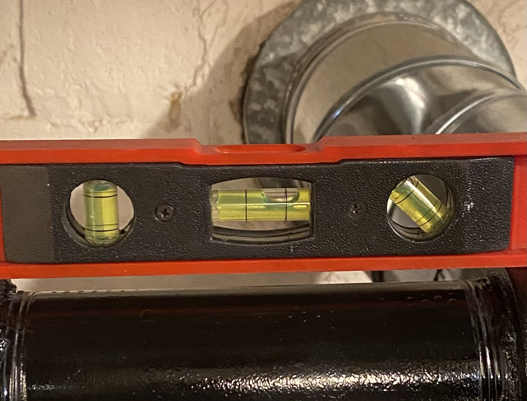

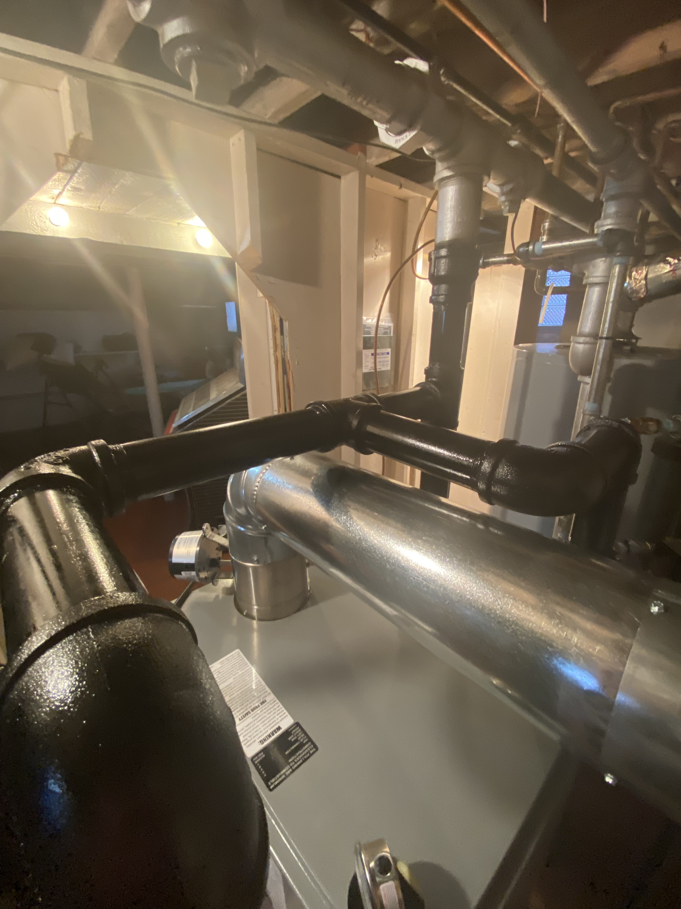

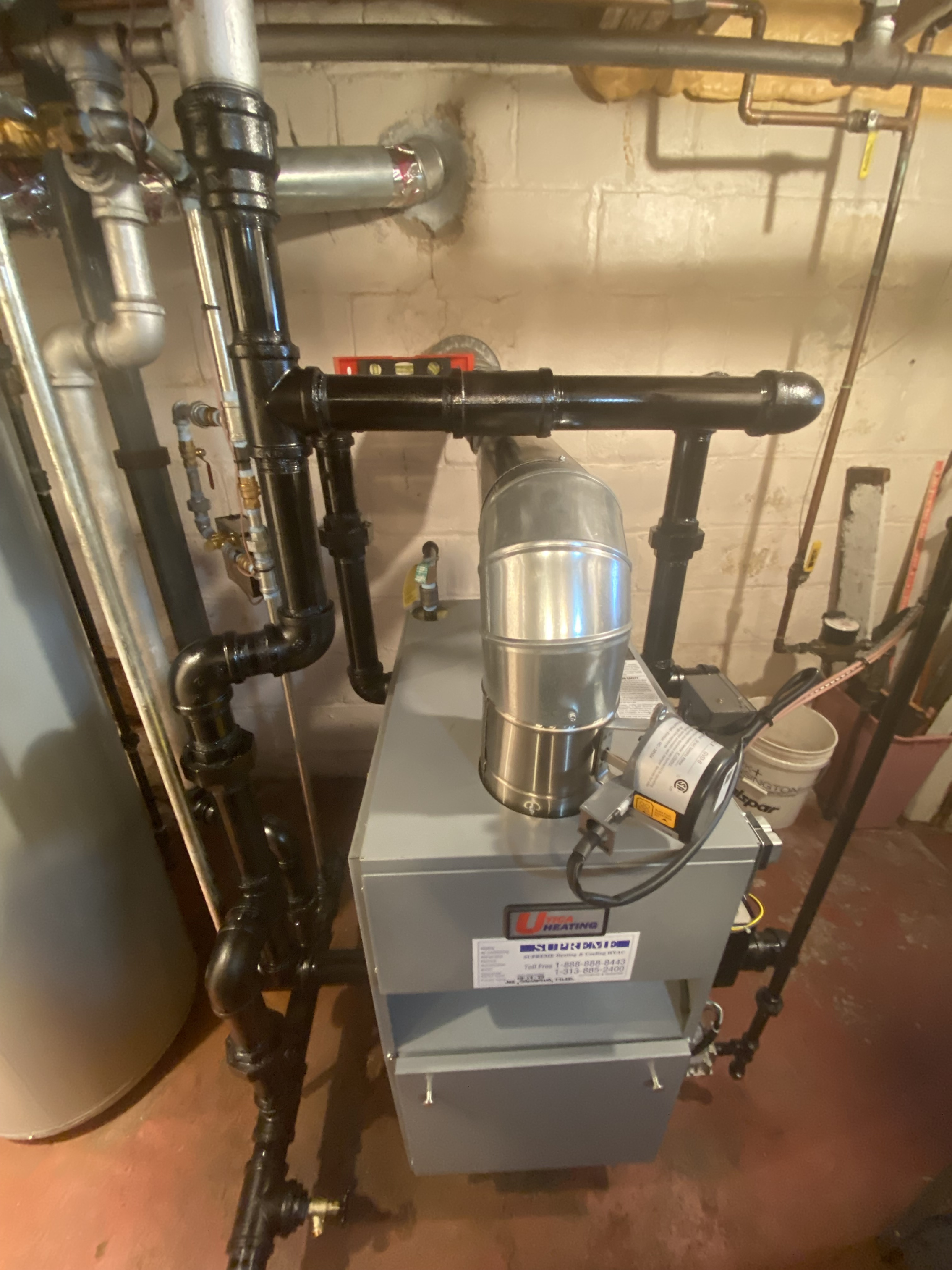

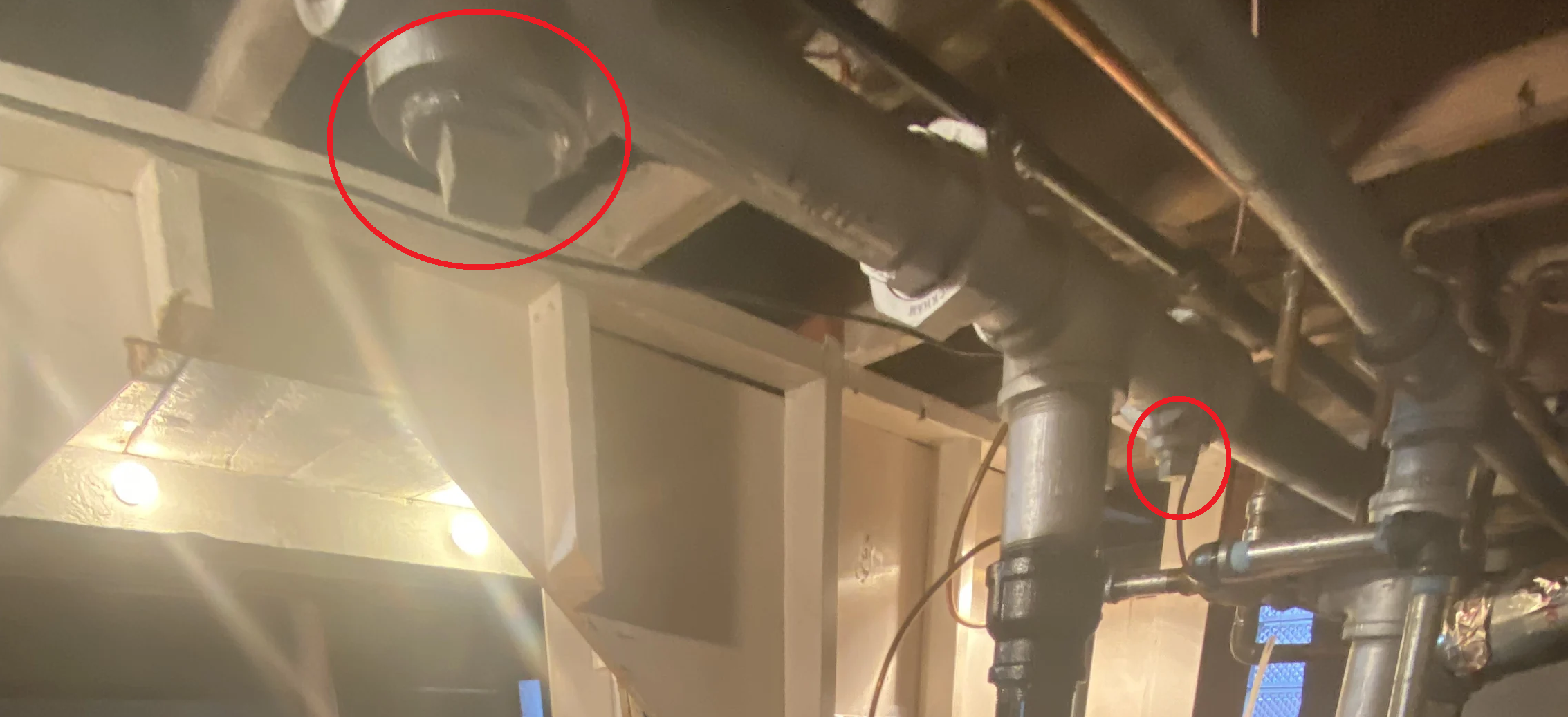

just had new system installed - one riser is one inch shorter of the two - plumber says thats normal to allow proper drainage. Please advise
    riser to where? show some pictures or something.
    109A_5 Posts: 4,759
    If it is the risers from the boiler toward the header pipe it is to create pitch for the header pipe toward the equalizer pipe it is normal. Pictures would help for better clarification.
    Intplm. Posts: 3,162
    If you are describing a gravity drain, then yes, it's a good thing to have one shorter, provided it's in the correct direction.
    But what does this question apply to?

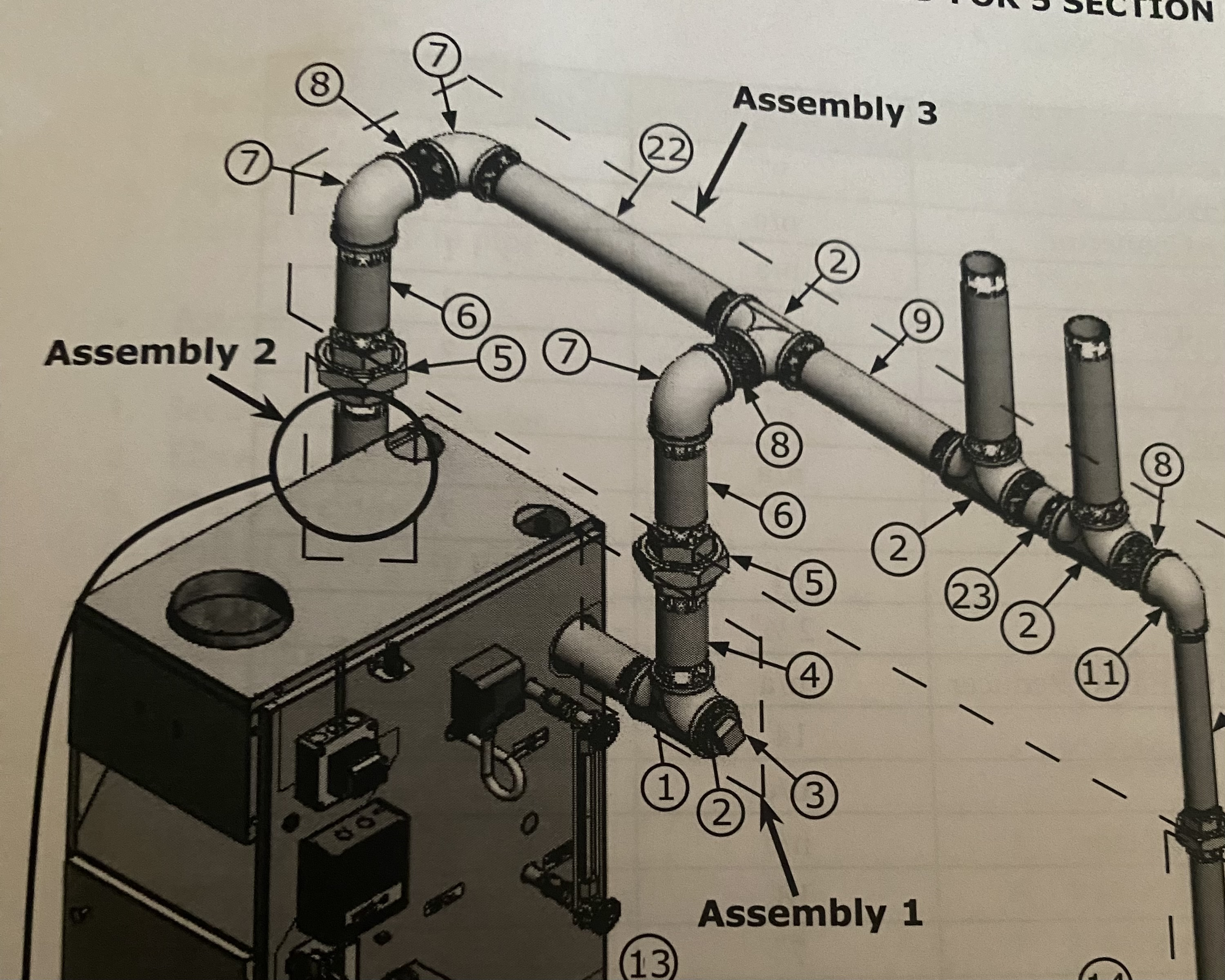

    That is for it to slope toward the equalizer. Check the size of the risers in the manual, they may have incorrectly reduced them where they come out of the boiler, see what the diagram in the manual says the minimum riser size is.
    The riser to the system should tee off and point up or at an upward angle before the equalizer connection, it should not connect to a tee that connects both to the main and the equalizer.
    Is this 1 pipe or 2 pipe steam? That return looks weird for steam, it looks more like a gravity hot water return main.

    The slope is fine if it's there, and it's fine if it's not there.
    @mattmia2 is right, the piping coming off the header up to the main isn't correct according to the installation manual, but in reality it should work fine even without perfect water quality.

    Kind of wonder if it is counter-flow also and the drips were removed.

    Original coal boiler had 2 risers.
    The small plug could have been a drip but more likely went to the vapor specialties that are missing.

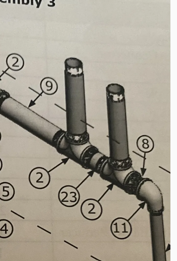

  • This is from installation manual - it appears that it looks my system.
    is this correct for my vacuum pressure system
    This part is wrong. The drop to the equalizer should be after the connection to the system so that water tends to head straight toward the equalizer and steam turns up to the main.

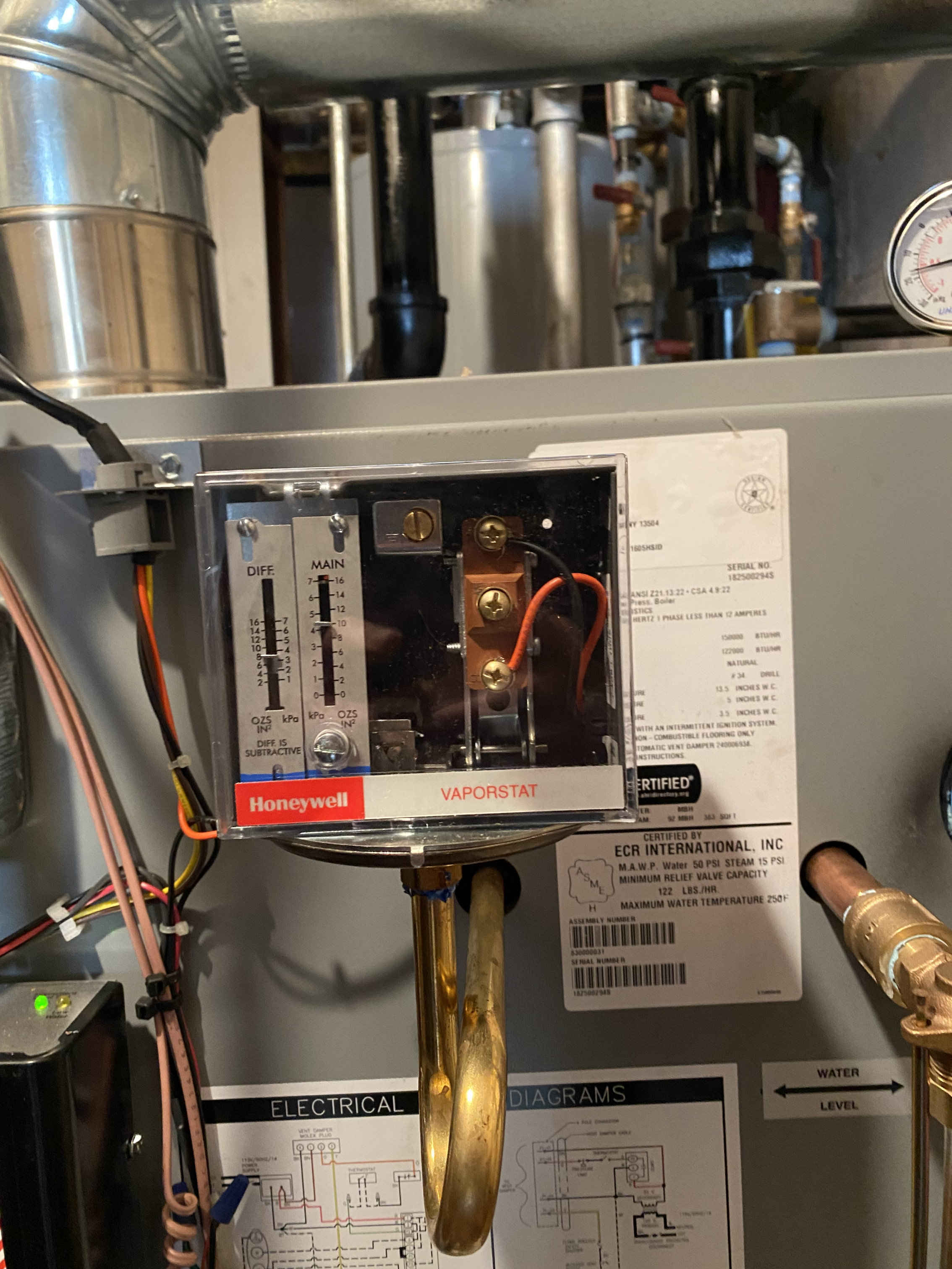

    The piping while not textbook will be fine if the sizing is correct. The pressure control is et way to high. The main should be set to 1 1/2 -2psi and the diff should be 1 1/4 psi to be verified with a low pressure gauge.

    Ed, that is a vaporstat……ounces shown.
    EBEBRATT-Ed
    @JUGHNE
    Yeah. I was a bit hasty on that one ty.
