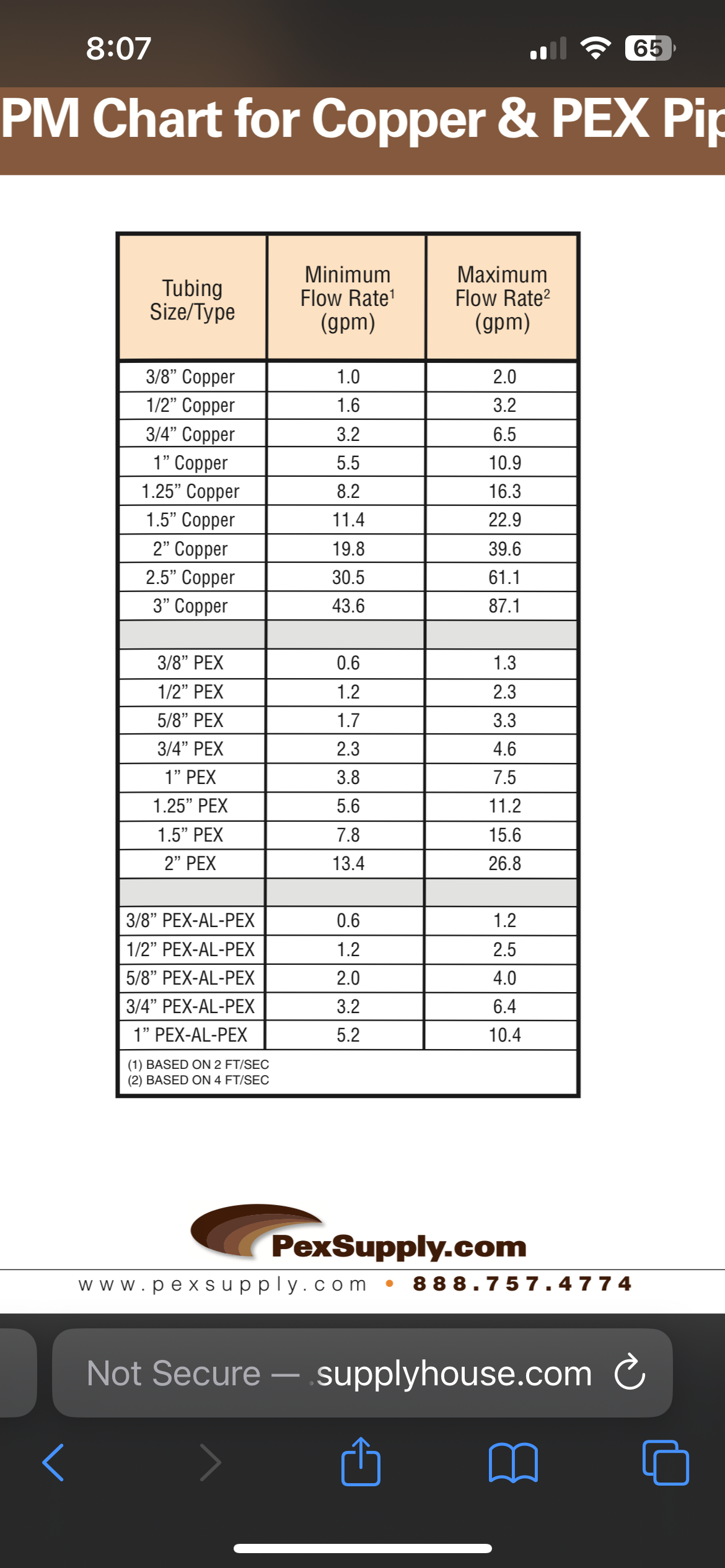

    mattmia2 Posts: 18,431
    3/4" pex can move more like 30,000 btu/hr at 4gpm at 20 f delta t

    I see the most common insulated pex for OWF is 1”. 1-1/8” outside, .875 id
    3/4 copper M is .811 id to get an idea of the flow capacity
    There is some PAP pex al pex available that has a larger ID that is used with OWFs
    It should be the job of the installer/ designer to know what size is required.
    Leaving the tube size selection up to the OWF sales and marketing , often leads to expensive mistakes. There are plenty of online sources for sizing pipe and tube for hydronic applications
    The pex manufacturers and their reps are happy to share sizing information also
    If the oil boiler is a 160,000 input btu x 80% efficiency so you have more like 128,000, @12 gpm is all the flow you need to move its full output. 1-1/4 pex can do that flow.
    These are conservative numbers based on 4 feet per second velocity

    So 120k BTU would be like 12gpm at 20 delta T. And 8 at 30 delta T. So 1.25" would be ok… I think?
