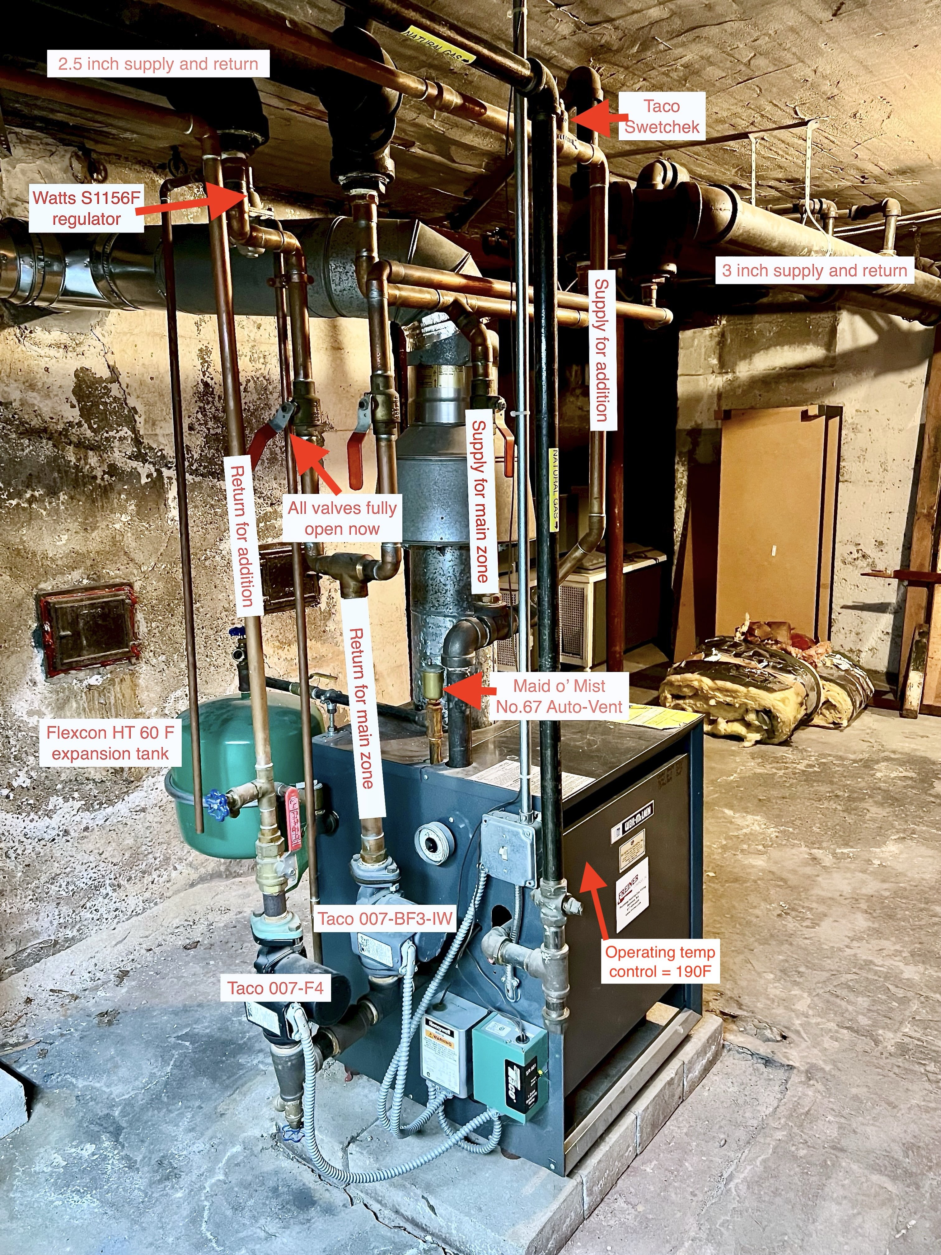

Hi everyone,
What a great resource that this forum is. I have a copy of "pumping away" sitting on my desk as I write this! I was advised to ask you all for advice by a member and veteran master plumber up here in the Boston area and am unfortunately outside of his service zone, but he thought that you may be able to offer some additional feedback and advice. You all have forgotten more than I know, so I’m thankful for any help. I have also attached some pictures.
By the way, @DanHolohan I am happy to send you or anyone else here a scanned copy of the 1928 Landon radiators catalog that I purchased on EBay to help me determine the heat output.
I have two main issues:
  • Based on the picture of my system, I wonder if I am missing any critical components near the boiler to improve the performance issues I’ll describe below, and if you'd advise of any changes to the current setup
  • I am having real issues getting the cast iron radiators hot enough to keep the home comfortable
Background information:
  • The home was built in the late 1920s and seems to have originally been a gravity system. I purchased the home 4 years ago.
  • I installed 1 inch fiberglass insulation on about 95% of the basement piping (the picture below was taken before I installed it) and have weathersealed the fireplace hearth and external doors. This resulted in about a 5% decrease in energy use when adjusted for average temperature, but I’m still consuming about 23 million BTU in the coldest month of the year. The attic floor was insulated 10-15 years ago with blown in cellulose but isn’t air sealed and has settled a bit.
  • There are three loops: two original cast iron loops on one zone, with a longer loop (3 inch NPS that tapers down to ¾ inch) and a shorter loop (2.5 inch NPS that tapers down to 1 inch) in a direct return configuration which heats 2200sqft, and a copper loop for a 425sqft kitchen remodel/addition. A cast iron radiator was removed from the shorter cast iron loop because of the remodel and was likely about 60sqft EDR.
  • The thermostat for the cast iron loops is not in direct sunlight and is on the first floor, in a room 2/3 of the way down the longer cast iron loop.
  • Radiators have been bled every season and never resulted in any air being released.

  • novajke
    novajke Member Posts: 41
    Fellow homeowner with a gravity system here. Have you checked the radiators on the old gravity loops for balancing restriction disks in the radiator unions?

    Jamie Hall Member Posts: 27,646
    How — if at all — are you able to balance the flows? The biggest problem with gravity conversions is balancing, and your observations lead me to believe that you have nowhere near enough flow through the older cast iron sections — and way too much flow through the newer copper section.
    The boiler cycling points in somewhat the same direction: you aren't running enough water through it to absorb the power you are putting into it, so it has to turn off to keep from overheating.
    The 007 on the cast iron may simply not be big enough…
    mattmia2 Member Posts: 17,760
    the valves that spin are probably plug type valves where they are 1/4 turn from on to off though there are other possibilities.
    the 190 setpoint probably isn't helping anything.
    closing the valves most of the way on the near radiators and opening them all the way on the far radiators may help balance things though you may ultimately need a circulator with more flow at low head.
    i hope the fin tube is a separate zone with a separate t-stat.
    i would expect the boiler to need return water temp protection, not to cycle on high limit. are you sure the circulator for the gravity conversion is working? maybe the flo check is stuck or a valve is broken.
  • HydronicMike
    HydronicMike Member Posts: 399
    Could be too much flow too. Hot water used to flow nice and slow and evenly off of the mains into the risers and rads. Might be zipping down the mains right by the branches now, only letting air migrate up.
    Time to do some math and maybe some well placed valves to channel flow.
    I would also consider a pumping away set up and moving the circs to the supply. Might be the source of your noise/air problems…and maybe even flow.

    EBEBRATT-Ed Member Posts: 20,716
    If the boiler is cycling on and off during cold weather, you are not moving enough water. You either have a balancing issue between the two CI loops or the 007 is not large enough.
    If you were moving water through the boiler it would not cycle. As you sid the boiler is not on long enough to deliver heat.
    Since you don't get air it is not an air issue.
    Take the temp of both CI loops where they tie together on the supply and return and see if the water favors one loop.
    Converted gravity system are finicky and converting them to a pumped system can mess with the balance.

    Chiming in again. As others have mentioned, you have a balance problem. There are three distinct eras of your heating system: 1. the orginal gravity based system 2. The 1980s forced circulation single zone conversion and 3. The addition's second zone done in copper. We know the system in its current configuration is unsatisfactory, however we don't know how well the orginal conversion balanced.
    The crux of your problem is the inherent incompatibility of the two zones, and insufficient isolation of the copper addition zone when there is only a call for heat from the gravity leg of the system.
    The large pipes and big radiators result in a large amount of thermal mass and water which takes a long time to heat up, but once heated can be maintained by the boiler. As your data showed, to get everything up to a steady state condition takes considerably longer than 45 minutes. As things sit, during normal operation a large percentage of water cycles through the second zone when there is a call for heat in that zone. As shown in your analysis, the water in this zone heats up very quickly and returns to the boiler hot. This water contributes to the boiler temperature rising and bouncing off the safety aquastat, but doesn't contribute to the rise of temperature in the gravity loops. This results in shorter boiler cycles that have to wait for the boiler to cool before continuing.
    When the is no call for heat on zone 2 the water in zone 2 reverses direction of flow and sends return water from the gravity loop back into to the supply side of the gravity loop via the zone 2 copper. Half of the heated water that would have gone to the gravity loop in the orginal single zone layout never sees the boiler.
    Let the experts chime in, however, if this were my system, the first thing i would do is add a zoning valve for zone 2 which opens when zone 2 has a call for heat. A check valve before the zone 2 pump might also work, but my intuition says that the zone 2 plumbing can still divert a percentage of water when only zone 1 is running even with the check valve. This modification will, at the very least, bring you back to the system as designed in the 1980s.
    Run the boiler and adjust the two valves on the return so you get the same temp on each return. I see no flow checks on the CI system the copper system has one.
    I think what I would do is split the CI system and put a circulator on each loop with an additional thermostat.
    Not much expense. circulator, relay, thermostat a little wiring and a little piping. Both zones exist right at the boiler to its an easy job. A day's work for someone that knows what he is doing.
    You will get more flow on each zone with two circulators.
    Don't be concerned about adjusting the valves. Even if you close one off the pump still has a place to pump water won't hurt a thing. The only valve you need to touch is to close the one with the hotter return. Make small changes and give it time to balance. Look at the picture and adjust that valve as in the picture for the initial setting and go from there.
    Whit a big system like that low temp return and damage the boiler. Sustained running below 130 deg isn't good.
    You may need larger circulators and a bypass to solve this issue but start with the water temp balancing.

  • MikeL_2
    MikeL_2 Member Posts: 547
    I would correct the return piping below the two ball valves. The bullhead tee is a problem as the water in the two branches oppose each other trying to enter the single pipe. And move the circulators to pump away.

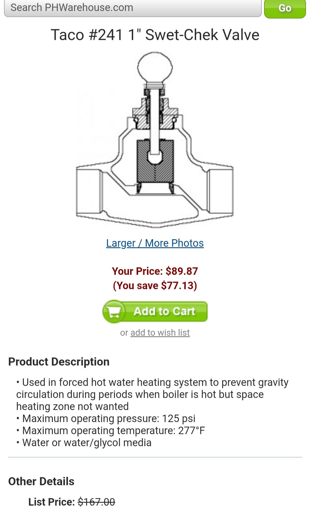

    You don't have to pull the system apart initially. Find or borrow a thermal imaging camera and you will be able to see a distinct restriction during initial warmup.
    The swetchek prevents gravity circulating, and does this by forcing the water through a vertical s. When circulated, it pushes through. When no circulation is on, the thermosiphon is blocked since the warmer water remains trapped above the colder water. (Edit: there is a check valve that gets pressed open when there is a differential in pressure aka a circulator running. This valve will also prevent reverse flow in the system assume the below discussed a failed check valve)
    Without a check valve or isolation valve, half of the water going through the zone one pump would turn and goes up the zone 2 pump, through all the radiators backwards and then back onto the zone 1 plumbing bypassing the boiler.

    How neat, I’m glad you caught that detail. What should the bullhead tee be replaced with?
  • MikeL_2
    I'd use a tee similar to the one above the ball valve at the addition return where the boiler drain is connected. Obviously with a soldered branch port instead of ips.
    While your system is drained consider ball valves or isolation flanges for the circulators. And we always try to avoid installing relays or other electric components low where they could suffer an accidental drowning.

    I don't believe the swetchek does anything (edit: aka it is not functioning properly) to help with the back flow of zone 1 water in zone 2 when zone 2 isn't running. Too verify this, rerun your 45 minute test with the zone 2 ball valve closed. See if this allows you to come up to temperature better. While you are at it, you can see which of the two legs on the zone 1 loops need to be restricted using the thermal camera. At the end of the test, you can open the zone 2 ball valve and see if the water is going in zone 2 backwards.

  • novajke
    First- i need to issue a correction: The swet-chek is a standard check valve and should prevent back flow of the system if functioning correctly. I apologize for misleading you and again, I repeat, I am only a home owner, not a pro who works with these components on a regular basis. That being said, i do have a masters degree in Mechanical engineering and have taken several courses on fluid mechanics, fluid dynamics and a graduate level hvac course.
    Having that out of the way, there is still the possibility that the check valve failed and allows unwanted flow.

    wonderful, thanks so much! I’m going to see if there’s a way to see if it has failed. The thermal camera suggestion may offer some clues.
    If the sweat check has failed that zone would overheat.
