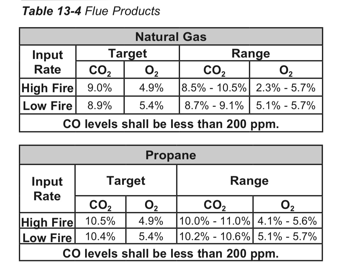

I just installed a new Lochnivar Noble NKB199N boiler. It has been converted for propane.
On low fire the flame signal reads 11.3uA
On high fire the flame signal reads 7uA
The manual states it should have a flame signal of at least 10uA.
Gas pressure is 12.12” wc at lockup and 10.17” wc at high fire.
I have about 100’ of 1/2” pipe from the primary regulator to the secondary regulator and 8’ of 1/2” pipe plus 4’ of flex line from the secondary regulator to the boiler.
Why would I be getting a lower flame signal on high fire than on low fire? I would think my gas supply is adequate as it’s not dropping below 8” wc on high fire. I took everything apart to make sure there were no obstructions in the air piping or burner and even cleaned the flame sensor which changed nothing. I even changed the gas valve thinking maybe it was that and nothing.

For propane Lochnivar states 14” max and 8” min. That’s what I was referencing when I was stating I am not dropping below the 8” min that Lochnivar specs. Measuring gas pressure on the test port on the gas valve.
Yes ran combustion and tuned it with it the manual specs.0 -

I don’t have them with me I’ll have to check tomorrow. Went by what the manual called for as you can see in the photo. The only thing I can remember off the top of my head is that the CO on high fire was right around 158ppm
High fire running at 4.2% o2 and 11.03% co2
Low fire running at 5.2% o2 and 10.37% co2
Talked to Lochinvar tech support and they said as long as the flame signal is reading above 3uA it should be fine. I just thought it was strange that it would have a lower flame signal on high fire compared to low fire.0
