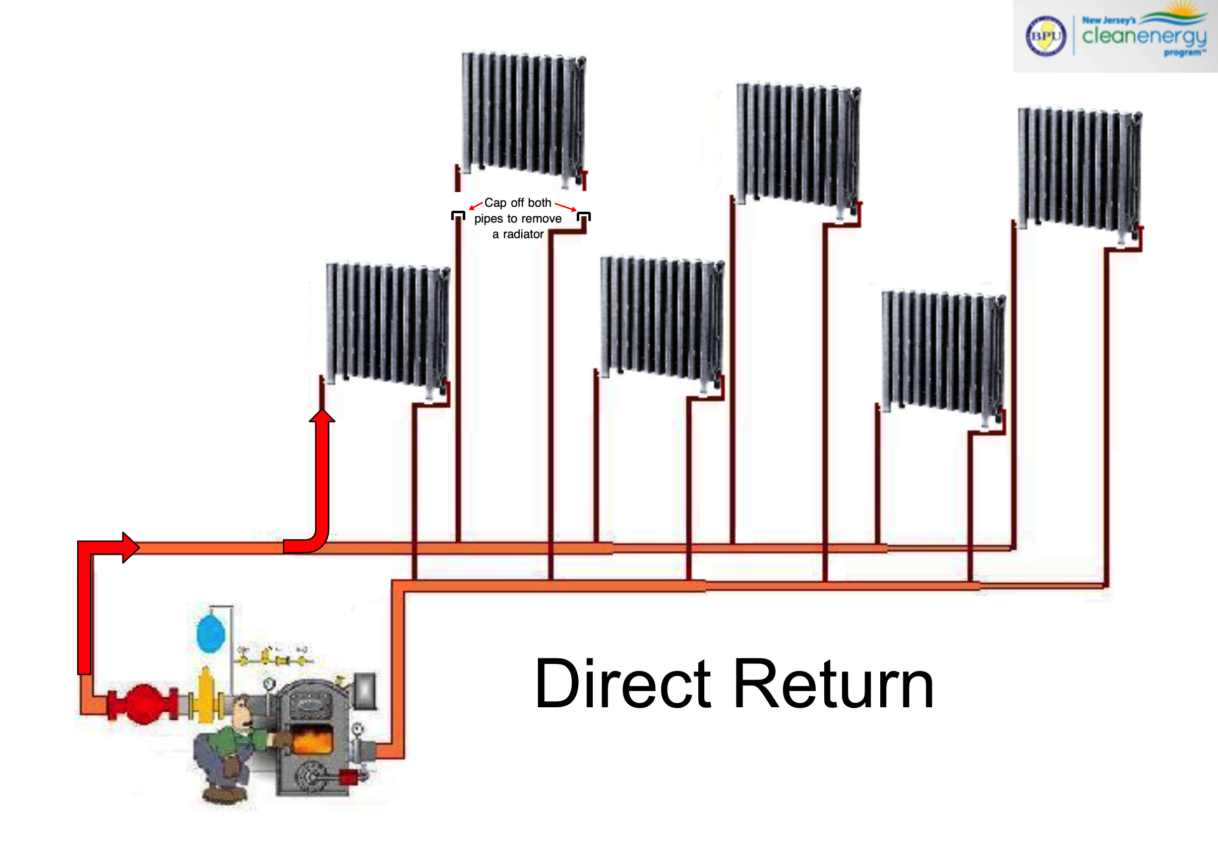

    You most likely have an old gravity parallel direct return system. That means the for every radiator you remove you need to cap off both the supply and return pipe to the radiator that you remove in order to fill the system up with water to turn the boiler back on. If removing radiators is what you are asking about.

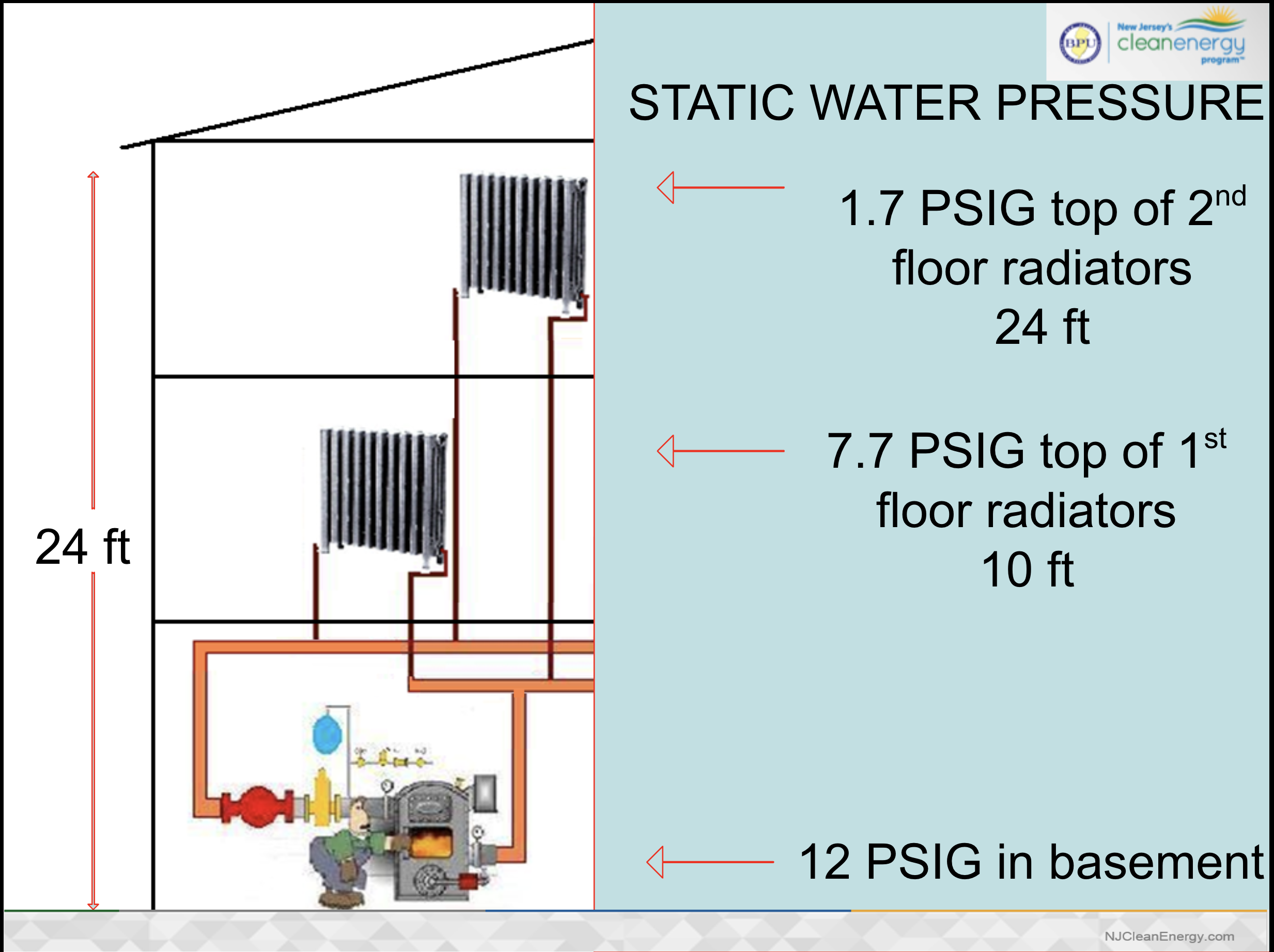

    Relating to pressure. The pressure needed to operate that system is not associated with the number of radiators. The pressure needed to operate that system is based on how tall the water needs to go.
    If all the second and third floor radiators are removed, and there is no heat to heat the second and third floor, then you can reduce the operating pressure since the water does not need to go that high anymore. This are some slides I used in the class I taught on the subject.

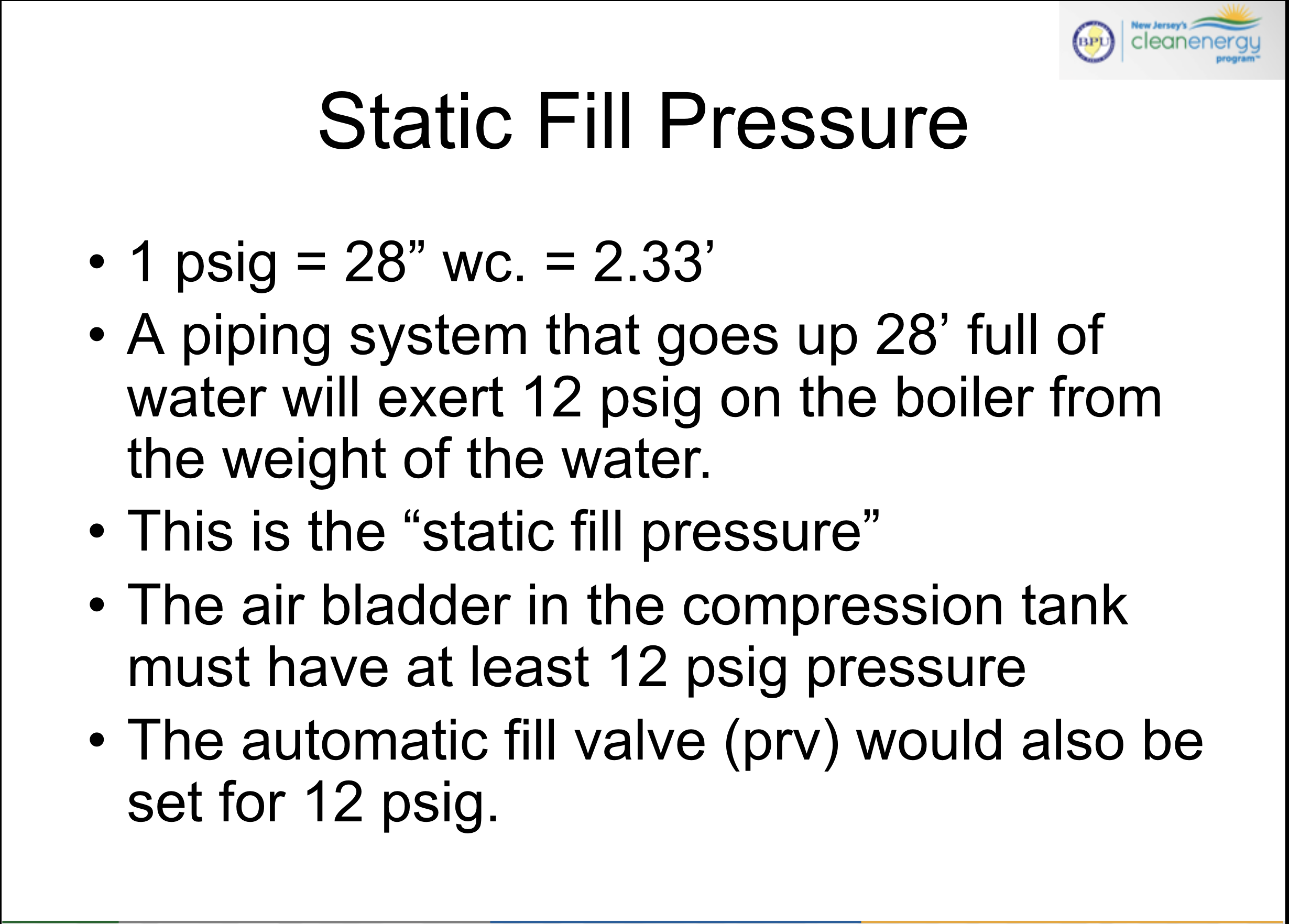

    In the first slide I would go over that water weighs something and when it is stacked up in a column the weight of the water at the top of the column is pushing down on the bottom of the column. that can be measured in pounds per square inch (PSI).
    When you look at the boiler pressure gauge you may see two scales on the pressure dial… PSI and Feet.

    Then I would show that a standard 2 story house with a boiler in the basement is often filled to a pressure of about 12 PSI. That means that there can be a column of water 28 feet above the gauge location. If your highest radiator is only 24 feet above the gauge in the basement, there is a little less that 2 PSI water pressure at that point. That is enough pressure at the highest radiator in the system to push any air out of the manual radiator vent.

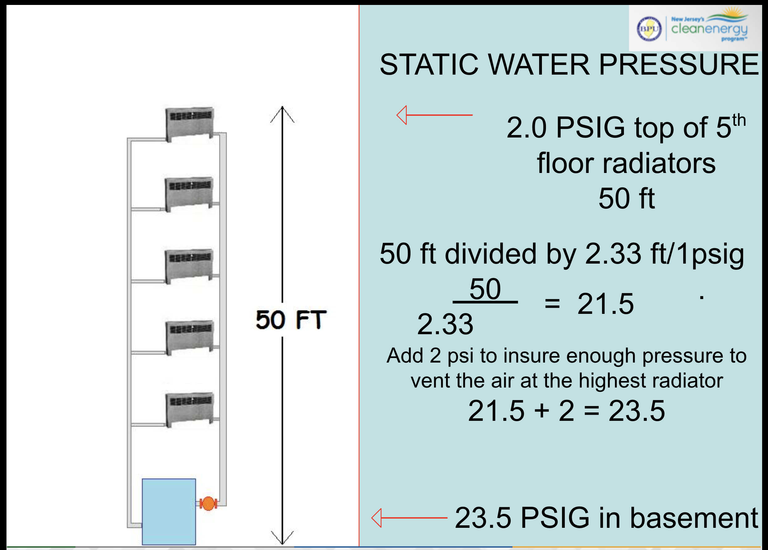

    Finally I would show a 5 story building and why you would need almost 24 PSI in the basement to get the water to reach the top radiator. If you used 12 or 15 PSI in this system, you will not get the water high enough to fill that top radiator.
    There is a lot more to this part of the seminar but it is suffice to say that all 40 of your radiators can be on the first floor and you can fill them with less than 10 PSI water pressure. If al 40 of your radiators were on the third floor, 10 PSI would not get any water to those radiators. So you can remove 39 radiators in the building and if you wanted to leave one of the third floor radiators connected, you would need about 18 PSI on the boiler gauge to put water up that high. if you only have one radiator in the system and it is on the first floor then you can operate with less than 10 PSI on the boiler gauge.

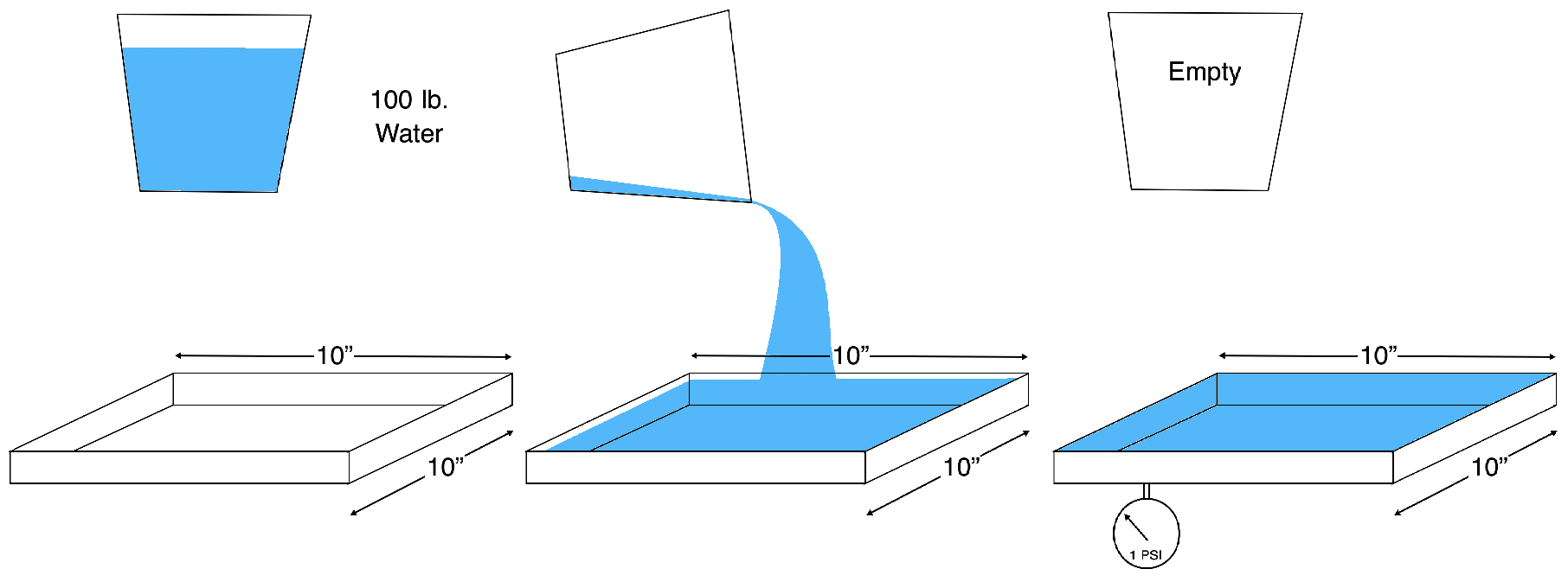

    I'm not sure you actually understand the concept. Why would you want to "depressurize" while you are filling the boiler? Filling is the opposite of depressurize. Filling is adding pressure. You are adding water in order to make enough pressure to push the water up to the empty radiators.
    Think of Pounds per Square Inch (PSI) as a literal use of the term. If you have 100 pounds of something and you spread all that weight evenly across 100 square inches, you have one pound per square inch. You dont have 100 pounds per square inch…. You have 100 pounds per 100 square inches.
    If you had a pressure gauge at the bottom of that pan the gauge would read 1 PSI with zero PSI at the surface of the water.

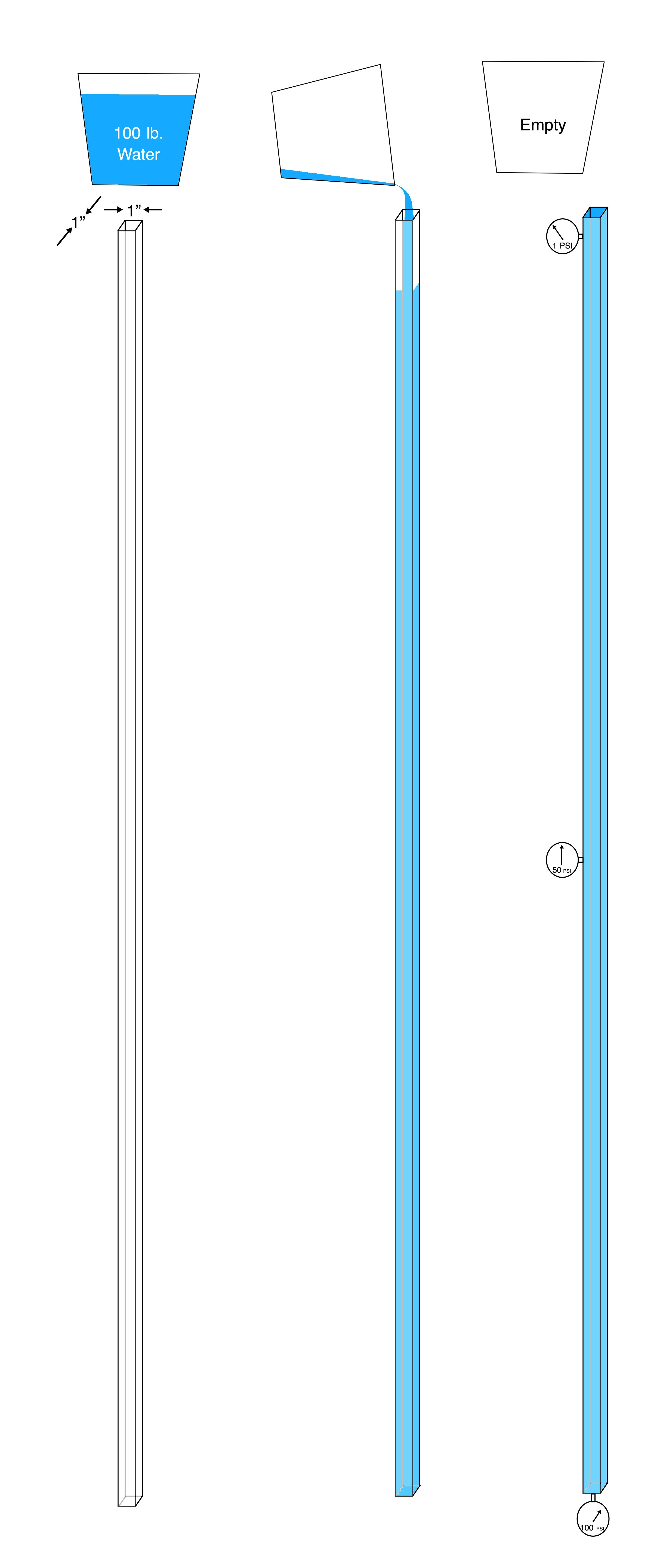

    This next illustration is a little longer (pun intended) but it shows all 100 pounds of water in a column that is 1" x 1".
    At the bottom of the 1"x 1" column of water the gauge will read 100 PSI because all 100 pounds of the water are stacked in that 1" x 1" column. If you look at about the half way mark the gauge reads 50 PSI and just below the top the gauge reads 1 PSI with zero PSI understood to be at the water surface.

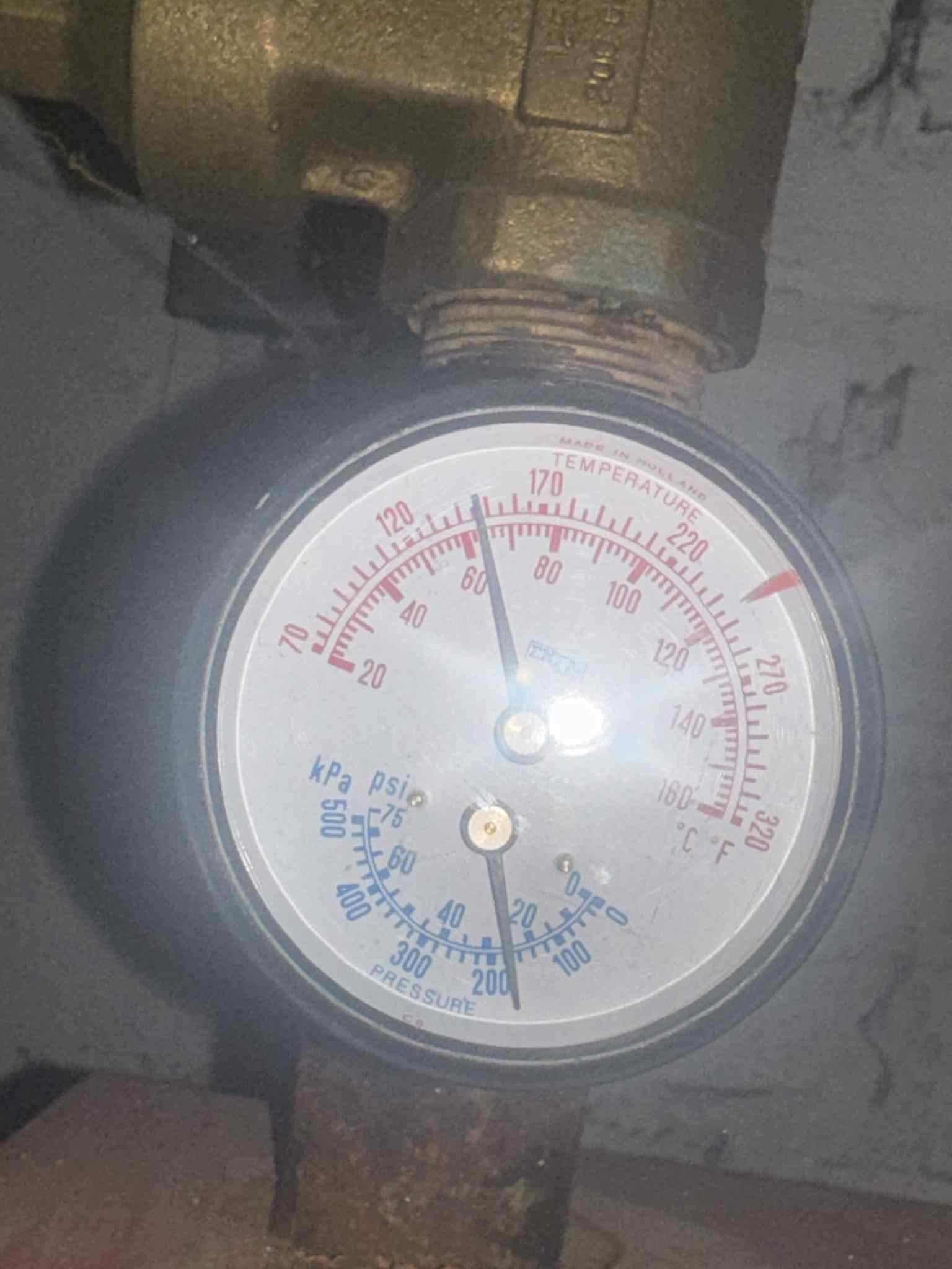

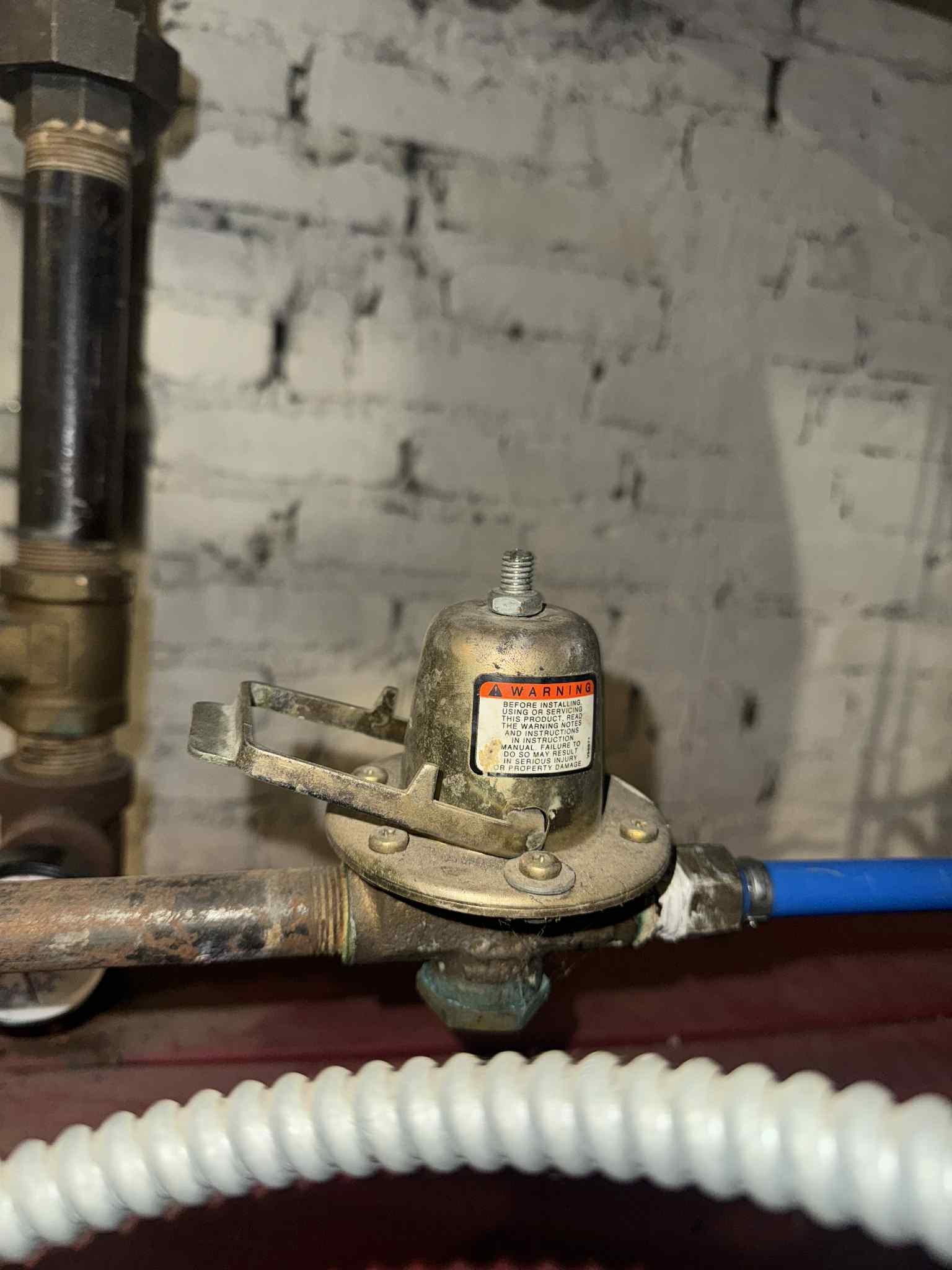

    Is my pressure relief valve turned the correct way? The blue pex pipe is the water supply.
    The pressure in my system is now about 25 PSI.

    That's not a pressure relief valve!
    That's a pressure reducing fill valve. And it appears to be broken. The fast fill handle shouldn't be cranked so far open like that. Normally the handle would be down in the opposite direction.
