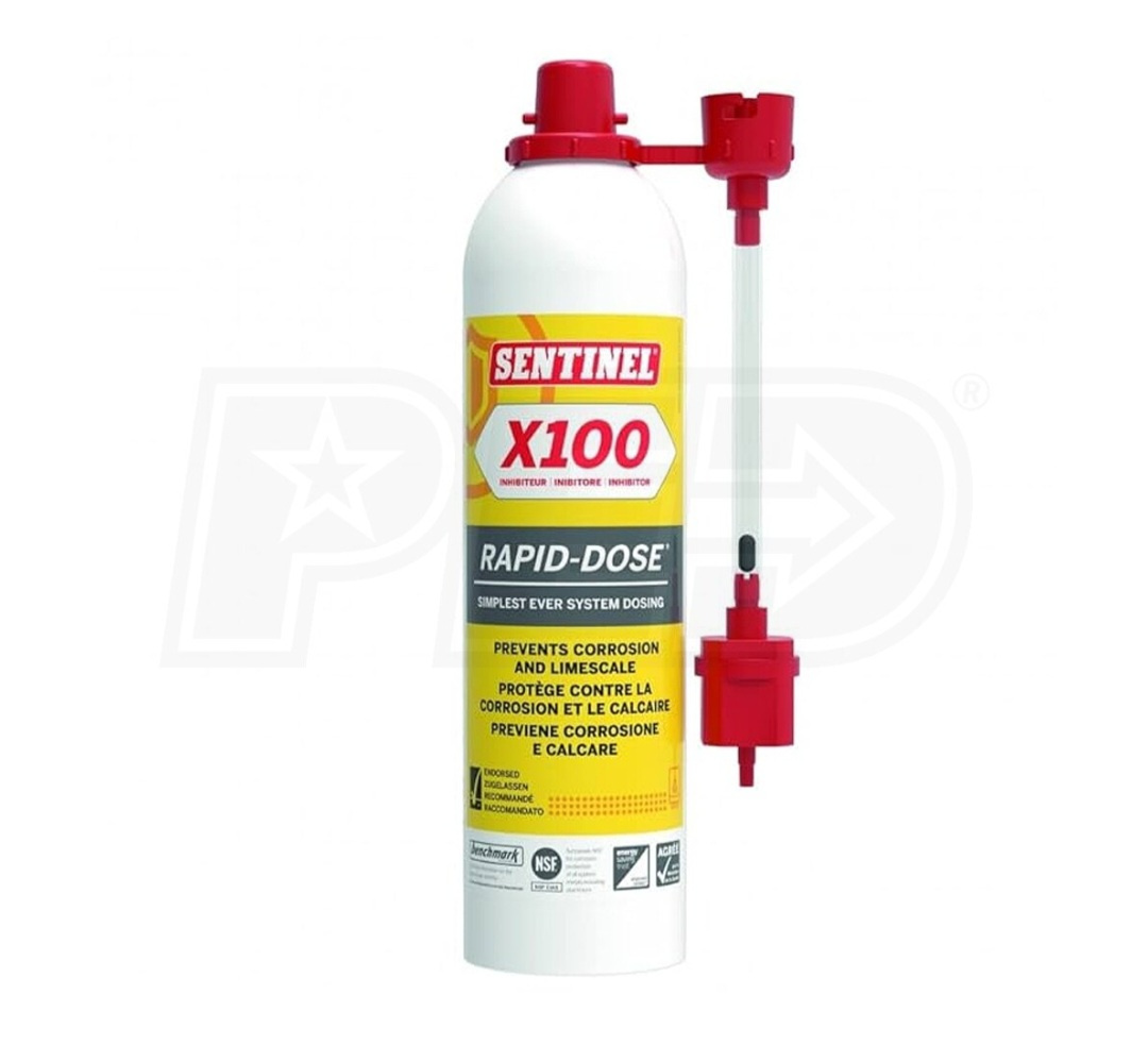

Sentinel X100 is recommended by WM. Also get the test kit.
