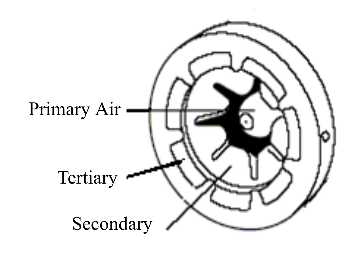

    The retention head position on any oil burner that uses the retention head that attaches to the nozzle assembly like the Carlin CRD and the EZ burners do are made adjustable so you can add additional air for combustion when the primary air (the air that flows through the center 5/8" to 3/4" circle where the oil spray enters the combustion chamber) and secondary air (the slots in the retention head) are insufficient for complete combustion. That third air adjustment that makes the opening between the edge of the retention ring and the air tube opening, is there so more air or less air can get to the flame as needed.

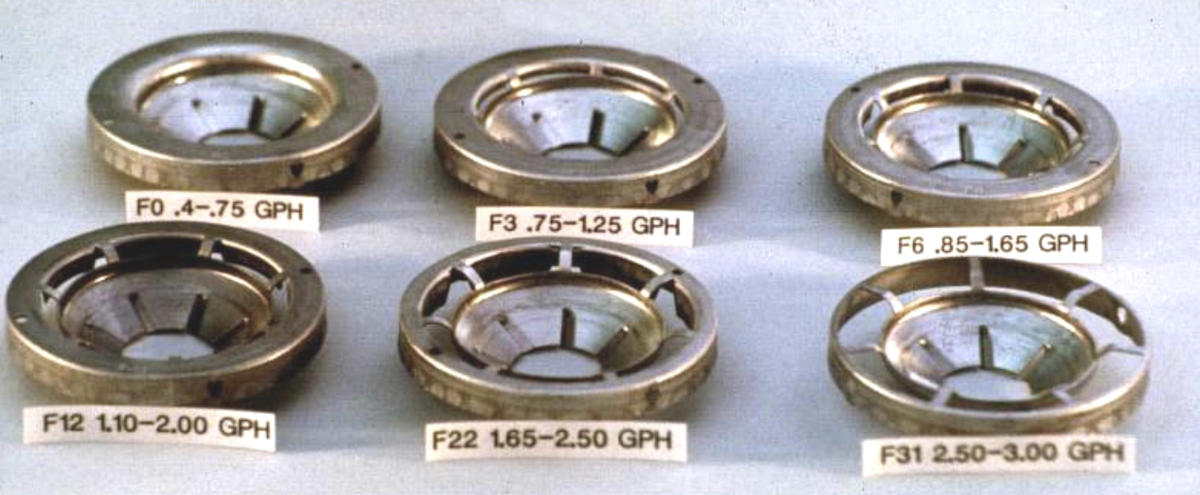

    Looking at the fixed head flame retention heads like the ones found on the Beckett AF and AFG burners will indicate clearly that the larger the opening around the outside of the circumference of the flame retention ring (like the F12 thru the F30 end cones) are designed for larger firing rates while the narrower circumference openings (like the F0 thru F6 end cones) are for the lower firing rates.

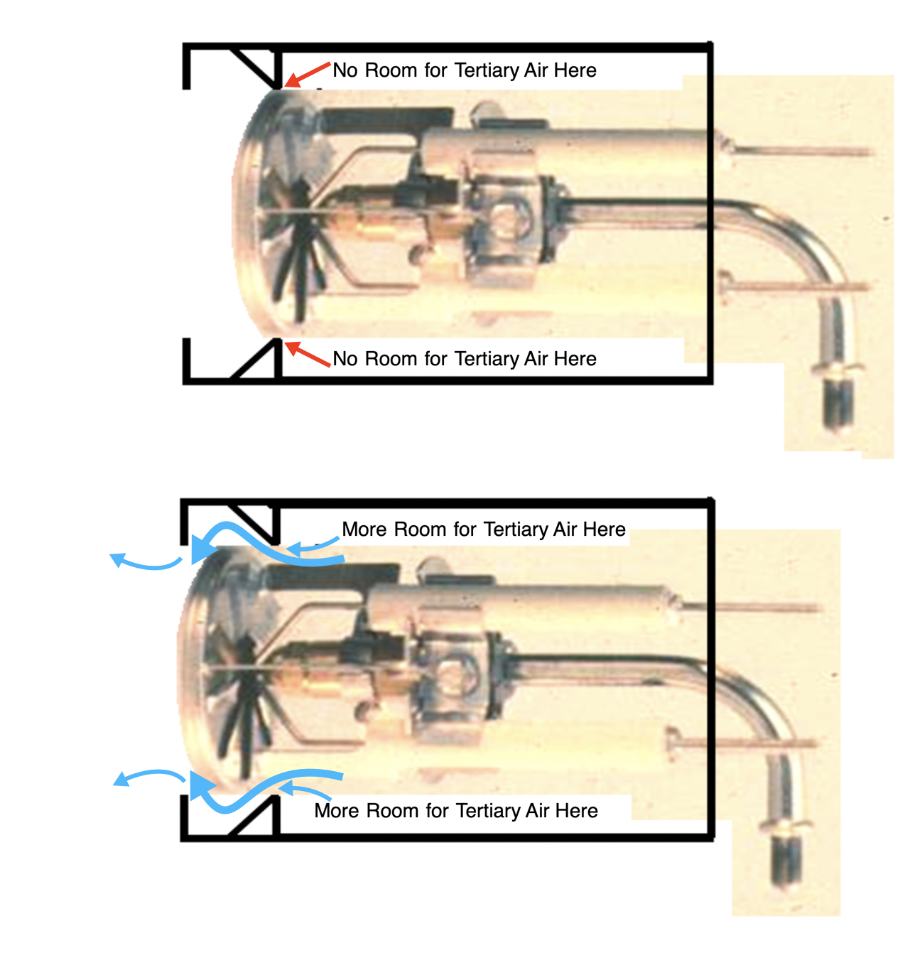

    These adjustable head burners allow you to shape the fire from a narrow long flame to a fatter short flame with a little tweaking. That adjustment is not available when you use a fixed head burner without replacing the end cone from a F3 to an F6 and you know that isn't going to happen in the field on any regular basis. Changing that third air adjustment by moving the nozzle in and out while the burner is operating can give you real time visual and audible feedback to get the quiet operation that your customer require.
    Move the nozzle closer the the chamber gives you a larger tertiary opening that may quiet down the flame. After locking that down you can then reduce the air gate opening to compensate for the additional air. When you get that zero smoke spot test, and the combustion numbers look good, you can leave feeling good about your adjustment that is not exactly on the OEM starting position numbers that are published in the manual.

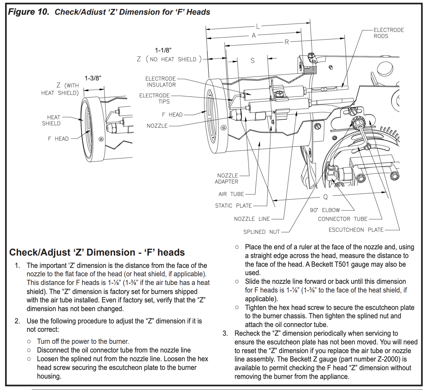

  • NO. !!! NO !!! NO. !!!
    moving the nozzle in relation to the fixed head will only mess up the dimensions that pertain to the spray pattern with the retention ring. That is not an adjustable dimension. On the Beckett AF and AFG fixed head burners that is called dimension Z and that is always 1-1/8" with F head end cone. Sometimes there is a 1/4" heat shield on some burners that don't allow for easy measurement of the Z dimension in relation to that part of the F Head so there is a 1-3/8" specification to the end of the shield.

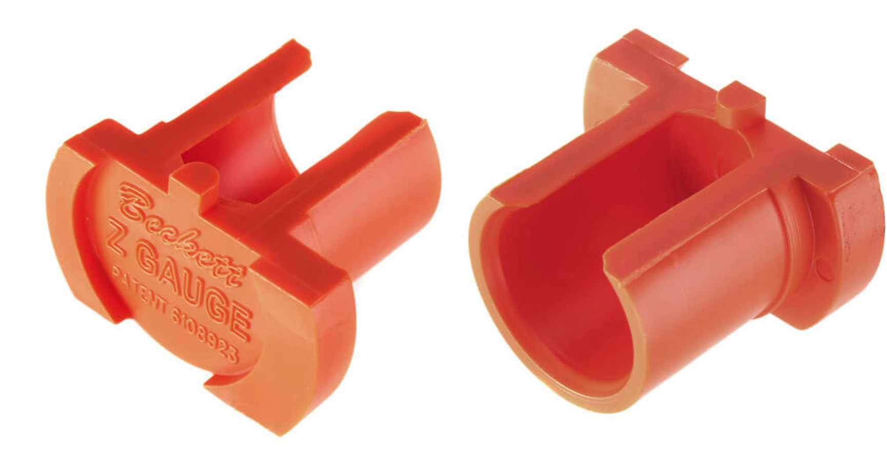

    There is actually a gauge that you can use to set the Z dimension when the burner is already mounted and it would be a hassle to remove the burner to measure from the end of the F heat ro the face of the nozzle orifice. This is the Beckett Z gauge
    It measures the Z dimension from the back of the end cone so the nozzle is in the perfect position in relation to the flame retention head.
    Other burner manufacturers use a fixed head end cone like the Aero oil burner found on some oil fired water heaters and the Ducane furnace also had a fixed head oil burner with the same brand name (but I think is was built by Wayne oil burner folks. You must follow the manufacturers specification for that dimension on any fixed head burner.
    As @EdTheHeaterMan said
    Do not move a nozzle assembly on a fixed head burner. That one must be set to the factory spec. Adjustable head burners like Carlin can be adjusted within reason.
