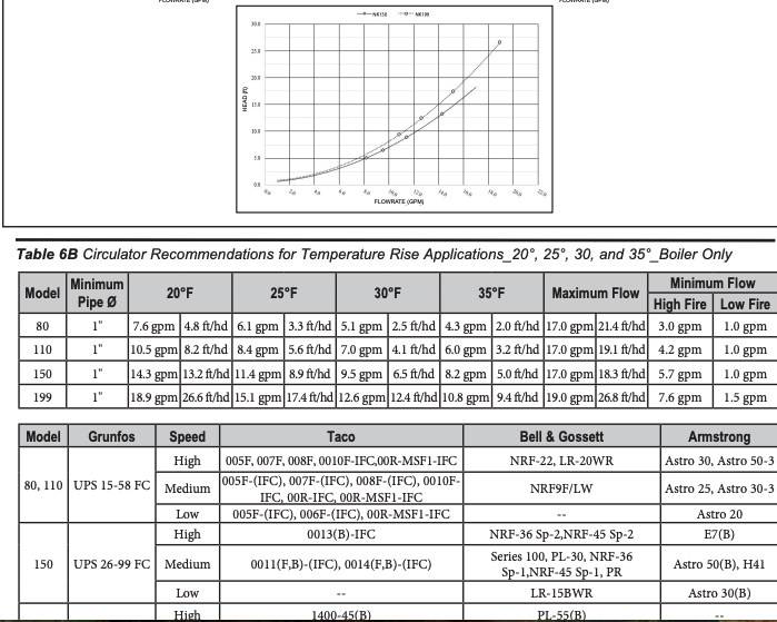

    The plumbing company installed B&G NRF 25's on everything. Boiler, Indirect, all 4 varying sized zones. The pumps have been noisy, a low frequency hum throughout the house. The 25's are not listed by lochinvoir in the install sheet. The 26-99 is, 0013, NRF36 & 45. I was just going to buy a pair of 26-99's for the boiler loop and indirect tank loop, then I got into the weeds of energy efficiency and ECM.

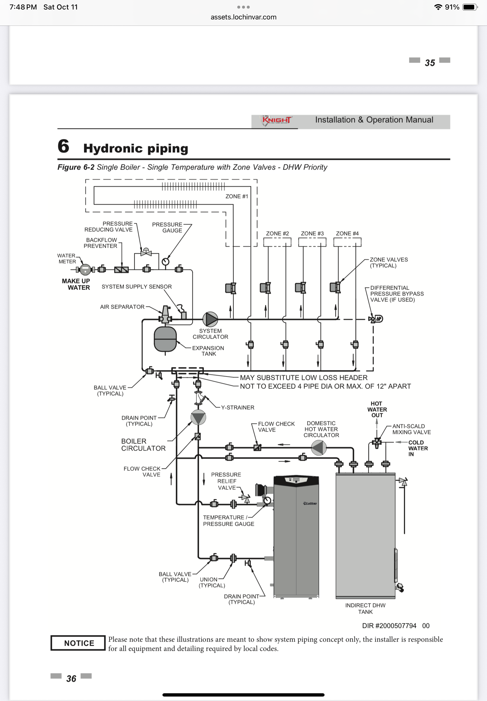

    If it is piped as a primary secondary then the NRFs are zone pumps? We need to see your exact piping to confirm that. Plenty of misinterperted P/S piping out there :)

    The boiler needs to have the pump that Lochinvar shows in the manual. Lochinvar does a good job of showing and explaining which pumps to use on the boiler based on the operating deltas you choose. Looks like the 26-99 is fine.

  • thanks Kaos. After reading Hot Rods reply it got me thinking I should dig a little deeper. I did a quick calculation of the head and flow of my boiler loop compared to the Lochinvoir install manual. My piping is shorter and 1 1/4” vs 1” piping used as an example in the manual so it seems some of the recommended circulators are too powerful. I am considering a 0018e set to zone mode. It connects to an app to read the flow gpm’s. You are right about the boiler size, I believe it’s oversized too.

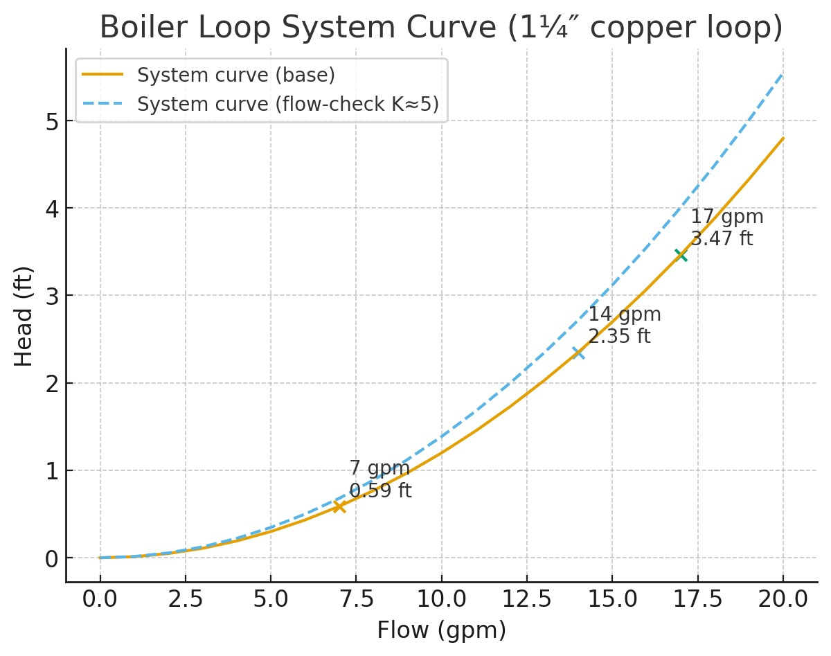

    Boiler Loop:
    • 14’ 1 1/4” type copper pipe
    • 6- 90 degree elbows
    • 2- 45 degree elbows
    • 2 full port valves
    • 1- 1 1/4” In Line flow check
    • 2 closely spaced T’s
    • Boiler HX, Lochinvoir says minimal? NKB 150 Noble
    Working on circulator sizing. Do these numbers look OK based on the above?
    • 7 gpm: head 0.6 ft (conservative 0.7 ft), ΔP 0.3 psi
    • 14 gpm: head 2.4 ft (conservative 2.7 ft), ΔP 1.0 psi
    • 17 gpm: head 3.5 ft (conservative 4.0 ft), ΔP 1.5 psi
    hot_rod Posts: 28,705
    looks like 14 gpm for the 20 delta which is the lowest they show
    In any case the 150 requires a 26-99. But you have 3 speeds to play with.
    Or an Alpha 26-99

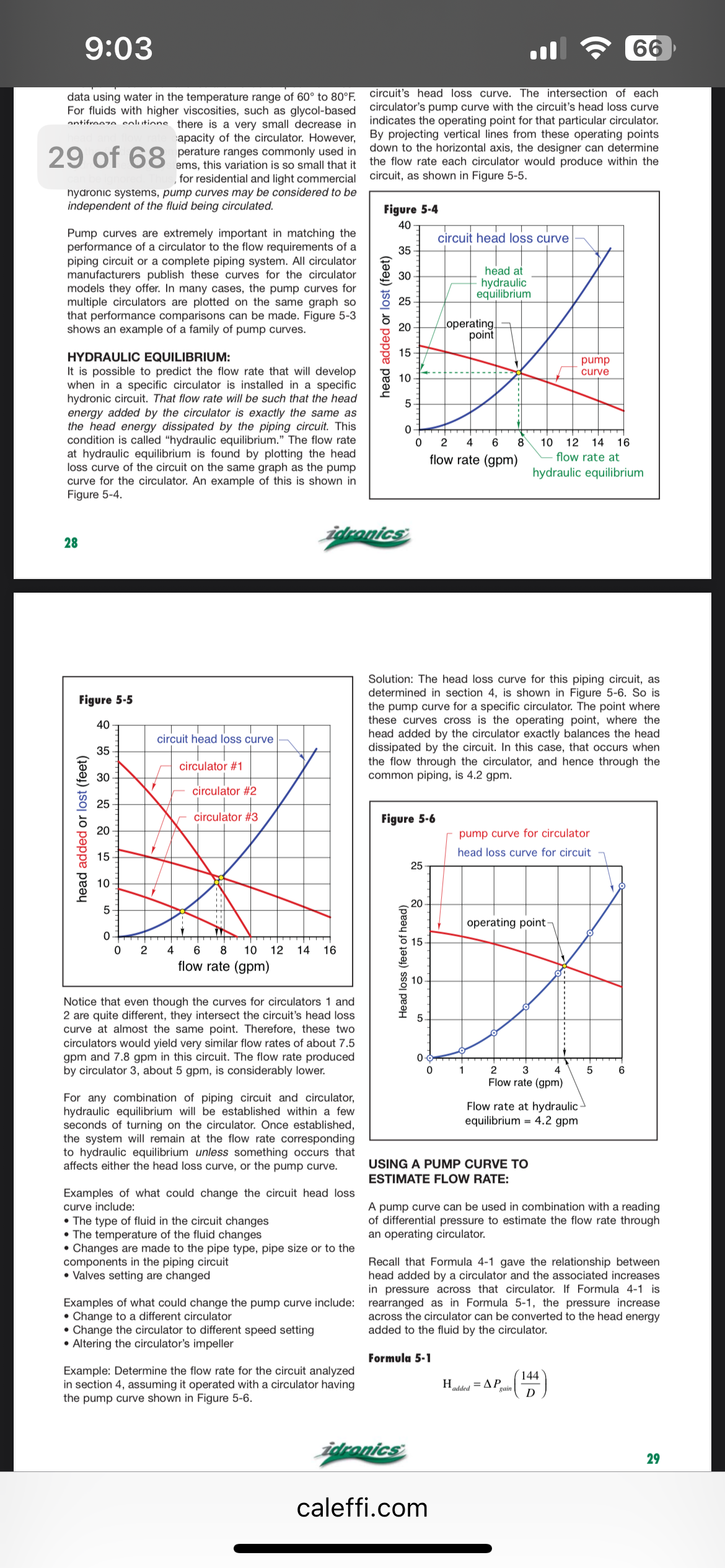

    If you want to go a step further plot the system curve over the pump curve. Where the lines cross is the OP operating point. That is where the pump is actually running.
    Idronics 16 explains the steps to do that math,
    Unlike thermal equilibrium, hydraulic equilibrium happens within seconds of a circulator bring reved up
    https://www.caleffi.com/sites/default/files/media/external-file/Idronics_16_NA_Circulation%20in%20hydronic%20systems.pdf
