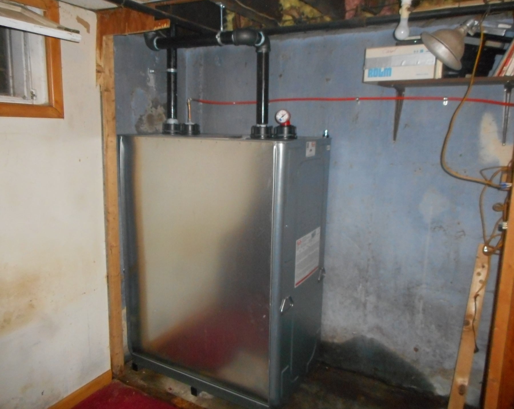

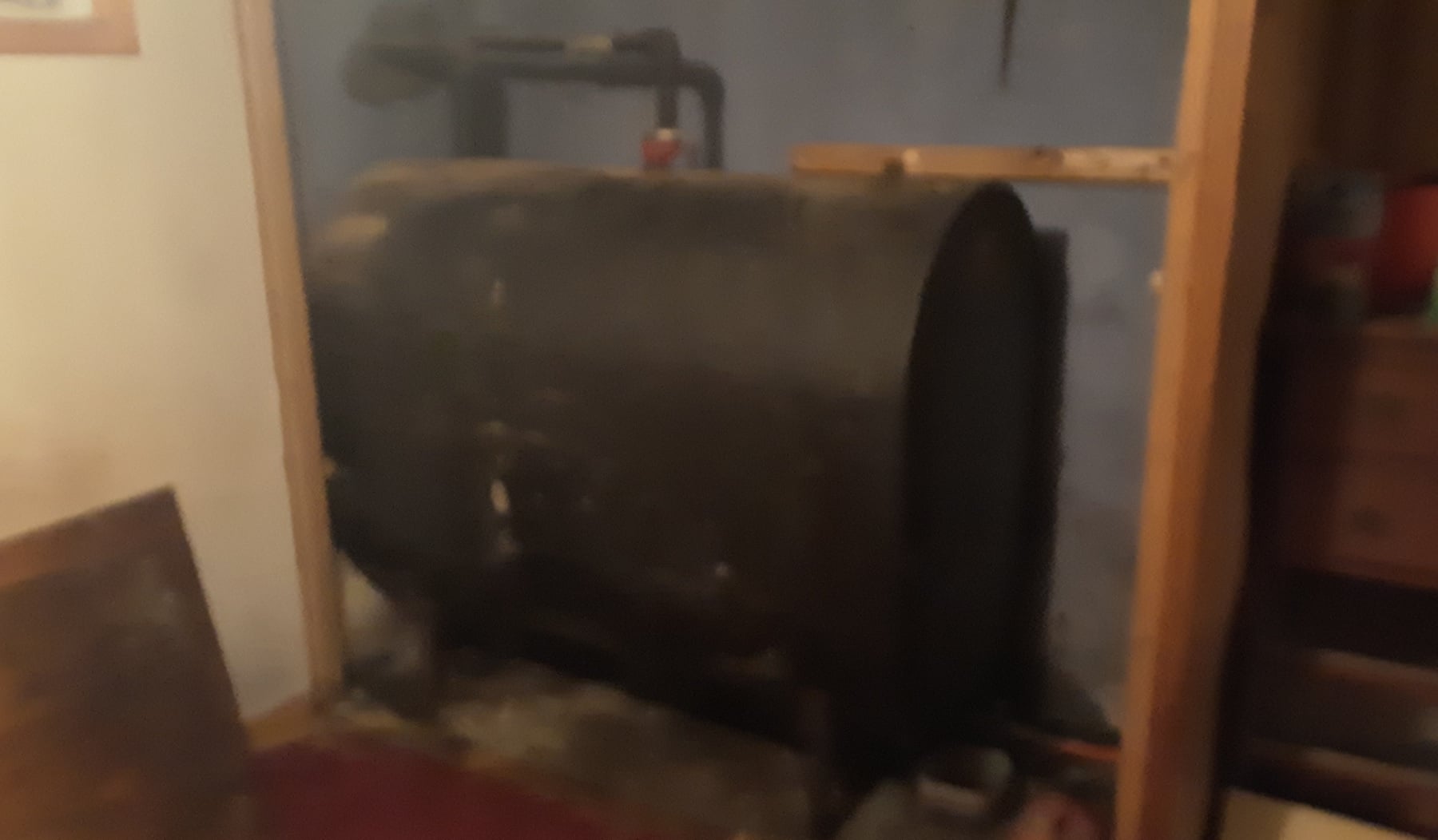

I'm hoping nothing will have to be done for a while. The company i used just installed a new Roth double wall oil tank. It was only about $100 more than the standard Granby oil tank like what I had previously.

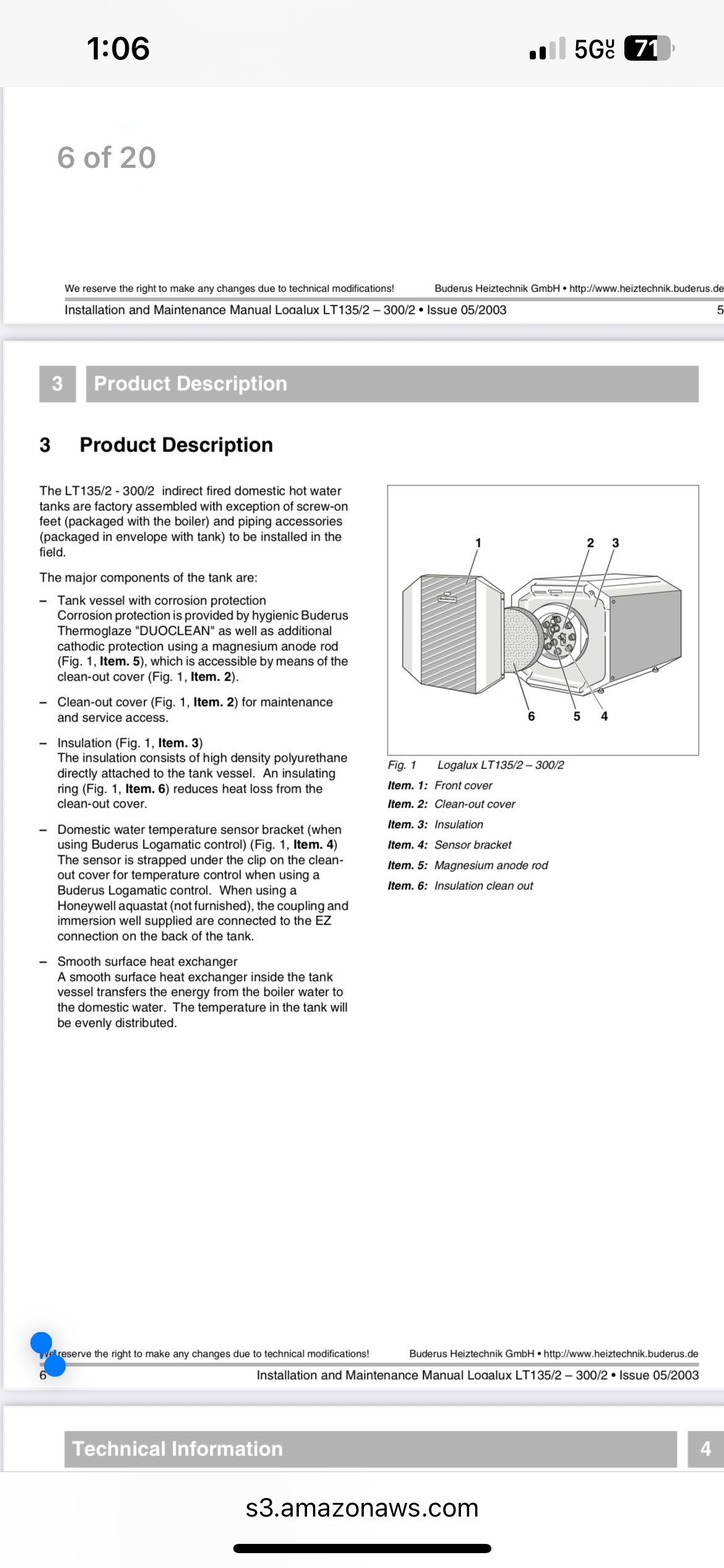

    Thanks for the reply. Here's what I have - the Buderus model is a Logano G115. I honestly don't know if this is considered an idirect water heater system. Yes re: considering a stand alone water heater when it comes time to replace what I have now. Noted re: it's best to have an indirect system.

  • Hi and thankyou both. I think I need more coffee 😛 It looks like the anode goes in from the front and is horizontal. Also, it looks like the plate the rod is in needs to be removed and held horizontally, so the anode can be fastened to it. So, it's trickier than replacing a vertical rod, but not so hard. Still, it looks like it might take some time, which could be why the tech wanted $$. If the anode is essentially used up, the tank is damaged. If the anode still has much magnesium, the tank is likely sound. Reading the anode is the best way to know how the tank is doing, in my opinion… so I'd want to have a look at it before deciding on a course of action. If you do dig in, please take photos of the anode for us!

    @Larry Weingarten the blue box below the boiler burner unit is a horizontal indirect tank. space saver because you can place the boiler on top of the horizontal tank. I like this setup because it places the oil burner at a comfortable working level. Since the boiler flue passages are serviced from a front door opening, you do not need to get to the top of the boiler for any kind of service.
    @Stelcom66, You have the best heating and hot water system available. There is no need to install a separate tank with its own heat source (electric gas or oil) and possibly a vent pipe connected to a chimney
    I have used an oil fired water heater that was connected to a chimney. Every 4 hours there was enough standby loss up the chimney that the oil burner needed to operate for 8 minutes to bring the water temperature in the tank up to the 125° setting on the control. That happened even if I did not use any hot water. I have found that when you use that Buderus indirect tank, there is so much insulation around that tank that it takes as much as 20 hours for the temperature to drop enough to need the burner to operate to restore the stand by loss.
    What I'm saying is that the oil burner connected to the stand alone water heater will run on average 48 minutes each day to maintain hot water even if you do not use any hot water. When you use the oil burner connected to your Buderus boiler to heat water it will operate for about 10 minutes every day if you do not use any hot water in order to maintain the tank temperature. that is because there is no vent connected to the indirect tank, and that particular tank is a better design that any stand alone water heater
    Also that particular tank may have a lifetime warranty…. that means they believe that you will never need to replace that tank. and if you somehow need to, they are giving you a free tank for your trouble. I would just do the recommended maintenance on that tank. It will last you many more years!

    You don’t have to drain the heating system to change or check the anode, just the domestic water in the indirect. That shouldn’t take more than an hour and I’d recommend that it be done.

    there is usually a clean out hole under the front cover of those tanks
