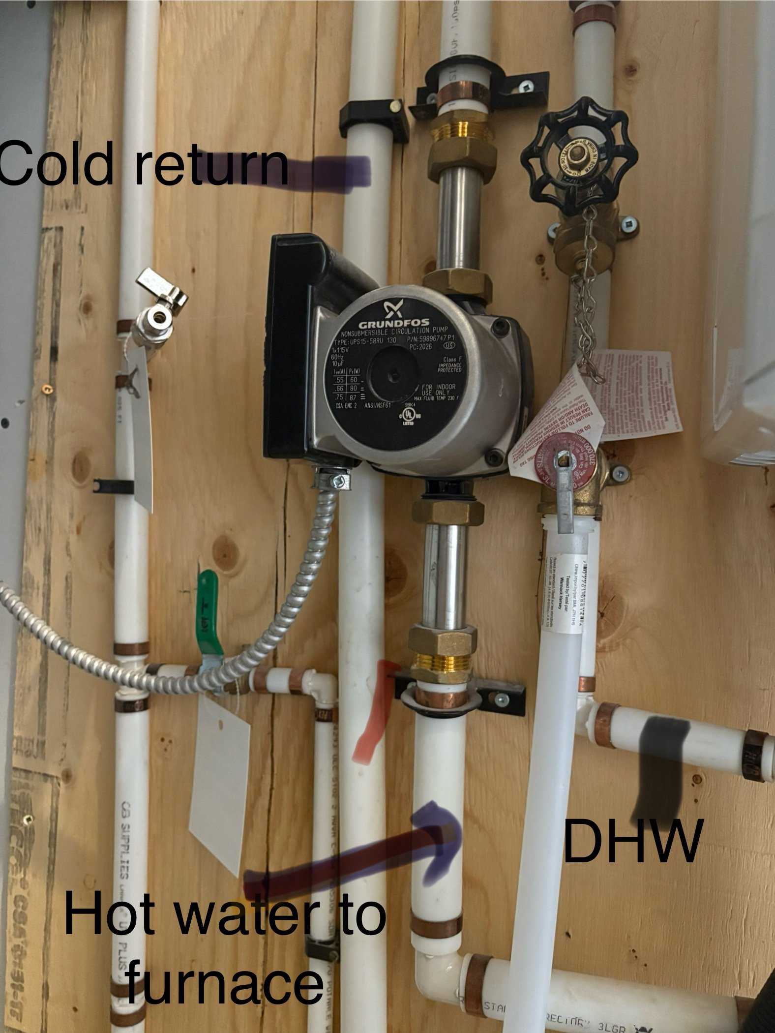

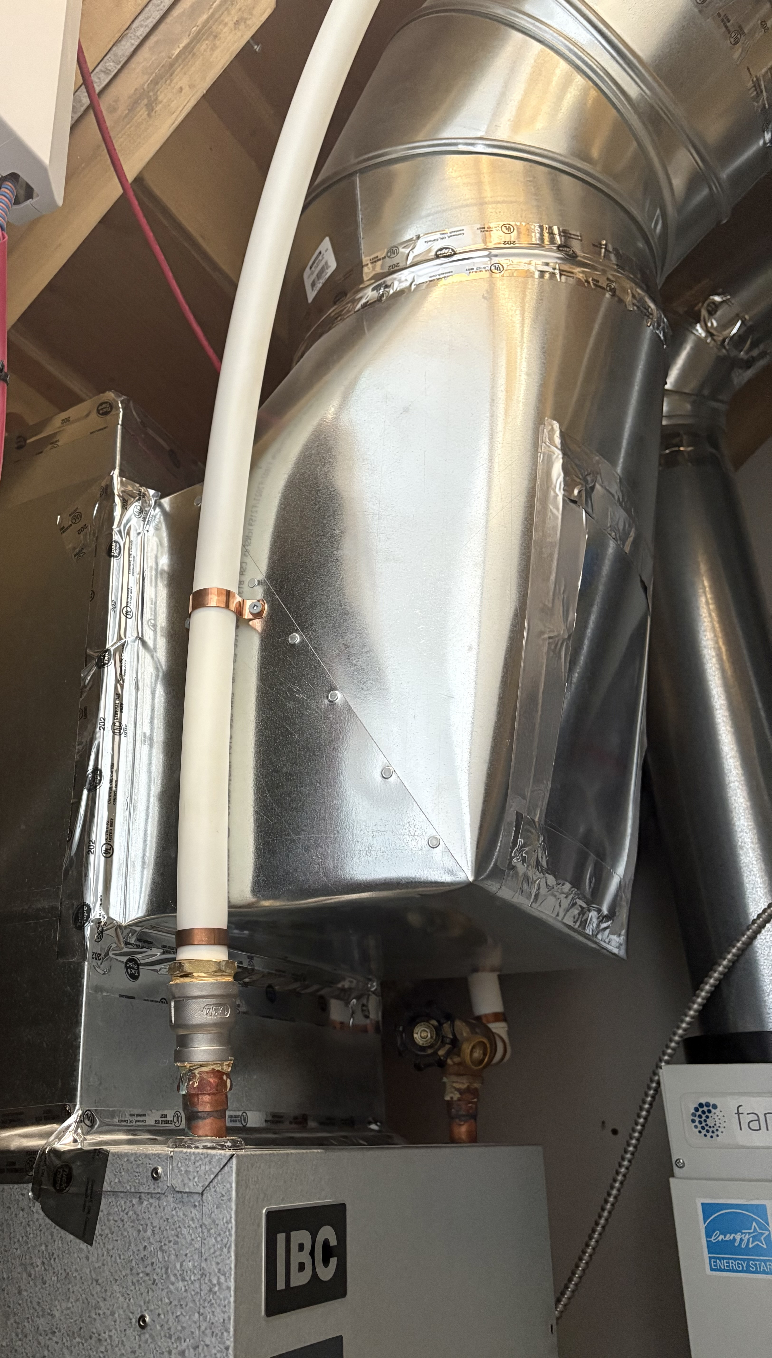

I am looking for any advice which could resolve the issue I am facing with our combi boiler unit.
We got a tankless water heater connected with a hydronic air handling unit . We started using our home heating system yesterday and since then we are getting mild hot water from the faucets. The strange part is every time the heat turns ON faucets give ideal temp hot water as they use to before. But when the heating system is not in use its again average temp hot water.
Note- tankless heater was descaled recently.
What could be the potential reason for this.

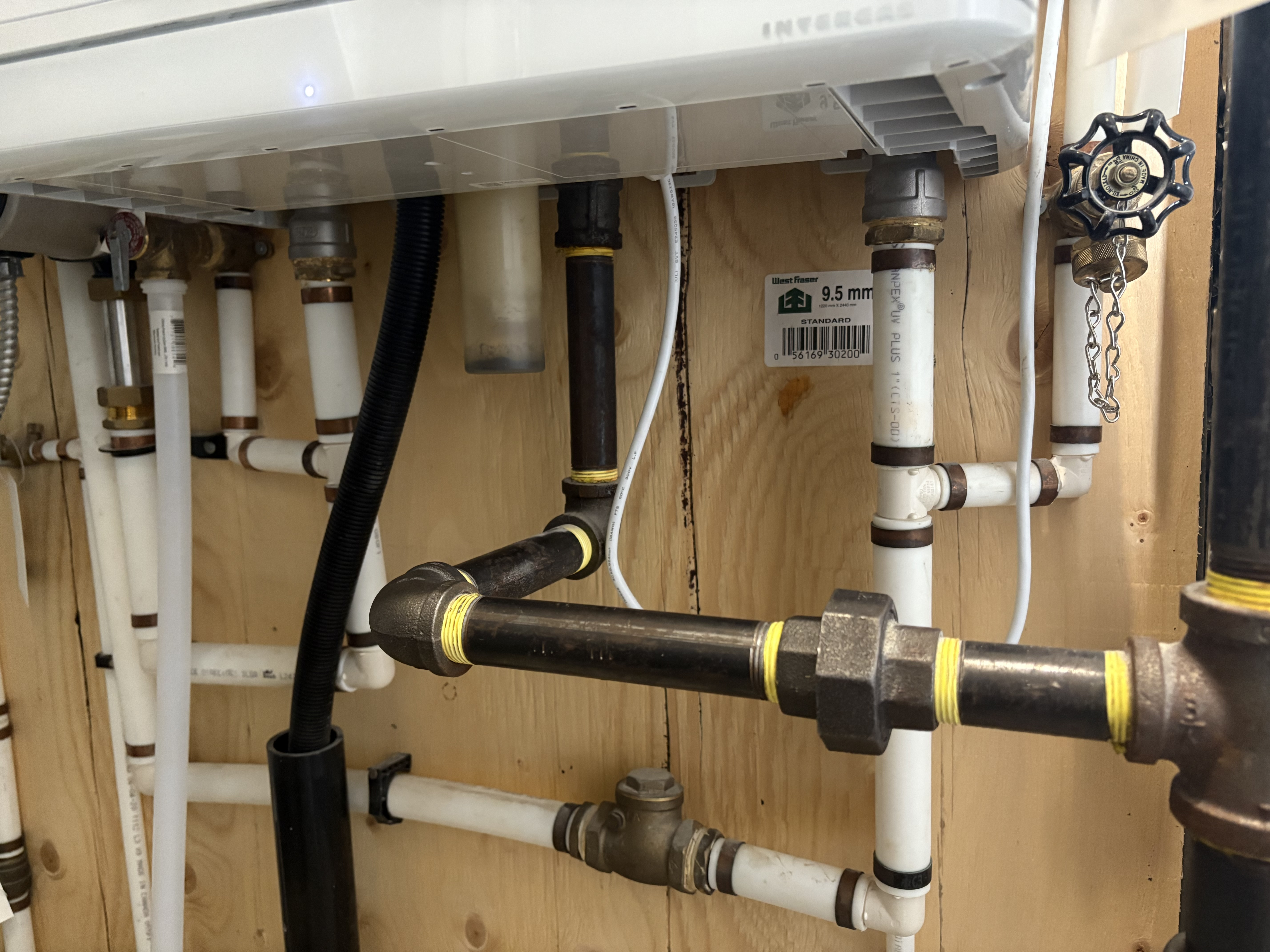

    take a pic of the install

    but this started only yesterday . It was completely fine until the home heating system was turned ON.

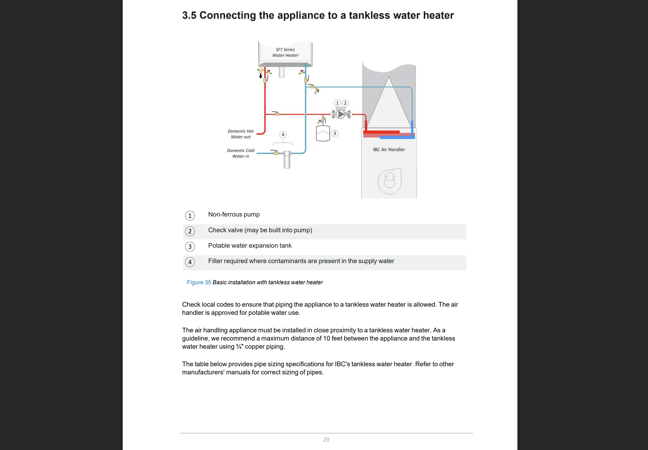

    Its a Ibc 199 sft tankless water heater which feeds a IbC Air handler as well.
    EdTheHeaterMan Member Posts: 12,543
    "Well blow me down". Quote from Popeye the Sailor Man
    I appears that IBC does offer an air handler that can be connected to their tankless water heater (does not need to be the Combi)
    I am personally not a fan, but is an approved use by the manufacturer. So I will look into the manual to see what may be causing the lower DHW temperature during the winter season while the air handler is not calling for heat.

    all of these tankless have a page in there install manual for a side take off for a heating coil on an air handler. Is that what I like to do , the answer is no but there out there ………. With out being there it’s hard to determine what’s going on . So let me ask, when you’re using the heat and the domestic water, is the water hot enough at your faucets ?
  • raricky
    raricky Member Posts: 20
    As long as the heat is running the domestic hot water remains hot enough. After maybe 5 minutes the water temp drops again.

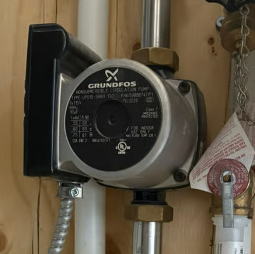

    These systems have a check valve between space heat and DHW. This is either an itegrated check inside the pump or a stand alone one. If this check is stuck or leaks, it creates the symptoms you see as cold water can bypass the tankless when the pump is off.
    A quick check is to see if the inlet of the pump gets cold when you have a DHW draw. If it does, you need to clean/replace the check valve.

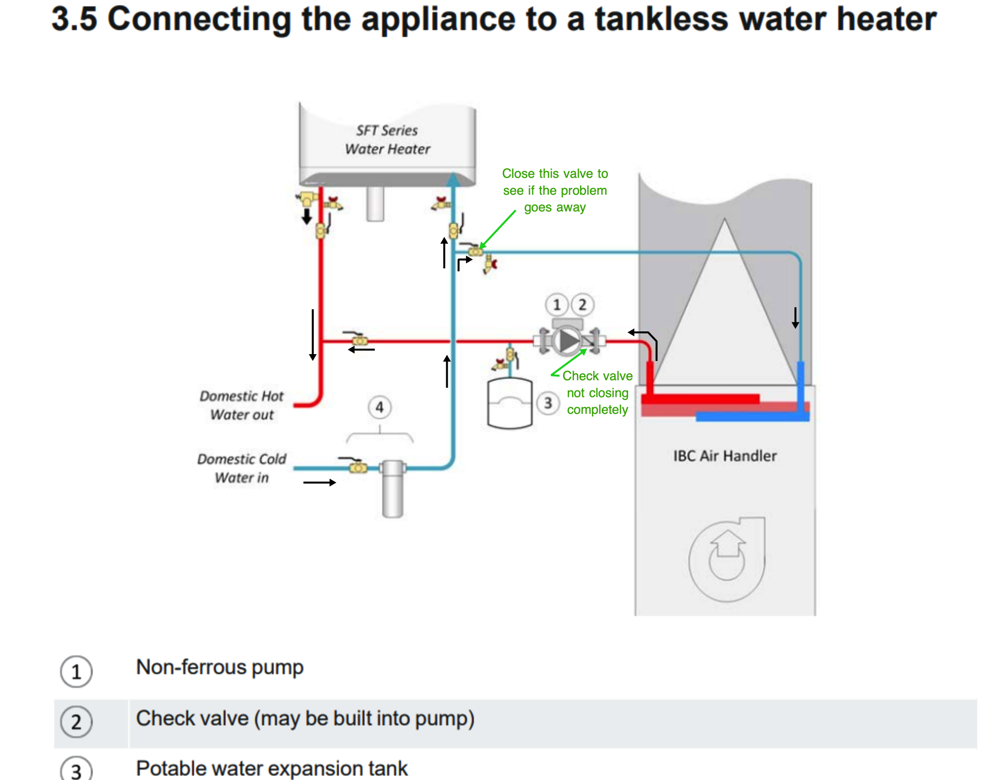

    I might check the check. as @Kaos mentioned. when you started to heat for the first time this season the check valve may have not completely closed on the space heat side of the system. An easy to check it is if the proper valves were installed you can shut off a valve to the space heat loop to the AHU and see if the problem goes away.
    The following diagram illustrates how the water can flow backwards when the circulator pump is off and the check valve is passing.
    When the circulator pump is operating, the reverse flow can't happen so you get HOT water. When the circulator is not operating the reverse flow will allow lower temperature from the AHU coil to mix with the Hot water and you end up with Warm Water

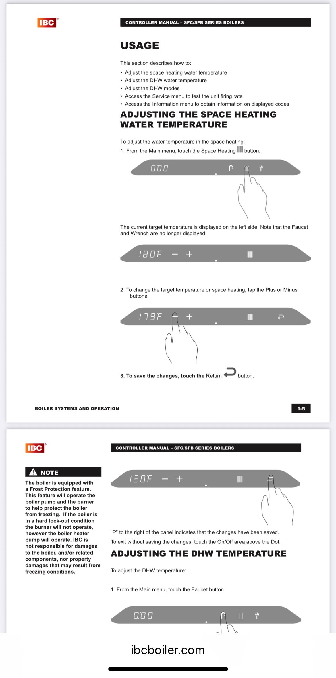

    I don't think you are going to have separate settings in there for space heating that's an SFT model not the SFC/SFB boiler models. this is almost certainly a piping/flow issue

    As mentioned by some contributors it could be the check valve in circulation pump causing the problem.
    I had this similar issue when i descaled this unit back in summers but that time I flushed water out from the plumbing system and it worked fine after that.
    I am probably going to call a professional to take a look what exactly is going on.
