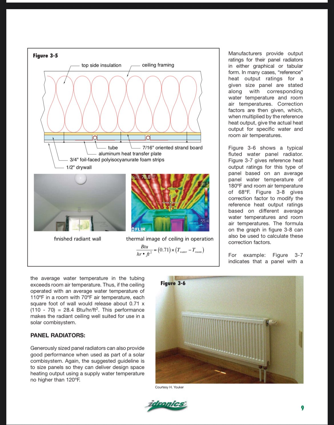

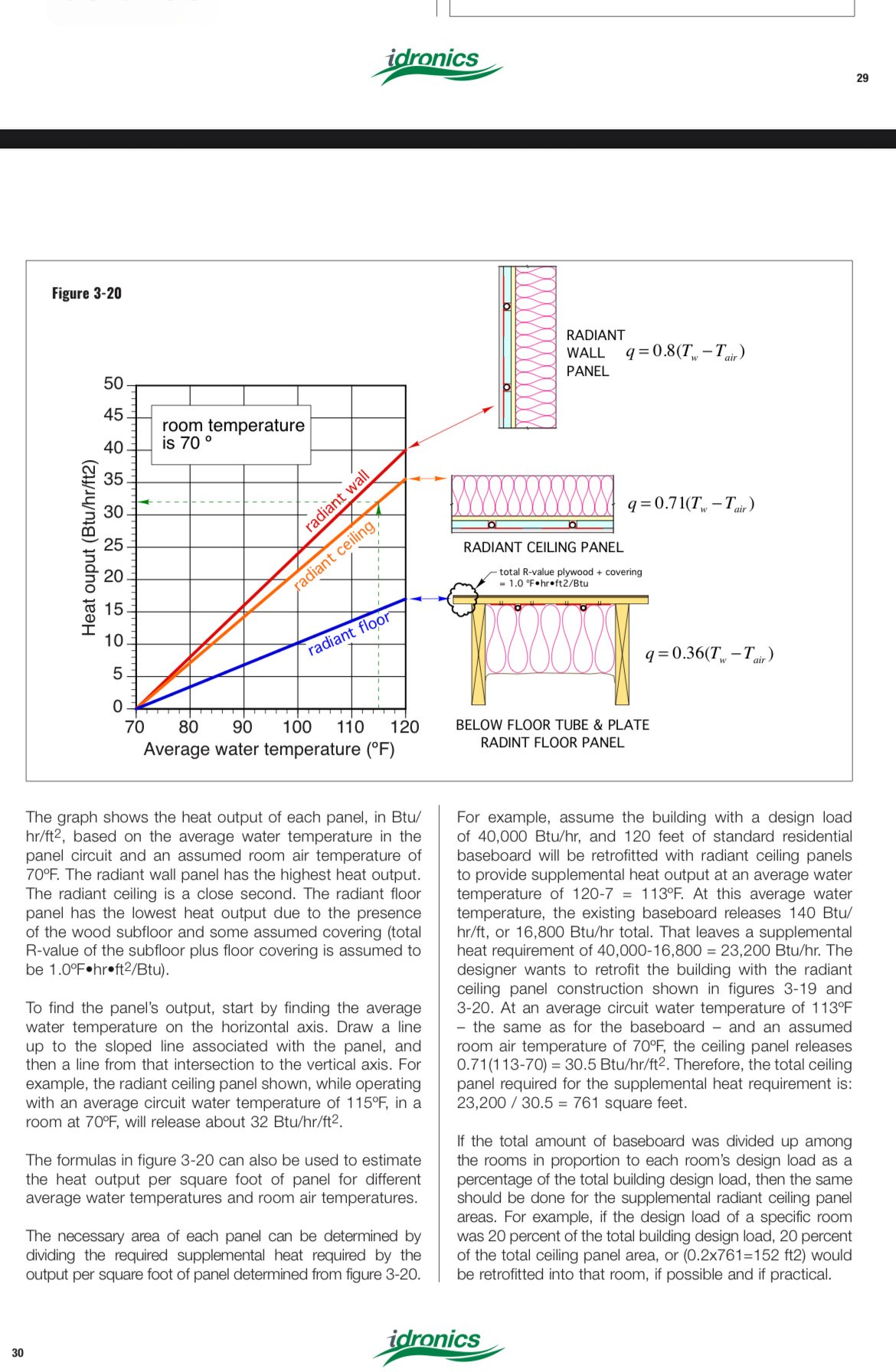

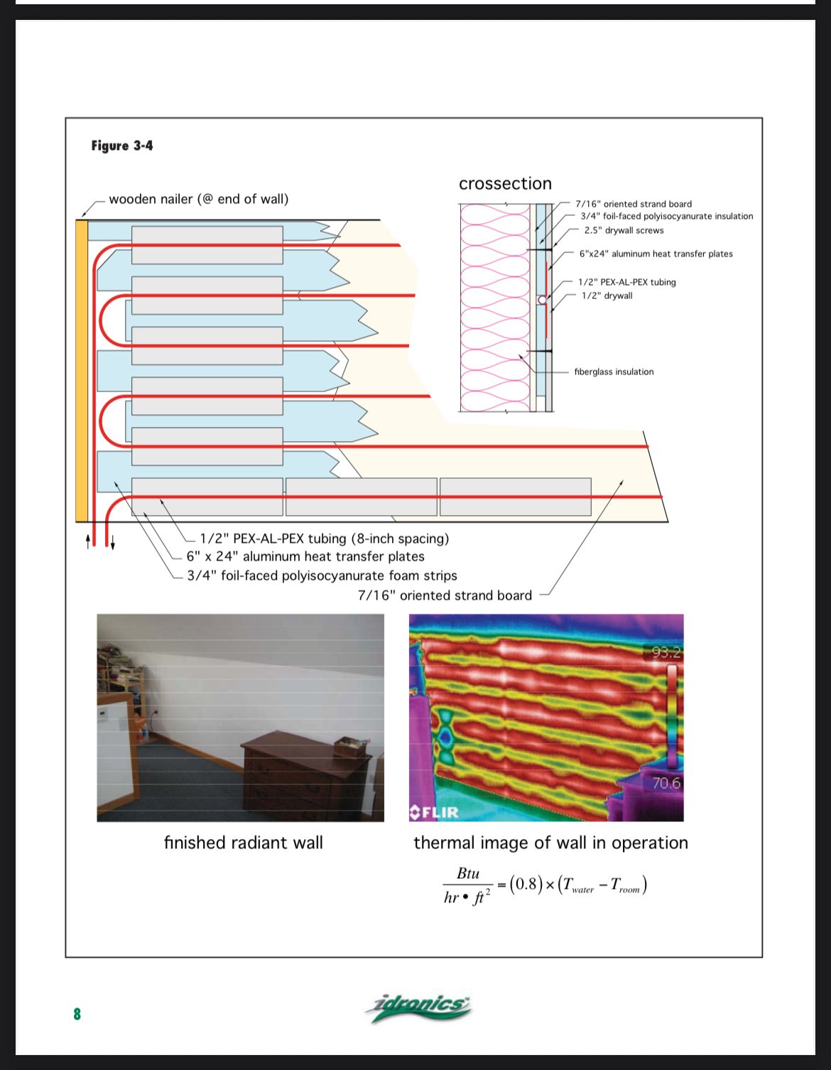

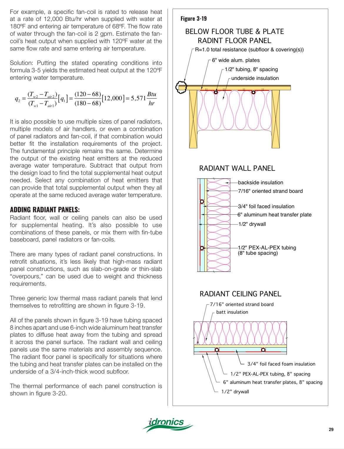

    here is some info on radiant floors, walls and ceilings.
    Uponor has a free design manual that takes you through all the steps, from load calc, to actual installation methods
    https://blog.twinsprings.com/wp-content/uploads/2013/05/Uponor-Radiant-Heating-and-Cooling-Design-Assistance-Manual-Part-1.pdf

    I have to admit the radiant walls make me nervous. I want to put labels on the wall “do not drill or nail - buried radiant piping”. 🤣😀🤪
    Mail4tommo
    hot_rod Member Posts: 28,078
    typically radiant walks are limited to the lower 3’, so mostly out if harms way for picture hanging etc.
