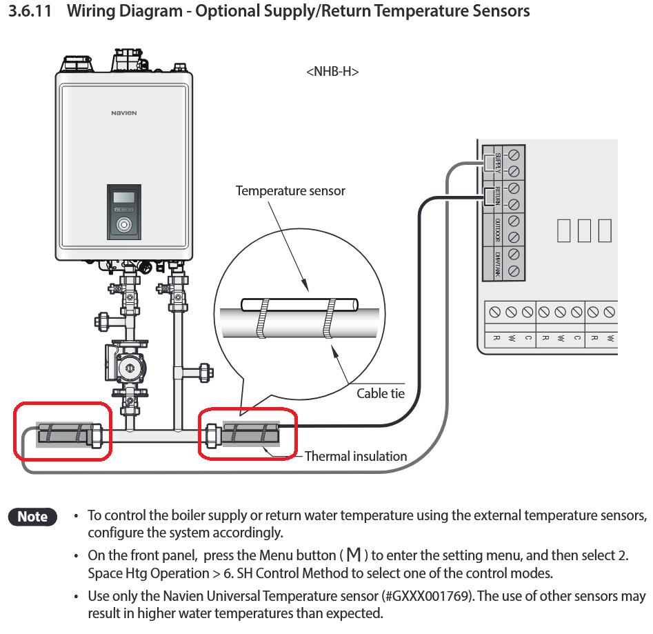

    if you use an optional sensor on the system side, it reads the supply and returns This may differ from the boiler supply and return depending in how it is piped

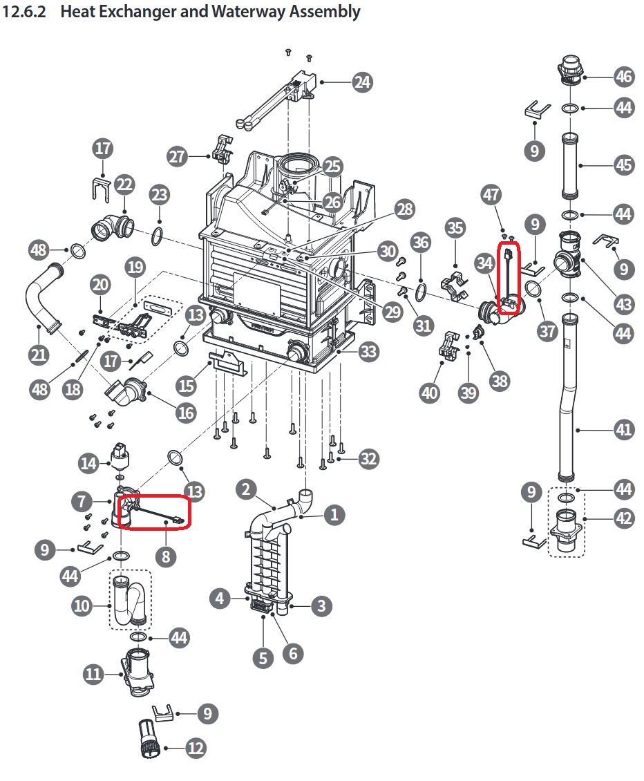

    I think you will find 6. Supply Temp, 7. Return Temp, are inside the boiler's jacket and
    8. Sys Supply Temp, 9. Sys Return Temp. when used are on the external pipes.

    109A-5…I never would have thought to look at the "parts diagram" to understand the vocabulary used. The "note" on fig 3.6.11 tells me where to look next…THANKS.

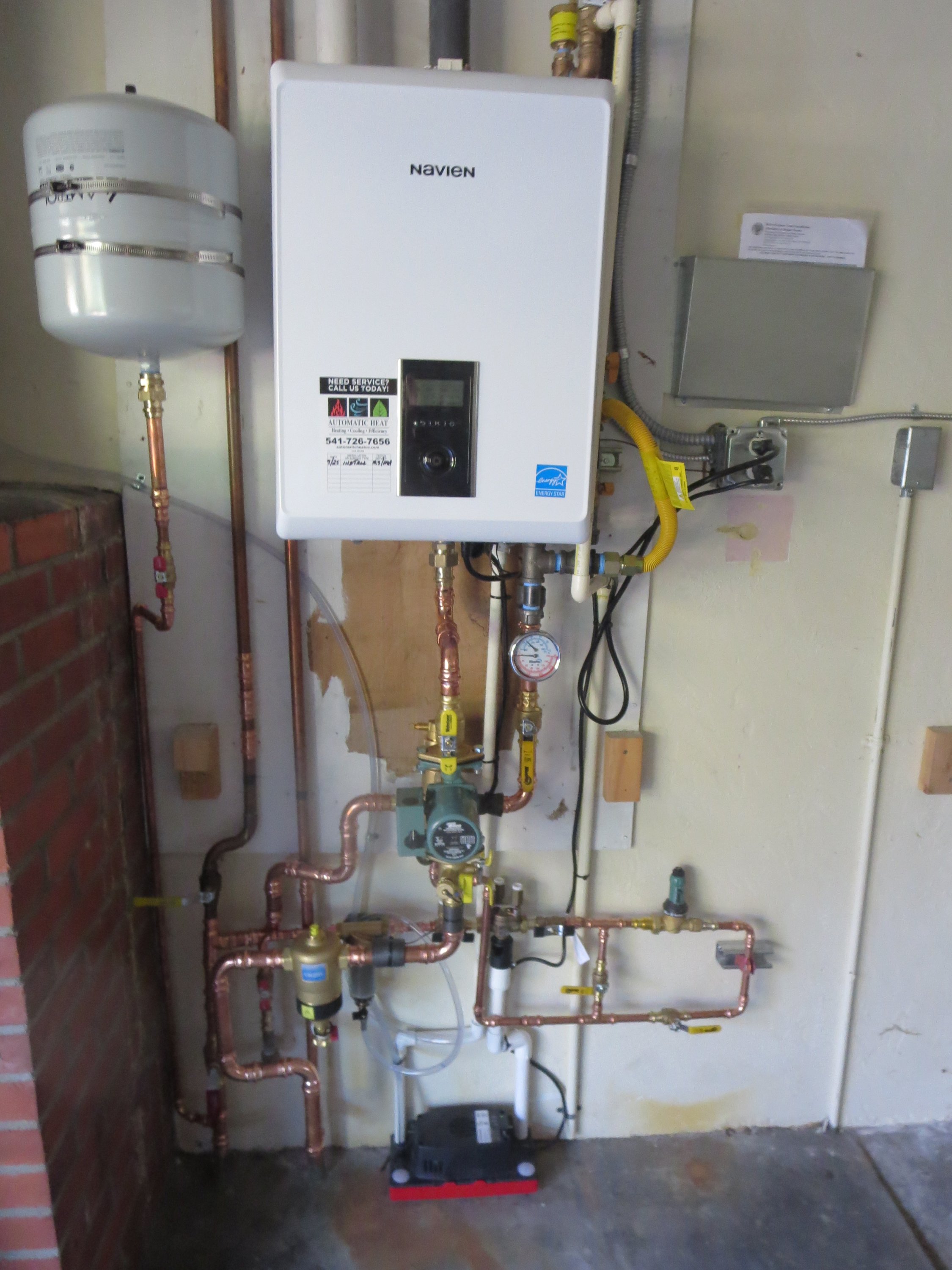

    post a picture of the boiler and all the pipes around it, all in one shot,

    photo attached. ignore dark copper pipes (vertical to ceiling) far left. they go to baseboard fins
    in garage (shut off). supply/return also on far left, but go into slab floor>thu foundation>crawl space.

    That looks like direct to load (there is no extra pump elsewhere). The most likely culprit for the temp loss is you are loosing heat into the slab. Concrete is a great conductor of heat and so is the dirt under it. Depending on how long that bare copper run through the concrete it is, you are loosing some real BUTs there.
    The other thing that really irks me is the lack of outdoor sensor. A modcon running at fixed 180F output does not condense at all, you are giving up about 10% of free efficiency most of the heating season just because the installer didn't care to install the outdoor sensor and set a reset curve.
    The high temp also means your unit will cycle more and no condensate means more buildup on the heat exchanger.
    Installing the sensor (which was included for free with the unit) is one of those things that there is pretty much no drawback to out. You use less gas and the unit lasts longer.

    Personally, if a customer asked "all efforts to go toward getting HOT water (160-170)" hydraulic separation would have been my first requirement for this boiler…. That heat exchanger has an excessive pressure drop, its the same style thats in a tankless water heater, tiny little passageways, meant for higher pressure DHW systems…. Think about it for a minute, if I can heat my house with 180 on the coldest day of the year, then I can heat with lower temperatures every single other day of the year, ODR isn't the blockade to your comfort, flowrate might be though… I suppose at this point we don't really know IF there even is a problem yet correct? You may be reading a lower value at your baseboards because with the system set to a higher than necessary setpoint the system never needs to reach a "high temp" average water temperature to end a call for heat with mild weather conditions. (if flowrate is an issue that also adds to it of course)
