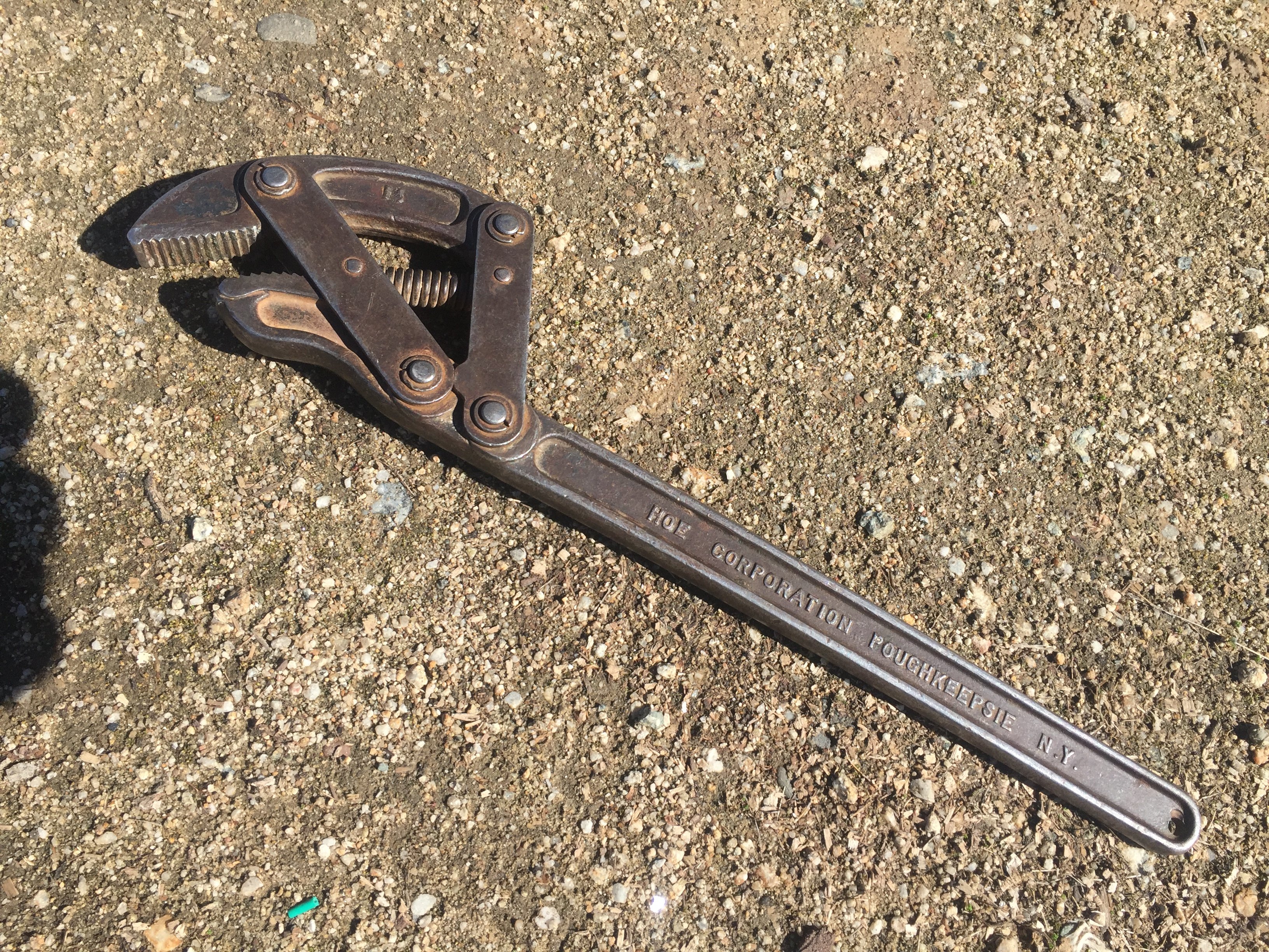

  • Just throwing out an idea here, but it sounds like the jaws of a modern pipe wrench are too wide to fit. I use a Hoe wrench (patent date 1922) for much of my work, as it has narrower jaws and fits nicely where modern Stilson wrenches don't.
    Yours, Larry

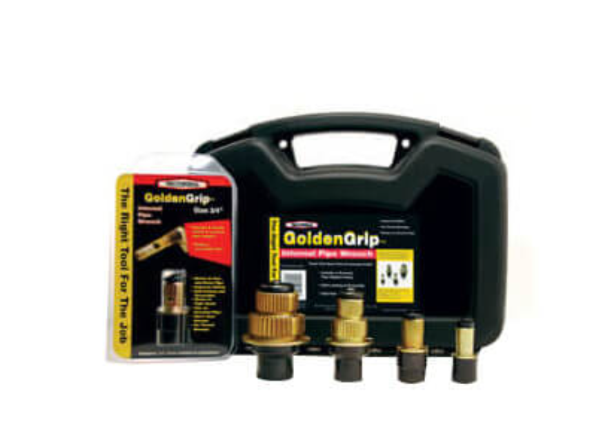

    there is something like this if the id is in the range of these
    https://www.supplyhouse.com/Rectorseal-97256-GoldenGrip-Internal-Pipe-Wrench-Set
    kcopp
    109A_5 Posts: 4,759
    Oh OK, by your description I thought you had this one and you snapped the square drive off.

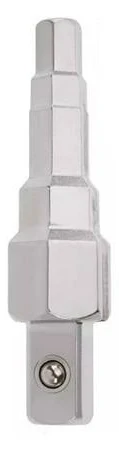

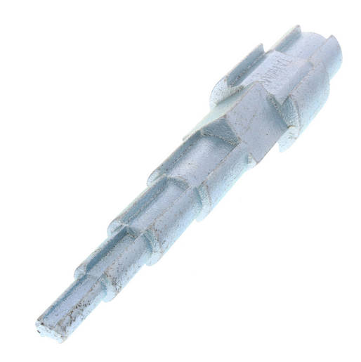

    Intplm. Posts: 3,162
    These three spud wrenches have their uses. Otherwise, it's a big pipe needed.
  • kcopp
    kcopp Posts: 4,735
    wrong wrench.
