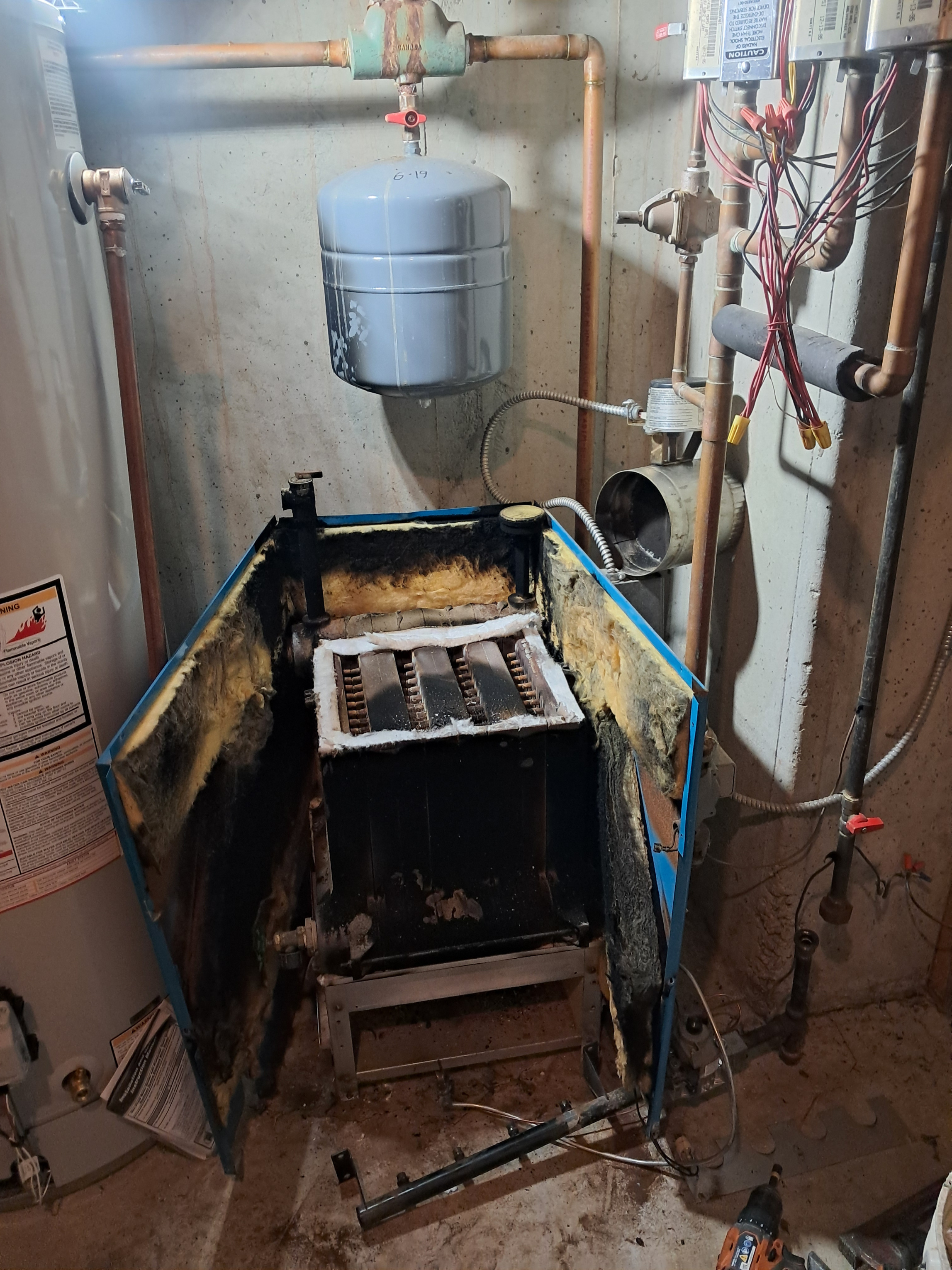

  • fixitguy
    fixitguy Posts: 100
    Today's mess, notice the soot on the side of the expansion tank. He wanted it serviced and put back into running condition. I had to laugh at that.
  • RayWohlfarth
    RayWohlfarth Posts: 2,093
    @fixitguy How come those calls always come on a Friday. Good luck

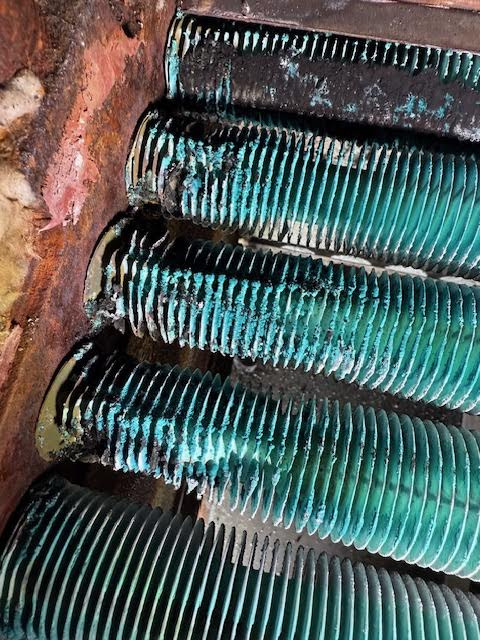

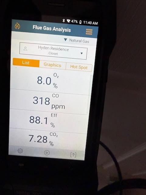

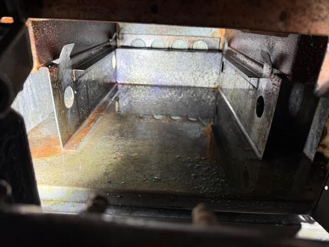

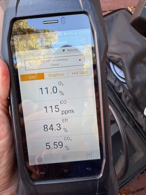

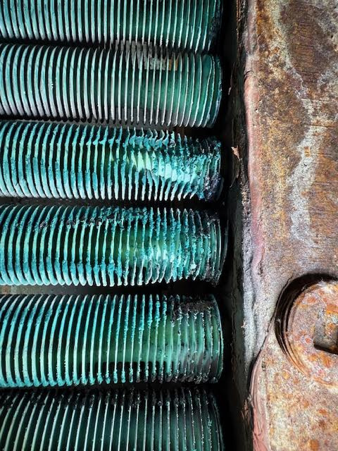

  • We had one today as well. We cleaned it - a Laars - two years ago and the owner wanted it checked this year; high CO and we were able to bring it down after flushing it with water.
    It seems that once it soots up, it's predisposed and will soot up again and again. I believe the cause was condensation from low return water temperatures and possibly not enough makup air.
    He's due for a new boiler, but doesn't want to spend the cash right now.

    Steamhead Posts: 19,022
    Common problem with that type of boiler.

  • captainco
    captainco Posts: 854
    Is that supposed to be a condensing boiler? Without seeing the flue temperature it has to be under 300 degrees based on the O2 and efficiency. Definitely a condensing problem.
    Just for better understanding why does return water temperatures caused sooting? 140 degrees no sooting but 130 degrees sooting. What about combustion air colder than 70 degrees.
    As a wholesaler for over 20 years I sold boiler reset controls and based on a 20 degree differential, our customers never had a sooting problem and our lowest setting in mild weater was 105 to 125 degrees.

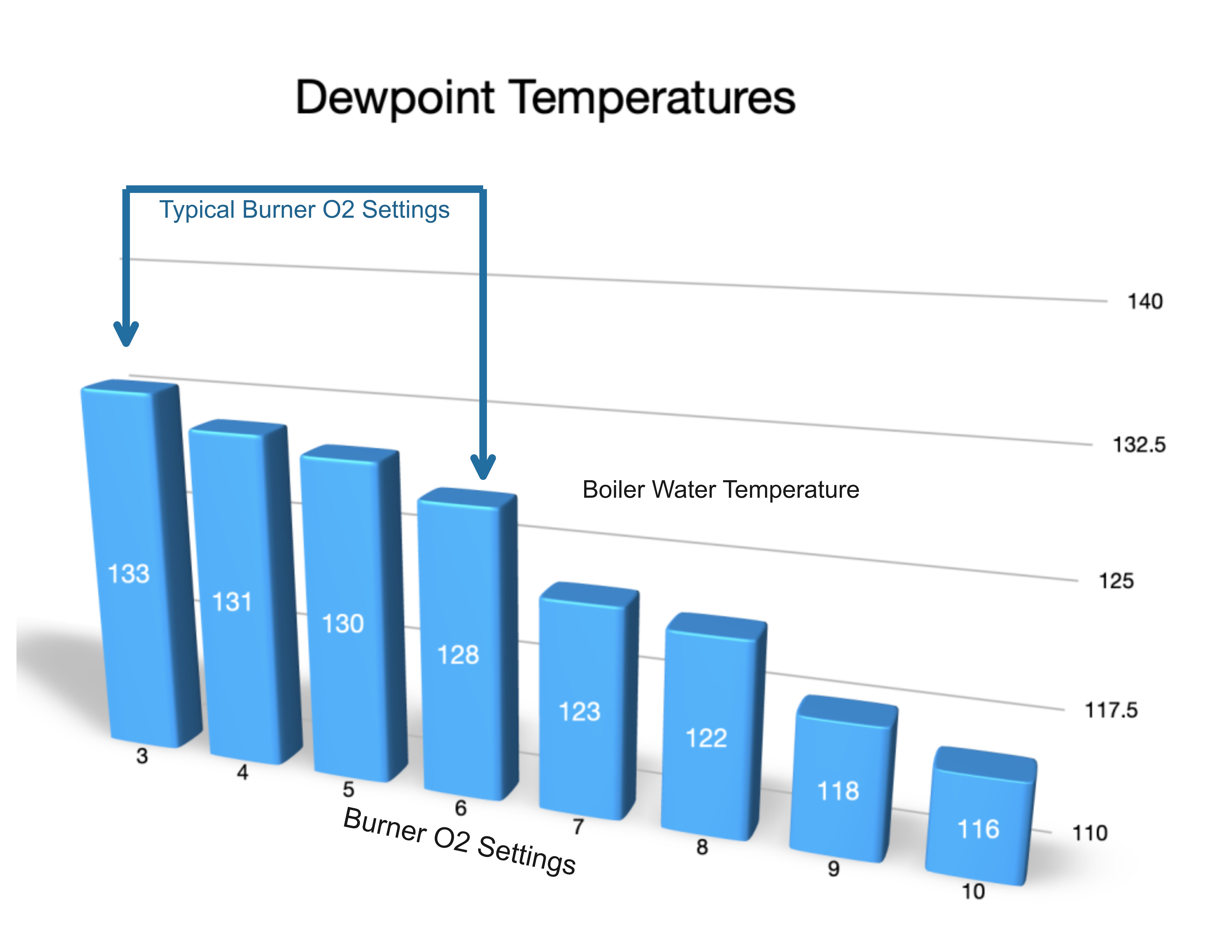

  • RayWohlfarth
    Here are the dewpoint temperatures depending on water temperature and excess air.

  • captainco
    iThe flame temperature of a burner is over 2500 degrees. It is written that for every degree the combustion air changes the flame changes temperature. That would be the same logic for water temperature. Remember water heaters never heat water above 140 degrees and definitely don't have incoming water temperatures above 140 degrees.
    Condensing is caused by underfiring, inadequate combustion air or improper venting. These will eventually cause sooting, but water temperature is never the cause.
    markdelzell
  • Sooting is caused by carbonizing flame, spyder in burner intake or burner flame impinging on cold boiler surface.
