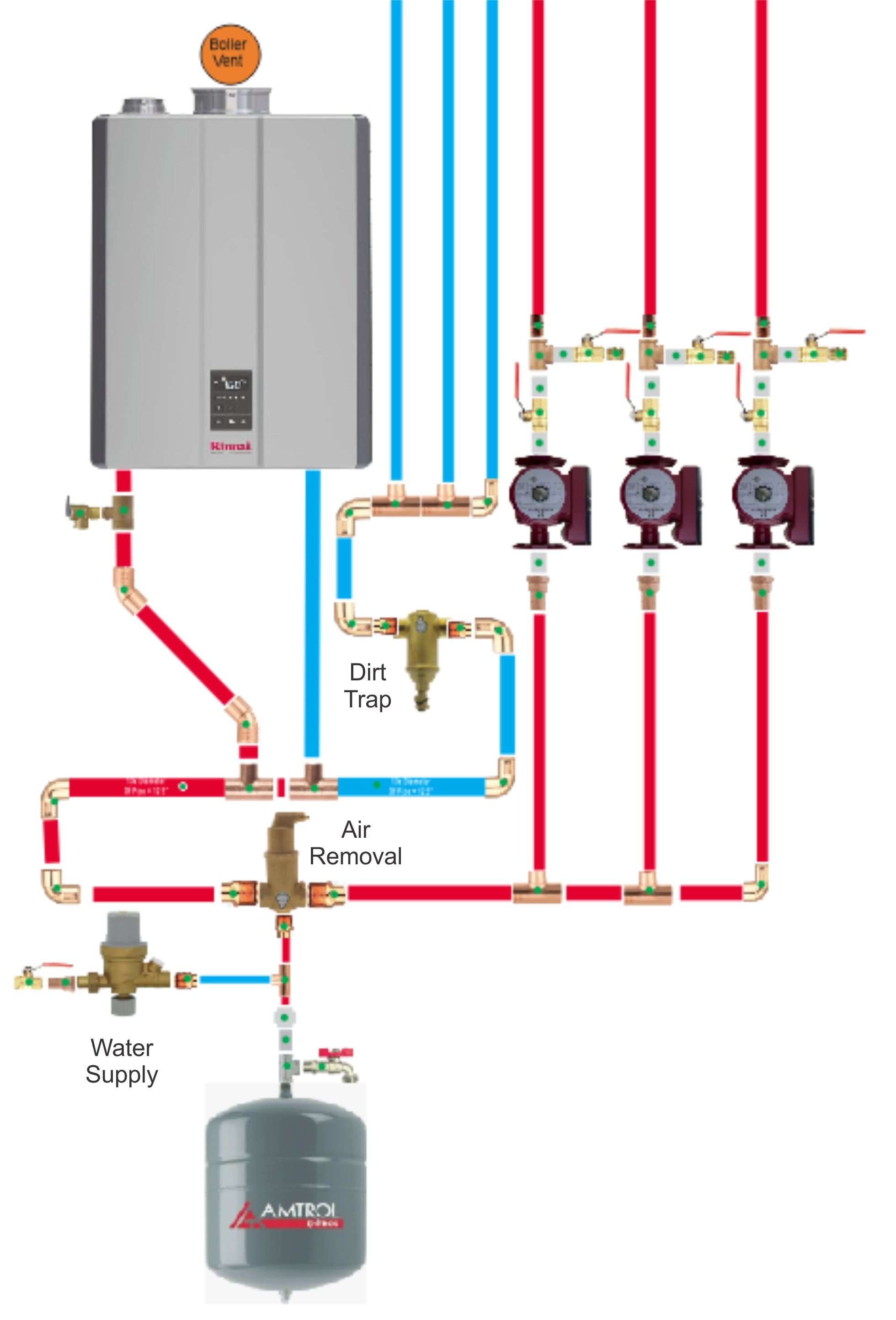

    Here Is A Drawing Of The Proposed System…
  • Kaos
    Kaos Posts: 1,003
    I would double check, but I think only the combi comes with internal pump, so you have to add an external pump to the primary loop. You also want some purge valves on the primary loop to help with air removal.
  • GGross
    GGross Posts: 2,104
    if there is no built in circ I recommend putting the external circulator on the return pipe flowing into the boiler (blue vertical line under boiler) and yes you will want some drains and valves. webstone makes pump flanges with and without drains that are nice, they also make ball valves with drains built in.
  • GGross
    GGross Posts: 2,104
    edited September 2025
    some other minor notes. I like to have a valve to shut off the auto feed, that way know there is a leak, taking on fresh water is typically not good for closed loop boiler systems, alternatively you could look into building a filling unit with an autofeed and an extra expansion tank that way you could control the makeup fluid. there are also pre-built systems for this. webstone makes an expansion tank service valve that will take the place of several fittings at your expansion tank and autofill setup . you also may be required by code to install an external low water cutoff device if there is not a flow switch safety built in to this. many have a pressure sensor safety that is sometimes accepted by local inspectors and sometimes not.

    FWIW….
    According to Rinanni…a user supplied circulator pump is necessary for the boiler loop, in addition to the radiators loop(s) circulator pump(s) for the Rinanni i150s Non-Combo Boiler.
