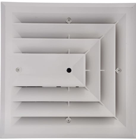

I'm thinking about replacing a central air system with a ducted heat pump. The existing A/C system has ducts in the attic (which I plan on re-using for the HP) and diffusers in the ceiling. There is a single return in the ceiling in a common hallway. The diffusers are very similar to the attached image. These work fine for A/C in the summer, but I am concerned they won't be as effective for heating. Is there some kind of hybrid diffuser with the same footprint I can look at that would serve both cooling and heating? I'd prefer to re-use the existing ceiling holes and not cut new ones if I don't have to. This is for a home in the Hudson Valley of New York state. Existing heat is hydronic with an oil-fired boiler, which I still intend to use on colder winter days. Thanks.
The existing diffuser type doesn't matter, what you want is the duct size behind it.
With ceiling register and for heat to work well you want something with decent throw straight down, you have to get the air down to floor level to mix. You also have to watch where people will sit as you don't want to blow air directly at people.

If the diffuser shown is what you have, then its more than just a diffuser replacement. What you're showing comes as a combination register/boot so replacing the diffusers will also need new boots.
