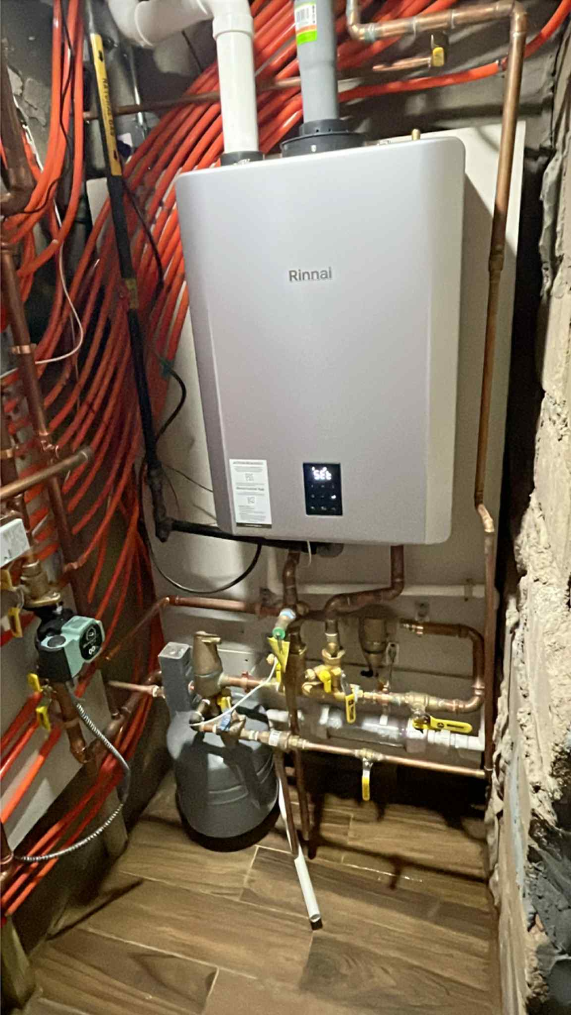

Hi all, I need some input from the professionals.
I recently had a solo Rinnai tankless boiler installed (IP060S). It's hard to tell from the picture but on the left I have two sets of pex manifolds each controlled by a Caleffi zone valve and both branch circuits are fed by a Taco VR1816. I purged all if not most of the air from the system, first from the secondary side, then from the boiler side with a sump pump and a couple of buckets.
I had my plumber come by to start up the unit because I was originally getting low water pressure error codes. He resolved that quickly but then came the main issue.
When there's a call for heat, the boiler fires but the water temperature goes up very quickly and immediately shuts off. On the first go I think the display was showing 255 F within 45 seconds from the call for heat, and there was steam coming out of the air vent inside of the boiler.
Just to give some more context, during the initial start up, the air vent was silent then it started hissing a bit, and gradually it became a loud gurgle both from the vent and the boiler. At one point it sounded like water hammering in the boiler while it was heating up, similar to what you would hear in a steam system, even though I bled the air out of the boiler.
The piping immediately under the supply side of the boiler was barely warm to the touch. And the fact that the water temperature was going up so quickly leaves me to believe that the boiler is heating up a small amount of water and that something is causing it to get stuck within the boiler. I can also feel/hear the pump running, but all of the supply side piping from the boiler to the pump is cold to the touch/barely warm.
Has anyone experienced this before or have any inclinations as to what could be causing this issue? Thank you in advance.

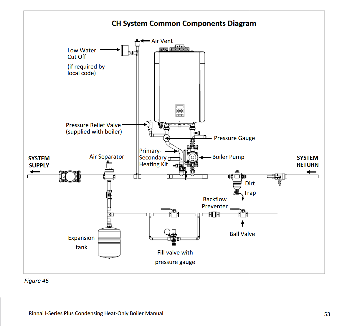

    Does your boiler have a built in pump? Quick google of diagrams show external primary pump.
    mattmia2rick in Alaska
    109A_5 Member Posts: 4,346
    edited September 2025

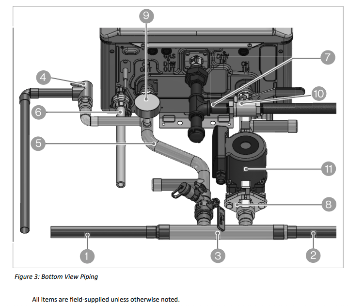

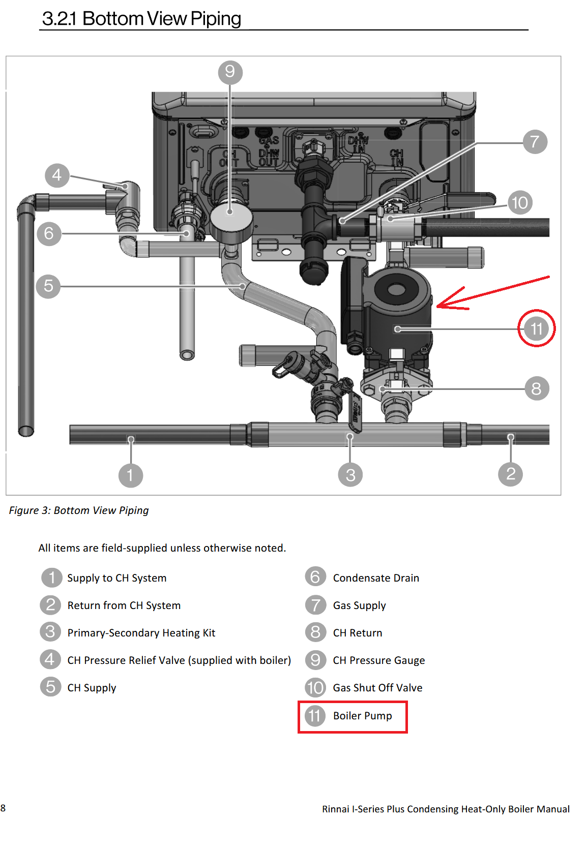

    Well… I believe I am looking at the correct manual. Where is the Boiler pump in your install ? It acts like there is no water flow through the boiler. No boiler pump (circulator) #11 below.

    I don't even see the boiler pump in the photographs? Is it even there?
    hot_rod Member Posts: 28,078
    Yes, you need to supply and install a pump on the boiler loop, as per the installation manual. I don't see an internal pump?
    Check your manual to confirm.

    You guys are correct, there is no boiler pump. I thought the manifold pump can supplement the boiler pump.
    What would be causing all the gurgling in the boiler even after I've purged the air in the boiler loop? I had a 1/2 HP recirc pump running until the auto air vent on the boiler went silent.
    Also, with the boiler water running at 255, (granted for a few seconds) what should I be looking out for, if my boiler is damaged?

    without a boiler pump the water in the boiler may be boiling, so you will continue to get bubbles and gurgling until you get flow though the boiler

    The bubbling and gurgling is almost certainly water in there boiling. Whether anything has been damaged is anybody's guess — hopefully the Rinnai sensors shut everything off before that happened.

    " I thought the manifold pump can supplement the boiler pump. " Supplement maybe in a very very tiny way. Replace, No. You have to move the heat out of the heat exchanger in a very expedient manor not with a parasitic flow path.
    And the heated water probably wants to rise not sink (Gravity heat), but that is not what is happening here with this system design.
    Jamie Hall Member Posts: 27,699
    And that parallel flow path mentioned is very short and direct vs. the water having to go through the heat exchanger. Never happen…
