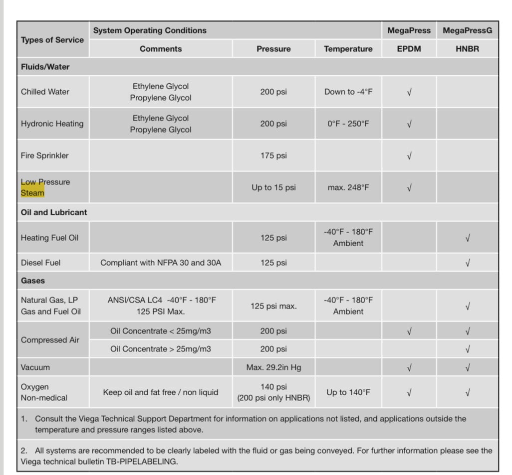

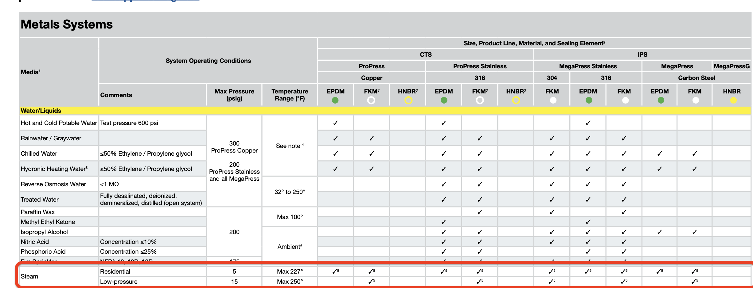

I was talking with a contractor installing one of the boilers I sold and asked if he was going to use Megapress He said he would on the large fittings but not on the smaller ones. I thought it was the cost but he said the small fittings are only rated for only 5 psi. Is that true? Are the small fittings only rated for 5 psi
Boiler Lessons
Negative. 15 PSI. See attached.

Bot PP and Mega Press are approved for low pressure steam up to 15 psi.
I've used 3" mega press for a few repairs on a main. With this job it was the best option to avoid a major project. You have to specify the right fittings and ensure the pipe is supported correctly. It has its place, just not fond of using it for every fitting during a changeout. 2 1/2 and 3" mega press flanges and couplings have saved the day on a few jobs to make the transition to near boiler piping where threading in place would not be practical or increase the cost for the customer by a decent amount.
2 -
You need to make sure you pick the right fitting for the correct application, i.e sealing element, pressure, max temperature.

Agreed on trying to avoid them. I've always used the white dot FKM seal fittings on residential systems. On the handful that I've put in haven't had any issues and the oldest is 4 or 5 years in service. It has its place, but I'd rather cut and thread pipe on steam.
