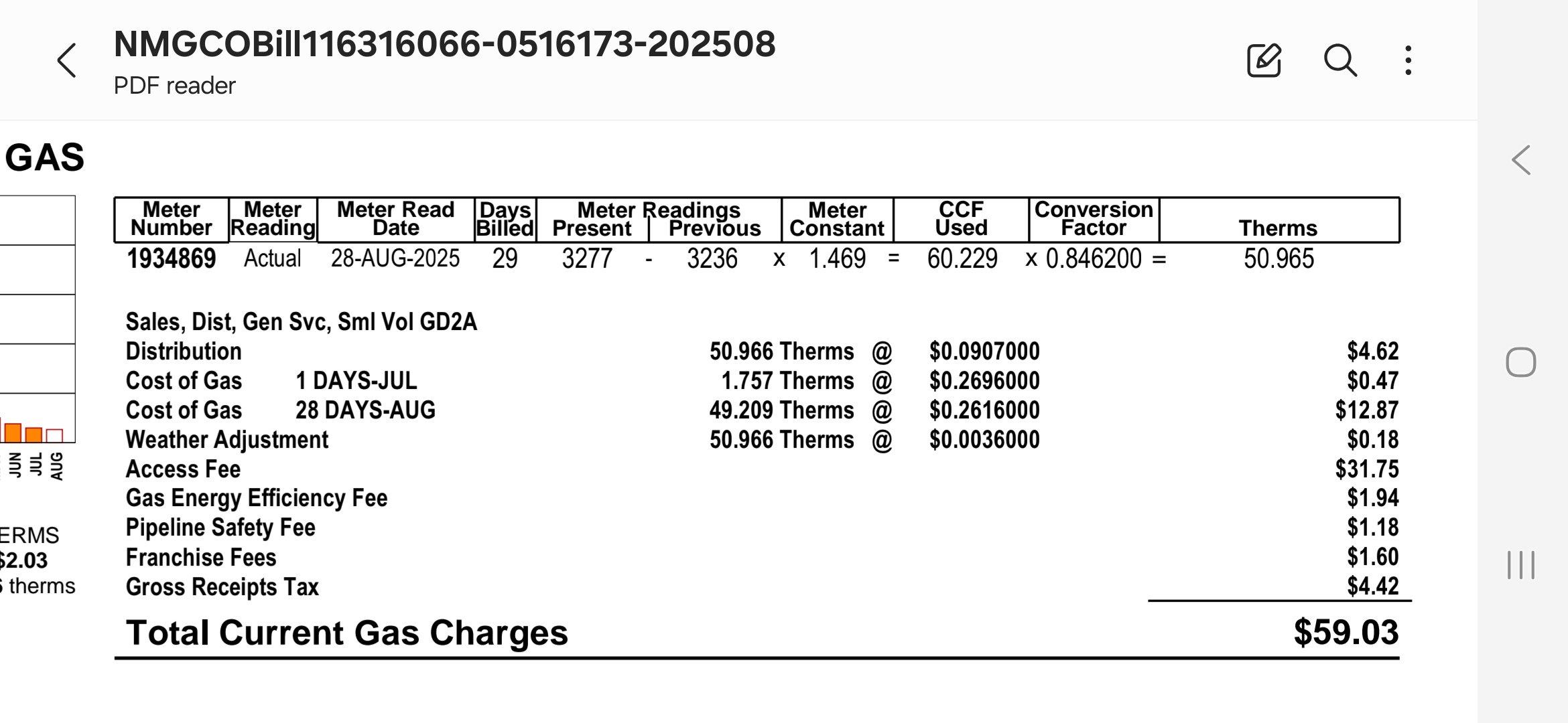

  • Fixed: $15.85
    Variable: $1.72/therm.
