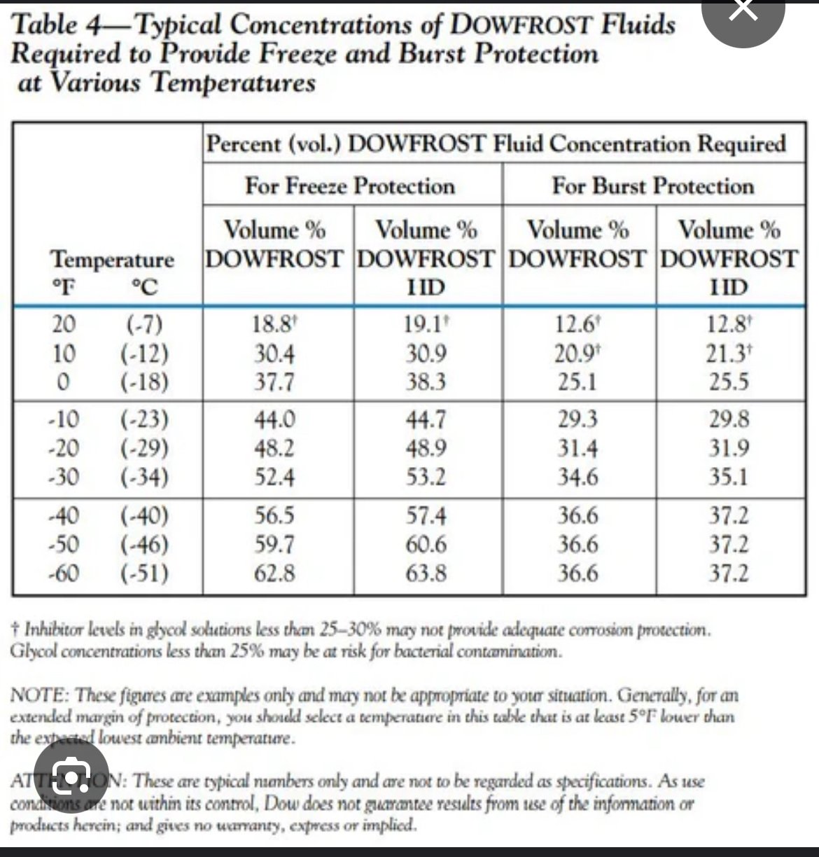

    there are 3 temperatures to know with glycol
    Freeze point, ice crystals start to form
    Slush point, no longer able to be circulated
    Burst point, fluid turns solid , may cause pipes to burst
    DowFrost HD has a burst of -30 at a 35% blend
    It is uncommon to need a 50%
    Temperature protection varies a bit from brand to brand, sone brands show 3 temperature others just two
    Here is Dowfrost and Dowfrost HD

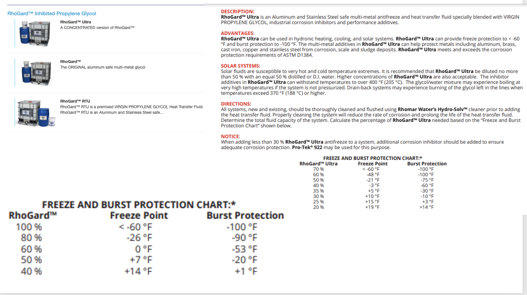

    The Rhogard is only 30% as-is and the Sentinel doesn't seem to show anywhere what its concentration is, but by the burst temp I would guess around 40%. The only way to do this properly is to get your hands on a refractometer and make adjustments as necessary, but you almost certainly don't have enough to keep the total concentration above 25% where it needs to be. With that said, why do you want glycol at all? If this space is occupied, it's not going to freeze and there is no reason to mess with glycol.

    You need to know exactly what fluid brand and model you have to get accurate information.
    Comparing RhoGuard to RhoGuard ultra at 40% the freeze point is quite different. The Ultra should be pump-able well below 0°F
    Rhomar doesn't show a slush point, that is the temperature where is no longer flows via a circ.
    I used the RhoGuard Ultra as it was a multi metal product
    When you blend on the jobsite the final % is often lower as you tend to s add straight water as it purges air out. Best to check with a refractometer a day or so later after it blends well and deareates
