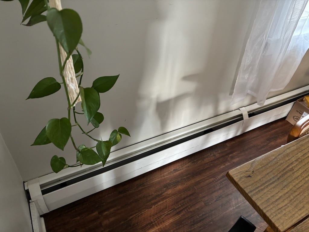

Look at Slantfin Revital/Line. I put it in my house. Slick, easy, strong.

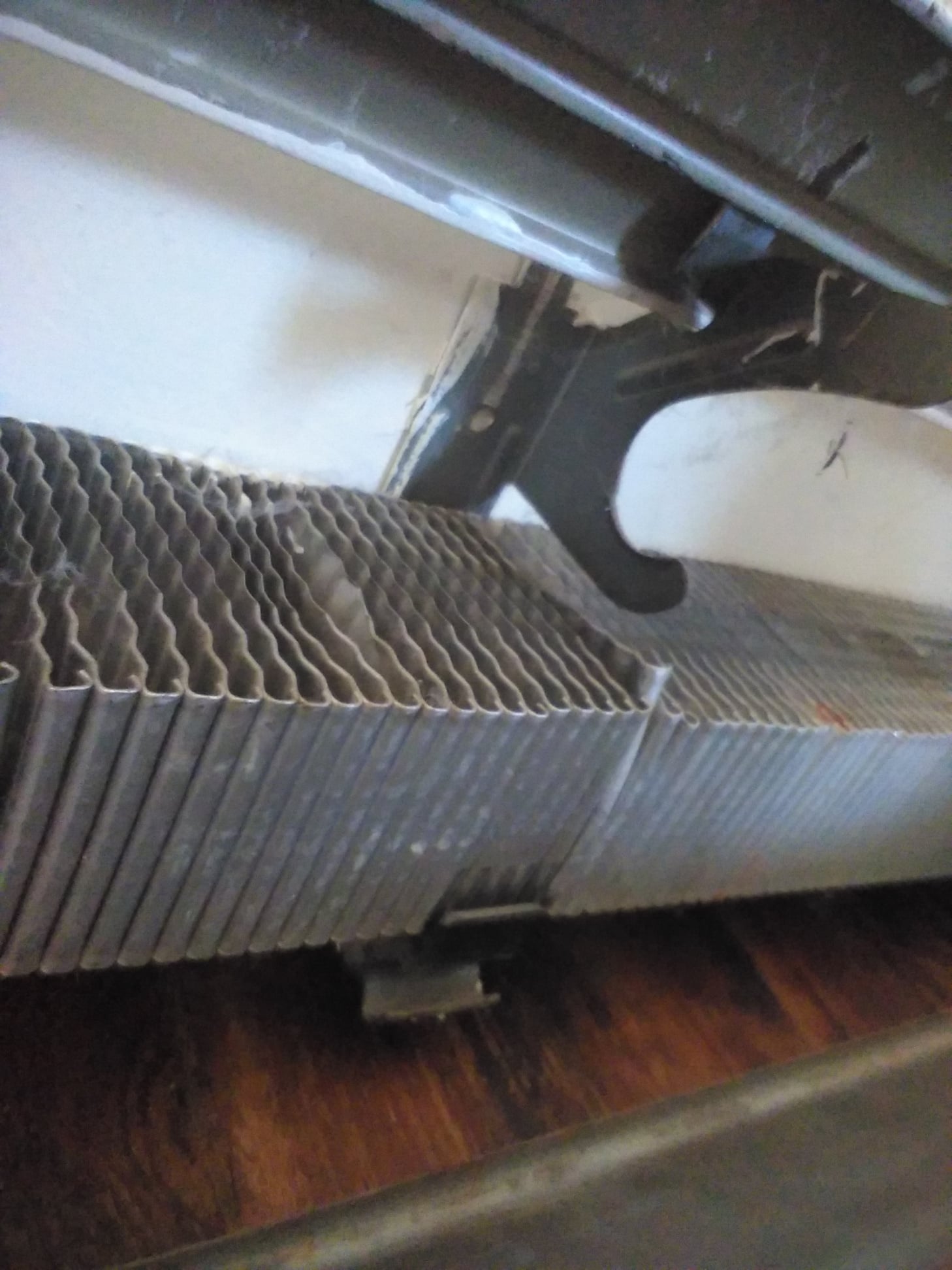

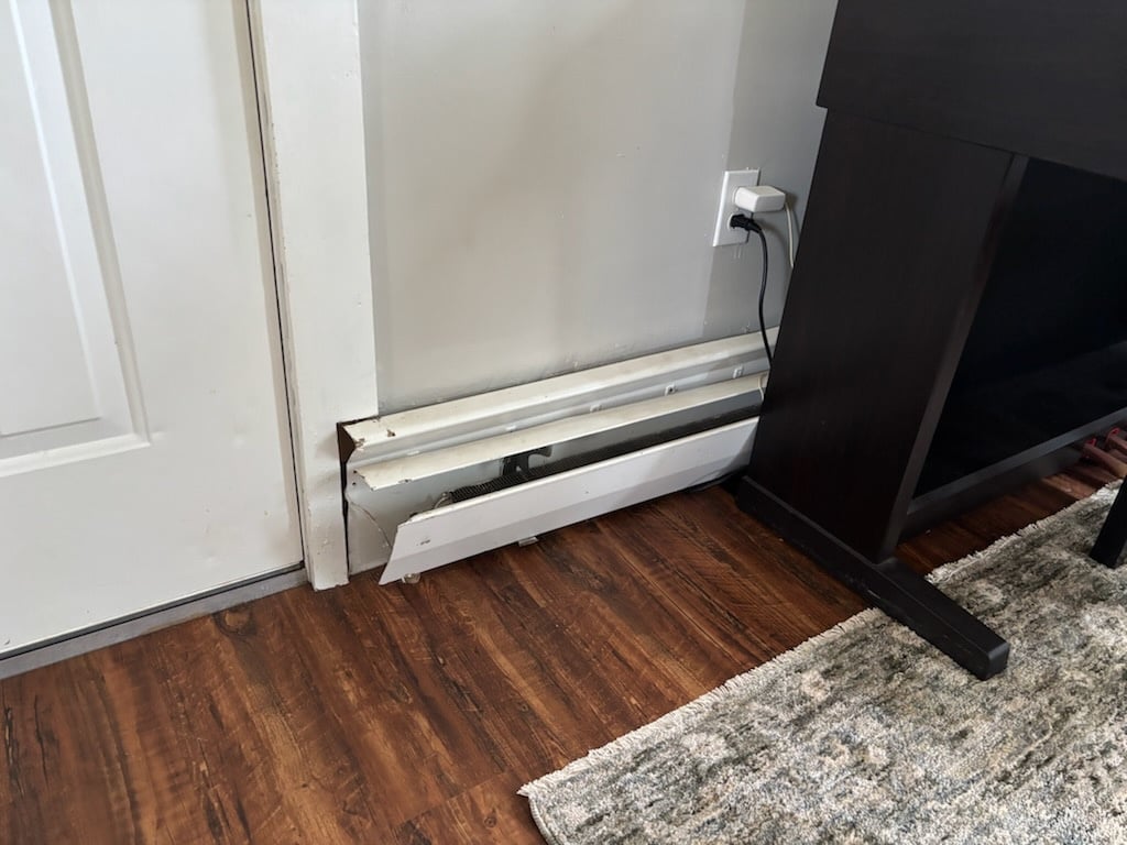

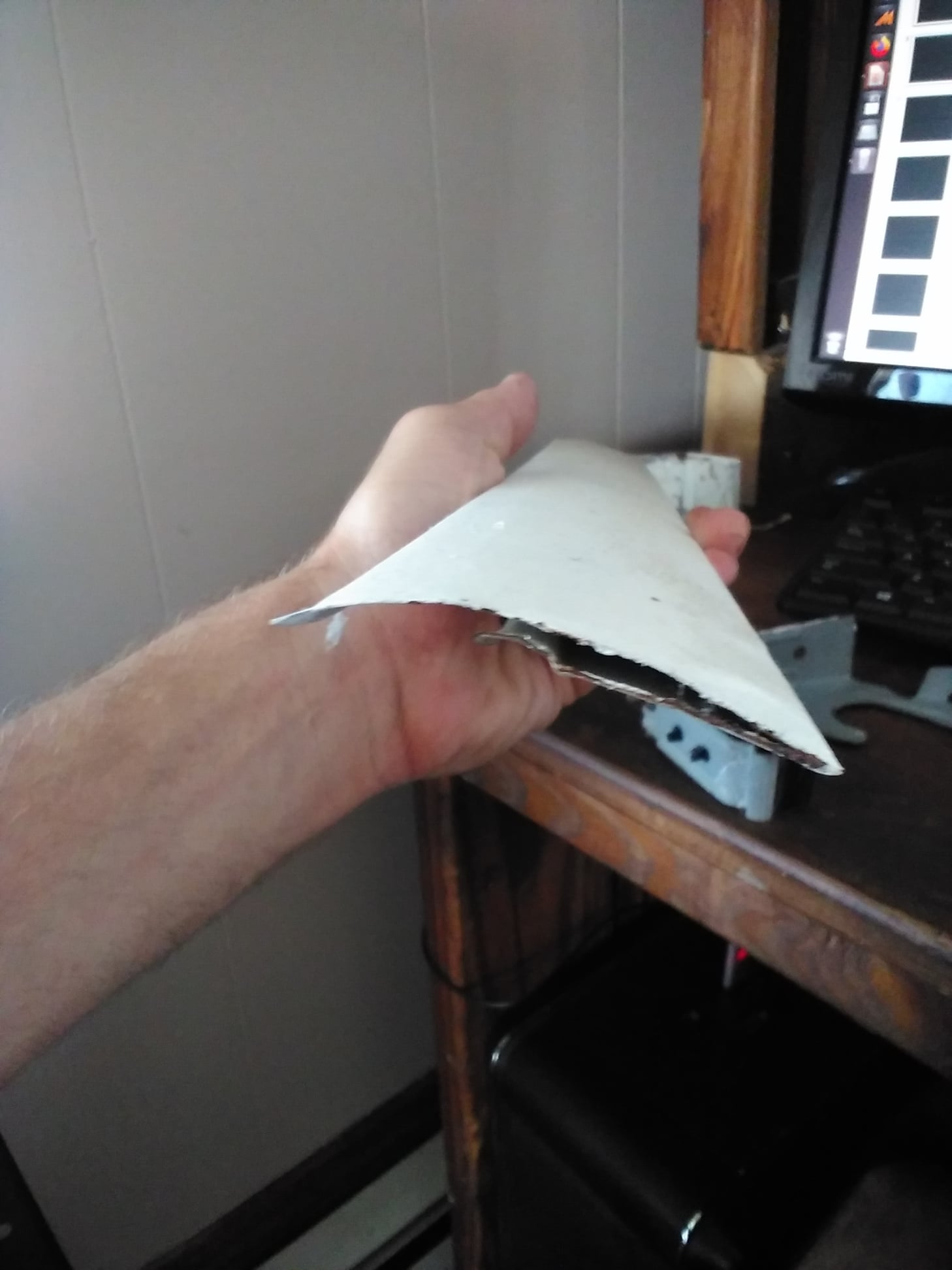

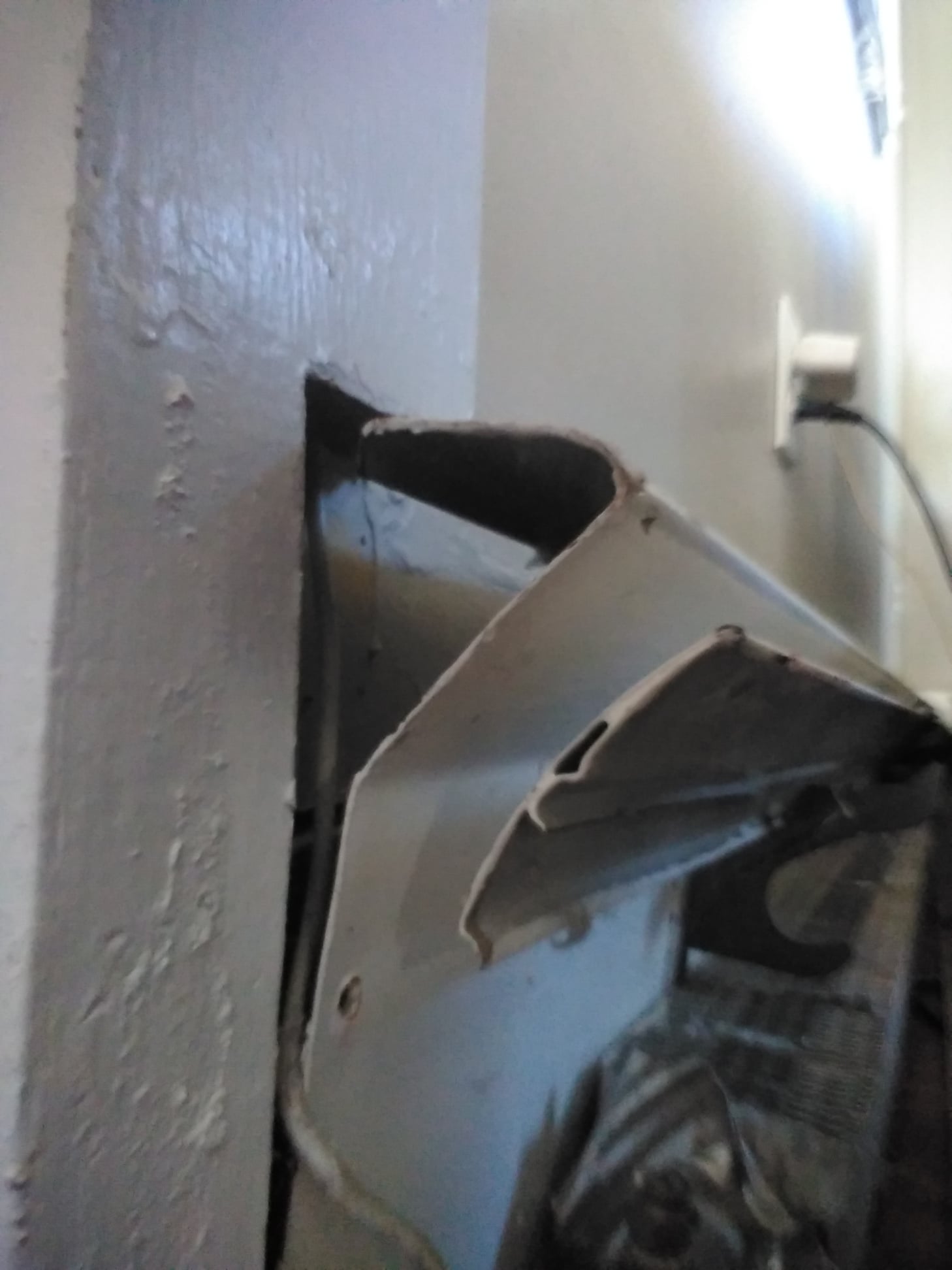

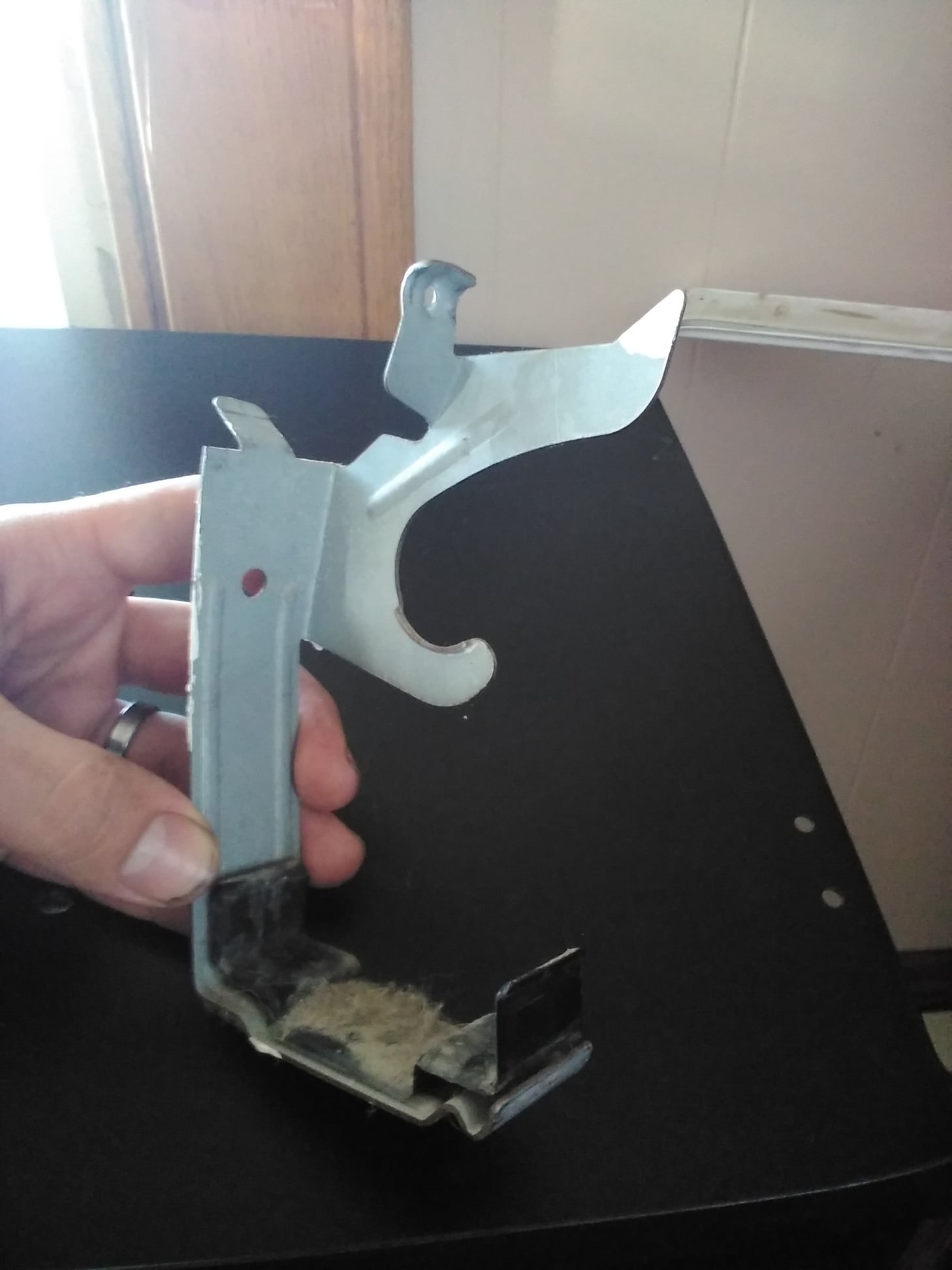

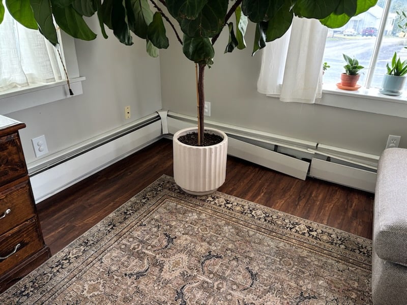

Here's some pictures, it's for a friend so it took me some time to get them.

Kind of looks like Sterling to me. Sterling is owned by Mestek you can Google them

Stearling, I have replaced all the parts except the actual fin tube. Don't know about other brands. There are other enclosures you can buy and use the existing elements. Smith I think is one and there is another one I can't remember the name of "baseboarders" is one
Not Sterling Kompak.
I am 100% sure that is old Argo Lo-trim.
