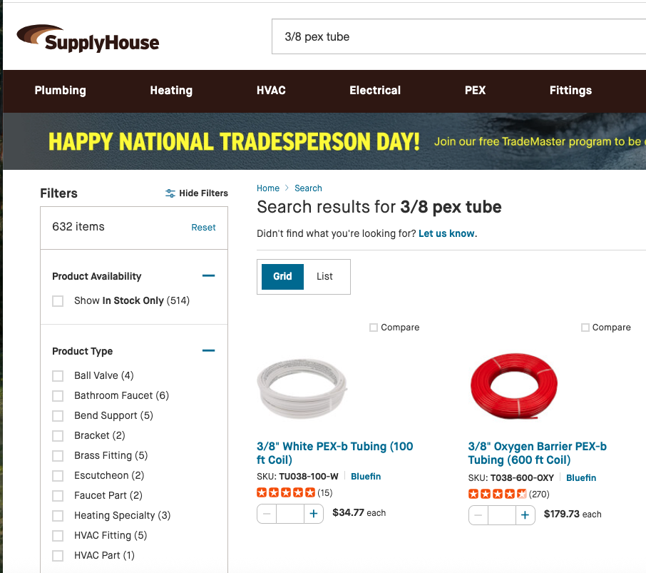

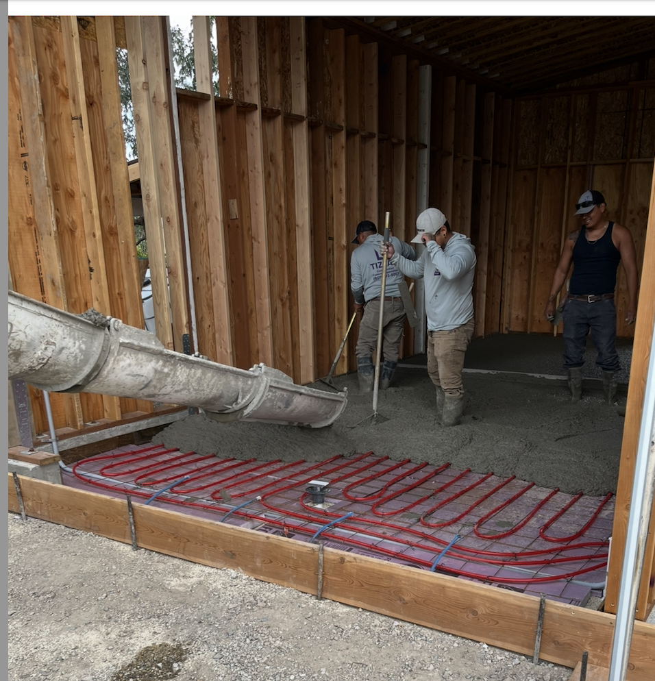

    I'm doing a shop addition and was going to run 3/8, 4" on center to be kinder for the A2WHP, lowest possible SWT. But 3/8 barrier tube is not a commonly stocked item around here. I went with 1/2. 6" OC

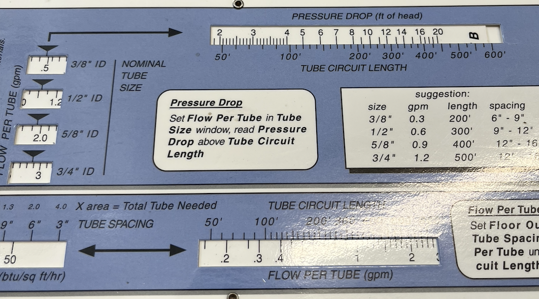

    .5 gpm in a 150' loop of 3/8 = 6' head, on the RadPad

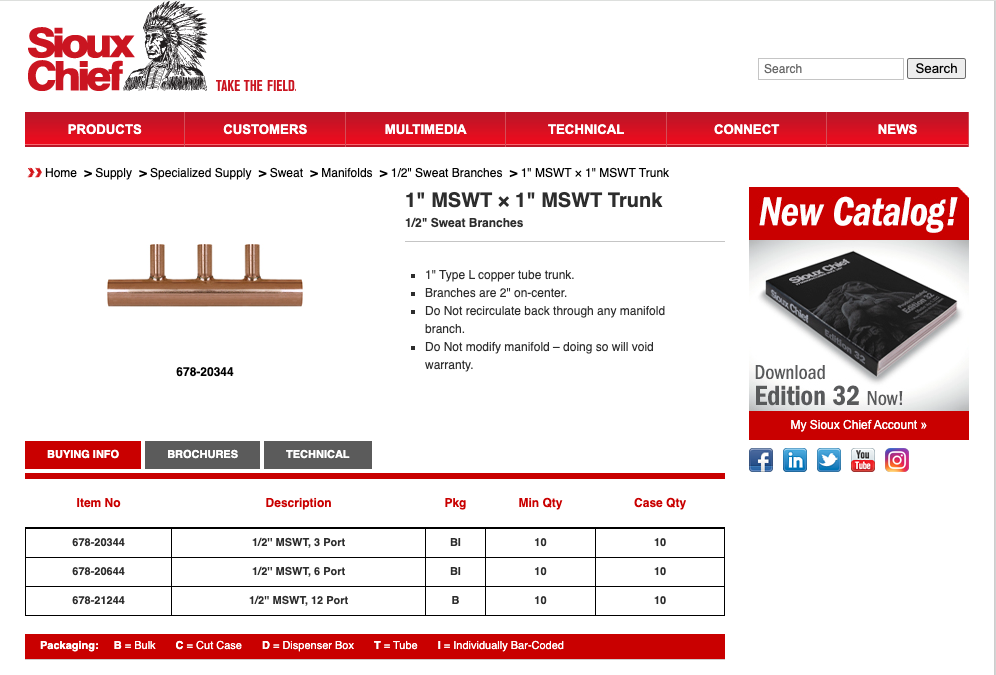

    You can still get manifolds with 1/2" sweat stubs, add your own pex adapter.

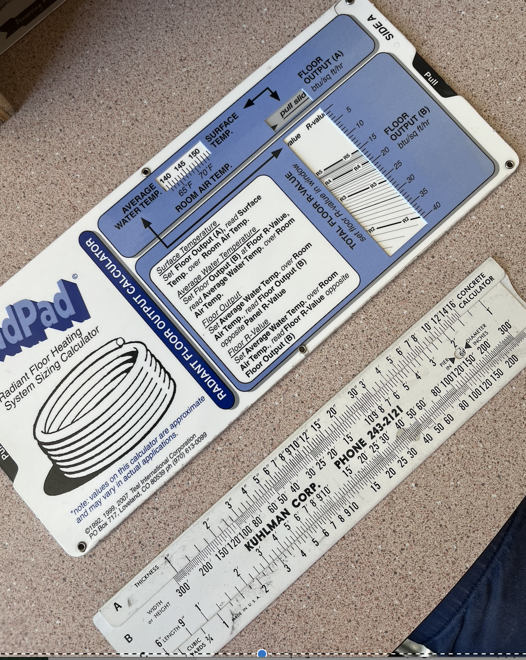

    Two slide rules that I still use. I find them as fast as opening a software or app.
    The Rad Pad developed by Larry Drake. 1992!!
    A concrete calculator.
    I do have an extra RadPad somewhere if @archibald tuttle wants it

    I'll bet SH could have 3/8 barrier pex at your door step in a day or so. I've used 3/8 in shower walls and concrete counter tops for tight spacing
