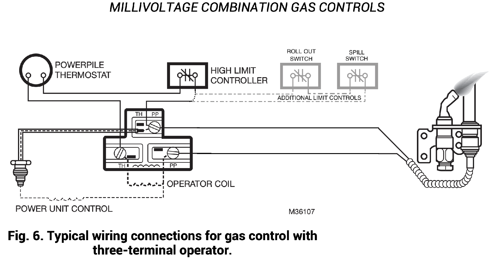

Hello-I have an older gas floor heater that quit, I believe it must be faulty control box-only because it is the only working part other than the thermostat. Everything else is sheet metal and cast iron! The control box seems to be made up of several parts put together-each has a letter and number stencil on it. Is there anywhere on your sight I could look those up?

    a lot are millivolt and just run off a thermopile. thermopiles wear out after a couple decades and don't produce enough current to open the valve and need to be replaced every once in a while.

  • Chances are that your gas valve is powered by 750 millivolts. That power is generated by the pilot flame burning on the pilot power generator. There are several items that connect the electrical parts to make the millivolts open the gas valve.
    • First there is the power generator sometimes called a power pile.
    • Next there is a Gas Valve that uses that power
    • Then there is the thermostat that opens and closes the electric current based on the room temperature
    • Then there may be a Limit switch or even more limit switches placed in different locations around the furnace in order to keep the furnace from overheating.
    Some of these limit switches may have a manual reset. If you have a manual reset limit, that may be the reason you have no heat. Follow the wires to see if there are any limit switches. See if those switches have a tiny button between the wire connectors and press it. If you feel a slight click when you push it then it was tripped. If you do not feel a slight click then it was not tripped.
    Another reason for no heat is the power generator thermopile may be defective.
    Here is a wiring diagram that might be close to what you have in your floor furnace.
    If you are not comfrotable playing with the safety controls on a gas appliance then i would suggest you call a professional for service. but pushing a reset button on a limit control is usually a DIY first step. If the limit trips again, then you need to find the cause. The safety switches are there to let you know something is wrong and needs further attention. Don't bypass them.
