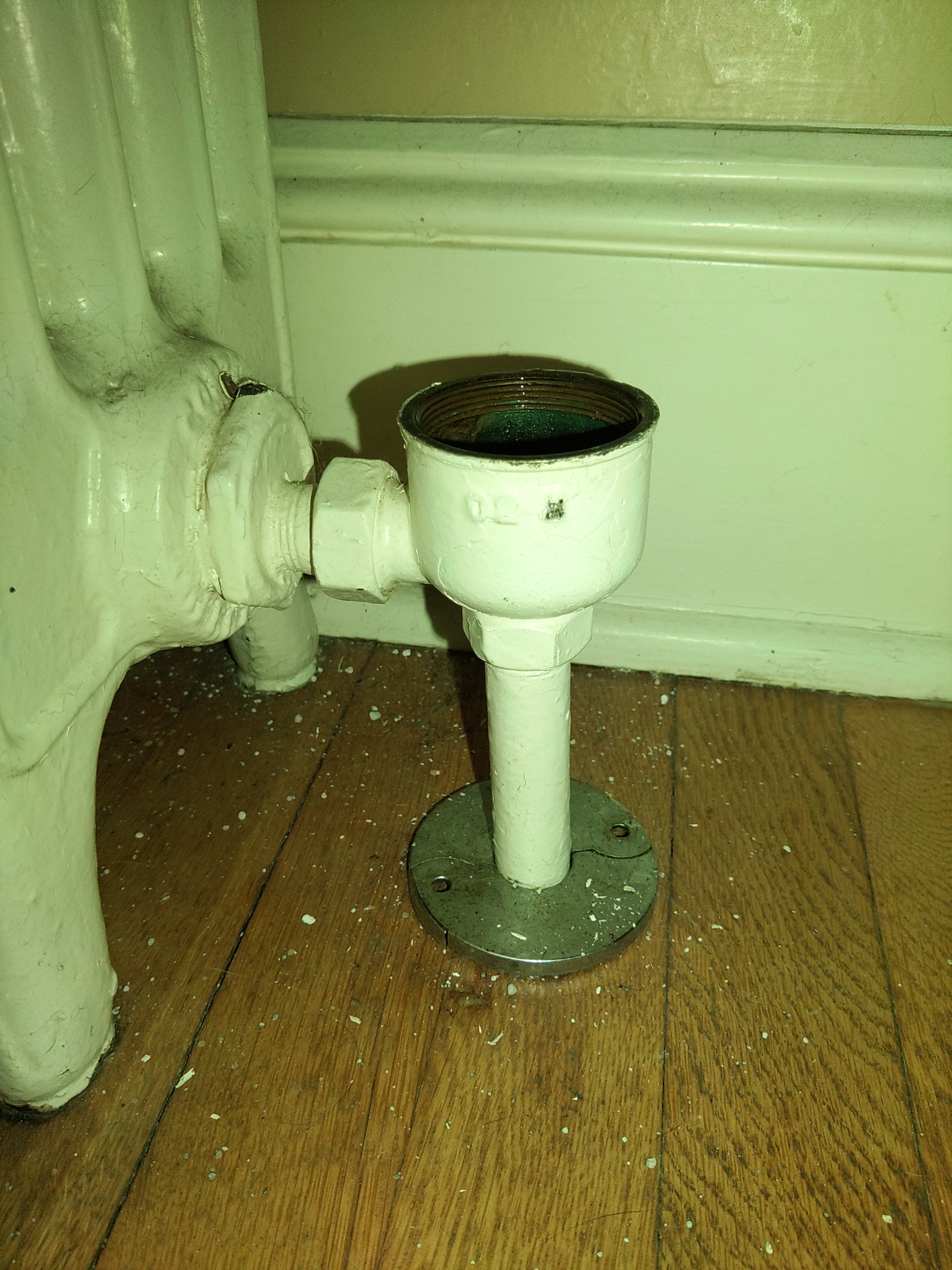

Decided to have a look at the cage units on my radiators. They are all Warren Webster 02H 1/2" with the exception of the attic radiator which is a Barnes & Jones 134 3/4" and for some reason the plant room/sun porch is a Hoffman 17C trap. The radiators all heat very well however the radiator that is in the upstairs guest bathroom gets way too hot it seems like testing with my IR temp gun there is no change in temperature across the trap. I'm suspecting that that cage unit has failed open. However all of the cage units have been in place for at least 29 years since Mom and Dad bought the place so I think I'm going to take and replace all of the Warren Webster 02H trap cage units with fresh Barnes and Jones units including the crossover traps in the basement. Does this sound like a prudent maintenance idea? Also took a picture of the cage unit off of the upstairs guest bathroom and does it look like it's failed open? All the other cage units look the same as well. They all came apart very easily with a little bit of leverage with an 18-in long pipe wrench which is all I have in my arsenal at the moment.

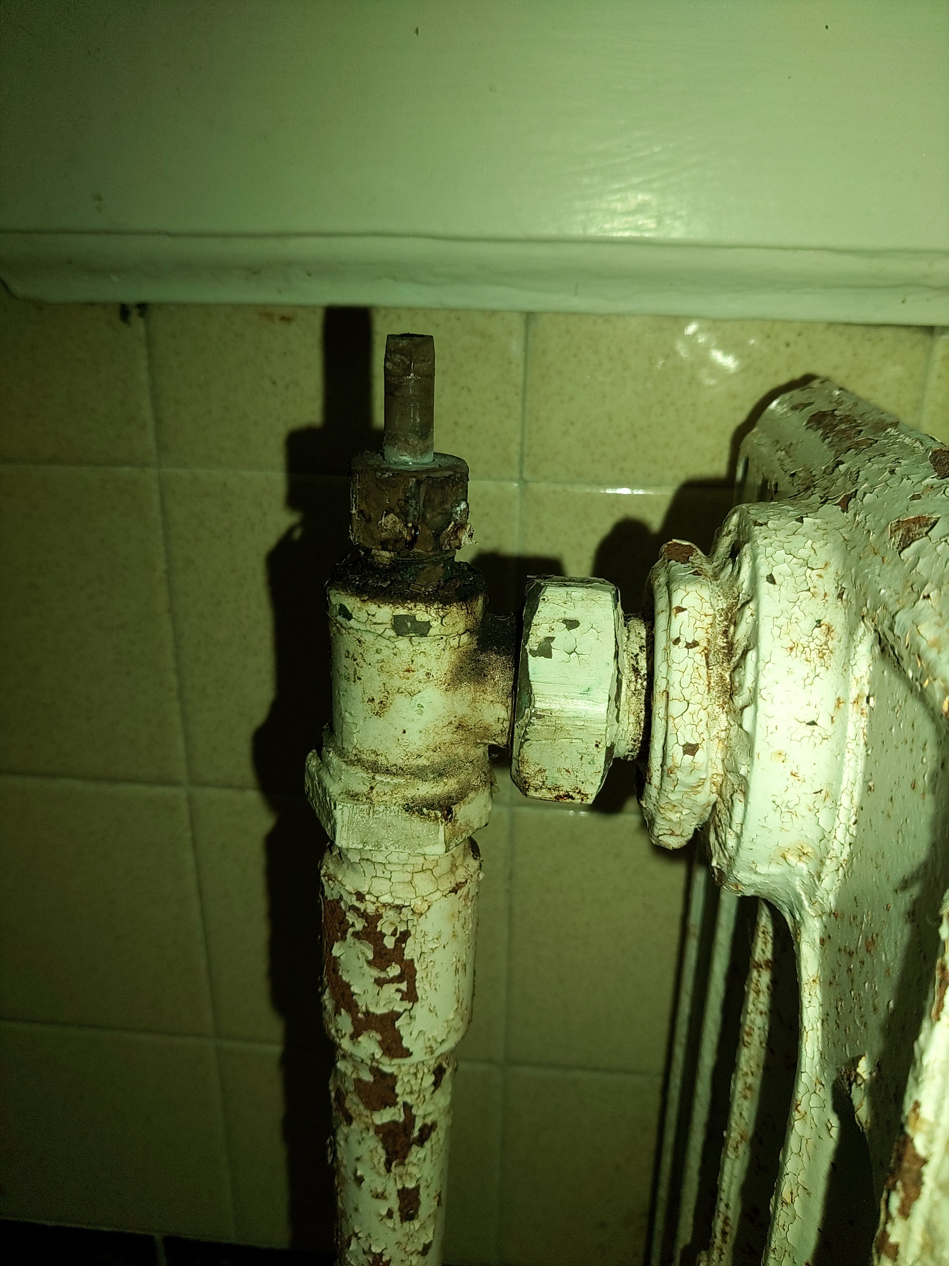

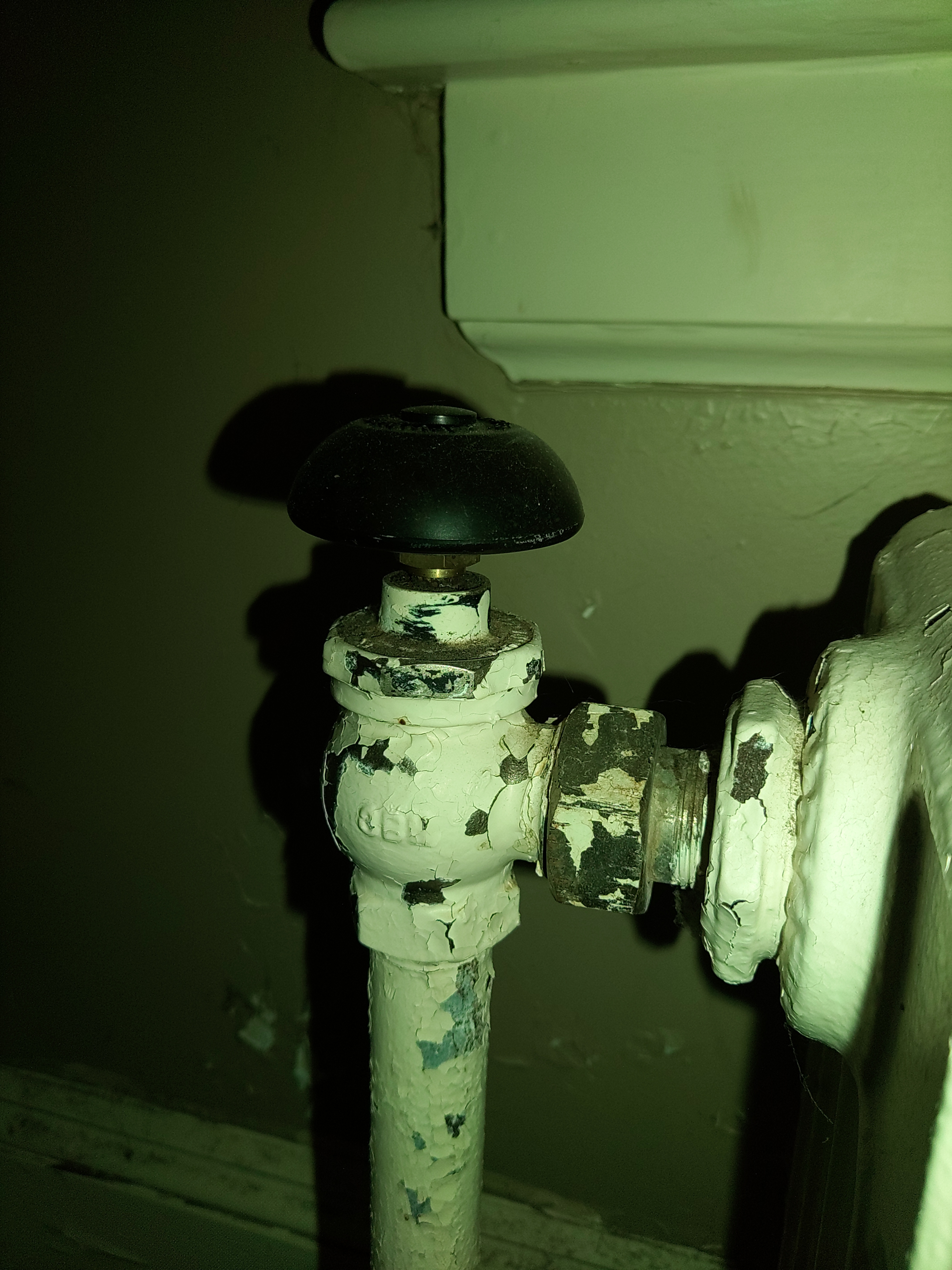

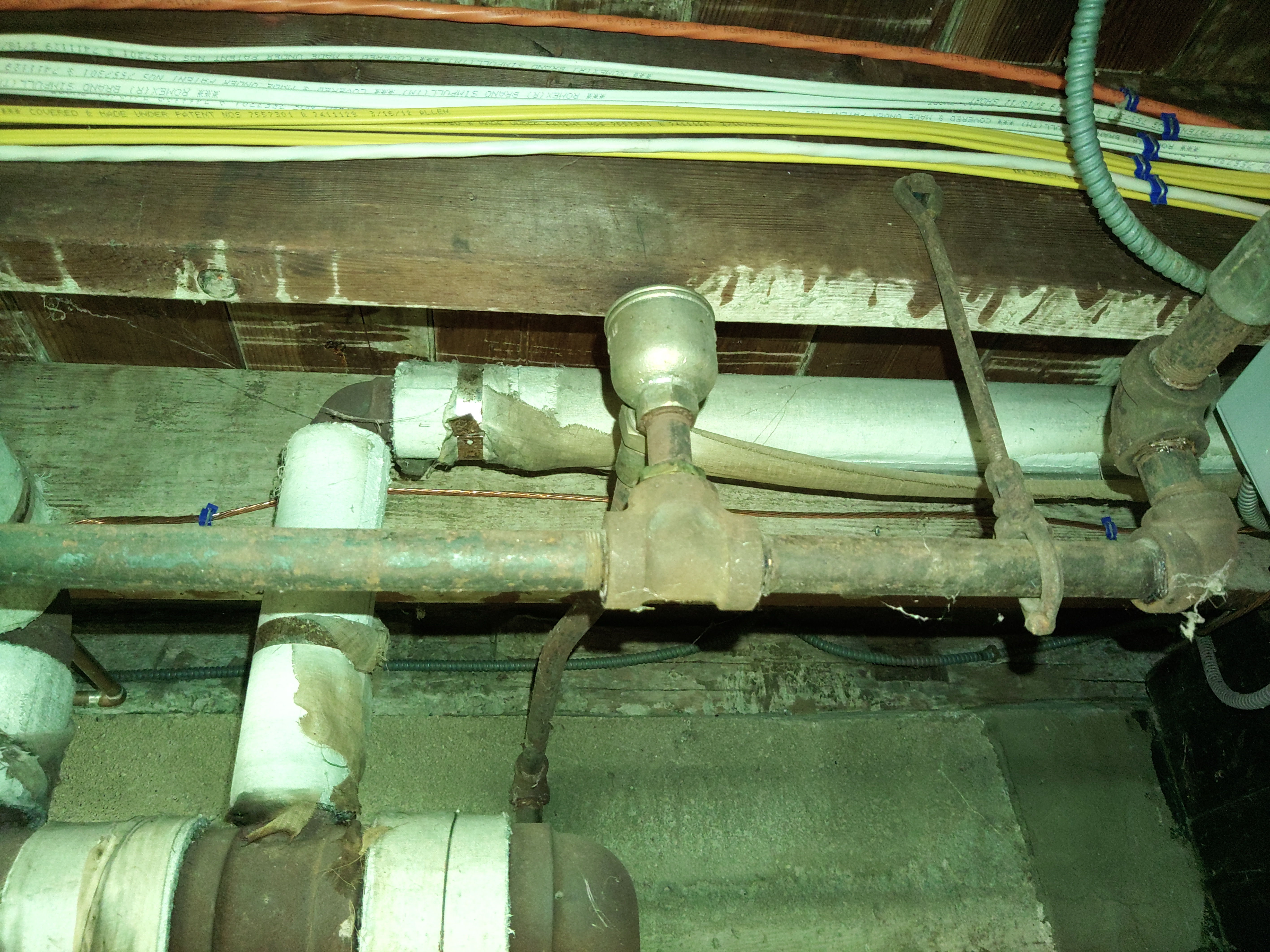

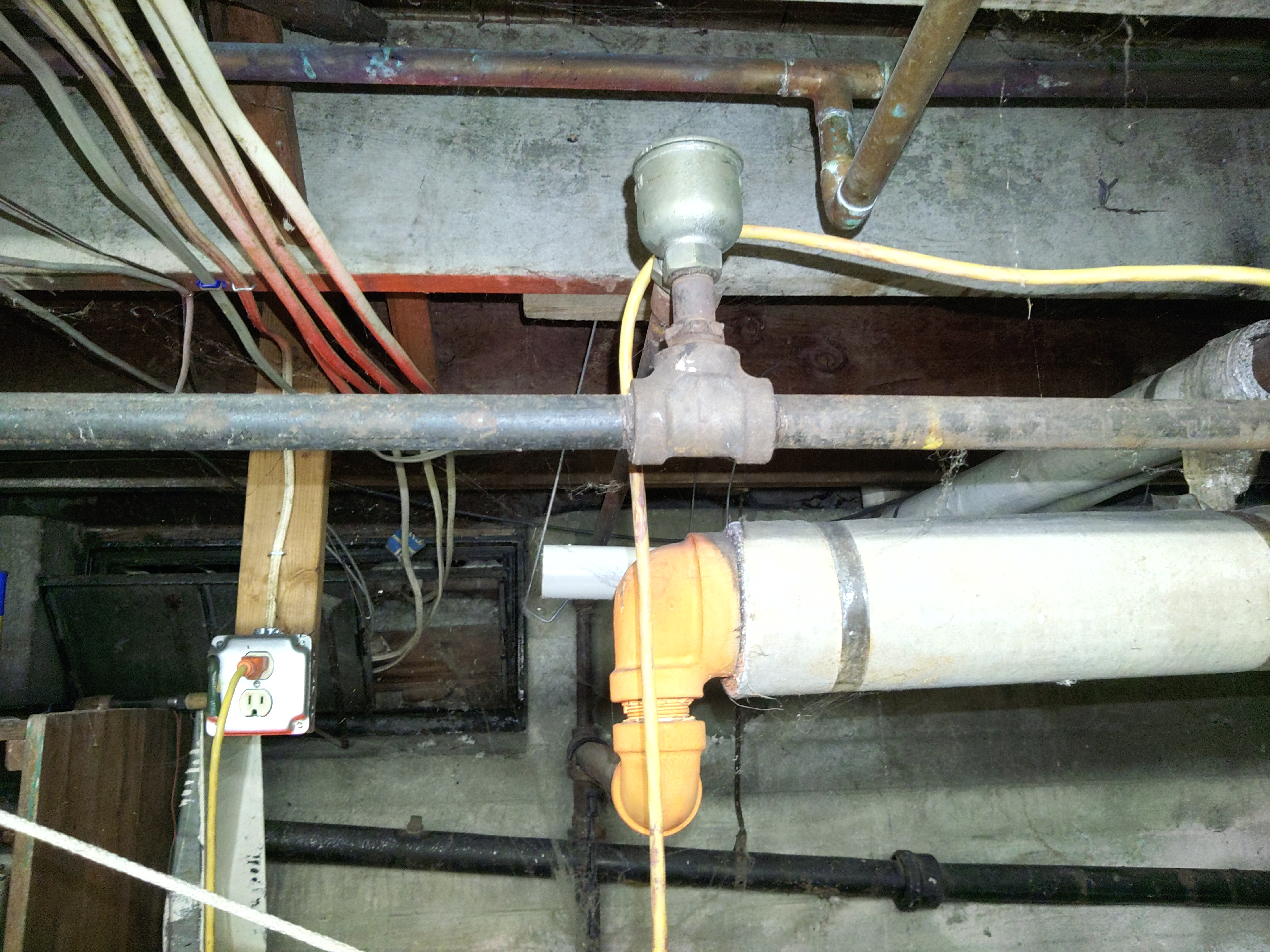

  • Crossover traps on the mains are still in place. The upstairs guest bathroom radiator has a different valve than all of the other radiators as well.
    Crossover traps:
    Upstairs guest bathroom radiator valve
    East facing master bedroom radiator valve, all of the other radiators in the house have the same type of valve.
    29 years they should be changed

    make sure the crossover traps are good. if those are failed open you will get steam in the returns. if they are failed closed the mains won't vent properly.

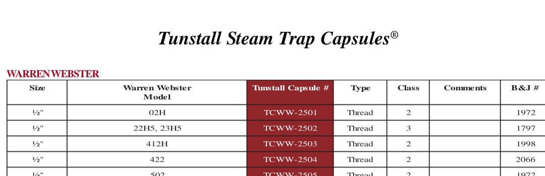

  • So I think I will end up just replacing all of the cage units including the crossovers. I have scoured eBay and I've come across a total of five Barnes and Jones 1972 cage units which is what is specified for the Warren Webster 02H trap. I'll probably do the most important ones first which would be crossovers and bathroom radiator. And I'll just keep an eye over time for them.
    you can buy new cages from barnes and jones or tunstall.
  • Thanks !
  • Looks like I might go the Tunstall route. The capsules are roughly $60 a piece from supplyhouse.com. and I need 12 to do all of the radiators that are in use plus the crossovers. The Barnes & Jones cage units are back ordered from supplyhouse.com and they are more expensive.
    you should call or e-mail tunstall and make sure you have the right part and that you don't need to change the cover or something for it to fit.

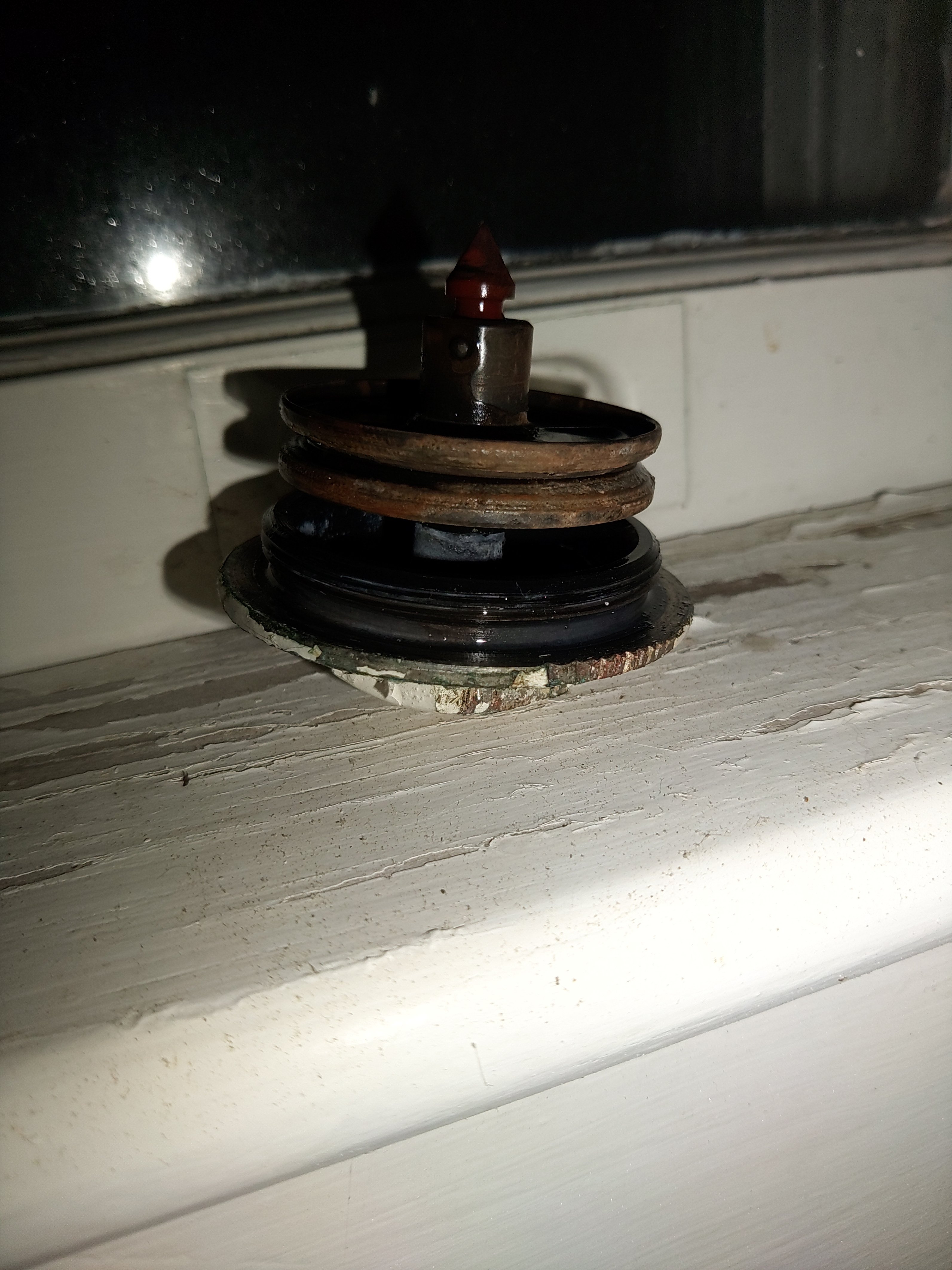

    If boiling water is enough heat that they should expand, I'd build a test fixture (to limit the expansion) out of some aluminum angle stock and some long machine screws or all thread and test them. Holes would be drilled in the aluminum angle stock to keep the capsule captive and the long machine screws or all thread makes it adjustable for the expansion gap and for various size capsules.
  • I was able to find the correct capsule right from Tunstalls website.

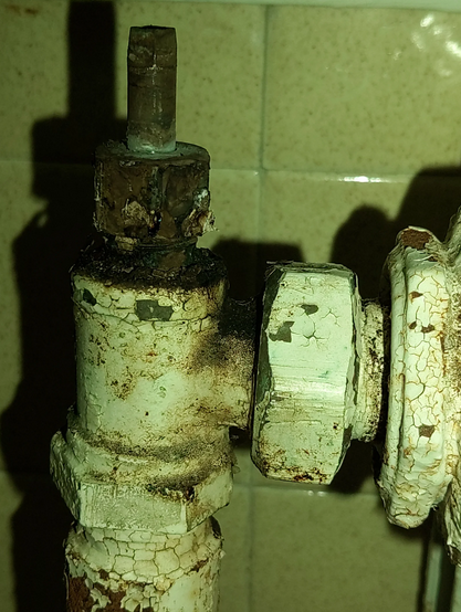

    It appears all the valves with the exception of the one in the upstairs guest bathroom are original. The only one that's different is that bathroom radiator. That radiator gets in my opinion way too hot and checking the return when the system is running the return is hot. I'll pull that cap off tomorrow when I get the appropriate size socket from work and test that particular cage unit. I tested the one that's in the dining room just in some boiling water and it appears to work. I'll bring that cap with me to work tomorrow so I can get the correct size and then I'll stop at hobo freight on my way home and just grab a cheapie impact socket. It appears to be a 1-1/4" hex. The biggest wrench I have in my shop is 1-1/8"
    Photo of upstairs guest bathroom radiator valve :
    The rest of the radiators have valves like this and looking in The Lost Art of Steam Heating Companion those are in fact Warren Webster valves.
  • I think I've done an EDR calculation and the boiler is sized appropriately. Pressuretrol is set to cycle between 2 to 3 PSI. Cut in is set at 2 and I looked at the diff and it's set to 1. In a few weeks I'm actually doing some boiler maintenance so I may end up adding a low pressure gauge into the pigtail if that's an appropriate spot to do so

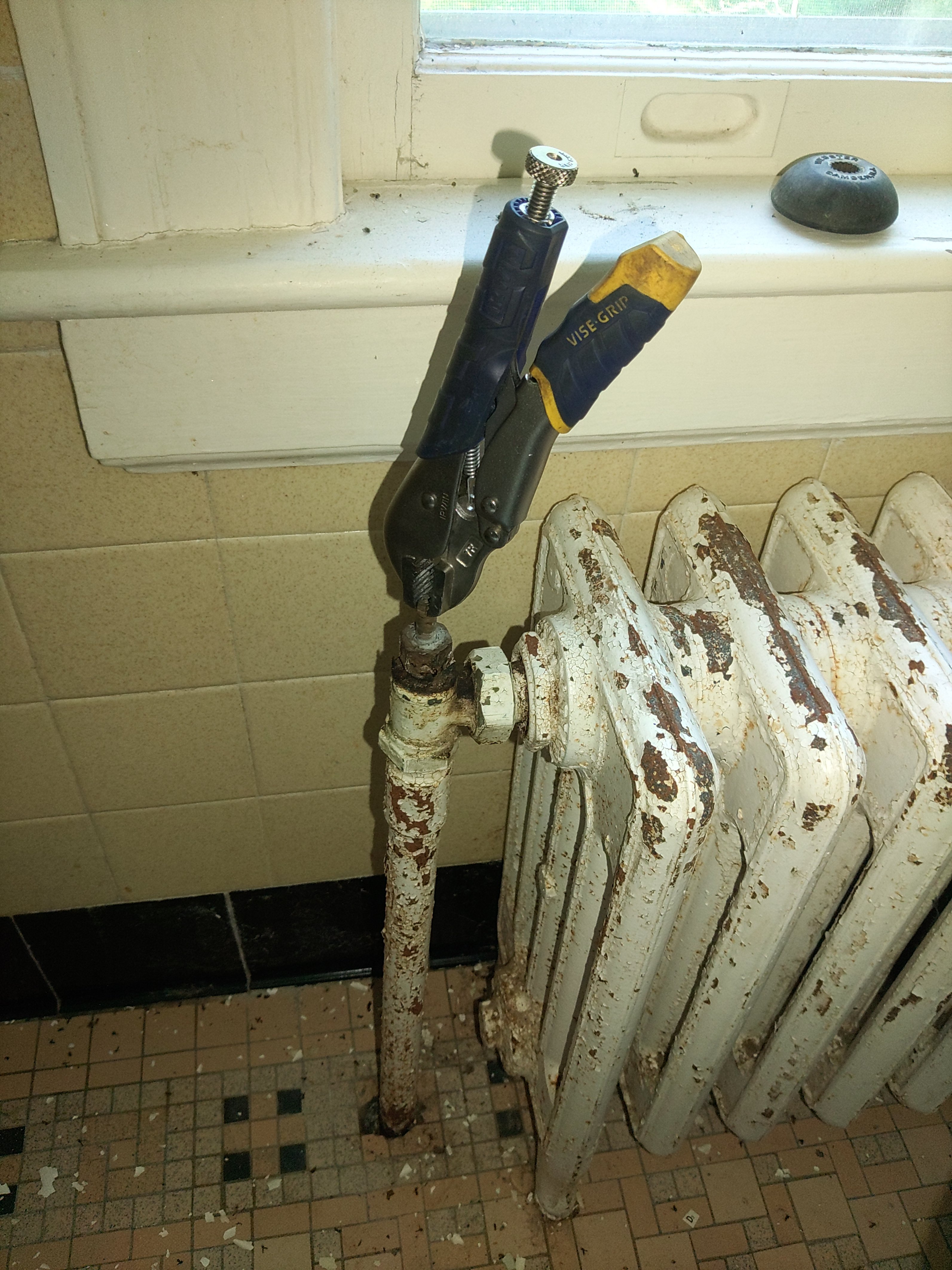

    you can close the valve on the radiator with the non-vapor valve most of the way to make it heat less. you can throttle radiators with the valve on 2 pipe steam.

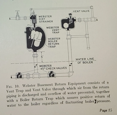

    I don't know if i linked this before, but this is one of the warren webster catalogs

    " That radiator gets in my opinion way too hot and checking the return when the system is running the return is hot. I'll pull that cap off tomorrow when I get the appropriate size socket from work and test that particular cage unit. "
    This type of trap just prevents steam from getting into the return so air is not trapped where it should not be, it is not to control the amount of heat the radiator dissipates.
    With this valve, maybe the orifice is missing and all the other original valves have them.

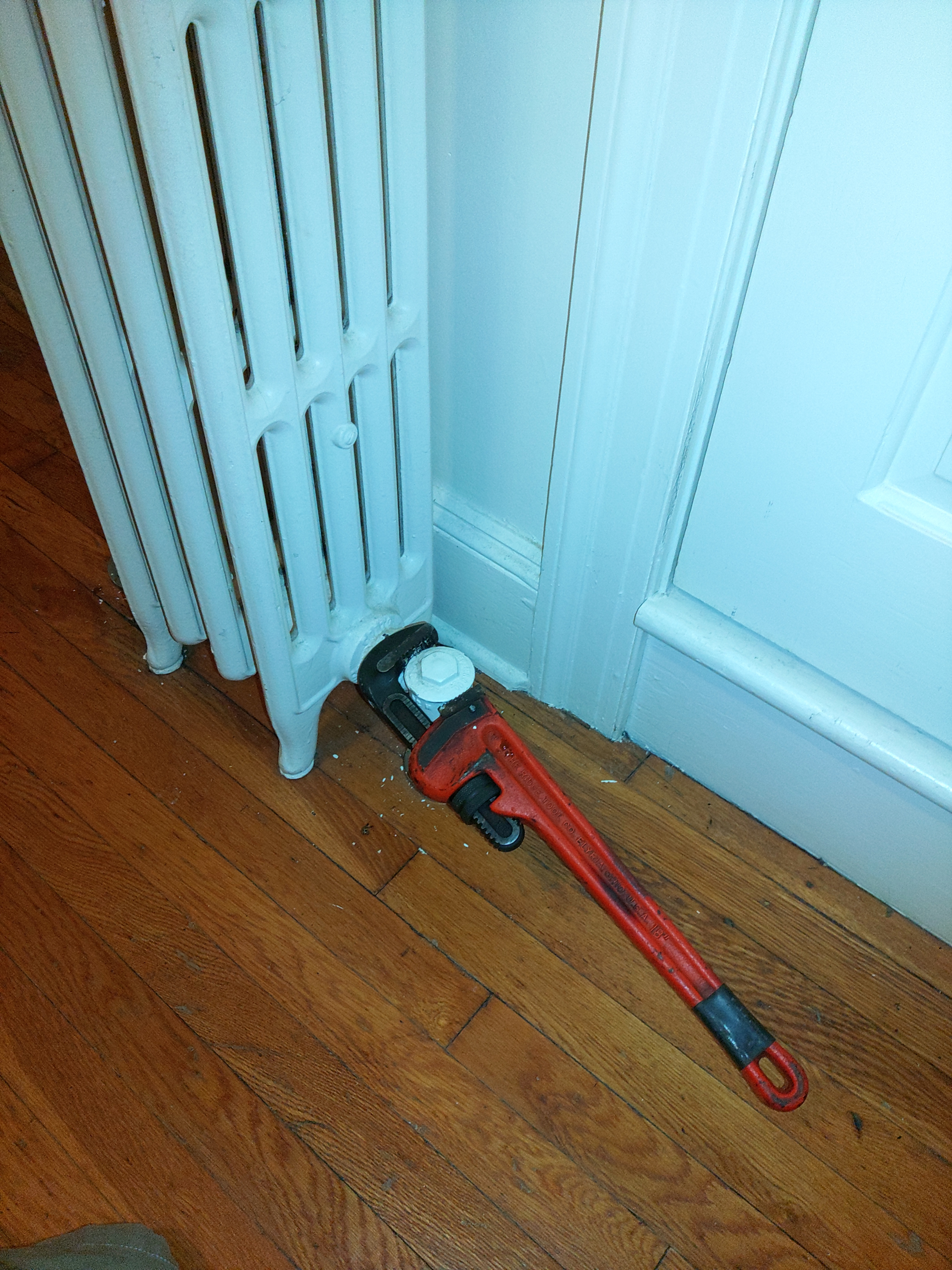

  • I'm gonna try shutting that valve off. I have that bathroom closed off now anyways as it needs to be basically blown up and redone in terms of painting some tile repair etc
  • WilliamGwiazdowski
    WilliamGwiazdowski Posts: 168
    edited September 2025
    Valve does turn, I just put a pair of locking pliers on the square end of the valve stem and shut it. From closed to open it is 1/2 turn. When we get into heating season I will see if the valve actually works.

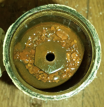

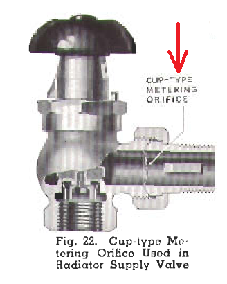

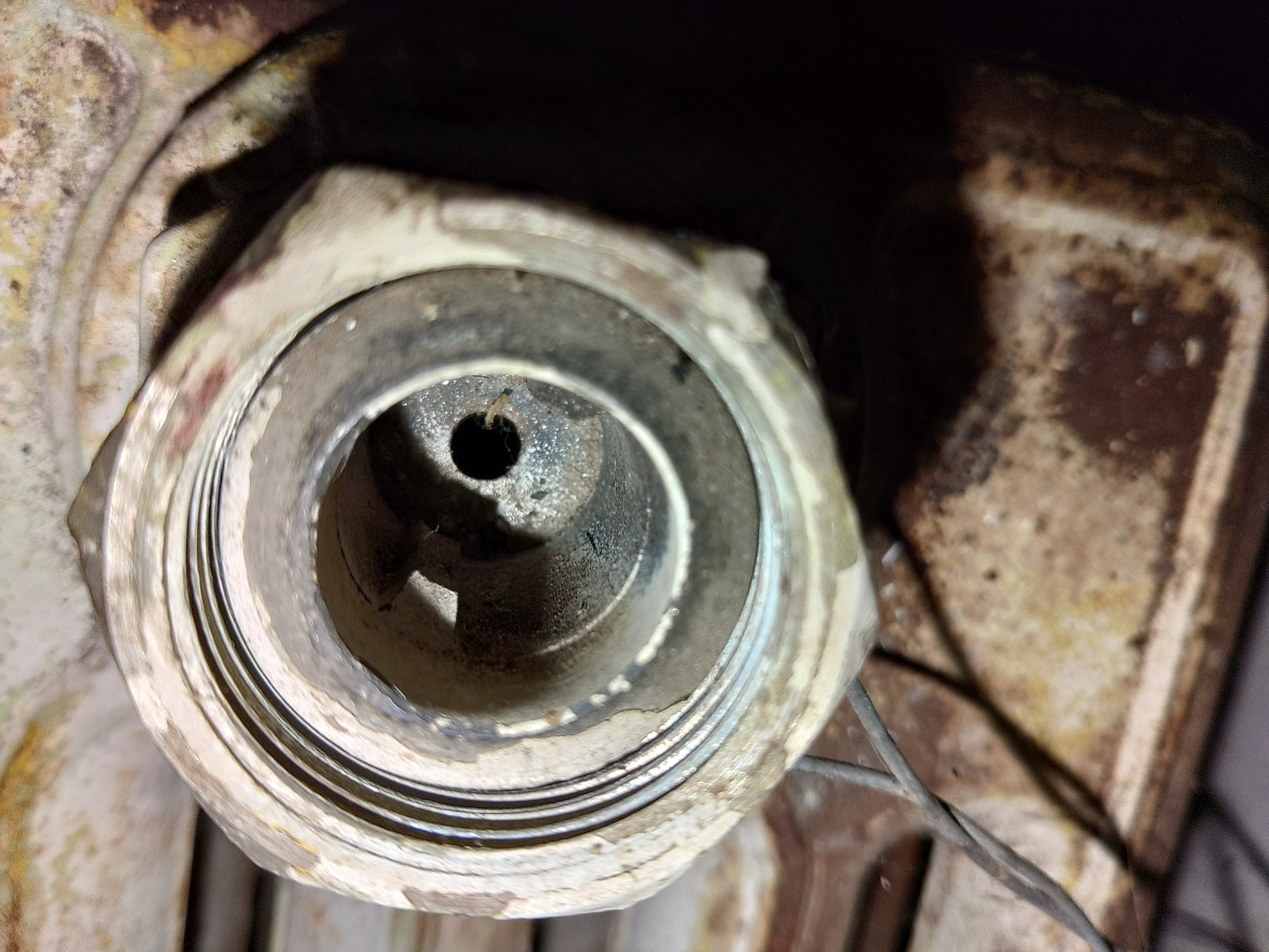

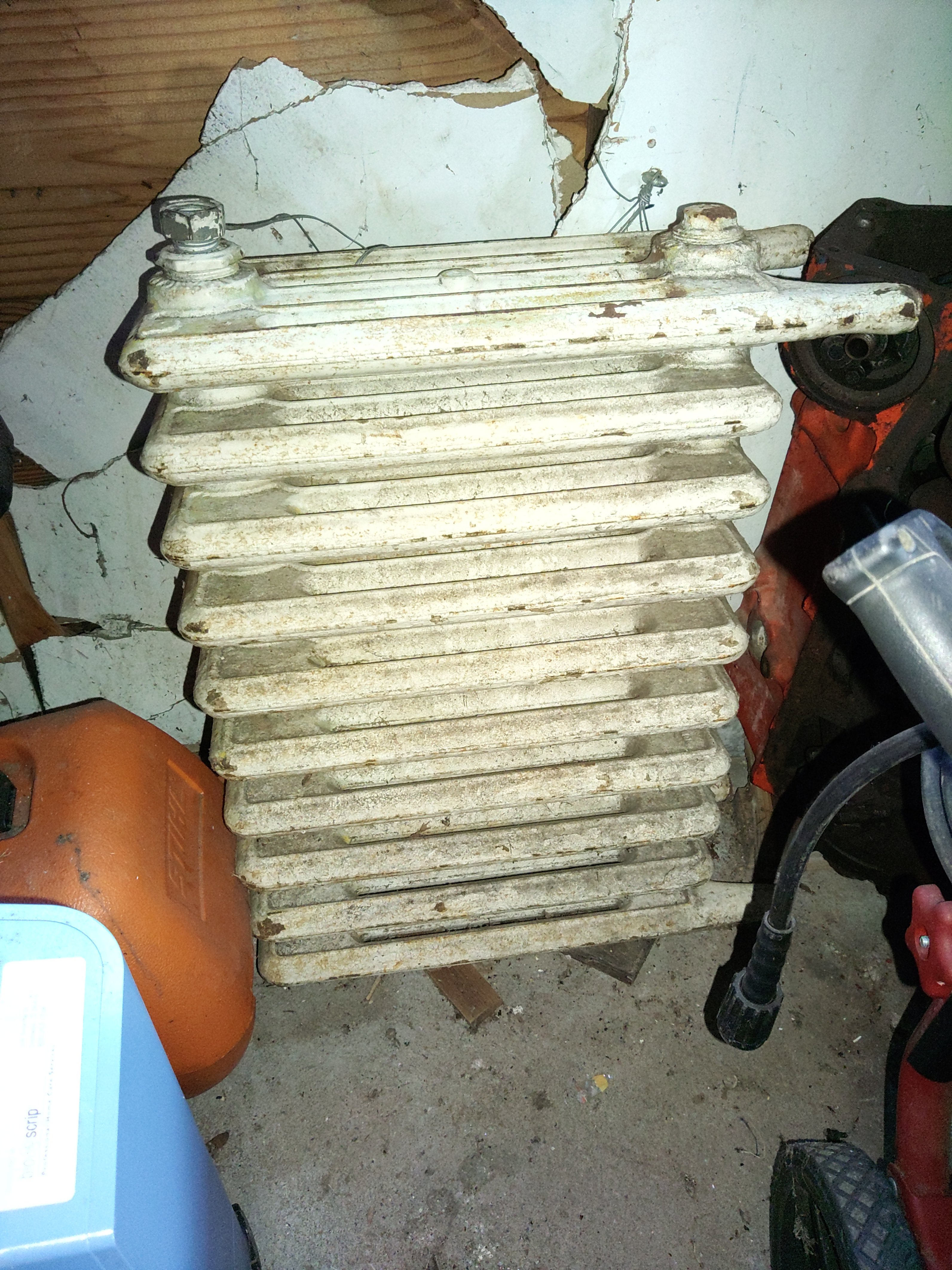

  • This afternoon I was putting up some new blinds in the garage and I found a radiator that used to be in the living room where the window seat is now and when I looked in the inlet spud I found what I believe is a restrictor orifice. Maybe somebody can confirm this?

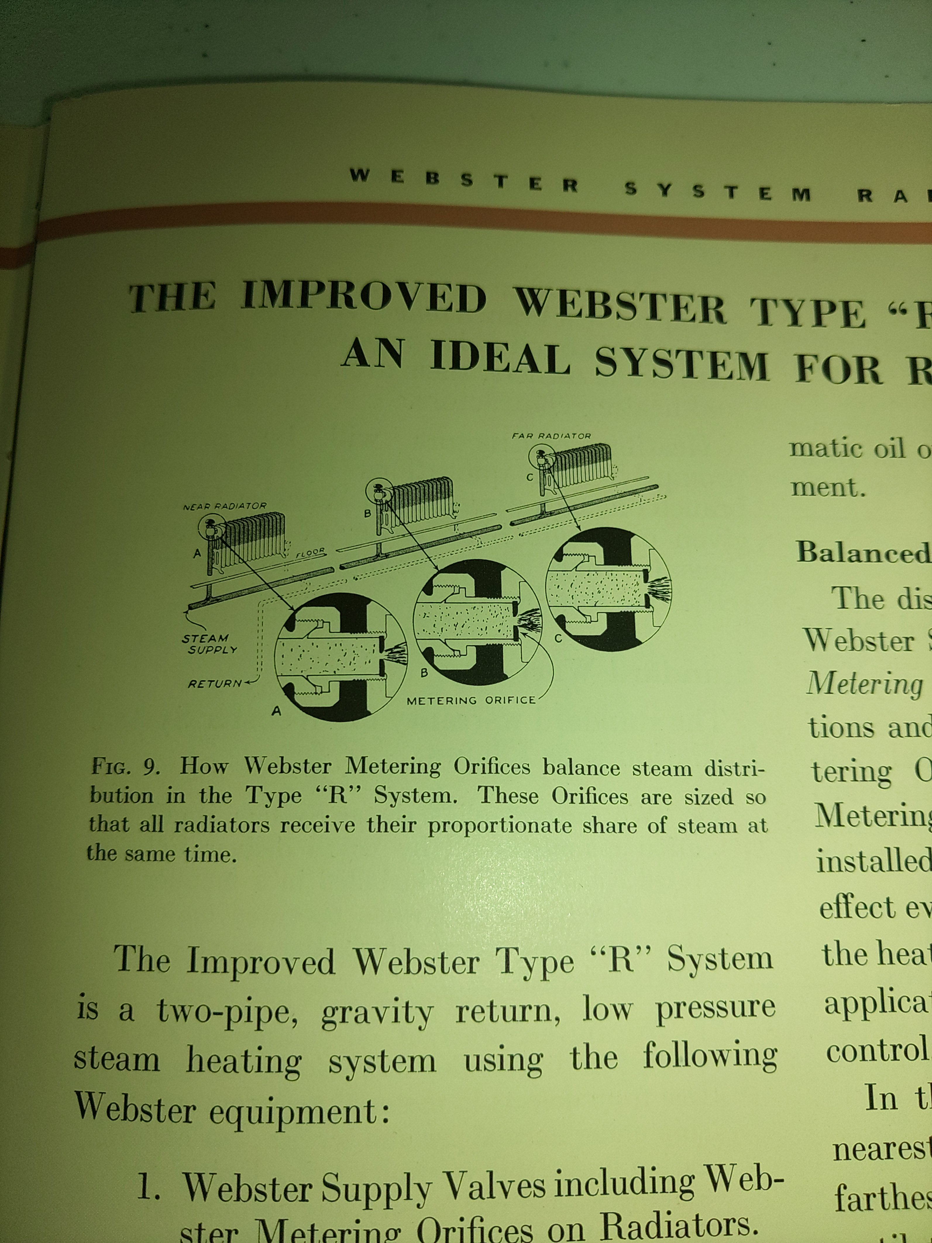

    that is exactly what that is. the warren webster system looks like it used a complicated thimble piece but you can do the same thing with a flat plate that fits in the union for the valve with a hole drilled in it.

    Since you have this one opened up I would inspect the valve and clean out the debris.
    Since you have the orifices the traps may only come into play with smaller radiators (if the orifice was not sized correctly, too large). Or very cold days (design day temperatures) when you need the whole radiator filled with steam to compensate for the heat loss of the structure.
